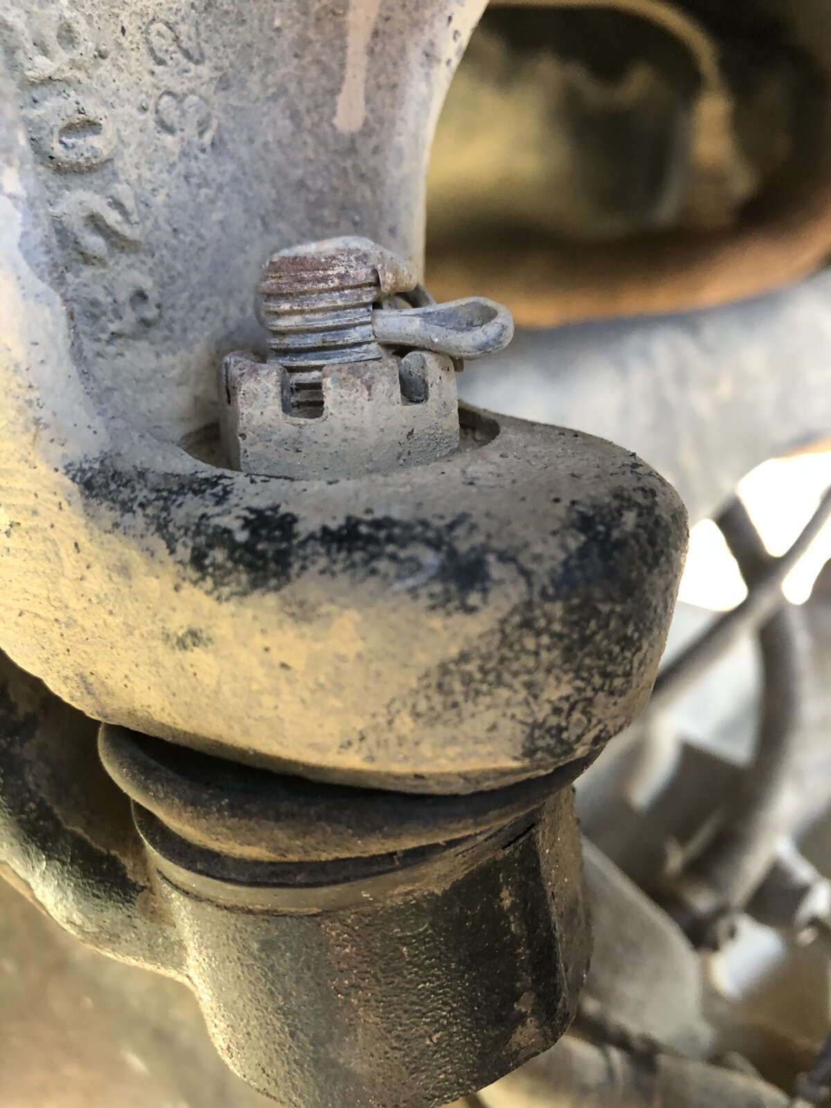

The frame side moves too, which is odd because the ball stud appears to be tightened past where the cotter pin can engage the castle nut. 🤔
Something doesn't add up...

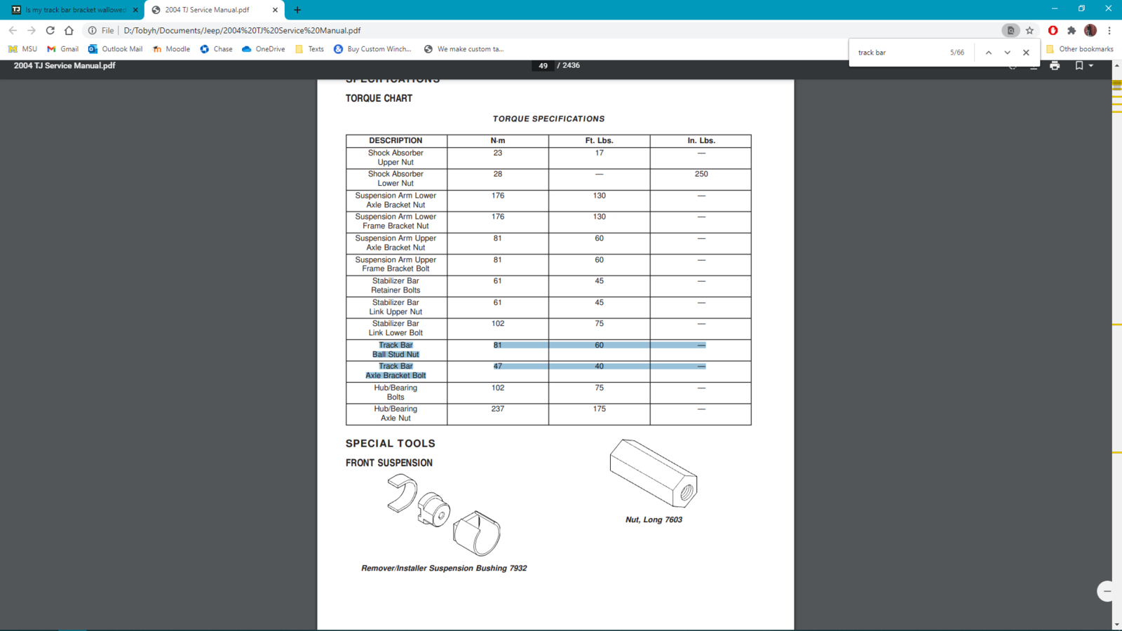

The 2001 Factory Service manual that I have says 55 ft/lbs for the axle end and 65 ft/lbs for the frame end.
Another source that I used said what I posted above, but I have found several other sources with additional specs.
