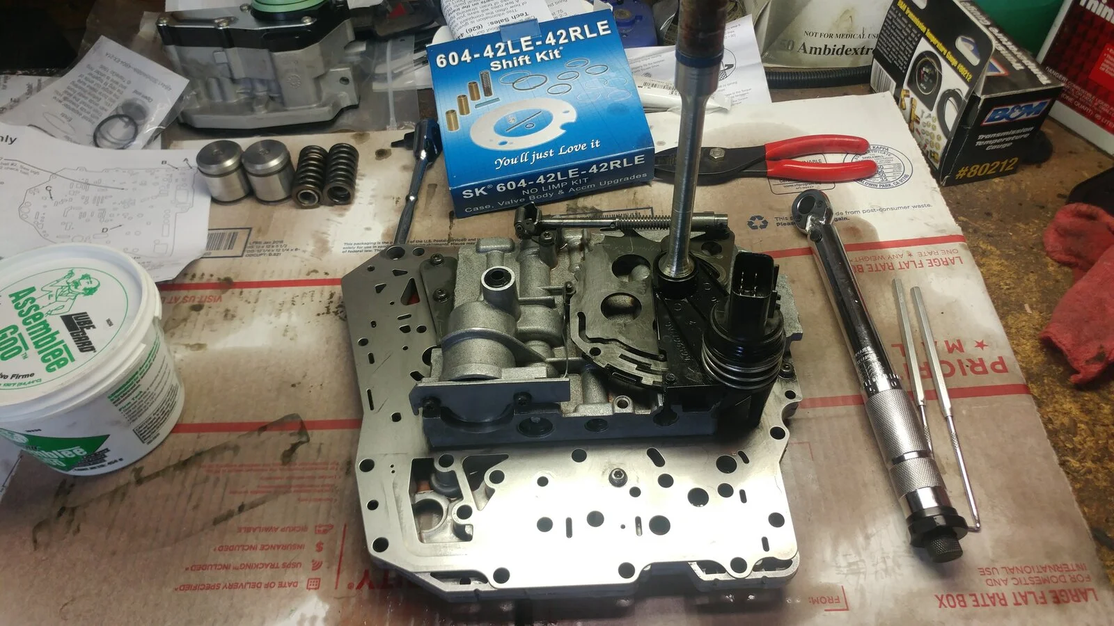

It’s the valve body program with the check balls, Sonnax did a mod where it will pump in park, but it has to be done by someone other that a stock shop.

The good news is that a rebuild is absolutely a job you can do in your garage if you have a decent attention to detail. I had never opened up a transmission before but successfully rebuilt mine last summer. The FSM & the ATSG are pretty much invaluable resources. There's a long thread here detailing my misadventures during that process. I also video'd a lot (but not all) of it. I too wanted to add this to my list of things that aren't a big deal, mission accomplished.
