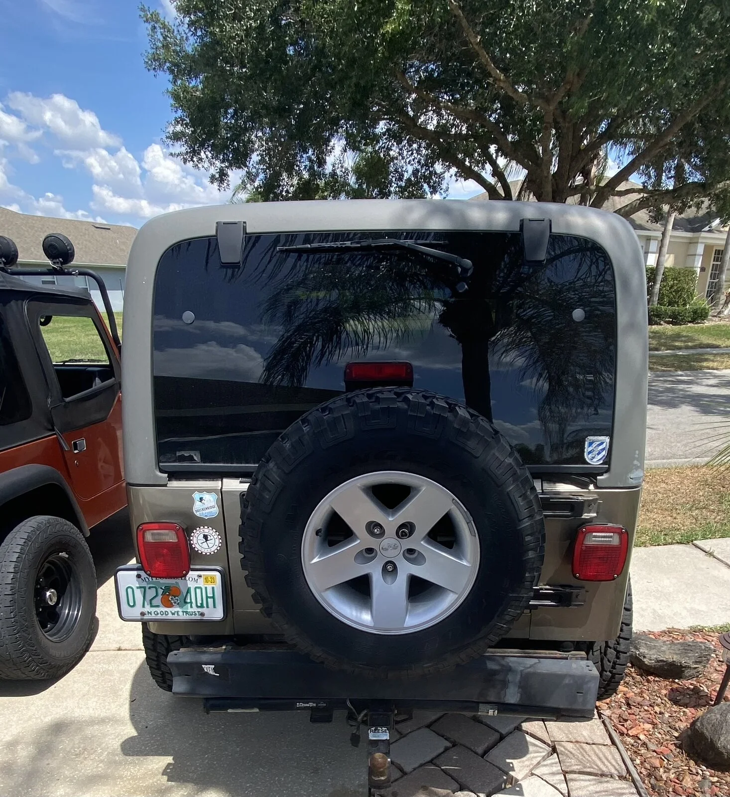

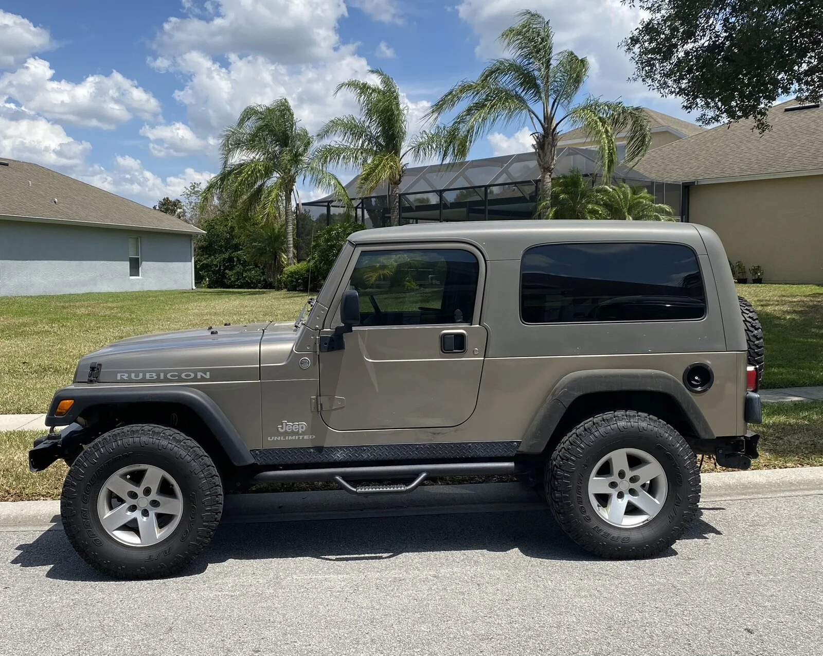

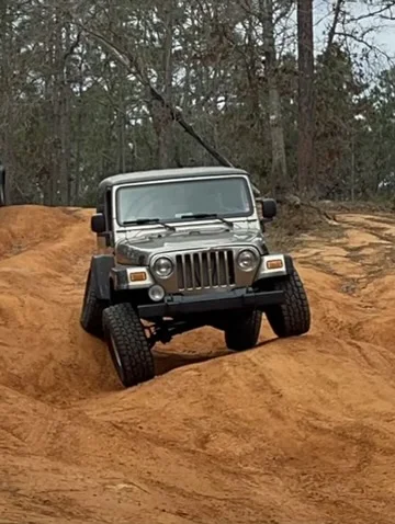

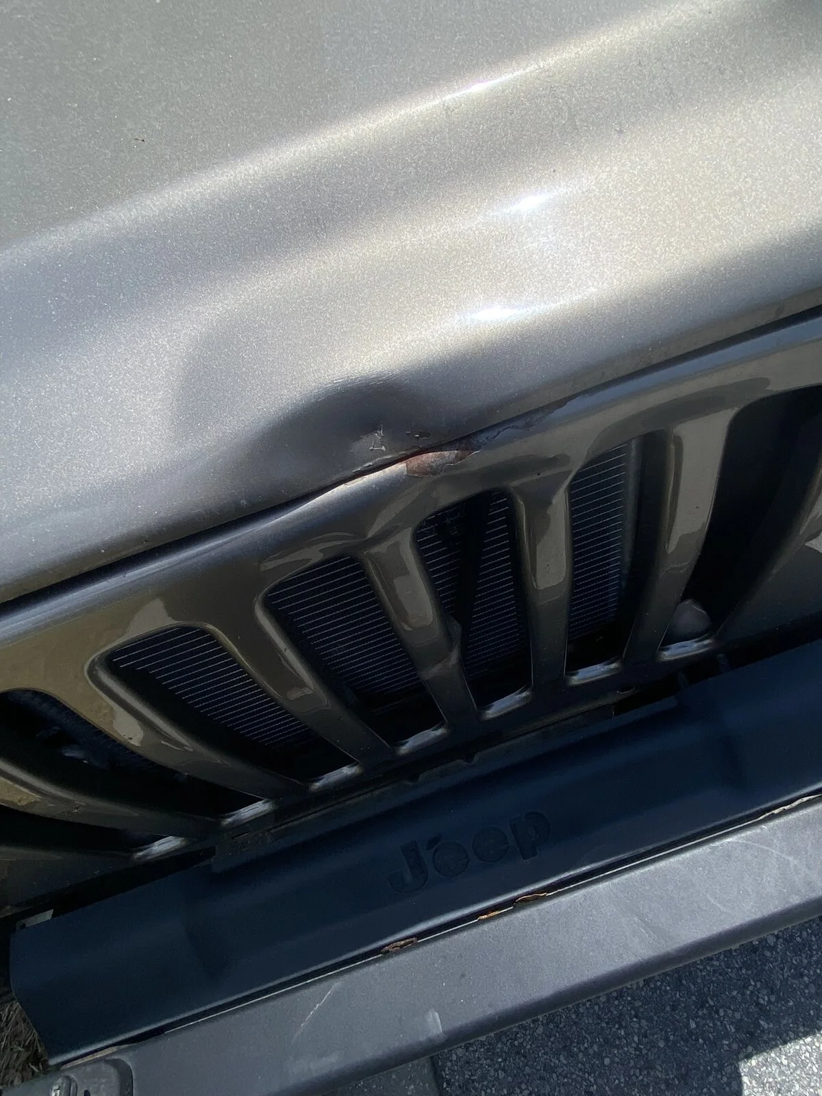

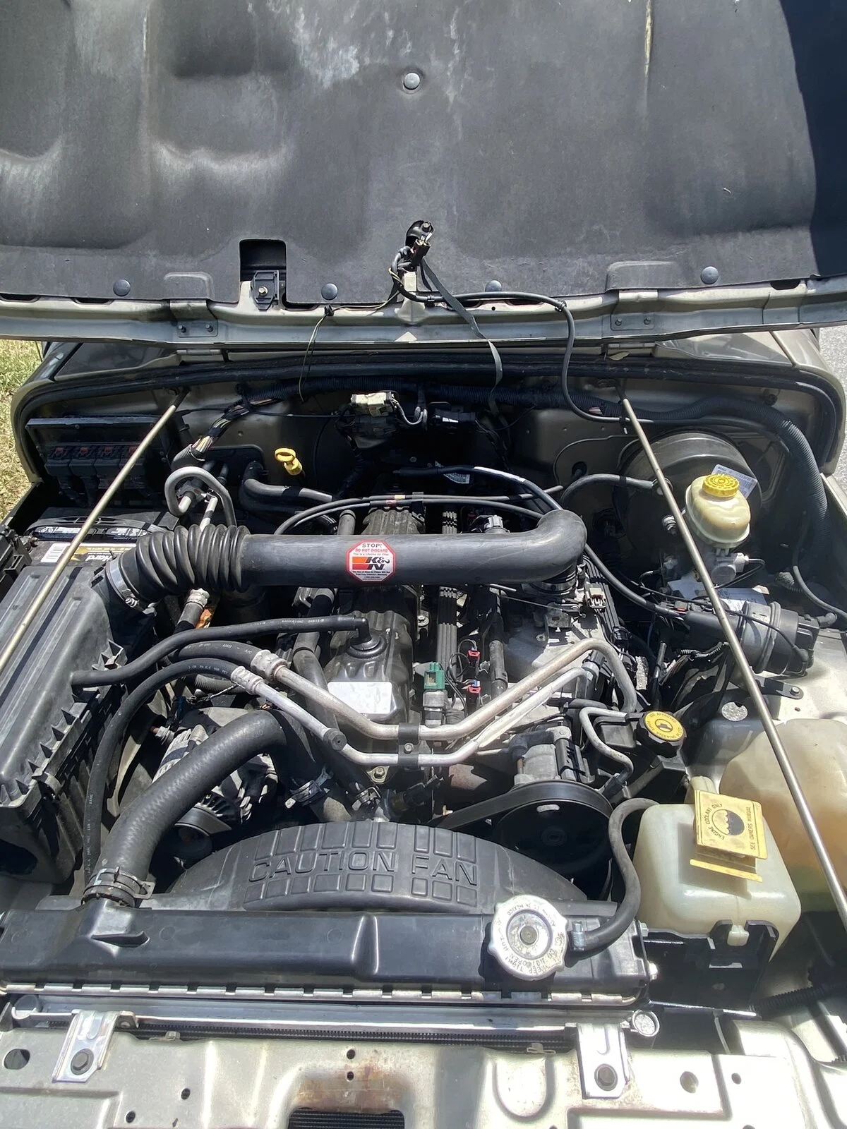

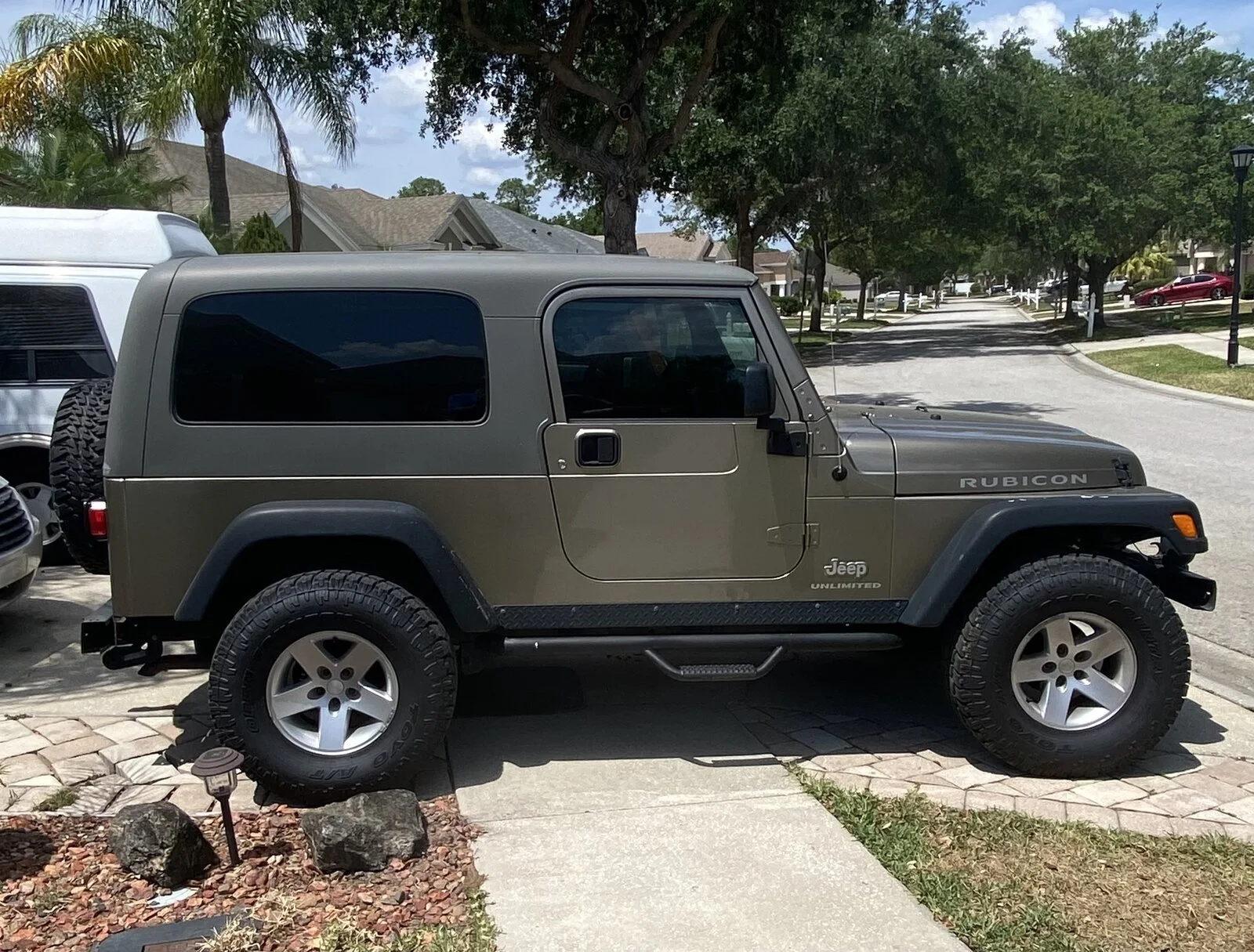

@707kevin - here are a few pics:
The Cyclops fog lamp!
Welcome! I think you'll find this forum very helpful, as I have. In today's market, I think you did well. I rarely see Rubicon LJs under $10k, no matter the condition.
