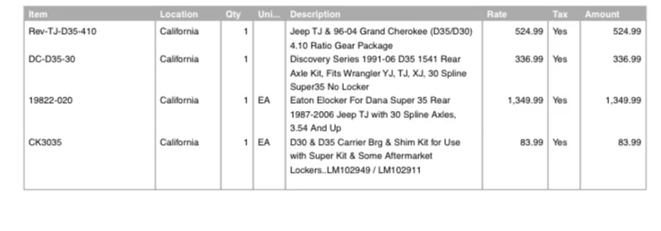

Hello, looking to upgrading my stock rear 35 to a super 35 and re gearing to 4.10 on 33s. Got a quote for parts and wanting to know if this is a fair price for an upgrade? Thanks or recommendations possibly. Quote is about 2,300
Yep, that's a pretty good price I'd say.
4.10s with 33s? Surprised nobody has jumped on that. I have 33s with 4.10s and a 5 spd and it's adequate but 4.56s would make 5th much more usable. Some will say 4.88s minimum with 33s. If already on 4.10s never mind.

I did my regear pre-Chinese Lung AIDS plandemic so I don't know the going rate in my area but that doesn't seem too bad to me for what you're getting.

Does R&G offer their US rear axles for the S35 kit?
If so, I'd get the US made version instead of the Discovery if you can afford the additional cost.
Unfortunately, Revolution only offers their super 35 axle shafts in the Discovery series (made in India). Or at least that was the case when I bought mine in 2020. But I've never heard of a failure yet from one of these shafts and I believe they remain the highest regarded s35 shafts on today's market.

Sounds about right… had my 97 tj regeared a couple of mounts ago for $2800… Dana 30 and Dana 35’s, 4:10 front and rear and LSD’s in both…
I regeared my previous Tj on jack stands and bought all the tools necessary… if the axles were on the bench I would do it again but getting up and down and installing and uninstalling a dozen times from the ground wasn’t worth it to me this time… just my 2 cents…
