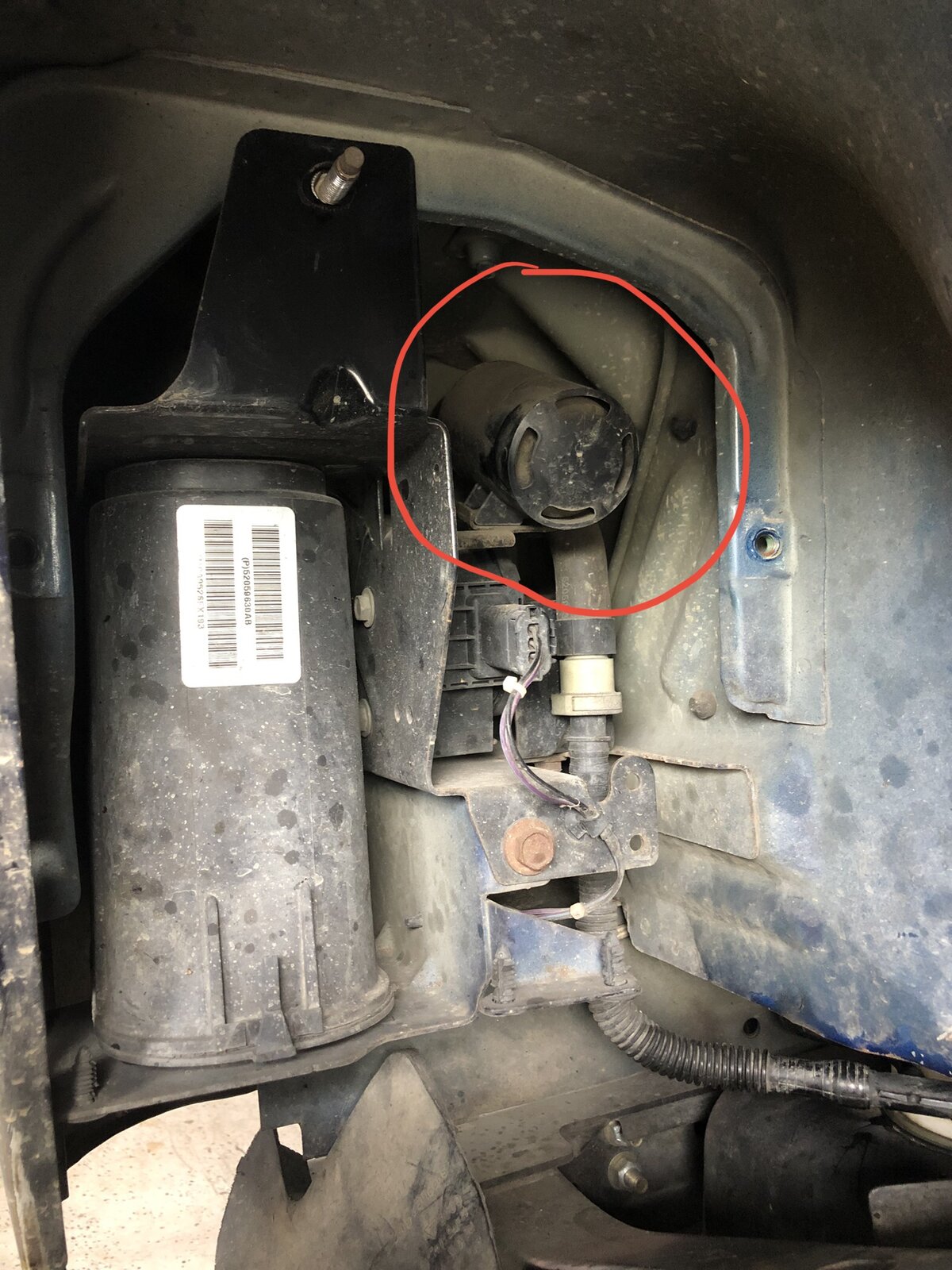

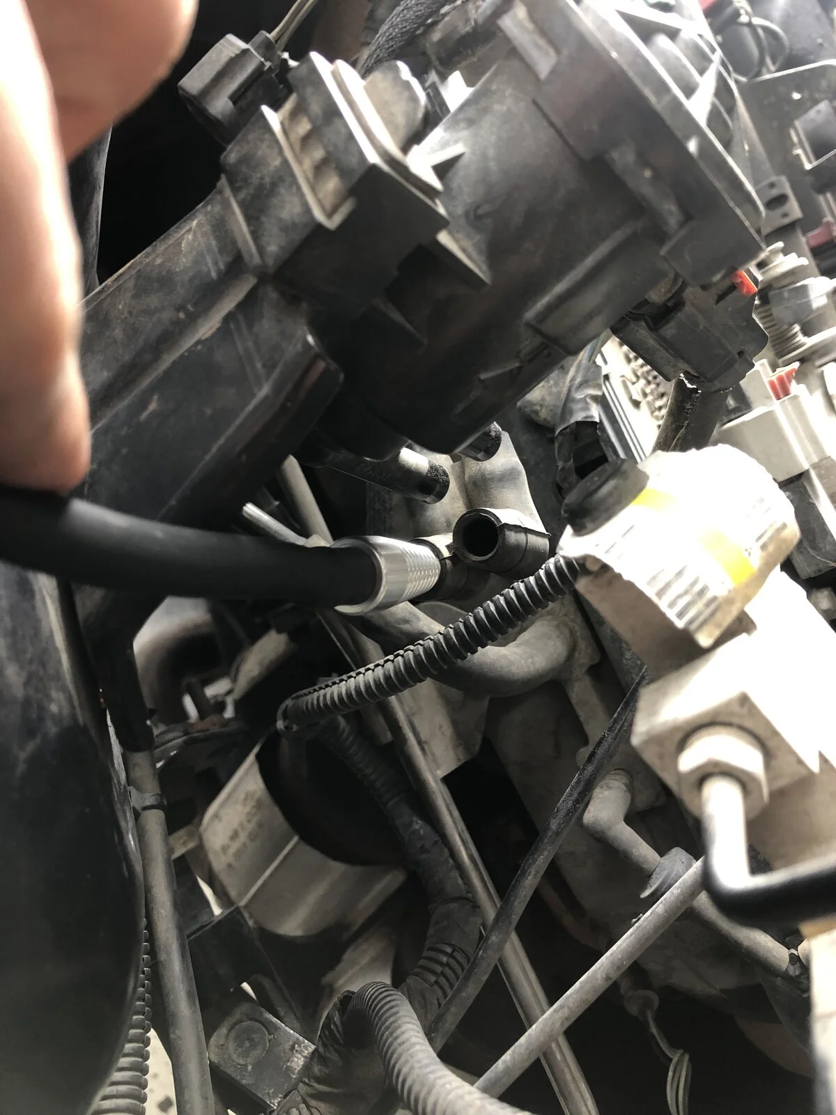

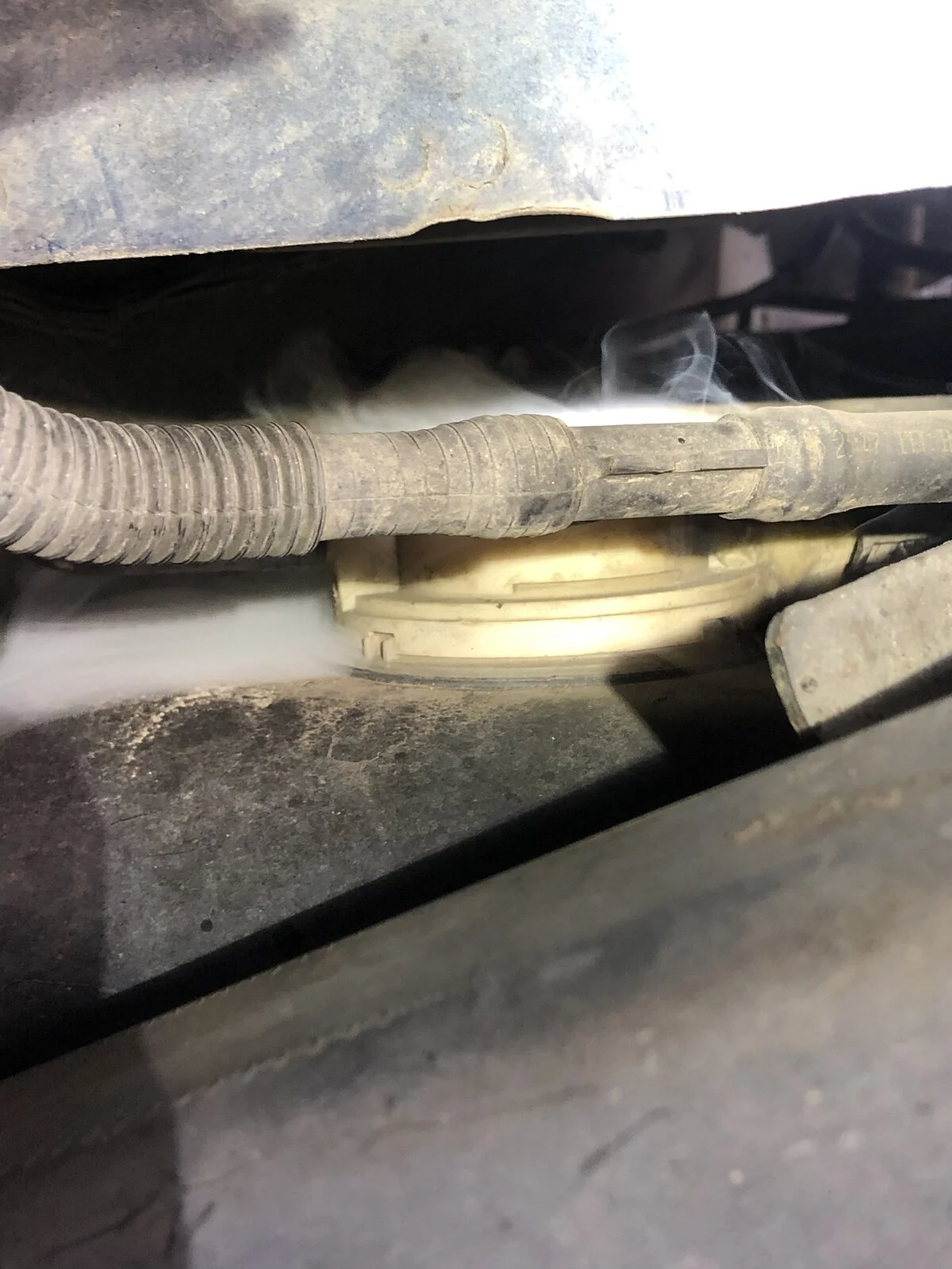

I had a very small evap leak. Hooked up the smoke machine and found the leak right away. Plastic weld fixed the leak but now the smoke is leaking from another part. Not sure what the part is called or if it’s normal.
First two pictures shows the part.
If the part is not suppose to leak. Does anyone know a replacement part number ?
For an 06 TJ.
That looks like a check valve I would go ahead and clear the code and see if she doesn’t code again
That one will likely close when it’s running or the evap system is running

Natural vacuum leak detection filter
Page 25-16 in the FSM
