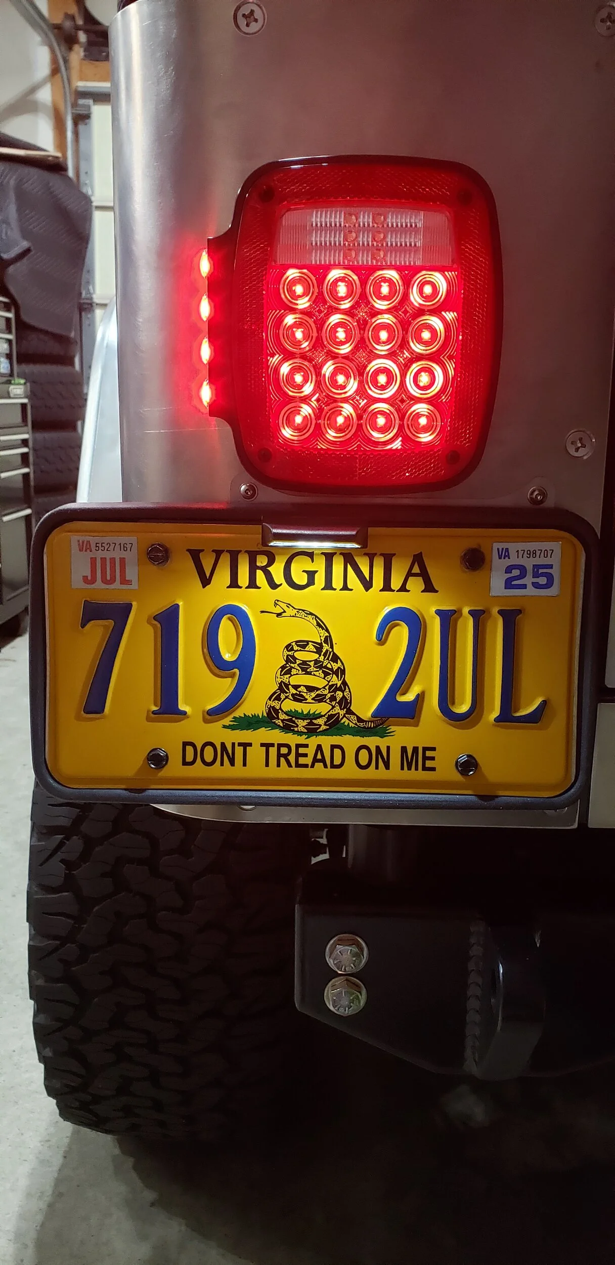

Having seen it firsthand mrblaine puts more thought into the packaging than most companies put into the product itself.After unpacking the lights, I realized he is both a Jeep and packing Wizard!
