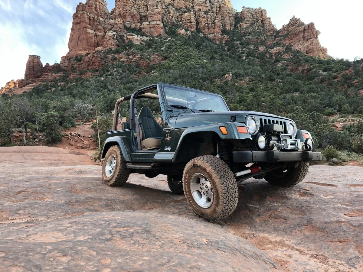

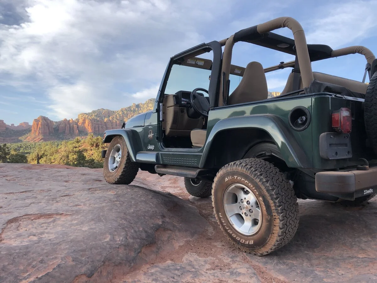

Took it out on a couple trails for the first time since buying it. Got to test the new suspension out and the ride was flawless.
I got to play with some pink jeeps too. One of them was sporting chrome AEV Bridgers. I see AEVs on their fleet quite frequently.
New suspension flexes well for what it is. This is about as extreme as the terrain gets around here, and I can always add a body lift if I start hitting my bumps. I still had a couple inches of clearance on the stuffed side.

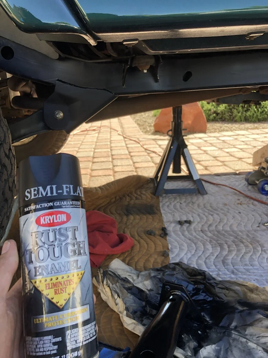

This is the stuff I used to paint the frame, and was actually picked based on forum recommendations. I think it looks perfect, and after a few wheeling sessions I don't think you'll ever be able to tell that the frame was painted.
That is just what I was looking for.Going to get rid of some light rust and paint the frame. Keeping my 97 sport stock looking also. Just picked up a set of 5 Canyon wheels with 31" Goodyear Wrangler Duratracs. Cant wait to put them on. Your TJ looks great !
Thanks it turned out great! Eventually I'll do the rest of the frame and axles just so it matches and looks fresh. I'll remove the axles to make it easier and that's probably when I'll regear too.

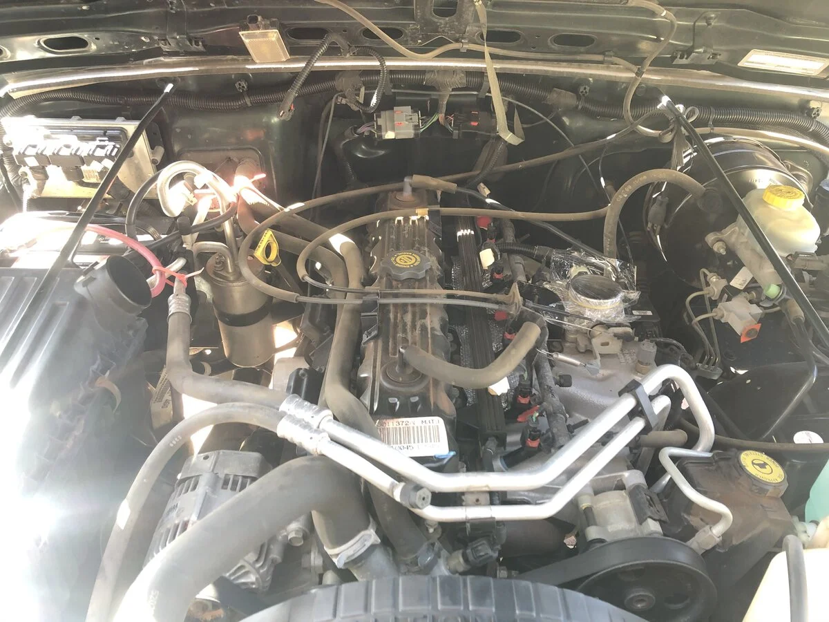

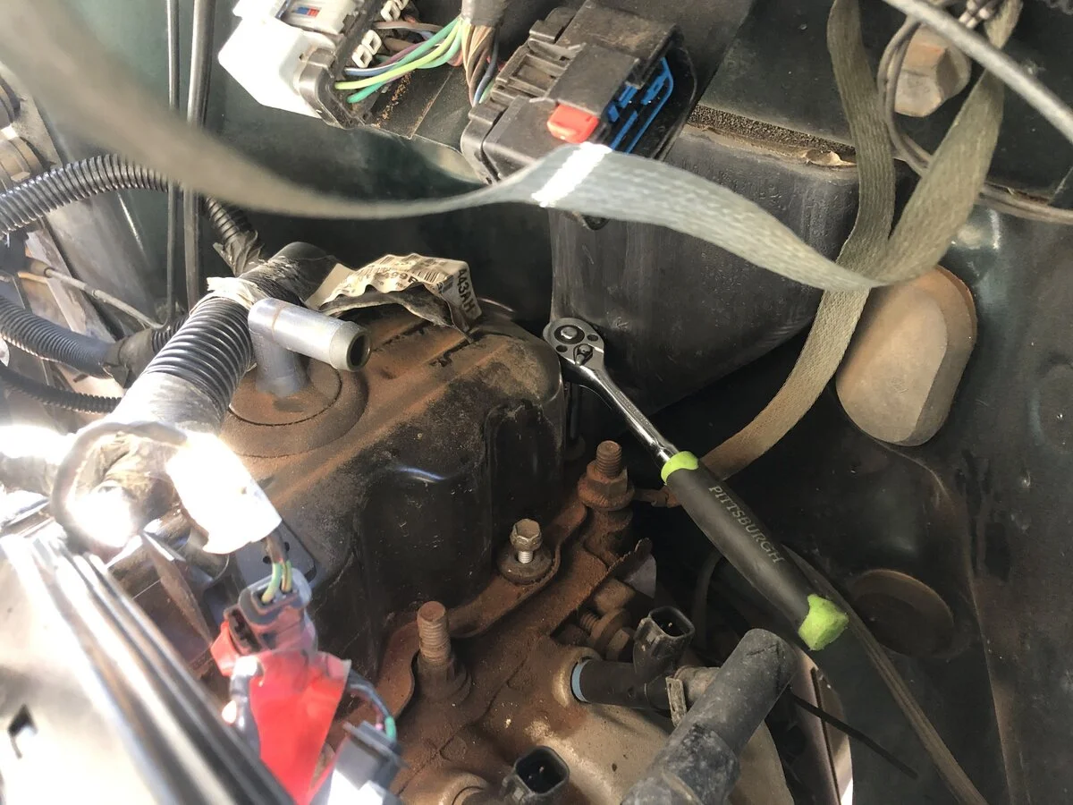

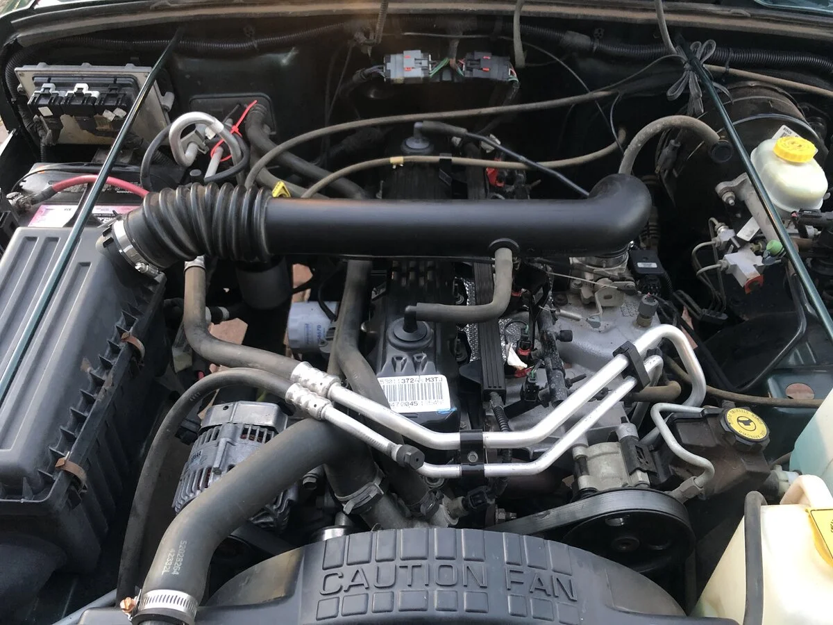

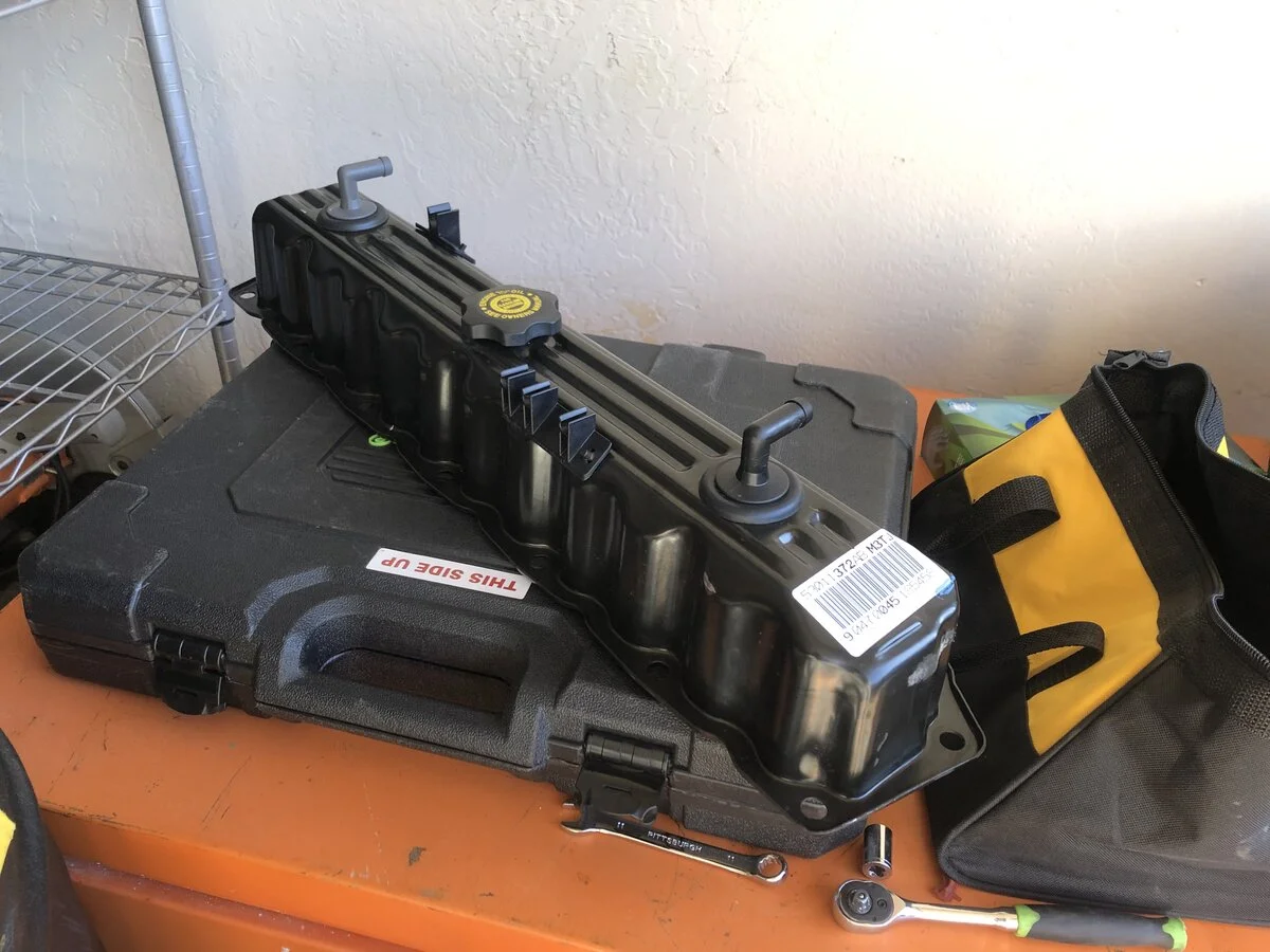

Today I tackled the valve cover gasket. I'm kind of blown away at how bad the oil is on the engine with only 53k miles, so in addition to changing the gasket, I also used some Purple Power and a wire brush and scrubbed the block pretty good. I think most of it is was from the grommets.
Do yourself a favor when you do this job. Take 15 minutes to remove the coil pack, and the injector wiring along the driver side of the cover. This gives you enough slack to move the wiring room sitting behind the valve cover to above it, giving you plenty of space to get the rear bolt and work around the sides. Unless you have an 03-06 with the plastic bridge behind the valve cover......suckers ;)

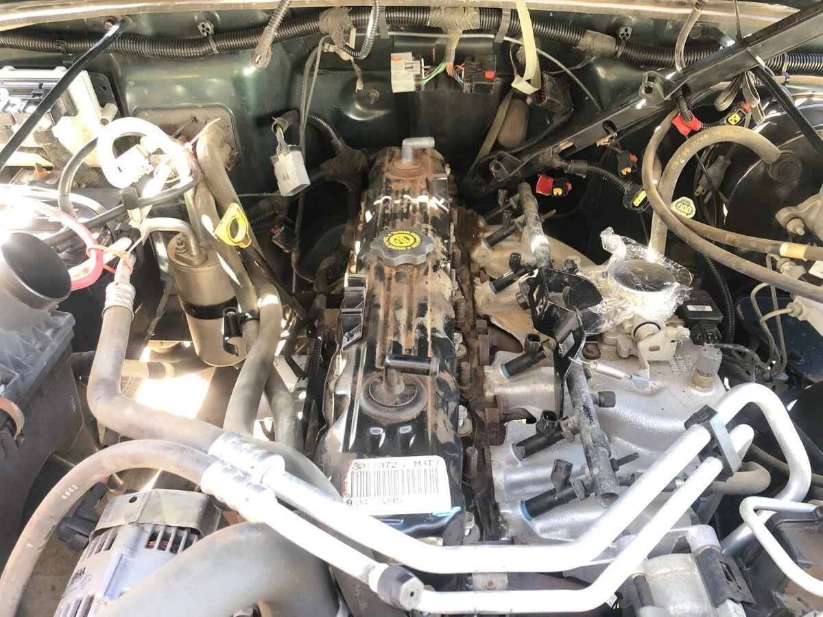

After removing the valve cover, I thoroughly scrubbed head and the manifold, degreasing every bit that I could. The PP/water mixture and a wire brush made quick work of the years of sludge buildup. All of the sludge you see in the above picture is now gone. I did a quick check to the head too. It's not a TUPY, but I didn't see any cracks....yet. Fingers crossed.

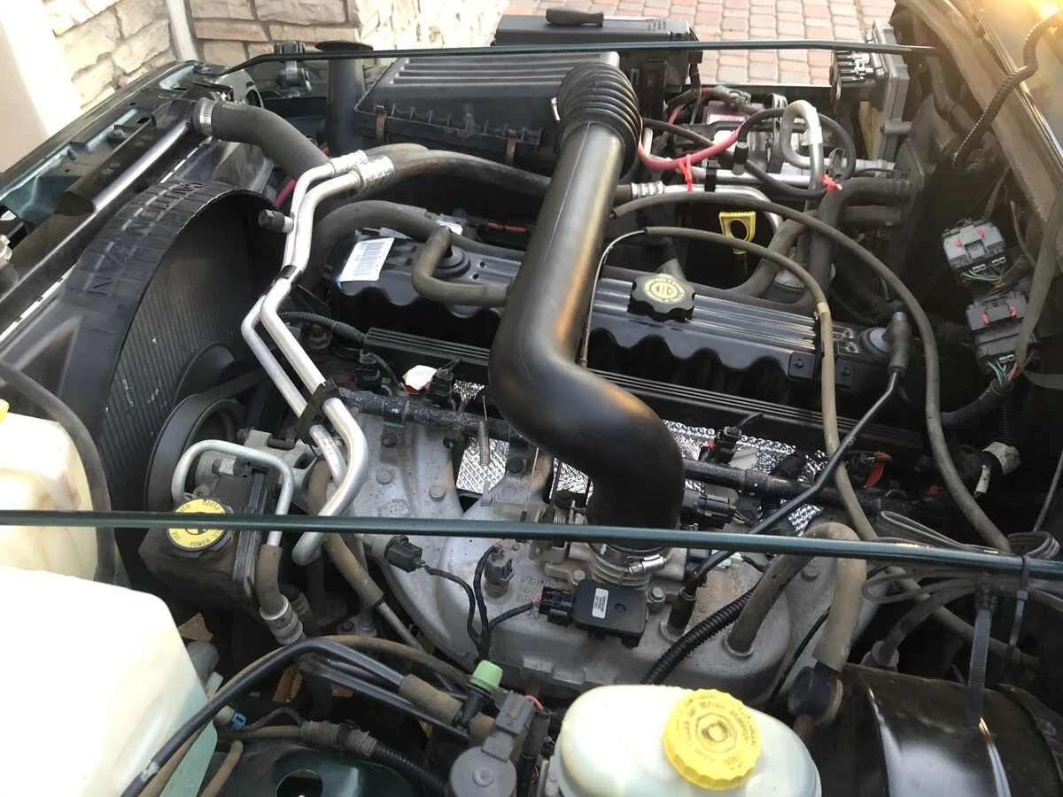

I then degreased the valve cover, and added new grommets and elbows. I also cleaned the bolts, and the metal sleeves that go inside the valve cover bolt grommets to shine them up.
Finished result.
And with it running, to make sure everything still works, which it did. More to come!

Damn that is one clean engine bay!
I spray it down whenever I wash the Jeep (like once a week lol) and it keeps it nice looking. I know it’s a Jeep but I see this as an investment just as much as I see it as a toy. Anything I can do to keep resale value up on the chance I’m in a pinch and need to sell!

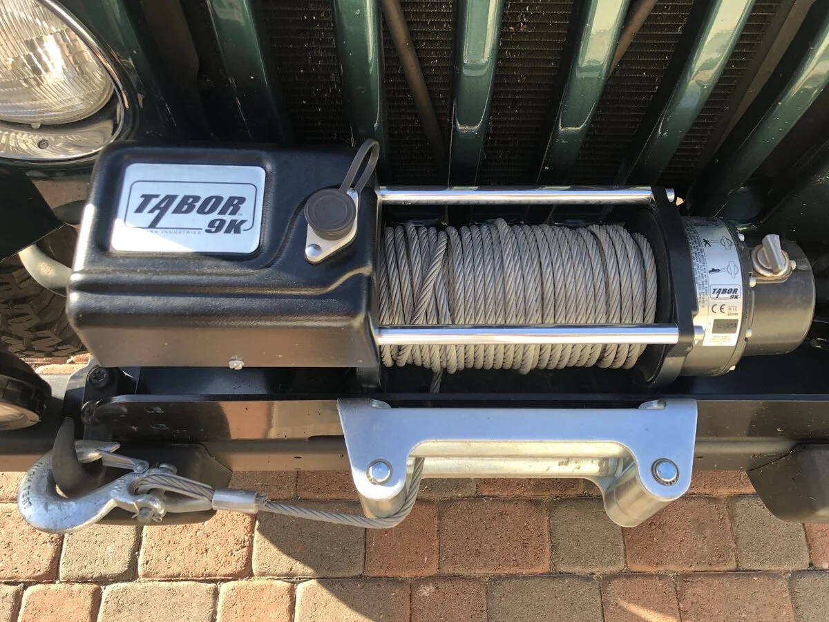

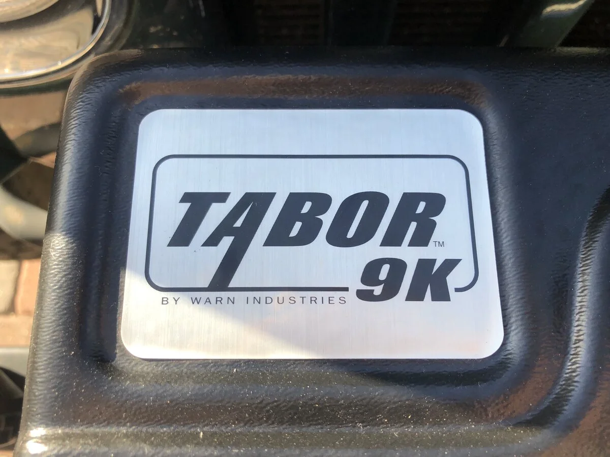

The winch is very beefy and I like how it looks on the raised mount on the stock bumper. It's build quality seems on par with Warn, and reviews rave about the quality and durability.
I have the same winch on my jeep, previous owner installed it. I've used 3 times for non jeep activities and thought it did good. Only issue I have with mine is I cant get the lever to turn to free spool, I have to use the remote to let cable out.
Usually that’s something you can pull apart and clean/fix. I used mine for the first time last week to yank some roots. Worked great!
I had mine completely taking apart, cleaned what looked like needed it and reassembled. Still cant get it to spin. I may have to take another look at this weekend.
Well I just got home from work and decided to try it and it spun right around and started free spooling. Looks like it was user error haha
