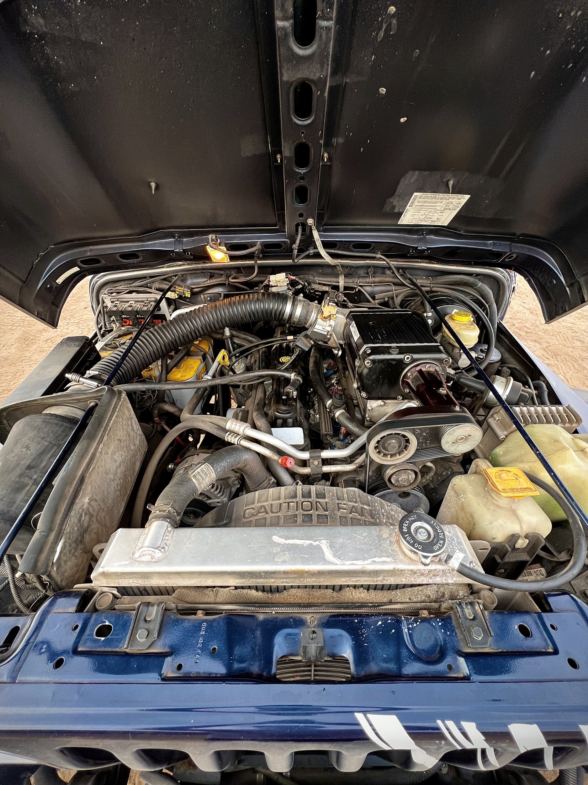

I’ve recently had some issues with my 2004 Jeep wrangler rubicon that I was looking for some help with. Since I purchased the vehicle, I’ve had a very loud whistling sound that I assumed to be a vacuum leak. I replaced the throttle body as that’s where a majority of the smoke came out of when testing and it has gotten better. However recently I’ve had an issue of an intermittent surging idle at startup, and stalling when coming to a stop which doesn’t always happen but happens once in a while. The whistle still happens but not as much as it did before, and only happens at idle rpm’s. If the Jeep dips under idle rpm’s the whistle goes away.

I have attached a photo of the motor and a video of said whistle/whine

Did you remove the IAC or clean it in place with the engine idling? Cleaning it in place while the engine idling cleans the entire IAC system, not just the IAC itself.

I did both. I replaced the throttle body and had to reuse the IAC housing so I cleaned the whole thing while it was out, as well as went through the steps to send carb cleaner through it while it was back on the vehicle and running. And that’s a good idea I’ll have to look into getting something like that

Since your IAC was clean, a good second guess would be the throttle position sensor is going bad. That's assuming your clockspring is good since a bad/electrically noisy clockspring can fool the PCM into thinking the TPS is going bad.

That was my next thought was the TPS. I’ve read some other posts talking about somewhat similar things but not exactly what I was experiencing. How about the whistle noise? Vacuum leak or no?

Whistling could be a vacuum leak or maybe really it's a noisy idler pulley.
