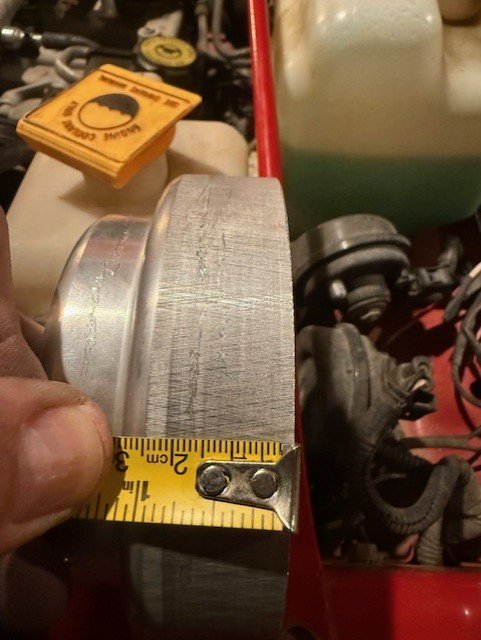

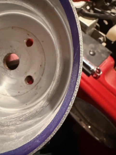

Granted installing the pulley had its own issues. The back side of the pulley would bottom out against the replacement button head bolt that was provided. So much that when first installed, the water pump refused to even turn. Ended up taking the pulley off and added some blue sharpy to the edge (I'm not a Machinist nor do I have a Lathe) and I sanded the back lip of pulley down using 120 grit and a DA Sander to provide more clearance without grinding the Button head Allen bolt down. In defense of Texas Jeep Products it would be very hard to compensate for all of the different water pump manufactures and there casting out there to know if the pulley would clear or not.
Looks like I need to pull the Pulley off again to clearance it a little more as it starts to grind ever so slightly when I mash the gas pedal hard. Hands down I think the Overdrive Pulley made the biggest single difference in helping to lower temps.
Added a few pictures that show how much I clearance the pulley. Disregard the scratches as I initially started to clearance the angle on the inner edge with a hand file which added scratches more than anything.
Laying pulley against 120 sanding discs on a DA helped me remove most of the material and left a cleaner look. Unfortunately, I could not find my micrometer to make more precise measurements, but you get the idea.
I think one more pass on 120 DA should do the trick and get rid of all contact between edge of pulley and Button Head Allen bolt.

As a side note: If you had the Water Pump out, it would be easy to just use a Spot Face Drill bit and remove some material from the pump housing to allow the Button Head Allen Bolt to thread deeper into the Water Pump Housing.

I do think that these small issues can be resolved. In my case, the edge of the belt is now riding perfectly along the edge of the pulley that I sanded down which means I can't really sand any more off the pulley. The only place I could remove a smidge of material would be to taper the edge of the area I sanded down on the inside a bit. Much like the way you already machined them. That would be the silver area to the outside of the blue sharpie mark in the pictures. I really do not want to sand down the top of the replacement Button Head Allen Bolt you provided since removing any material from the bolt would only weaken the sides of the Allen slot itself and make it that much harder to remove at a later date.
Thinking to try and loosen the belt tension just a "smidge" since it only scraps when I rev the engine aggressively or accelerate aggressively.
Normal smooth acceleration, it doesn't scrape.
Regardless, your over drive pulley made the biggest single improvement in reducing the temperature of my TJ in this summer heat. The quality of the pulley his outstanding and I highly recommend it to others.
