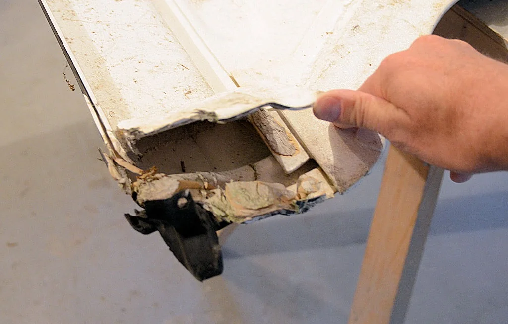

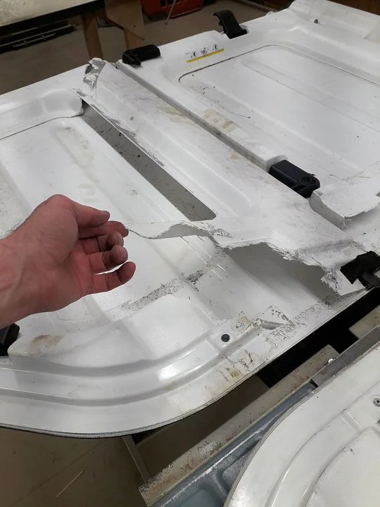

I recently did a repair in a JK Freedom Panel which should illustrate the basic techniques to use on your repair. Here's the Freedom Panel damage:
The fiberglass is cracked to the point where it's no longer structurally sound and some of the outside skin is actually broken off and missing. The panel is double-walled, so access needs to be gained to the inside to properly make the repair. It turns out that in this case the inner wall was also cracked and broken so with a little more cutting I was able to separate the inner and outer shells for access to the inside of the outer shell.

Almost nothing is "too broken" to be repaired using similar techniques; a while back when I was just starting my conversion of a factory JK hardtop to modular I picked up a broken side panel from a hardtop. It was missing a lot of the top edge of the panel but other than that it if repaired would make a good modular side for my project. It also had a large crack along the bottom edge. This repair was a little more advanced than the one above; for the Freedom Panel I was able to use masking tape as a form to make the repair of the missing fiberglass, in this case a lot of area was missing so I used a wooden form as a "mold" for the area to be replaced. The bond for the new area, and the repair of the crack at the bottom of the panel, were done using the same materials and techniques as the Freedom Panel repair though. Some before and after photos...

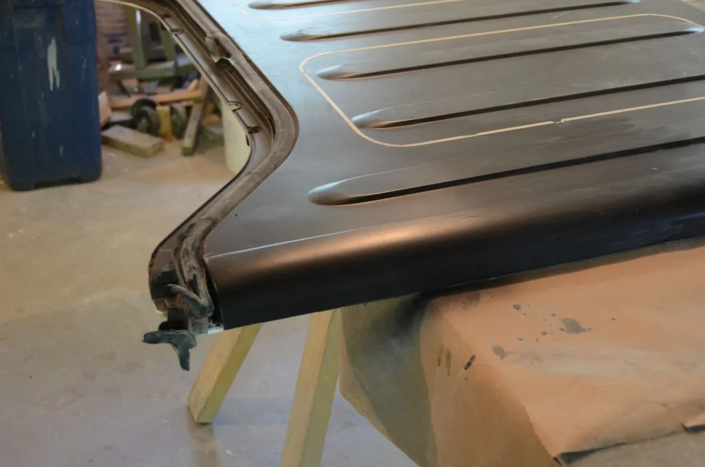

On my '03 I had backed into a tree and broke the corner of my hard top. It left a hole about 3" X 6". I called around and none of the body shops would fix it because it was fiberglass, and even the Corvette shops wouldn't do it because of the pebble grain finish.
I ended up fixing it myself with a fiberglass repair kit from a local auto parts store. The repair went well, but after sanding, I was left with a smooth surface. To match the finish, I painted it with pebble grain spray paint made for gas grills, and to simulate the texture, I used a texture roller from Home Depot. I painted the area, and while it was still wet, rolled over it with the texture brush. It took several coats to get the texture right, but I think it came out really well, you wouldn't notice it unless I told you where to look. Although only one side was damaged, I painted the entire corner cap at the dividing line, so I wouldn't have to worry about feathering the color in. Luckily, the gas grill paint was almost exactly the same shade of black as the original color.
The only picture I have is after the final paint. The brush picture is similar to the one I used.
From what I can see, it looks great!

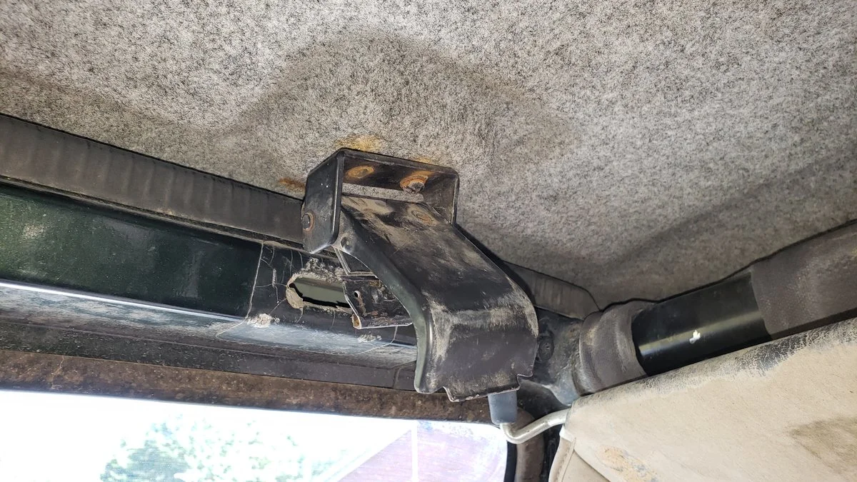

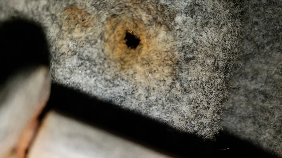

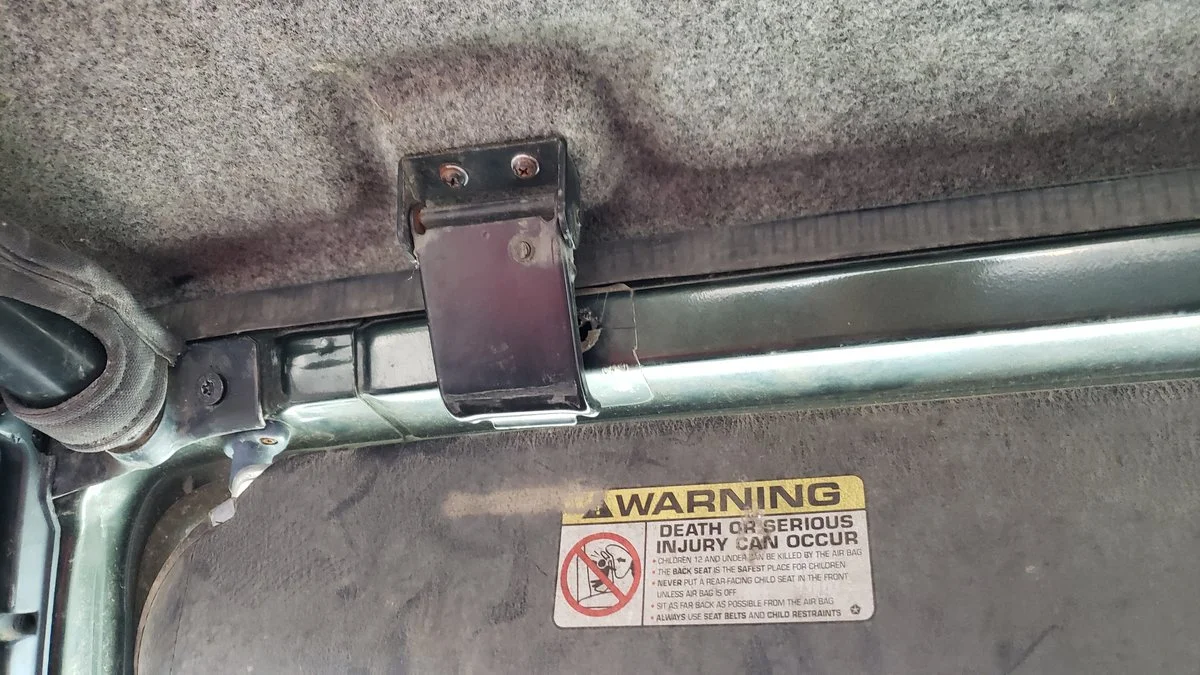

Do you have any suggestions for stripped out screw holes on the inside from the brackets that hold down the top?
You need to be more specific. The hard top has holes in the lower flange that hard top mounting bolts go through to captured nut plates. Are the holes in the flange broken out or are you just missing the floating nuts?
Reactions: 05 Blue Unlimited
Helicoil!! Dont scare me...I own a Ford f250...lol.
I dont know what the screws were biting inside. He is a better pic of the culprit.

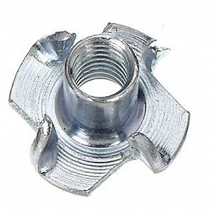

Mmm, maybe drill out the holes large enough for one of these to sit with the flange at the bottom, then fill the hole with fiberglass resin? (Put a bolt in it to keep the hole from filling with resin.) That should give you a good solid metal thread that should last a long time.
Put a release agent on the bolt during the cure. Made that mistake before...

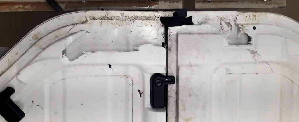

Here's an example of how weak the bonds are, these are JK Freedom panels that were in an accident. The inner shell of the panel was at the rear but when it broken the inner and outer skins separated all the way to the front:

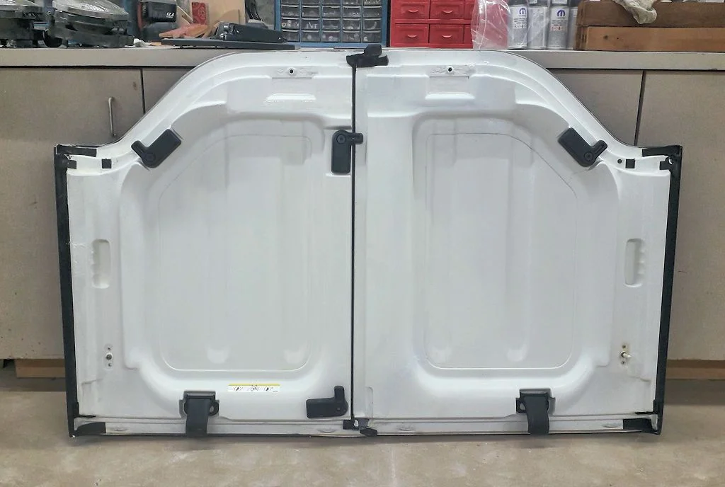

BTW to illustrate that pretty much anything made from fiberglass is repairable, these are the Freedom panels from that accident, parts of both are completely broken out - the adhesive used to join the skins just gave way. The same type adhesive was used on the TJ hardtop.
When I received the panels, I did not get the broken sections, so I had to recreate them. Here's the finished result:
