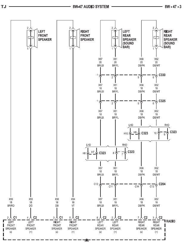

There's a dark-blue wire for the - lead to the right-front speaker. I don't see a red wire with a pink tracer anywhere in the TJ's schematic for a 2002. Could it be pink with a white tracer? If so that's the main always-on power wire for the radio.
