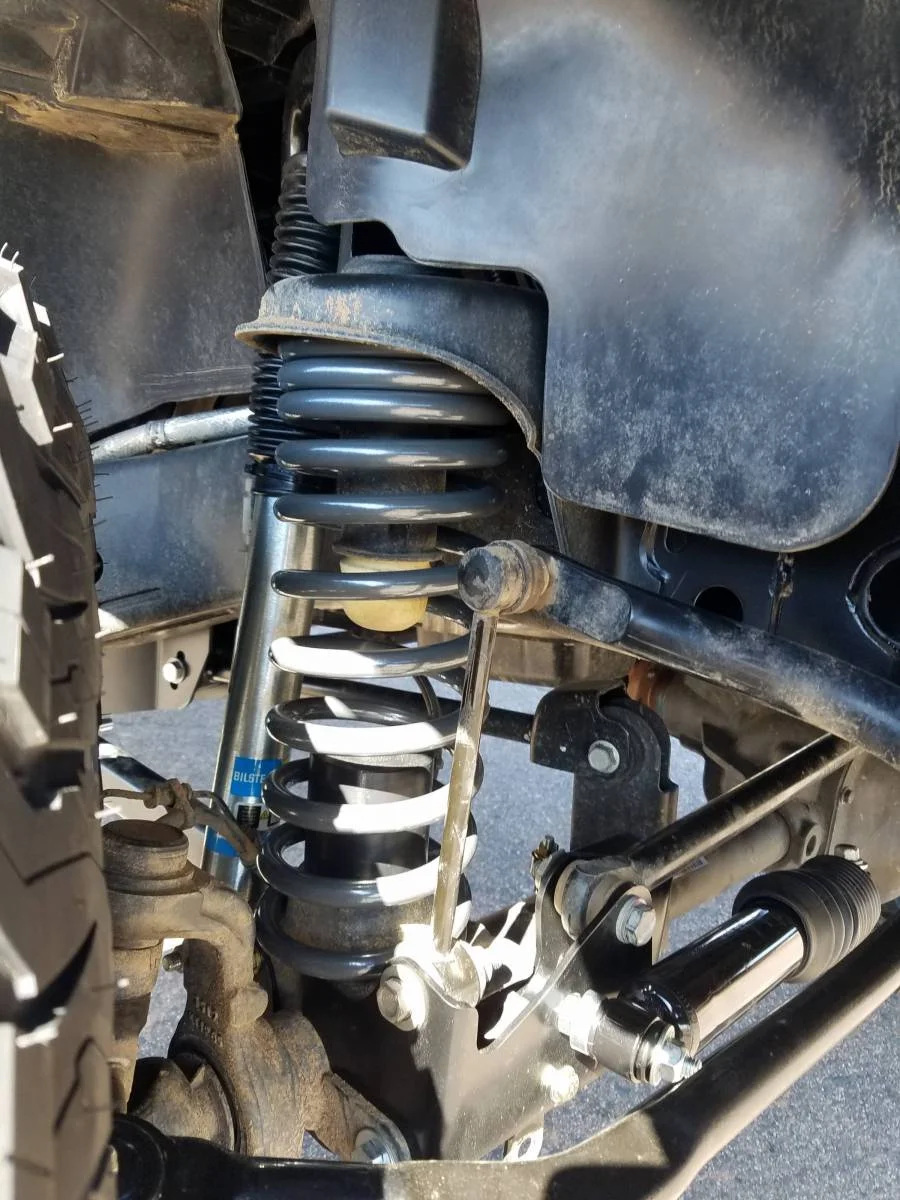

... The thing that is bugging me about dual rate springs is the compressed section of spring. It's basically just a coil spacer being mostly compressed at ride height.
That is what I was trying to describe above. That compressed section depends what the spring was designed to do. If you look at the AEV and Nth degrees springs, they do not act that way. The top coils are still open at normal ride height. You ride in the soft coil. Its not until you load the rig down that you get into the firm coil. MetalCloak and others take this this other direction as you described above. They have the soft section of the coil in full coil bind at ride height, so the only function the dual rate performs is to give you more droop. They are very different approaches. Most people are not seeing this difference and they think all dual rate and progressive rate springs act the same way and function the same. They do not. I think the JKS springs are designed to behave more similar to the AEV/Nth Degree springs. But I have never been able to find a picture of a JKS spring sitting at ride height so see how the coil is compressed.

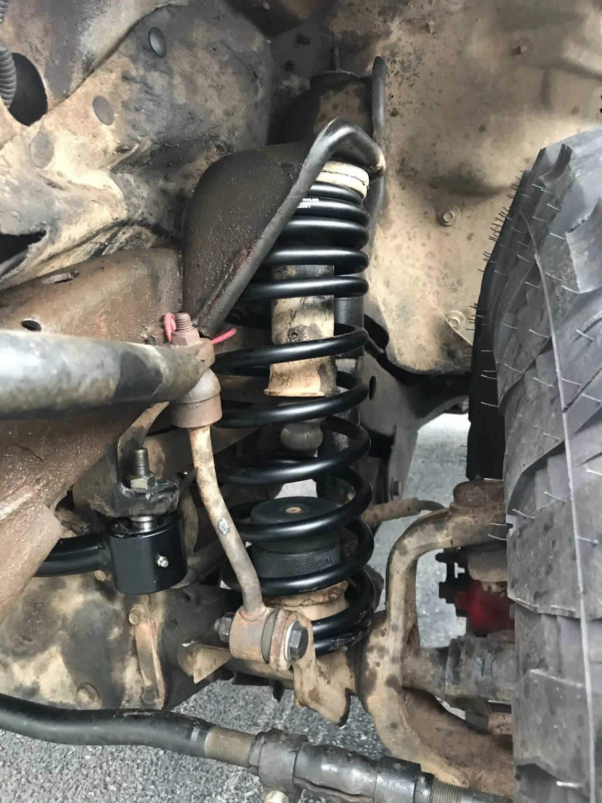

Let me demonstate what I am saying. Look at this Nth degree setup. See how the rear coils are NOT in bind at ride height? You can see the top of the coil is compressed more than the bottom . But no where near being just a spacer. Not until the Jeep gets a much heavier load on it will it go into coil bind. At that point you will still have the stiffer coil underneath to ride on. It is a true progressive spring made to carry a load.
TJ with Nth
JK with AEV
That is a very different spring than the Metalcloak way of doing things.
Don't think the MetalCloak way is the only way to build a Dual rate spring.
....For a daily driver that runs light most of the time, I need a spring that will provide a softer ride over small events, and a more rate when I add 150lbs. to the back with dog/gear/trailer/etc.
Yep, that is what I need too. That is why I like the Nth Degree and AEV way of doing it. I just don't know where JKS falls into the spectrum.

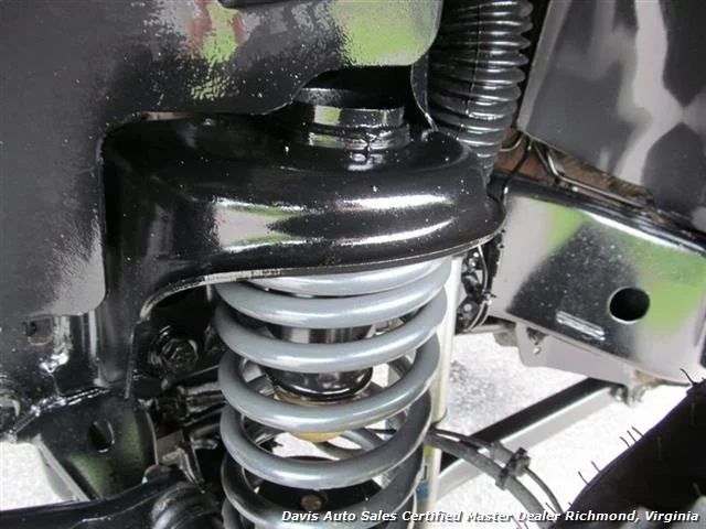

Here is another picture of how the AEV front springs sit under load. You will notice that it has one coil in bind. Probably due to a winch or something. But it still has at least 2 coils of the softer rate before it gets into the firm rate. Notice the spacing between the top 2 open coils is about 1/2" and the spacing between the lower coils is about 1". It still has a progression of spring to work through. It can still carry more load before the soft coil is in full bind. This is an entirely different way to design a spring than MetalCloak. MetalCloak designs their springs to give full droop without having the spring come out of the perch. AEV/Nth Degree designed their spring to maintain a consistent ride quality as the vehicle gets loaded down with additional gear. Additional length for droop is just a by product, it is not the intent of the design for AEV/Nth Degree.
