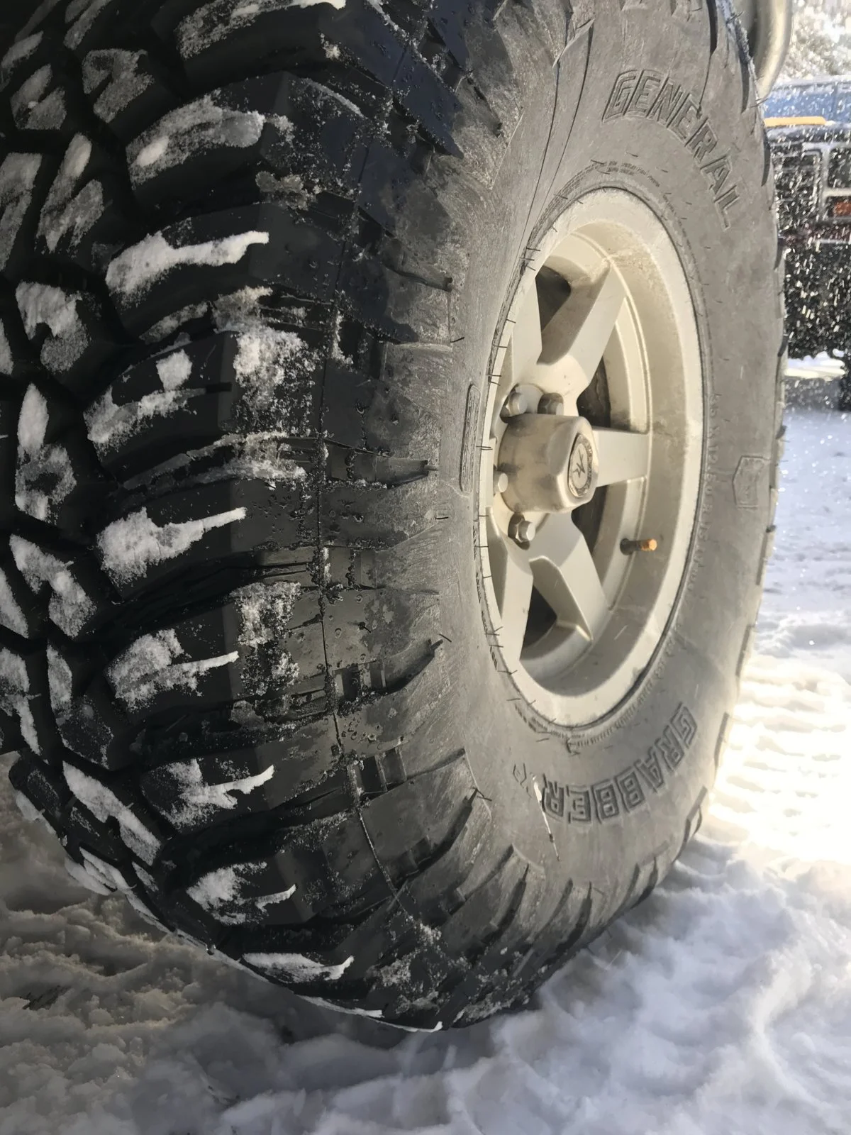

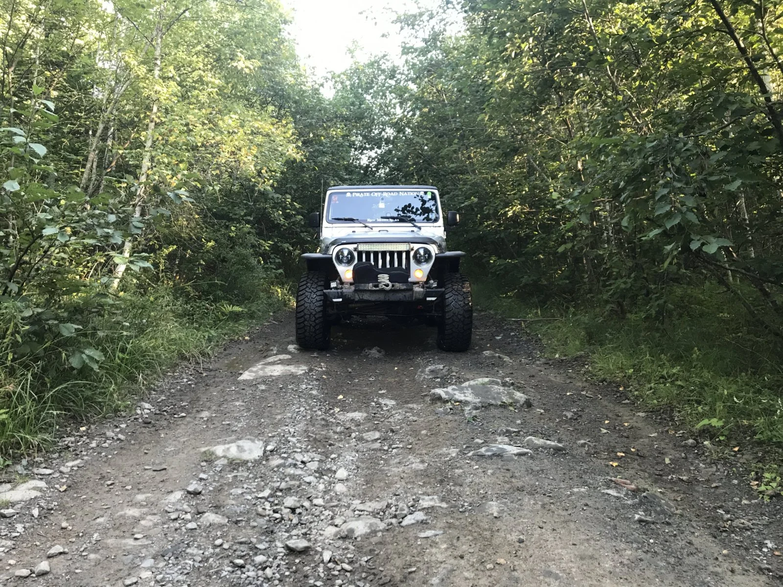

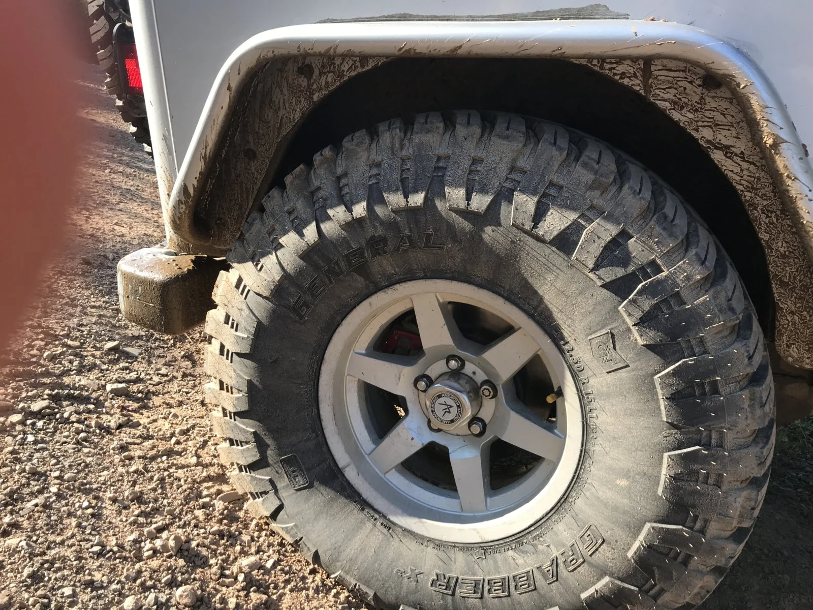

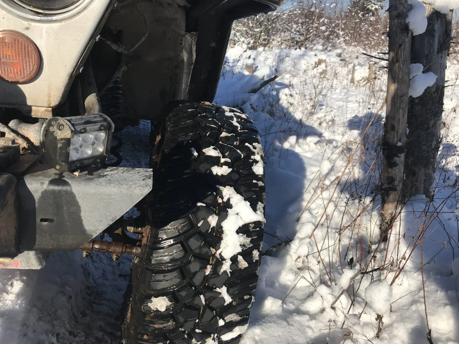

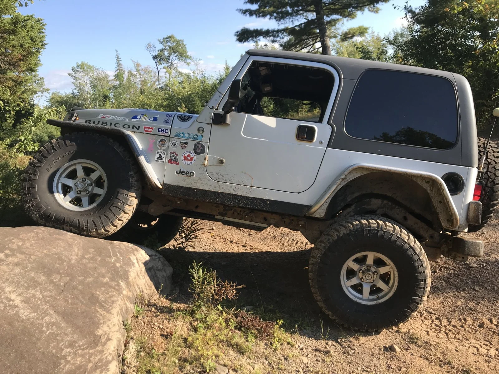

Today I went on a little solo run. This is my first time out since putting the new tires on, changing the rear springs and installing the MML and BL.

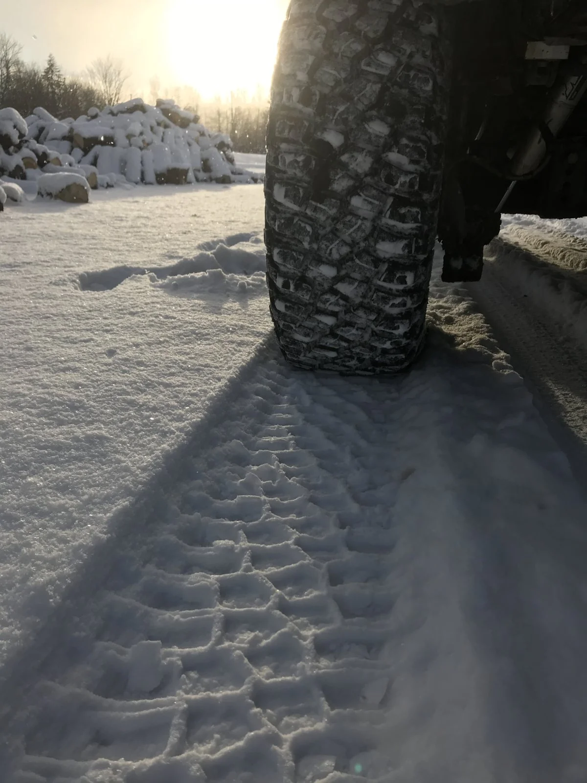

First impressions with the tires: I can't believe how much smoother they were compared to the 33's. I went to my normal 10psi, but these just handled the bumps and small rocks way better. Much smoother ride!
The Rough Country rear springs I got from a friend also made a big difference. They are WAY stiffer than the Crown Vic springs I had in there, and now when I come down off of something, I'm not hitting the bump stops just about every time. It would bounce before, and the rear end would go down a lot. Now it's nice and controlled.

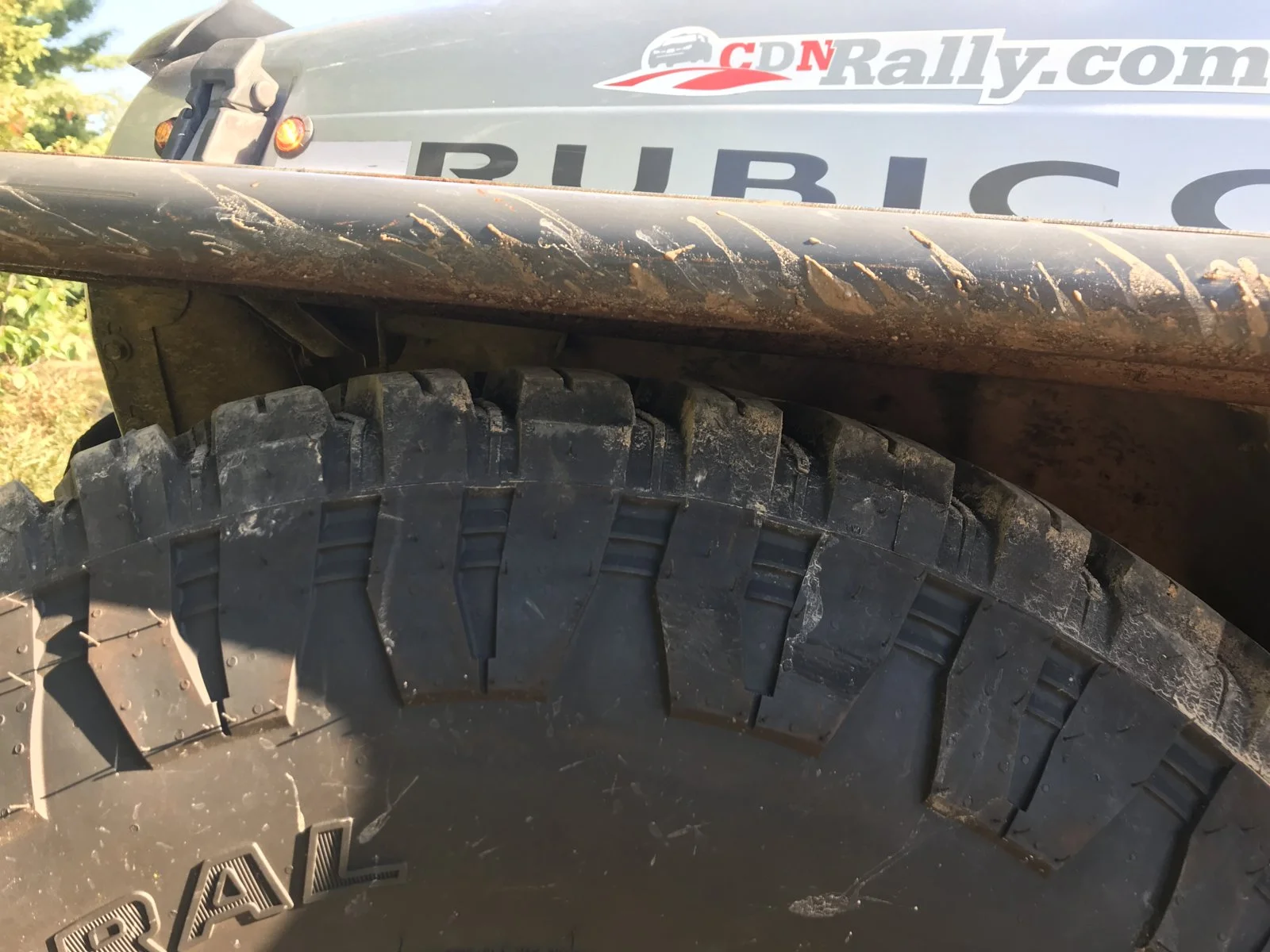

With the body lift, the tires clear perfectly. I also properly adjusted the rear bump stops when I changed the springs, and they're pretty much spot on now. So overall I'm very happy with everything!

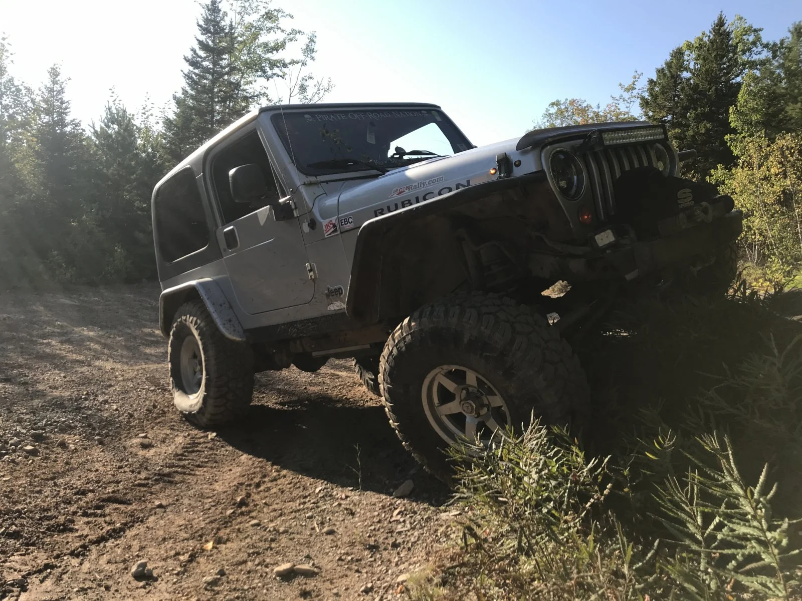

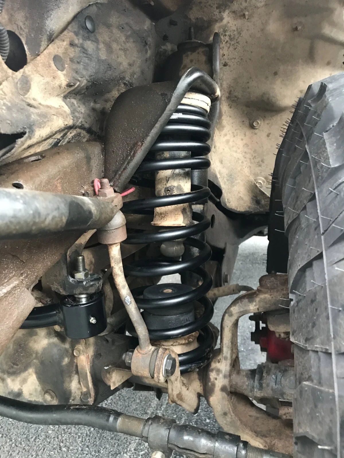

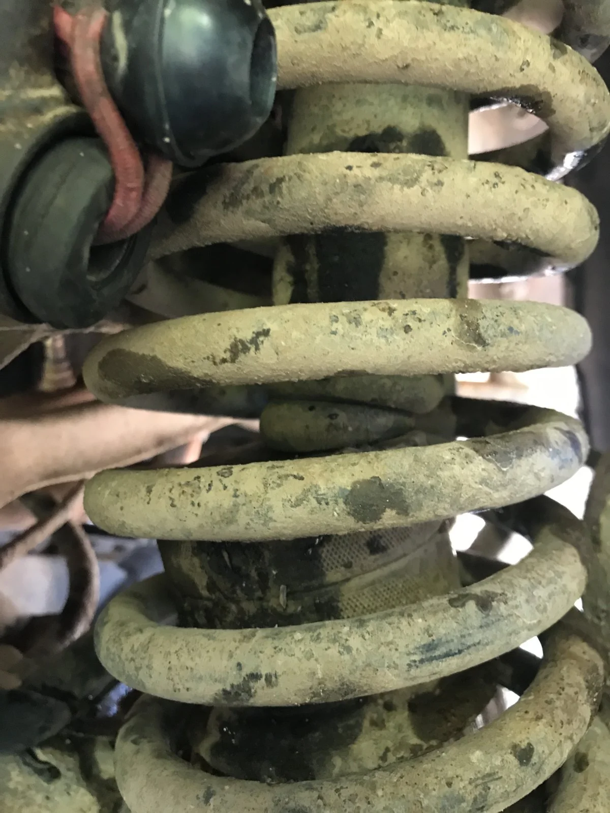

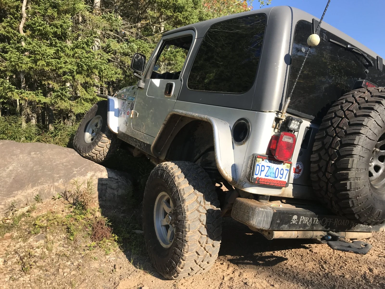

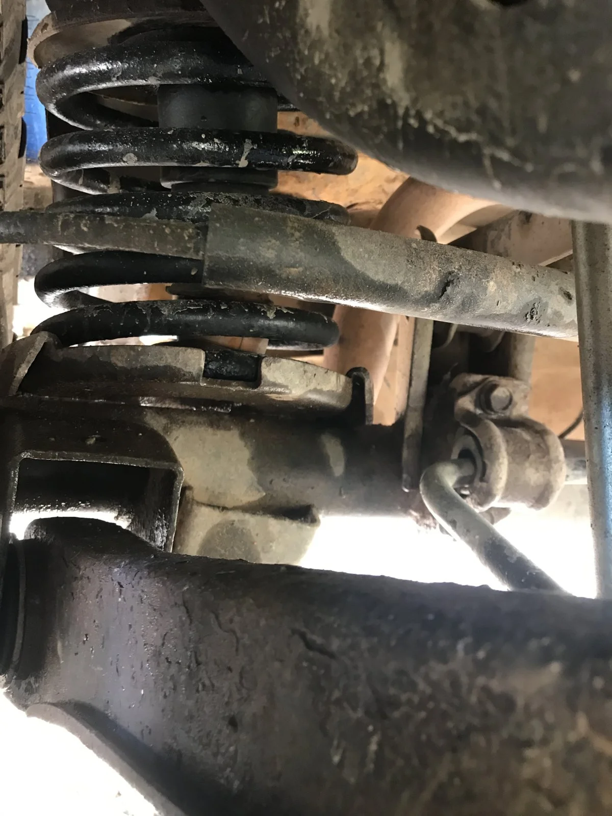

Front bump stop at full compression.
View attachment 55498 View attachment 55499
Not fully stuffed, but close.
View attachment 55500 View attachment 55501 View attachment 55502 View attachment 55503 View attachment 55504

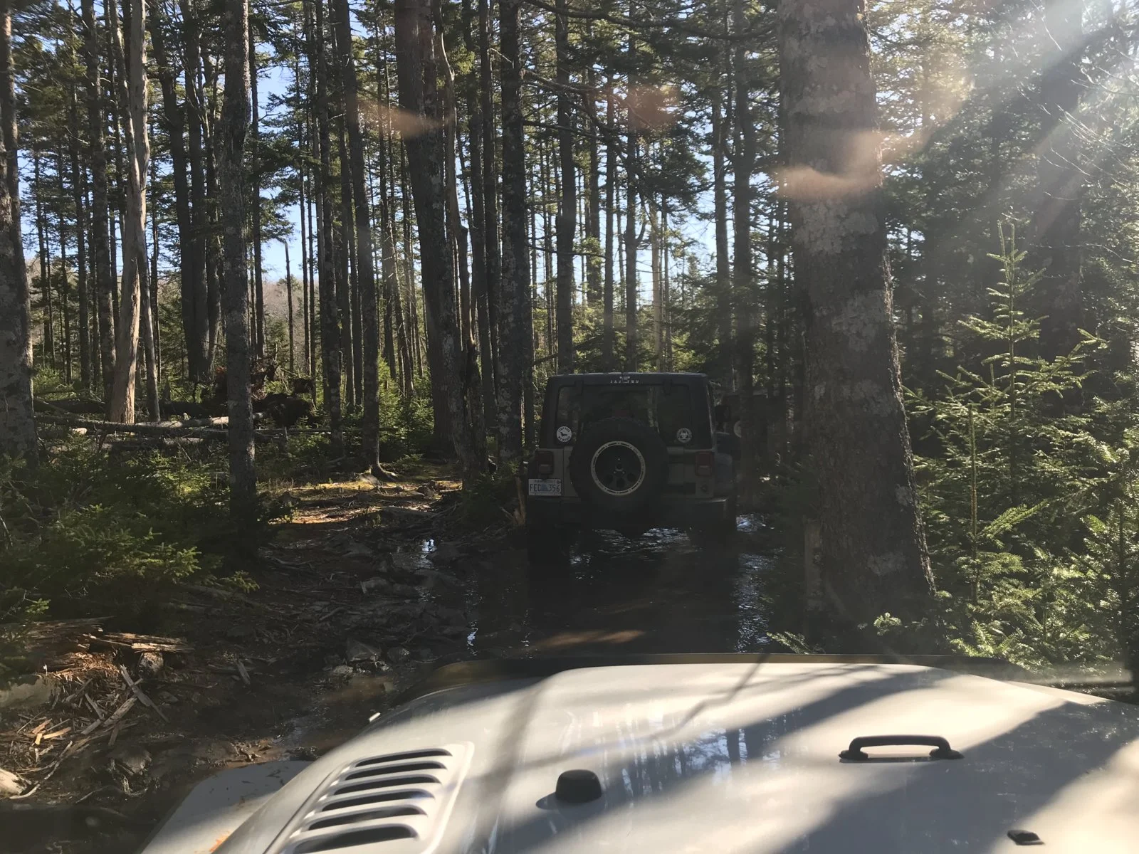

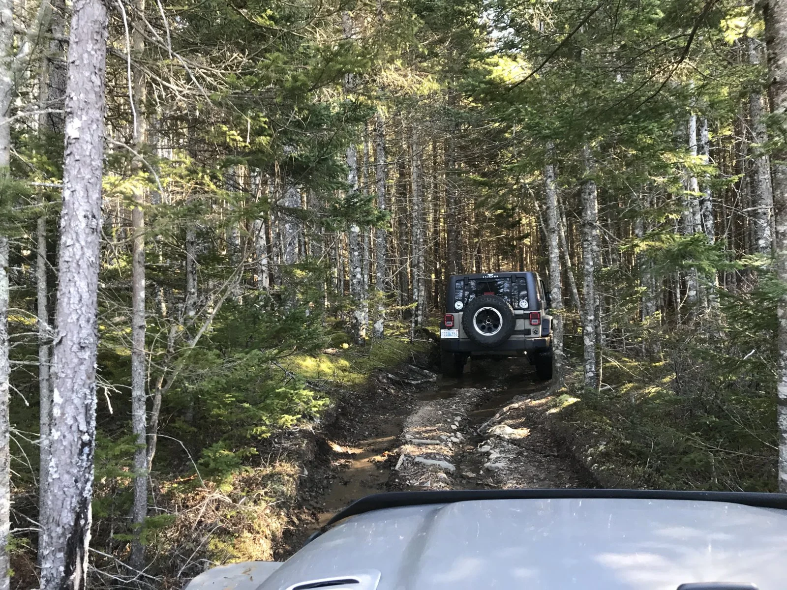

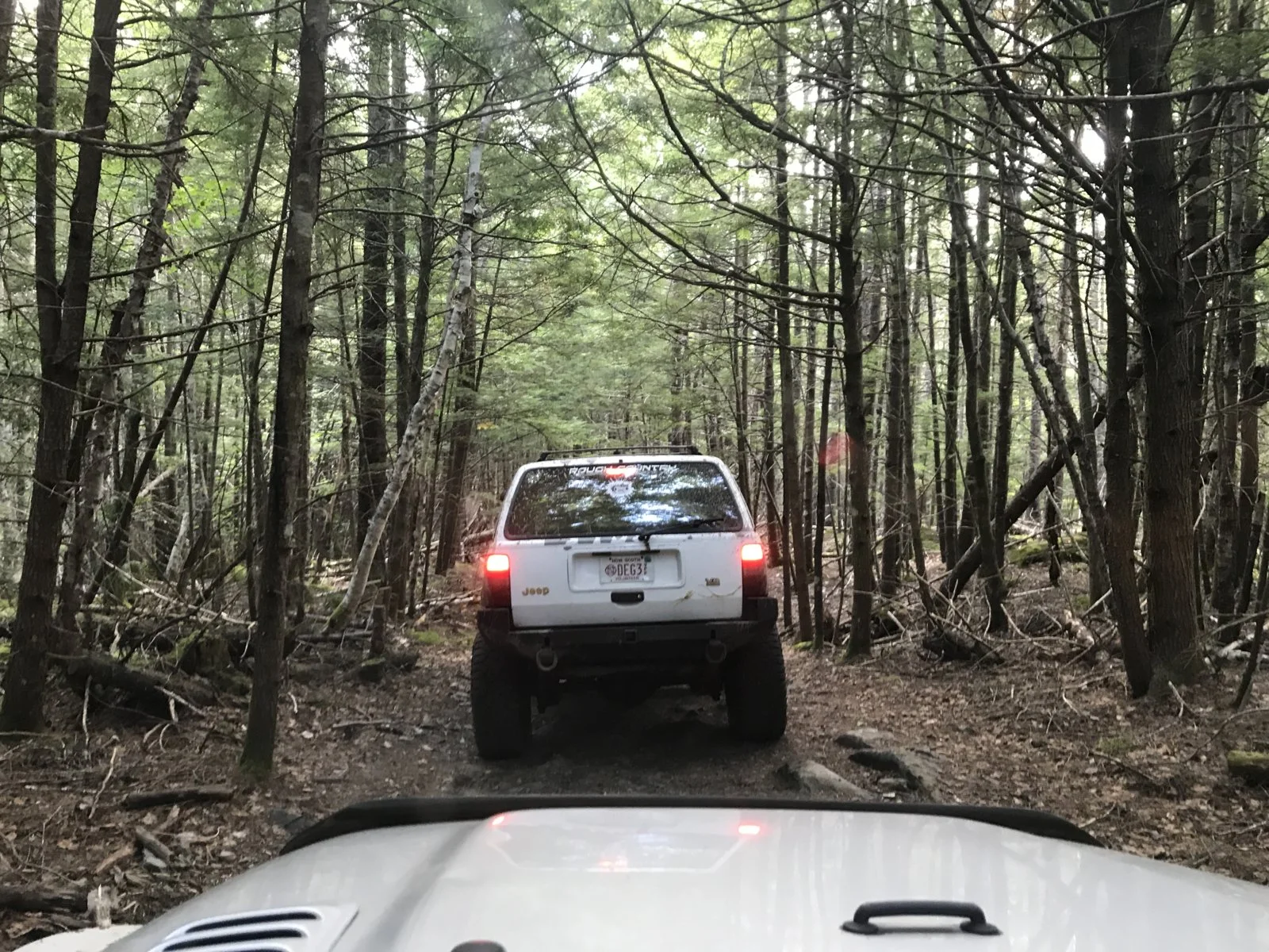

Just some pics from the drive.
View attachment 55505 View attachment 55506 View attachment 55507

I like this build. 4.75” overall Lift, 35’s. Skid, it’s really coming together. Nice job. Something to aspire too

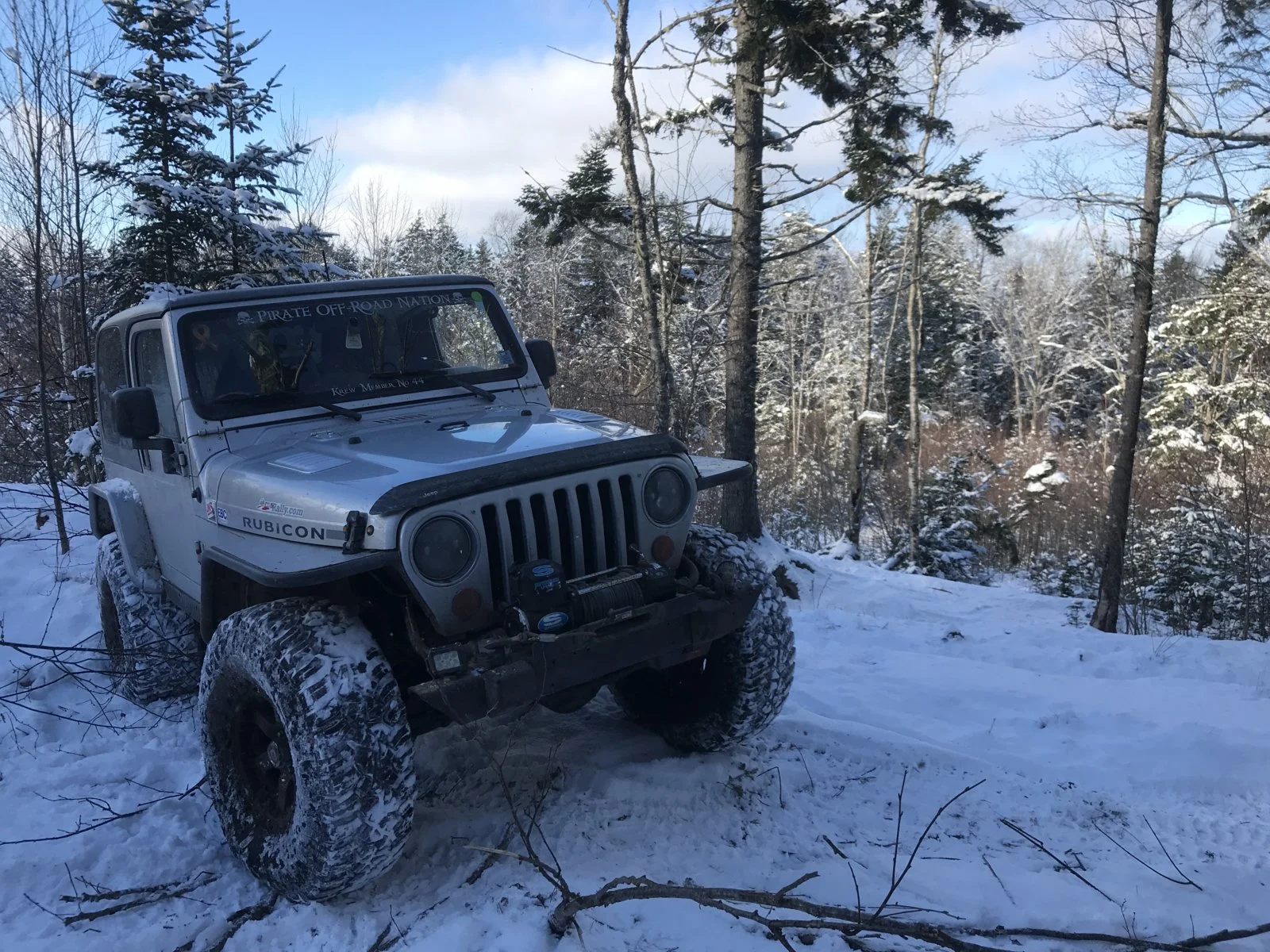

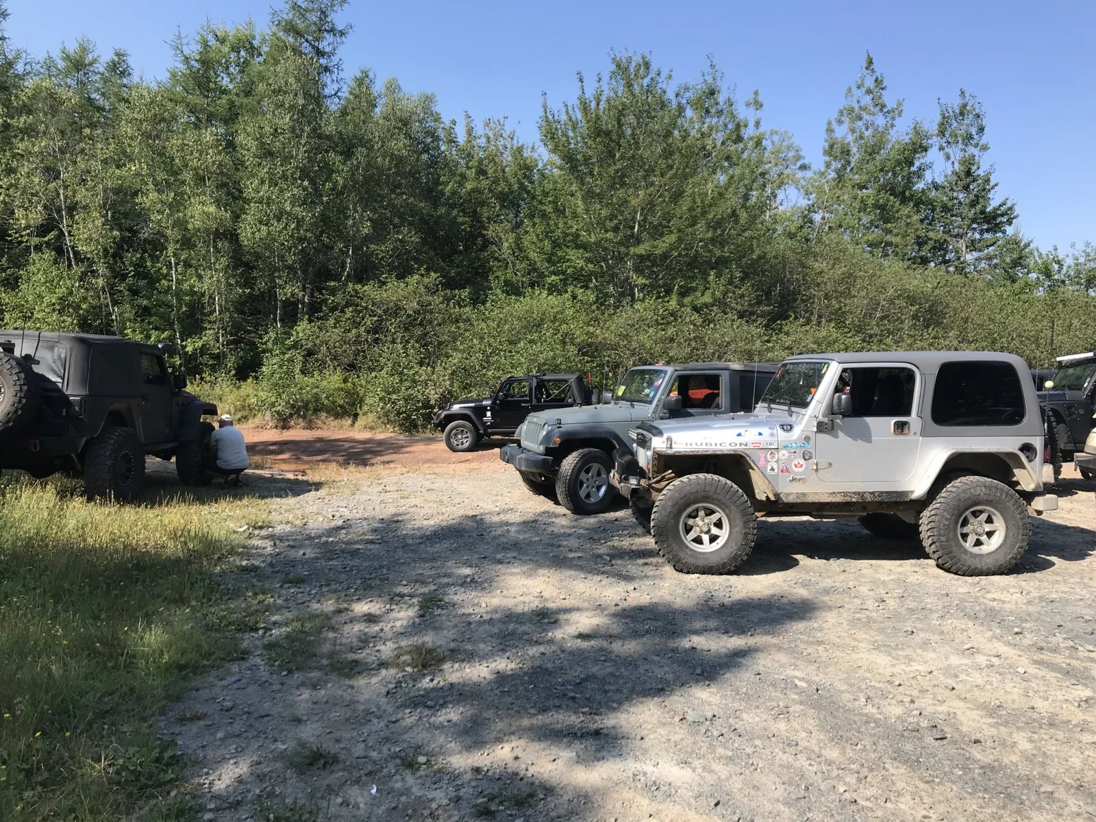

Yesterday I went out with the Jeep Club for a little run, and got to test it out pretty good. Super happy with it. No real wheeling pics, but here are some to look at.

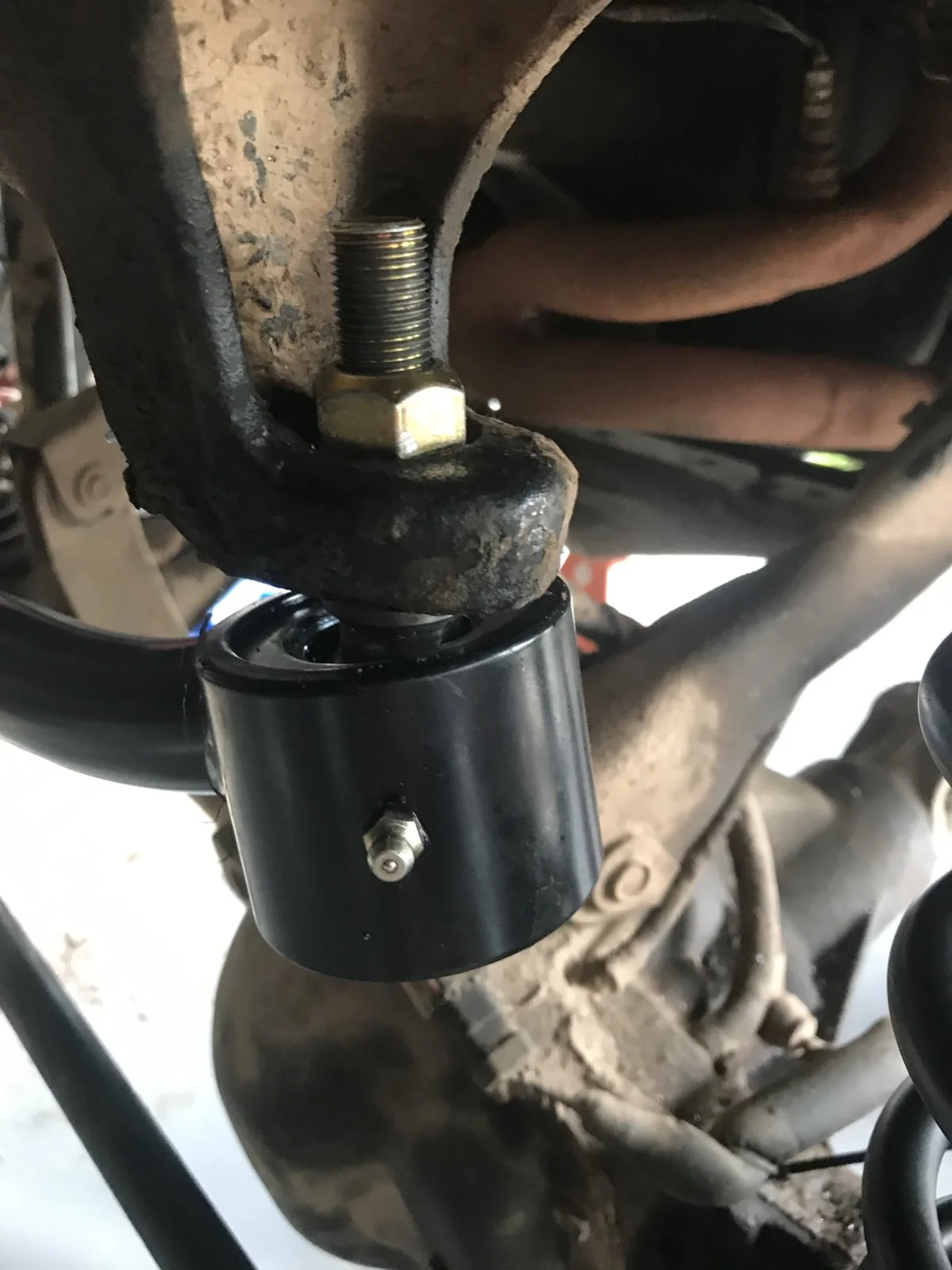

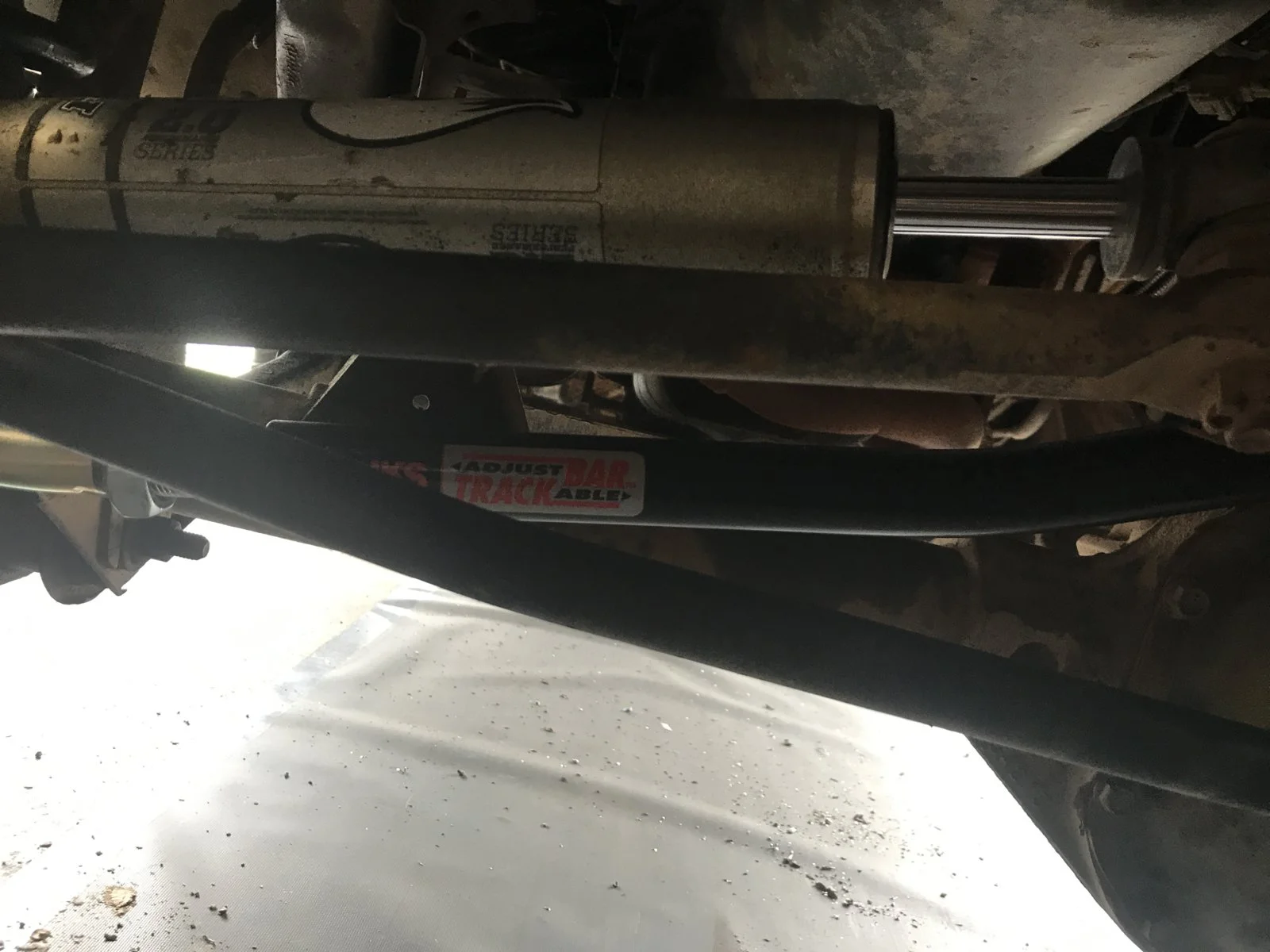

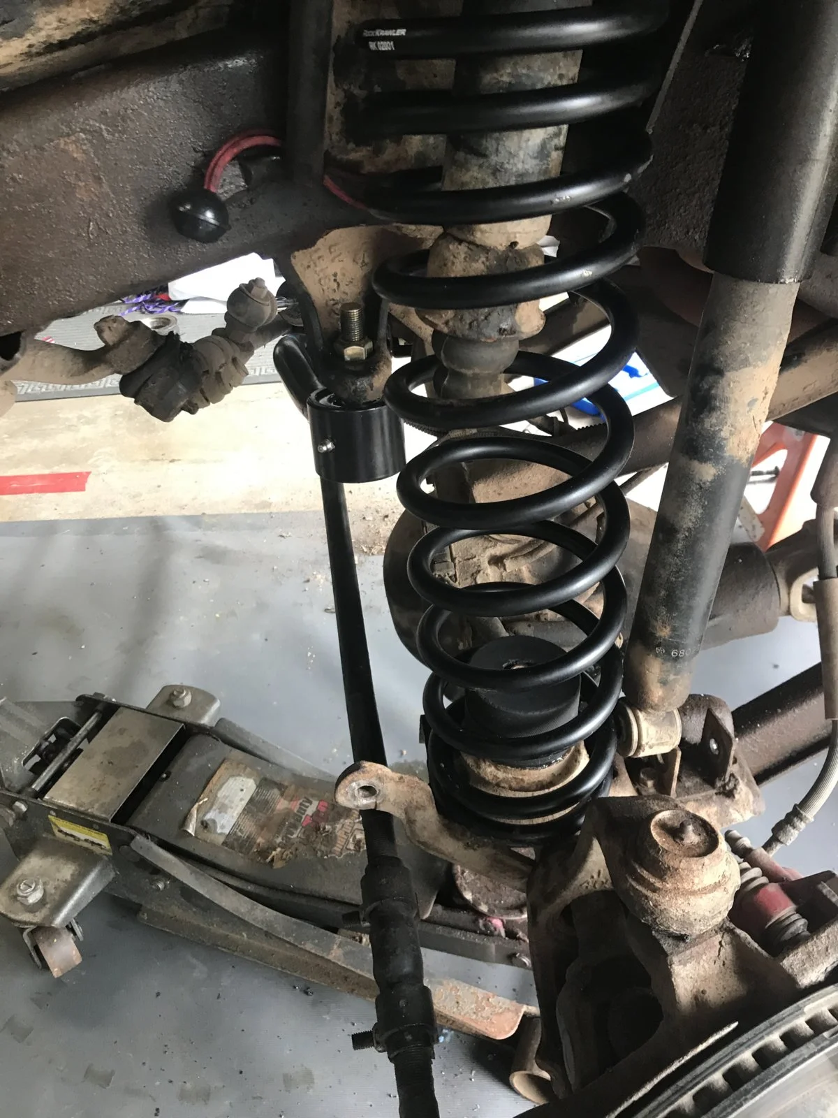

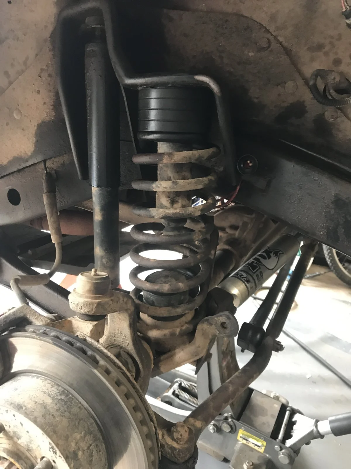

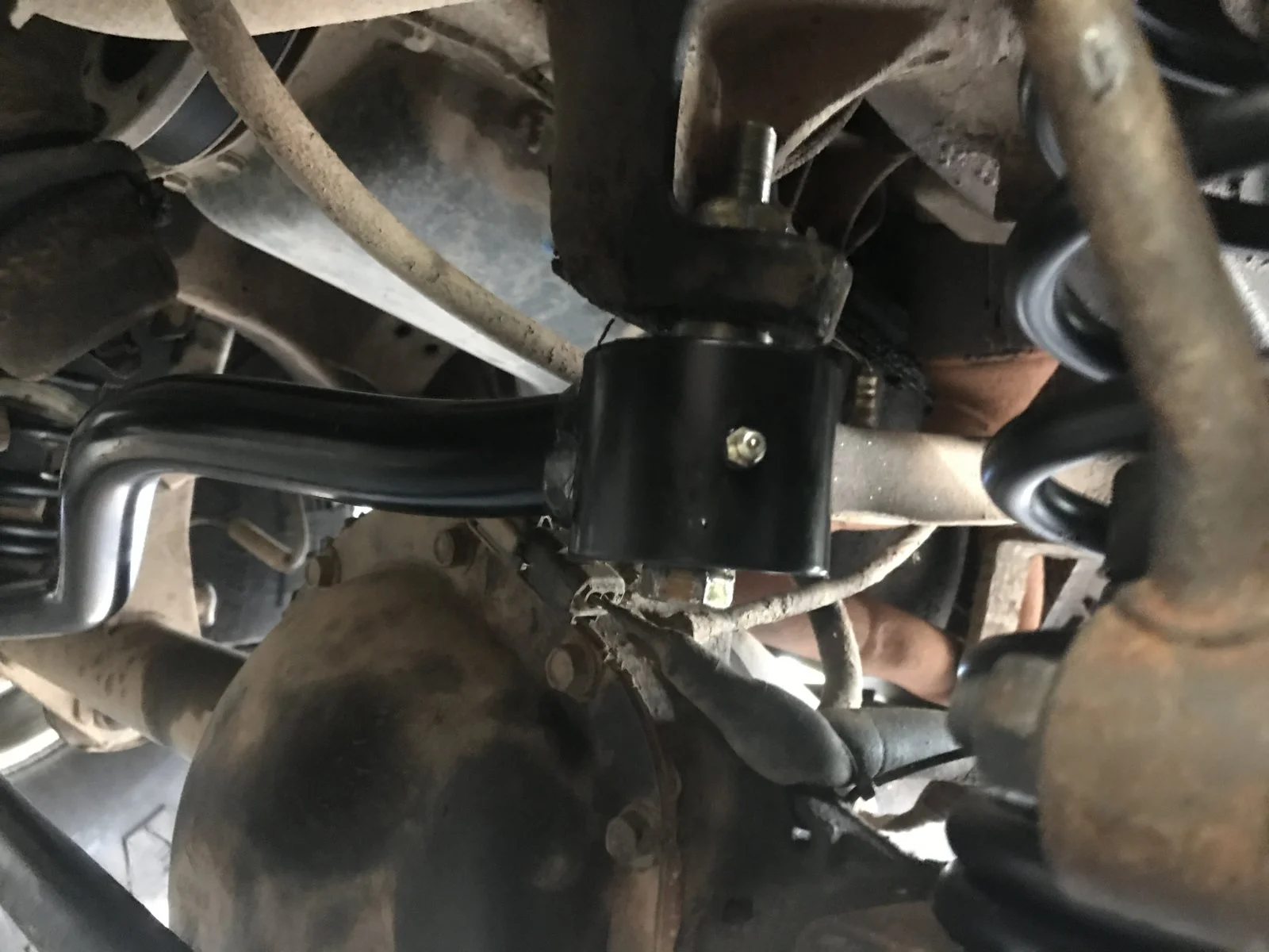

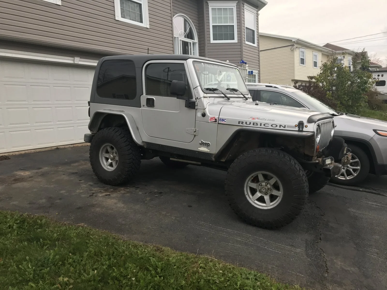

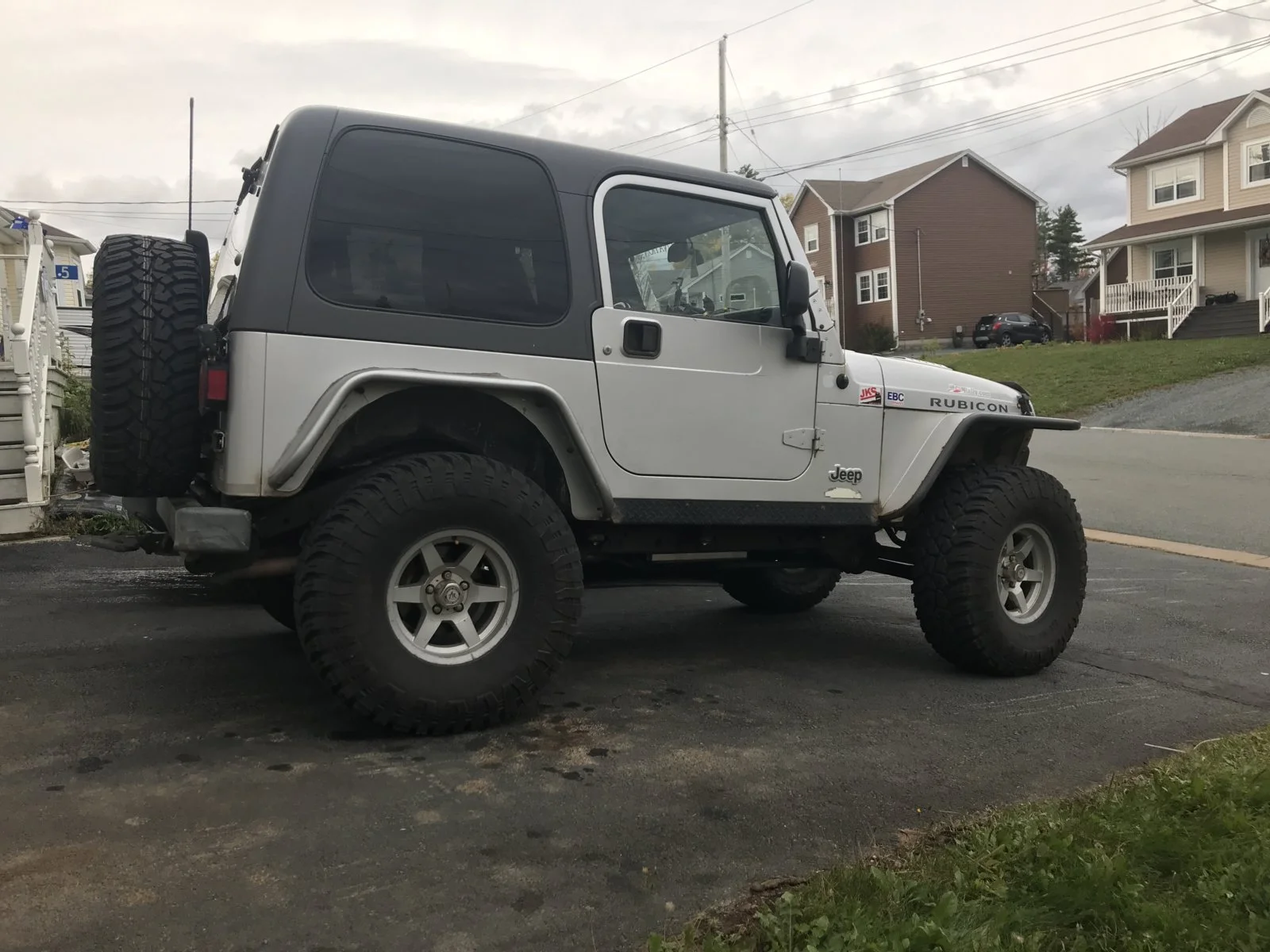

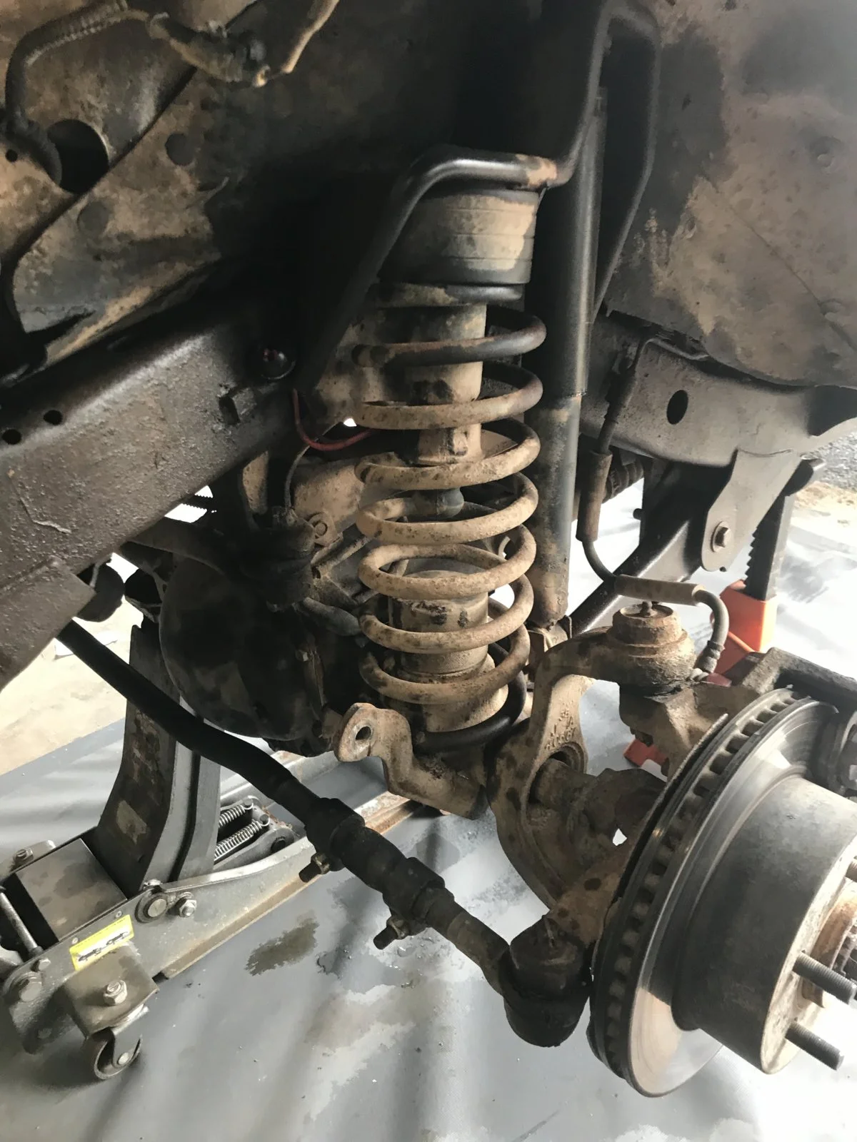

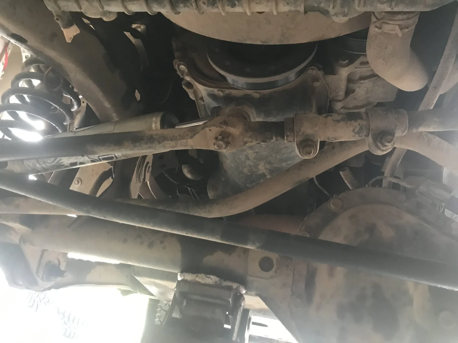

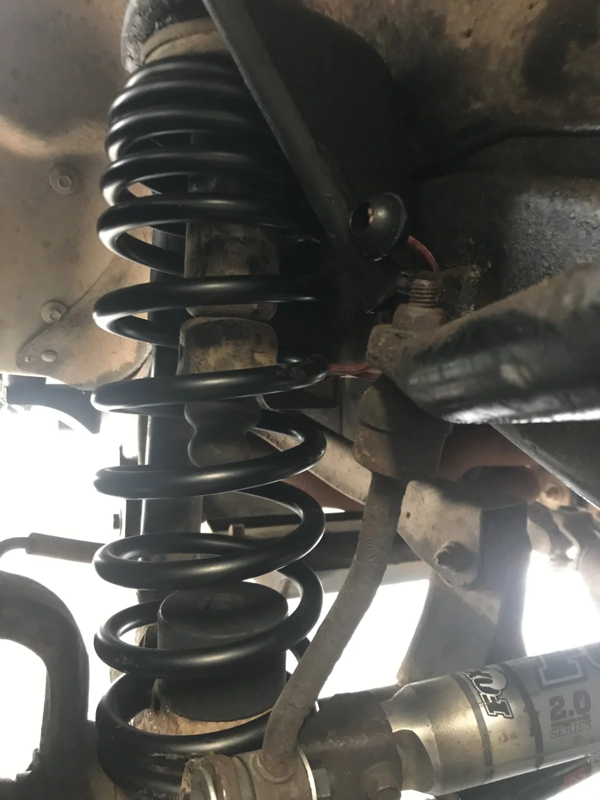

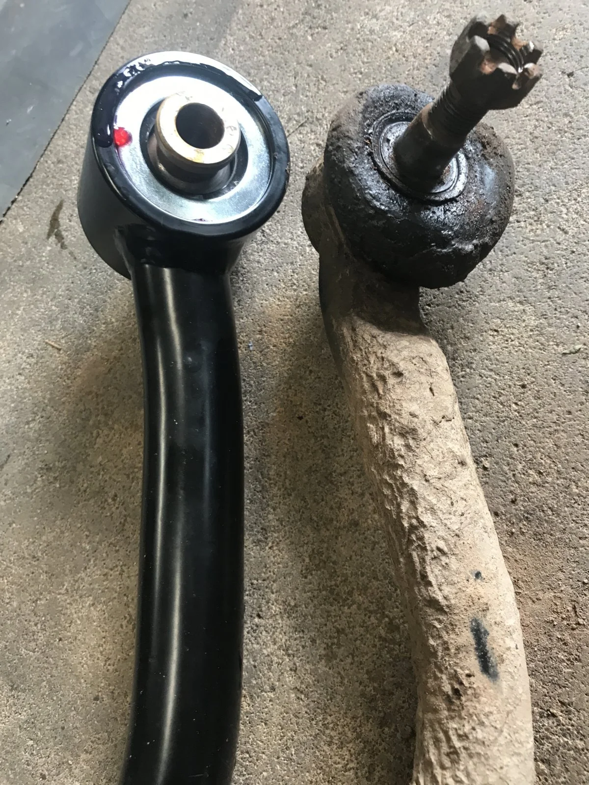

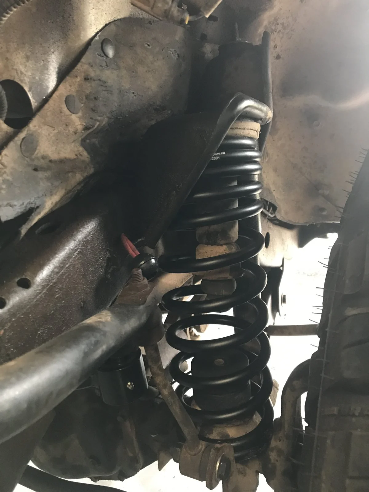

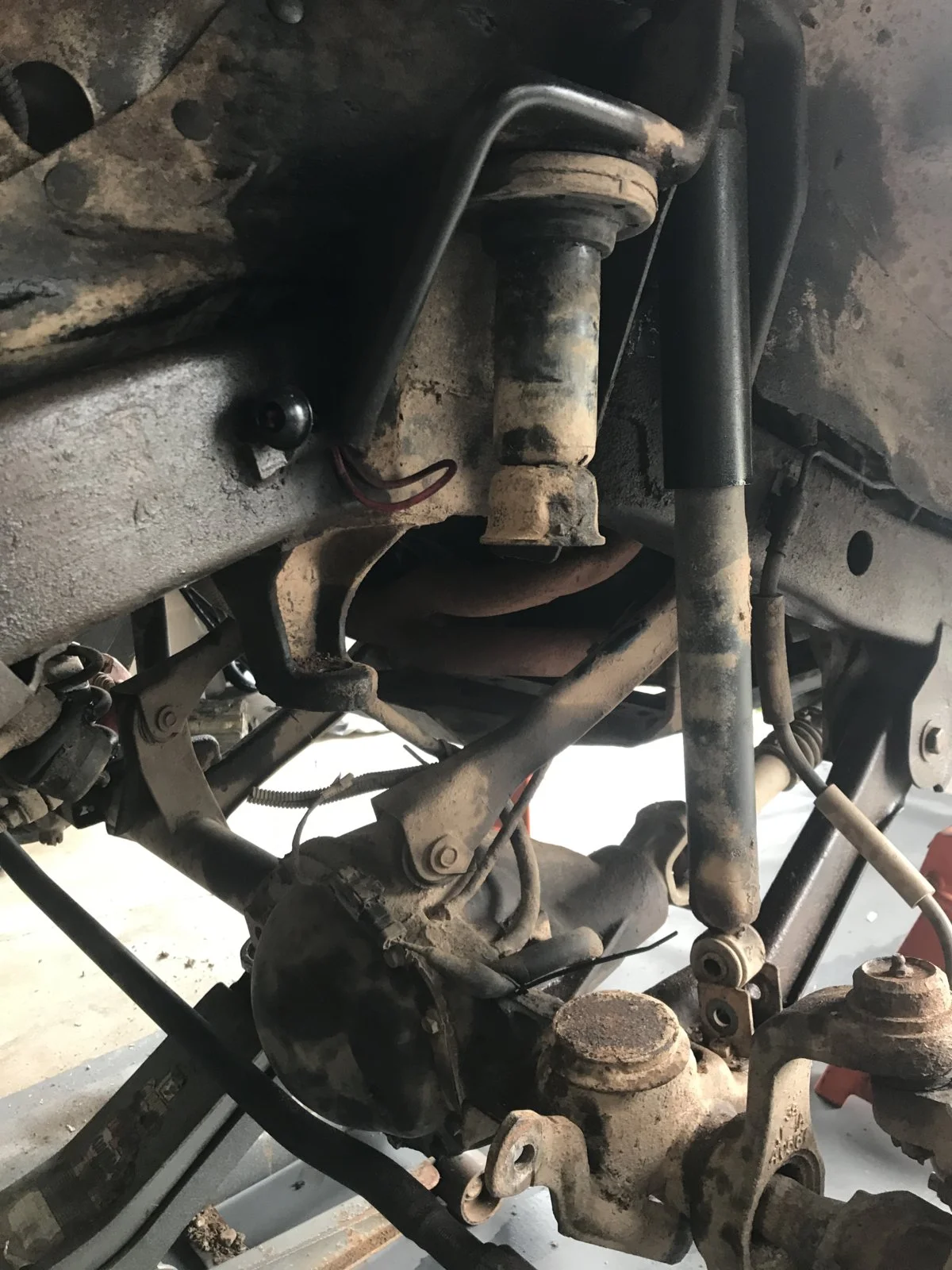

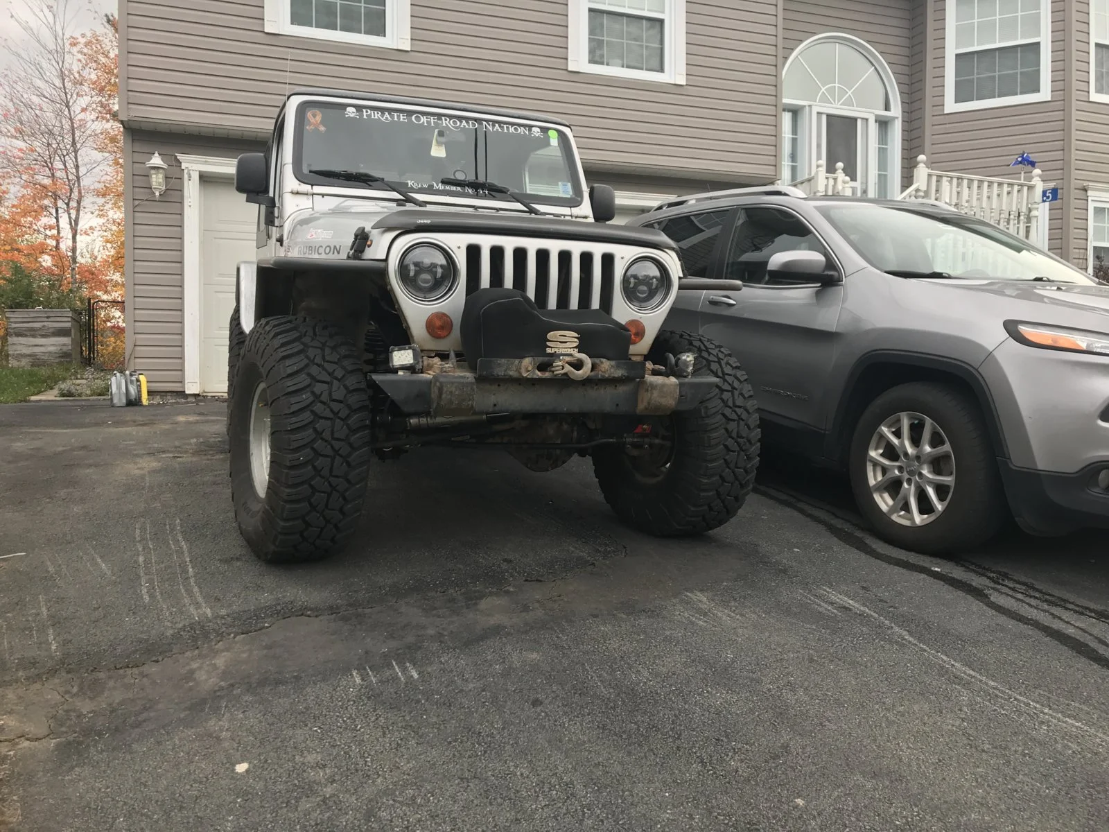

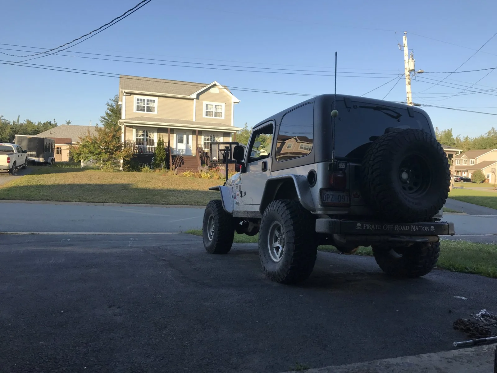

Today I was able to get my new Rock Krawler 3.5" Triple Rate coil springs in the front and install my JKS track bar.
Old 2" spacer and V8 ZJ springs:

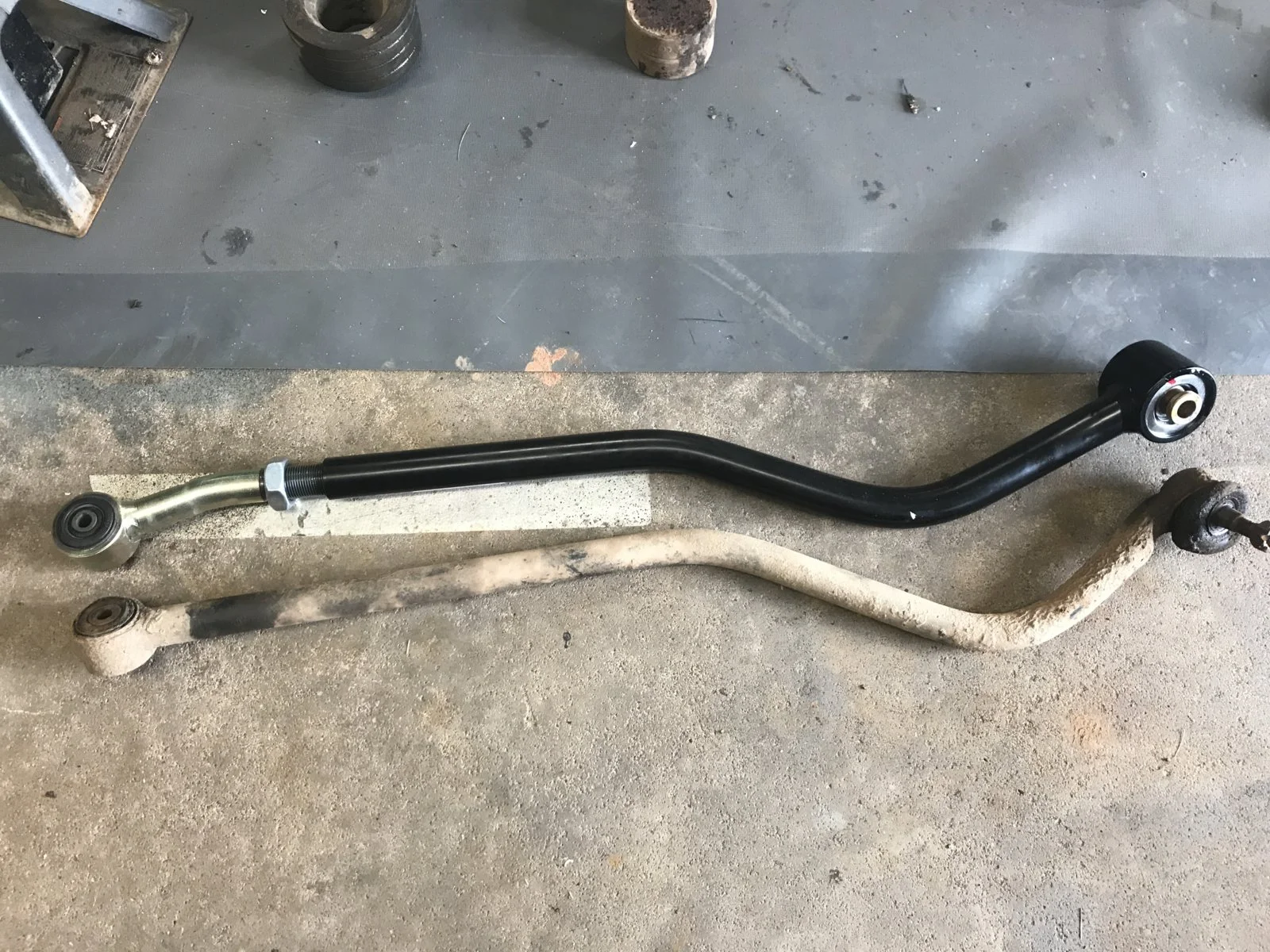

Stock track bar:
The picture doesn't show just how much beefier the JKS track bar is!
Springs, spacers and track bar out:
Getting it put back together:
Jacking the axle up on the drivers side gave plenty of room to get the drill in to drill the hole out:
Everything is put back together, just doing a final check to make sure I didn't miss anything:

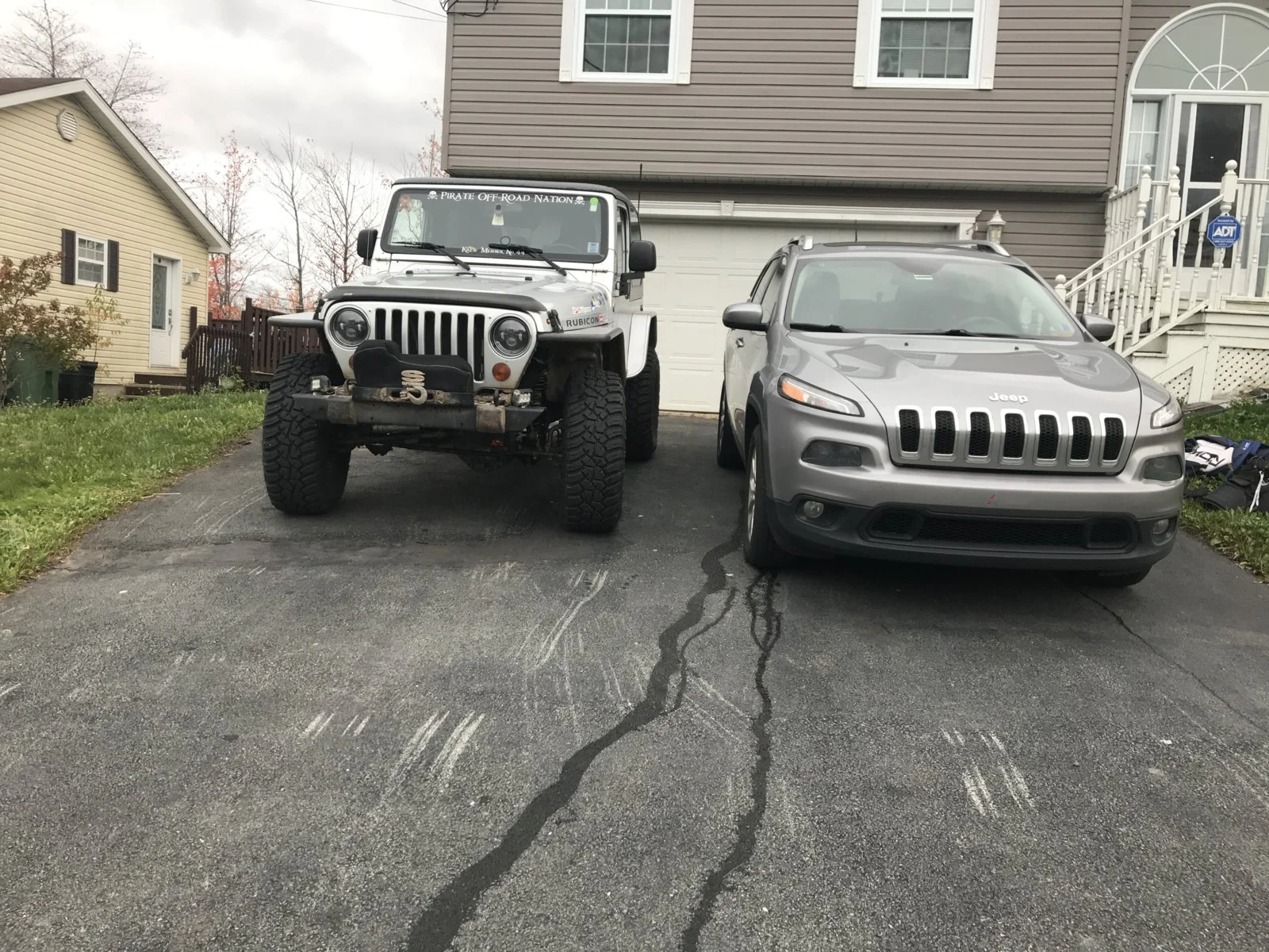

Sitting next to the wifes Fiat, lol:
Stock track bar:

How much lift did you get out of the new springs? Looks good!
Not being critical, but wondering, are some extended sway bar links, quick discos or ARock in your future?
I like your rig.
Reactions: derekmac
I like your rig.
Thanks! They gave just a hair under 4", and I expect they'll probably settle to 3.5".
Oh yes, I definitely need to get rid of the stock sway bar links. I'd love an ARock, but that won't be in the budget for a while. I'll probably just get some cheap extended links for now.

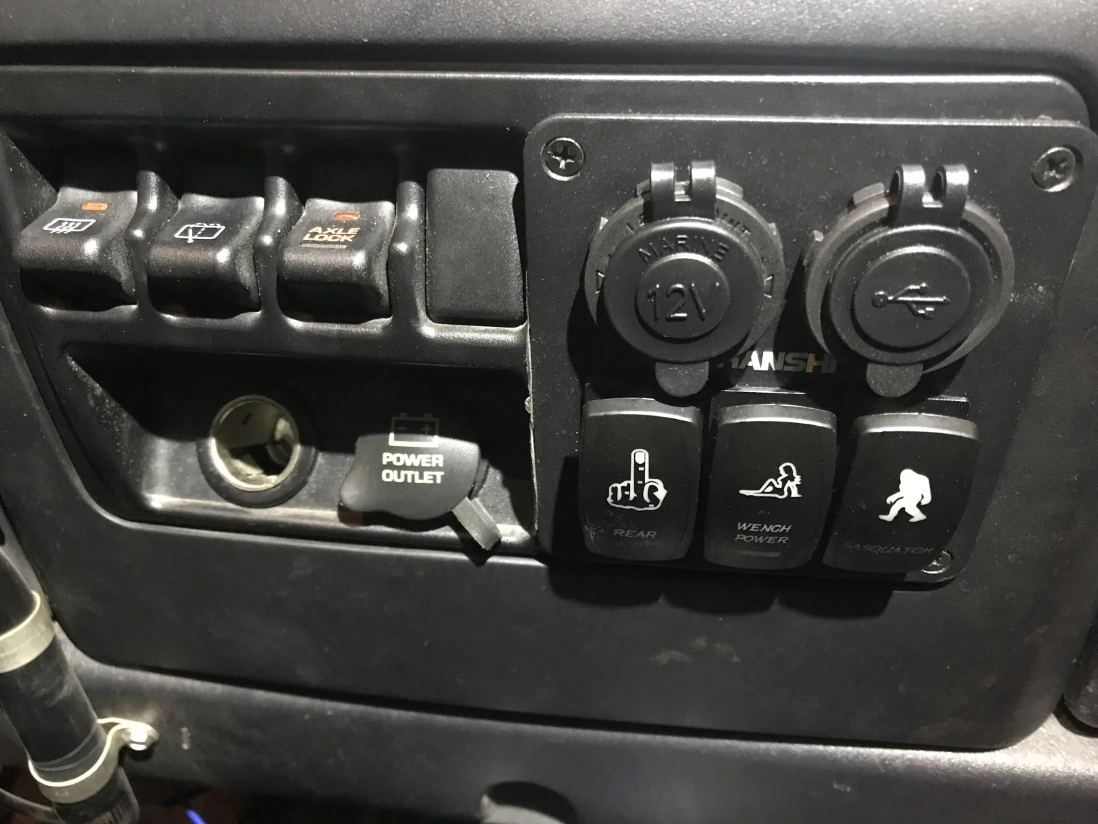

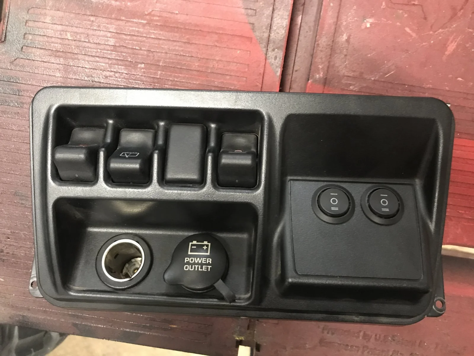

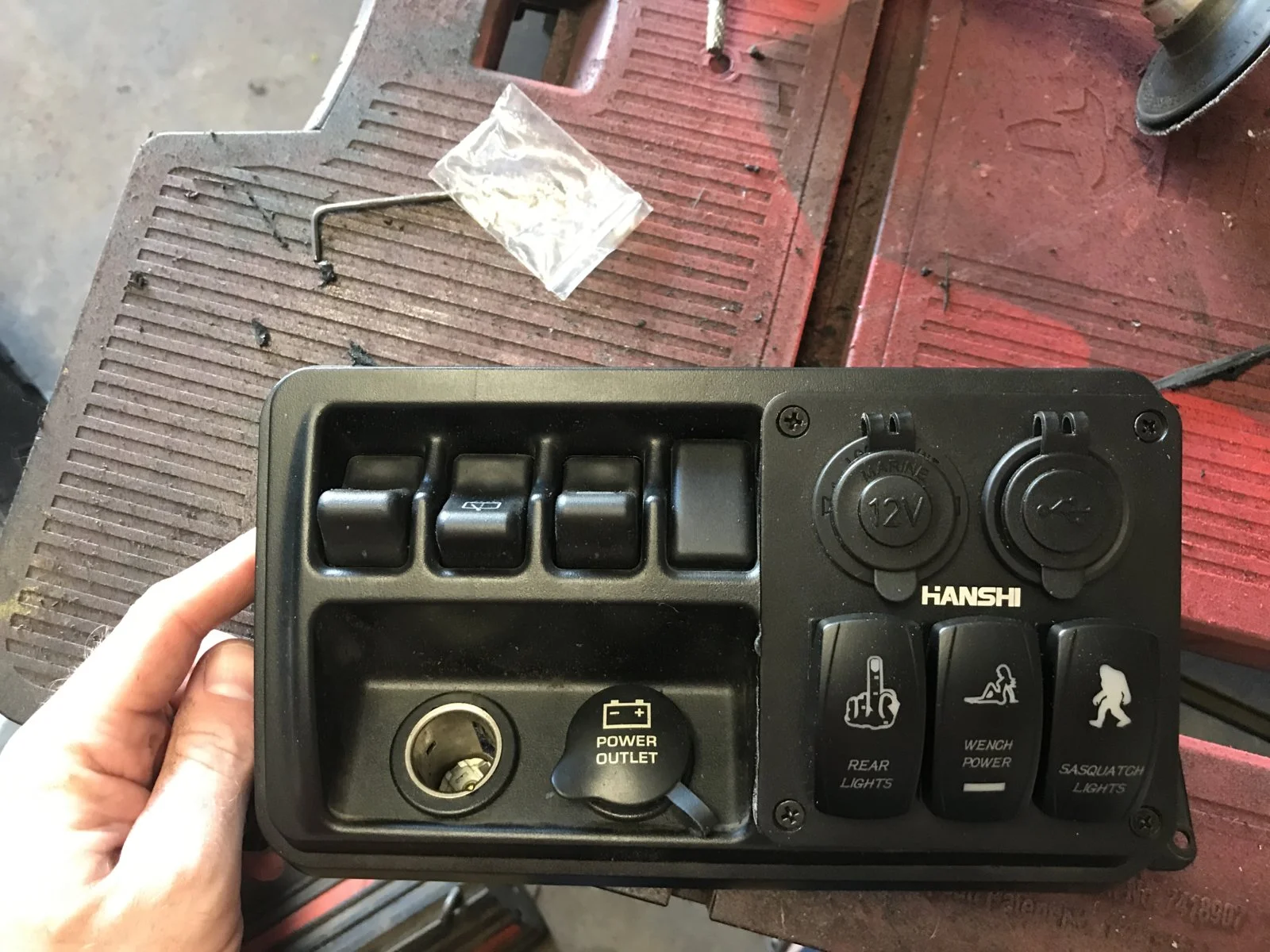

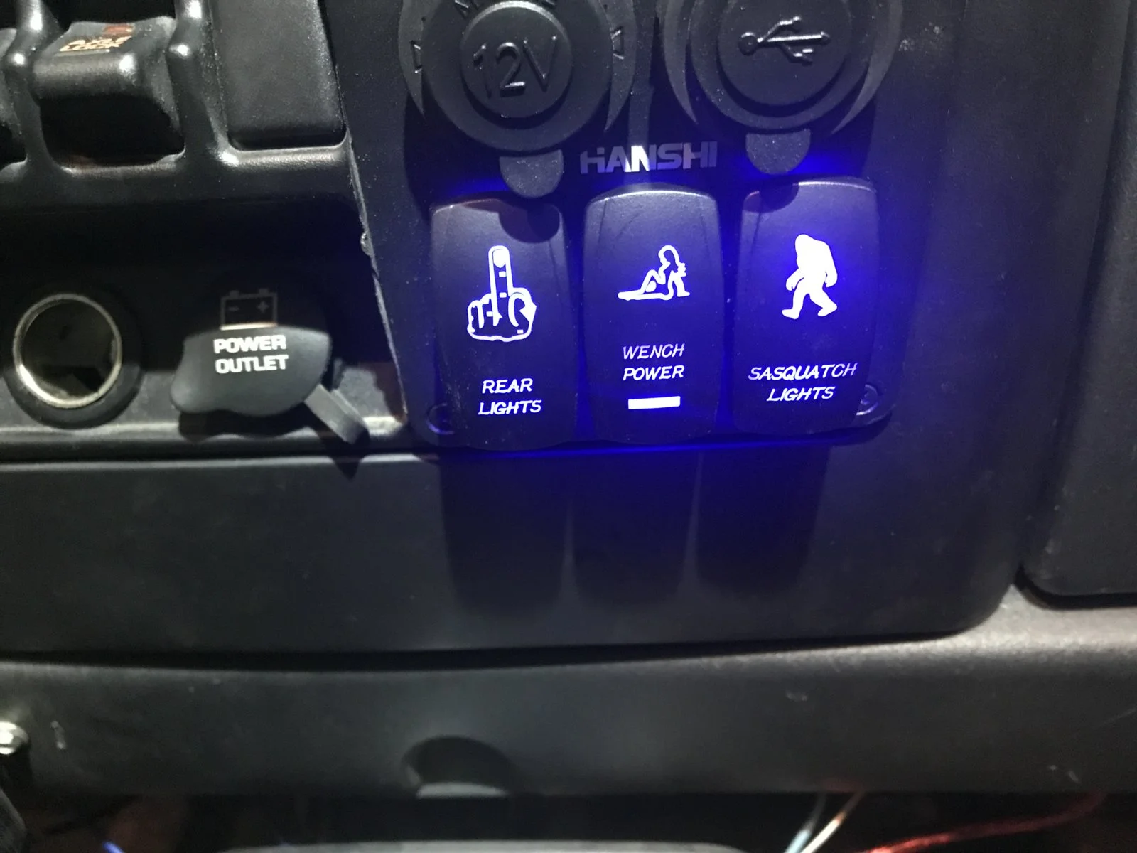

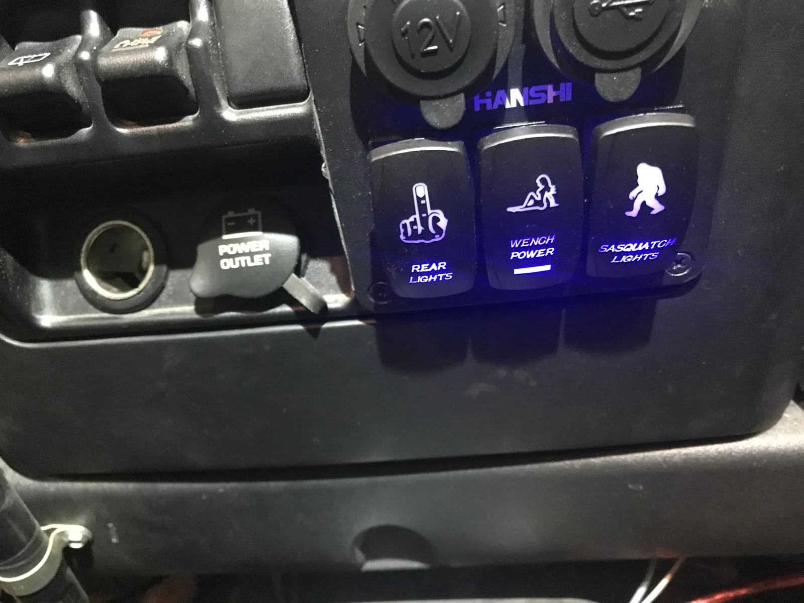

While I was waiting, I deceided to install a switch panel I bought on Amazon a while ago for $10.

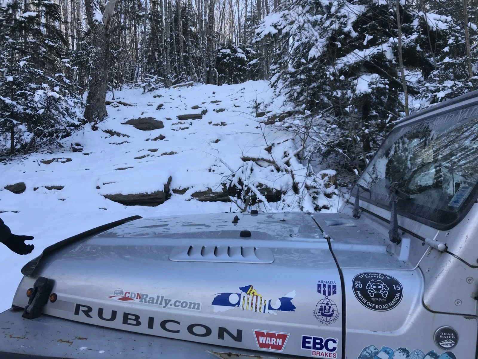

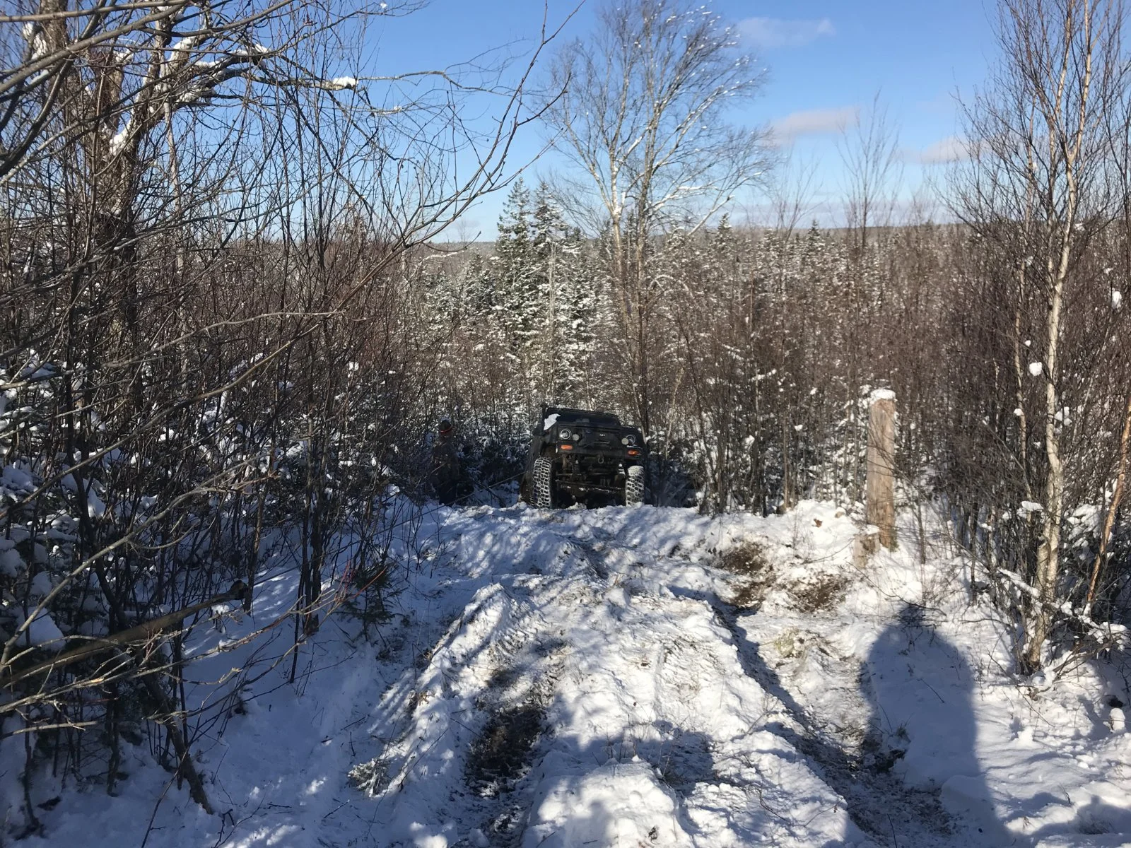

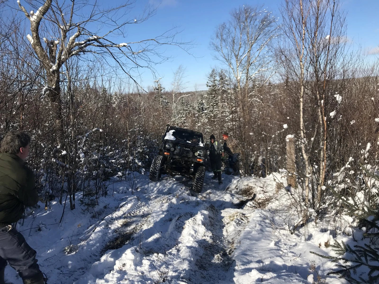

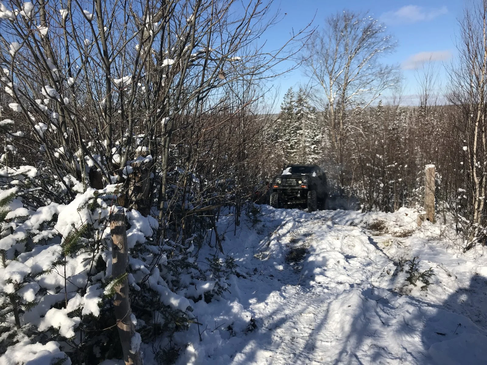

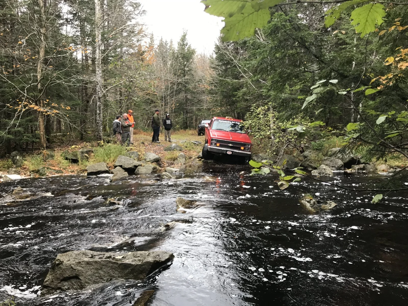

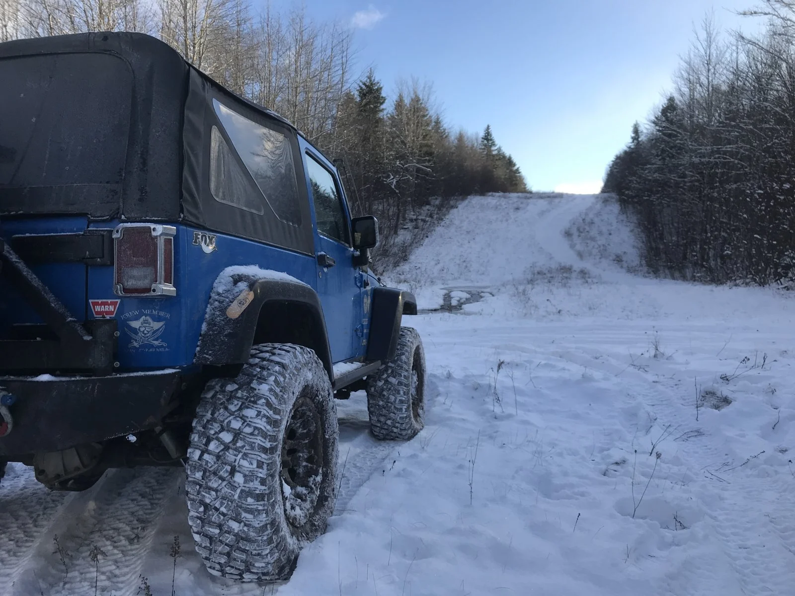

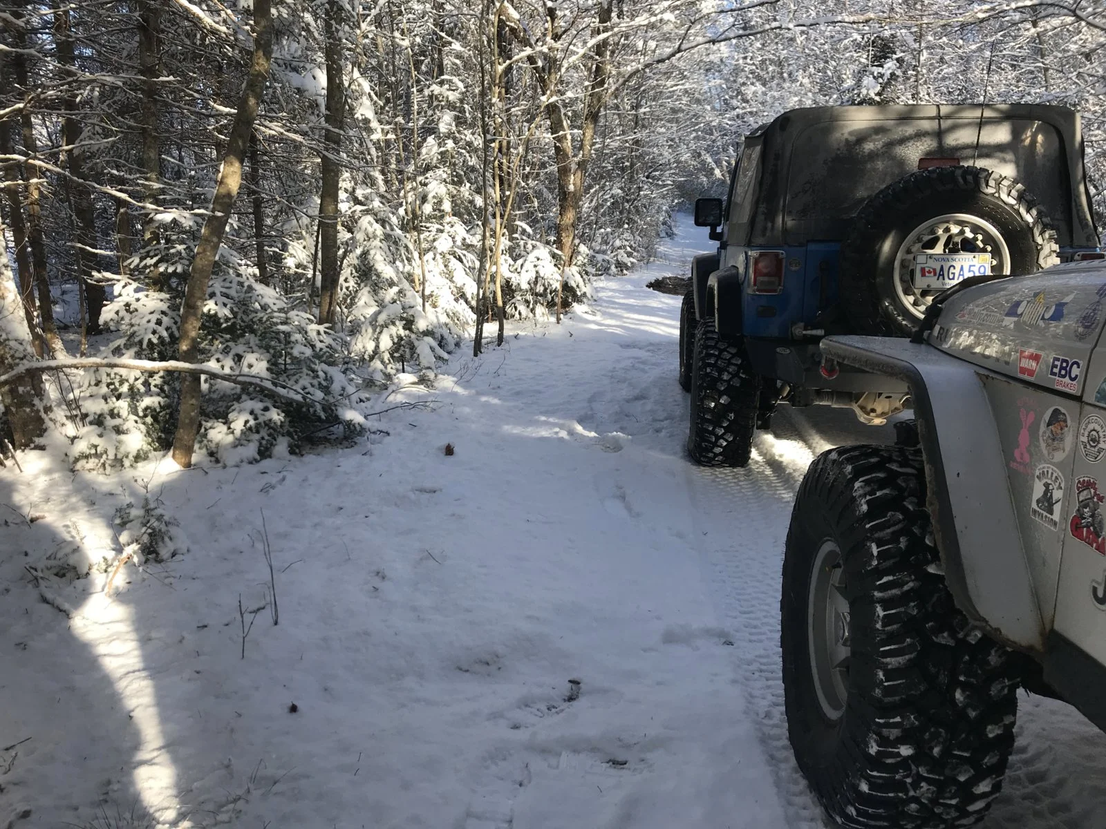

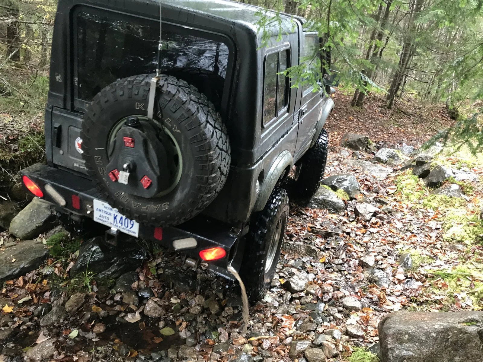

Went on a run yesterday. Did one trail that I haven't done in a few years, and two that I have never done. It was a great day of very tight wooded trails, which I just happen to love!

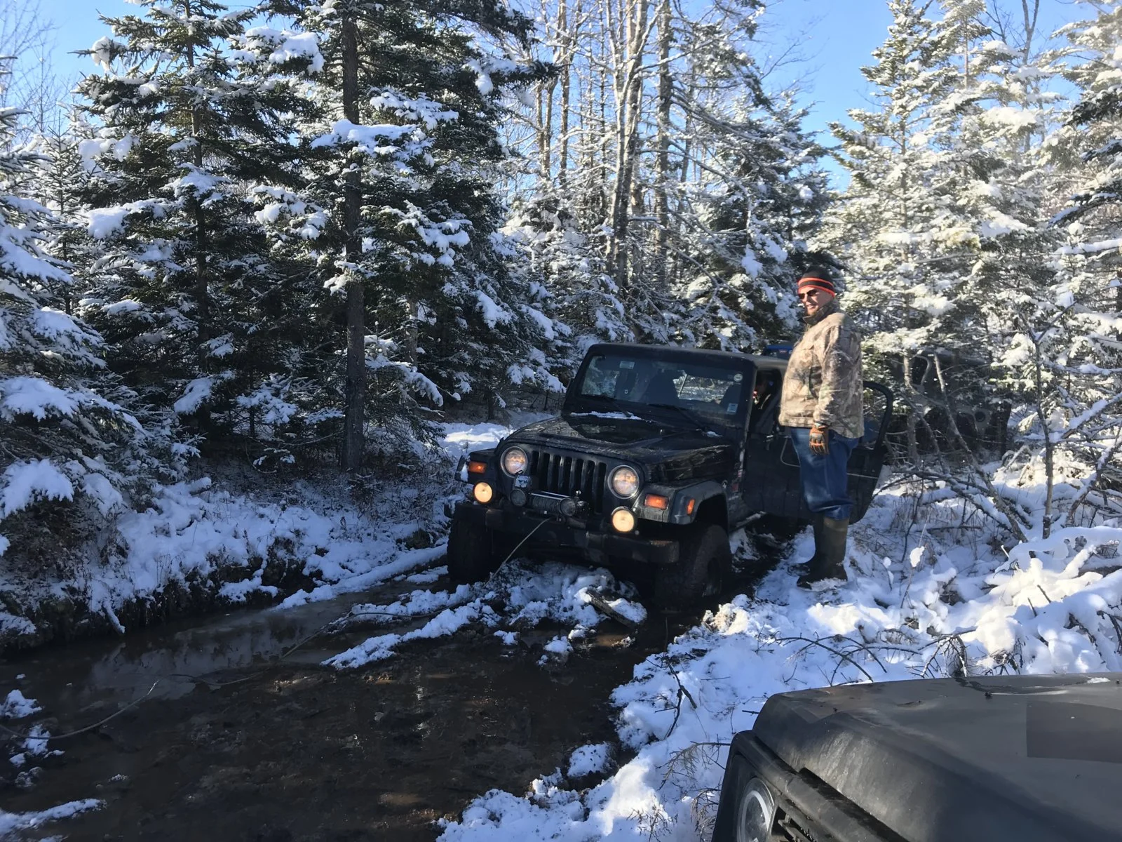

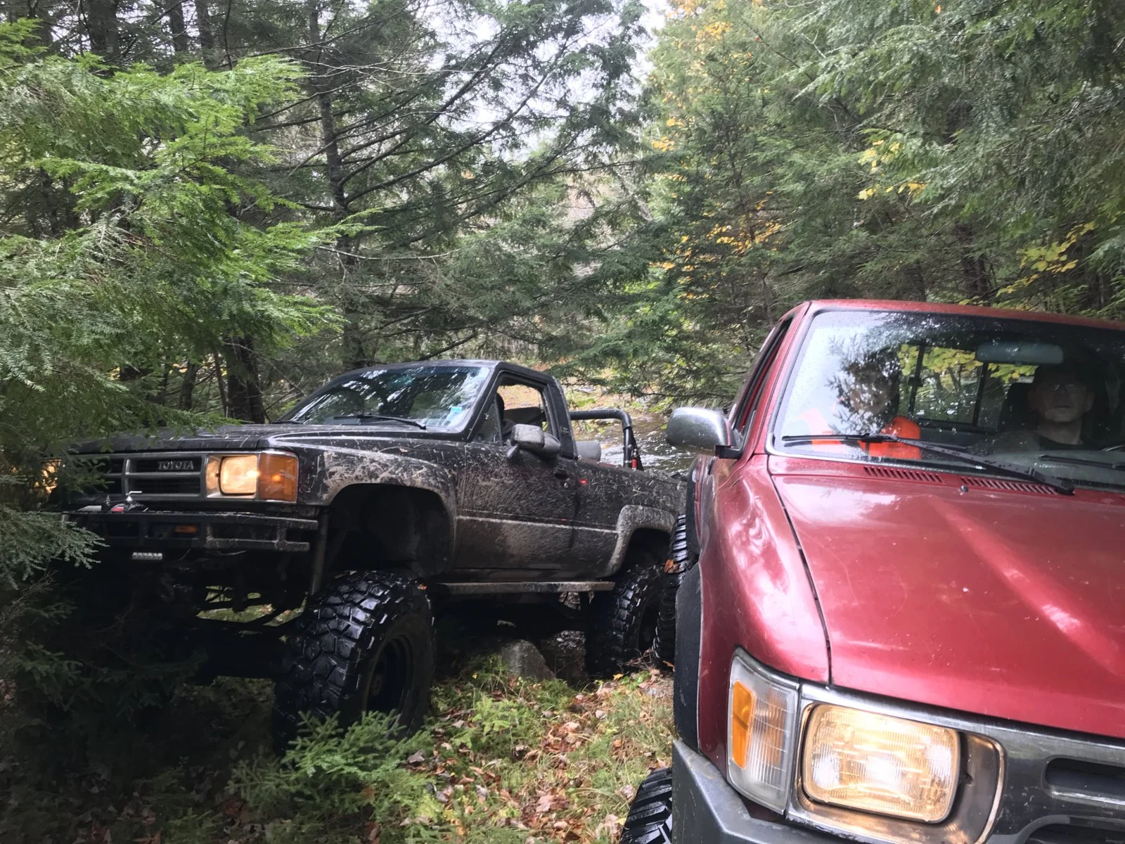

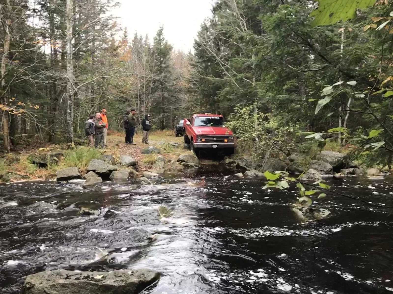

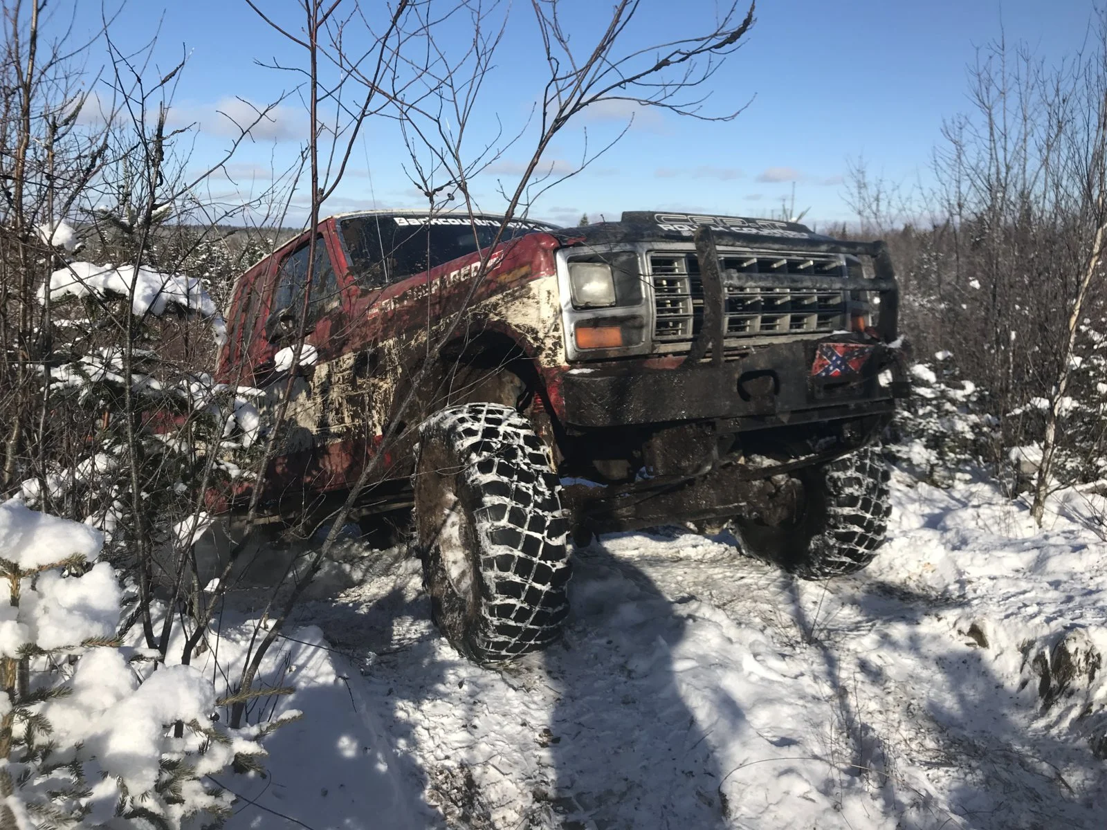

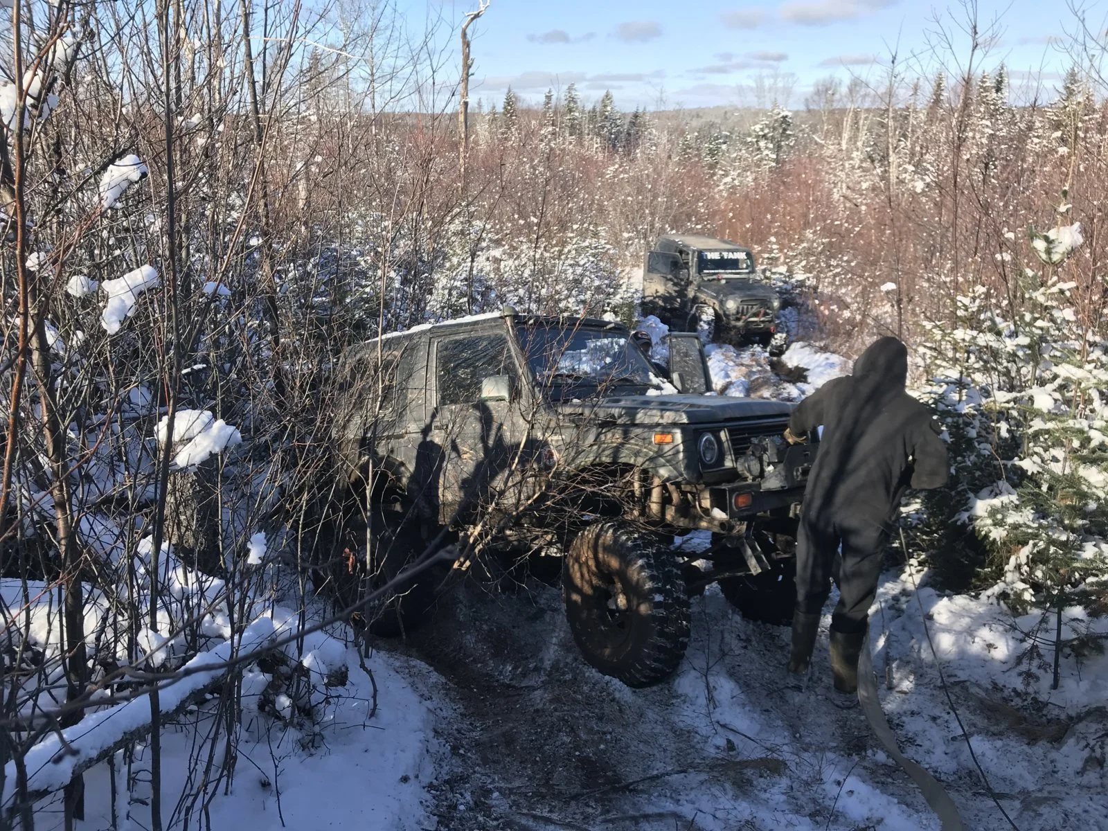

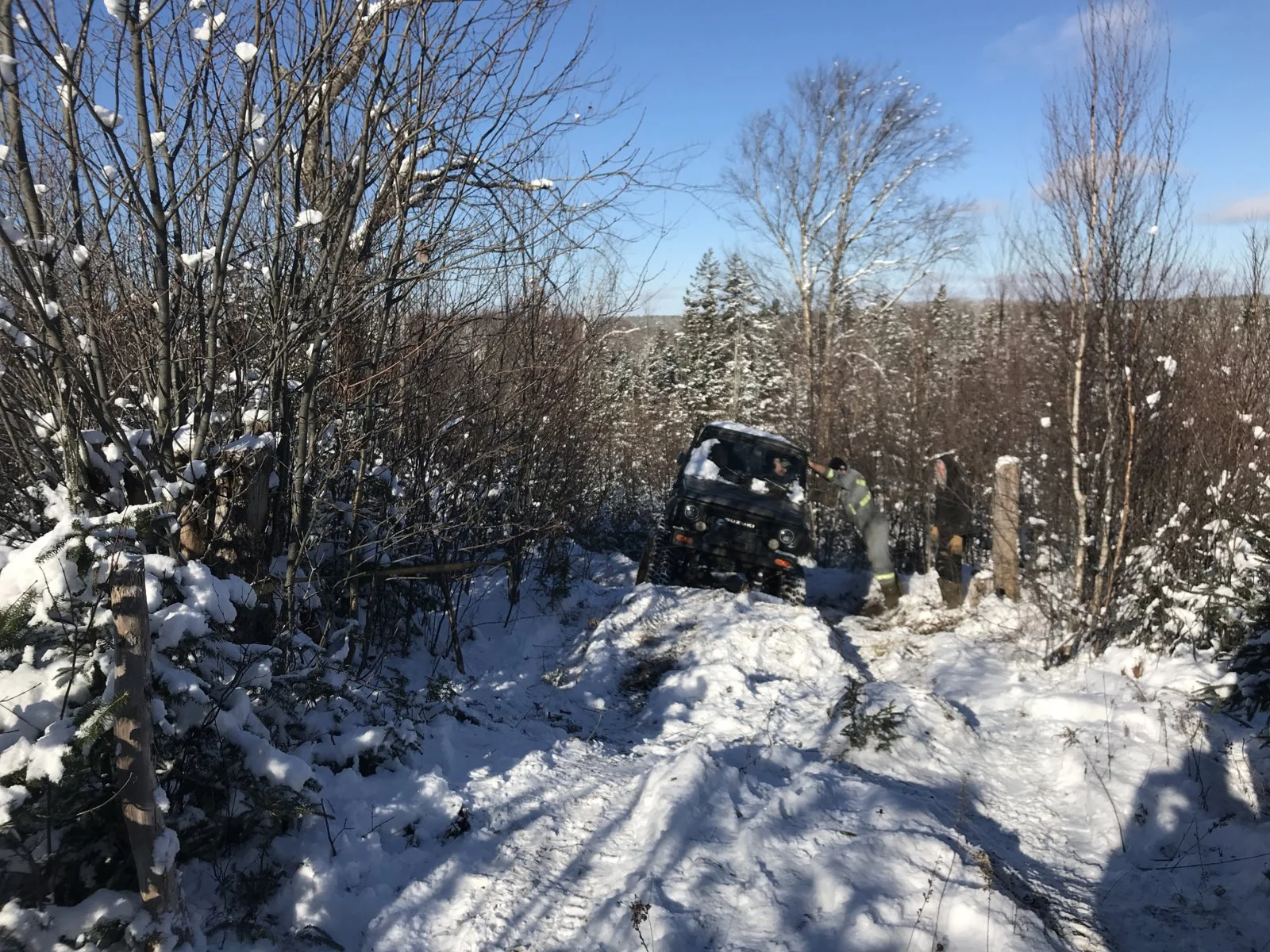

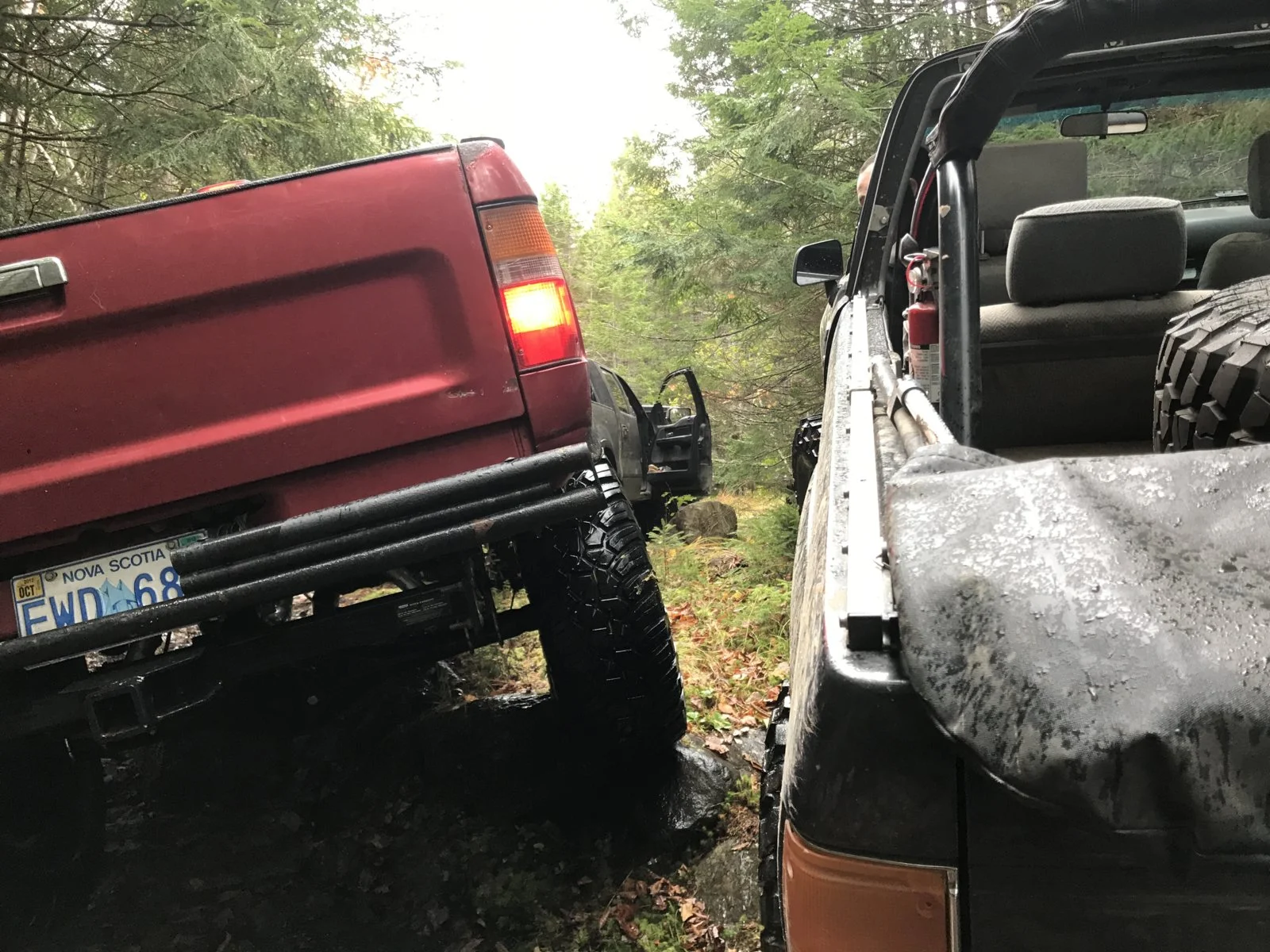

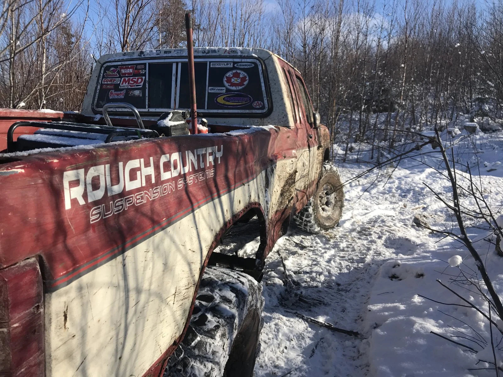

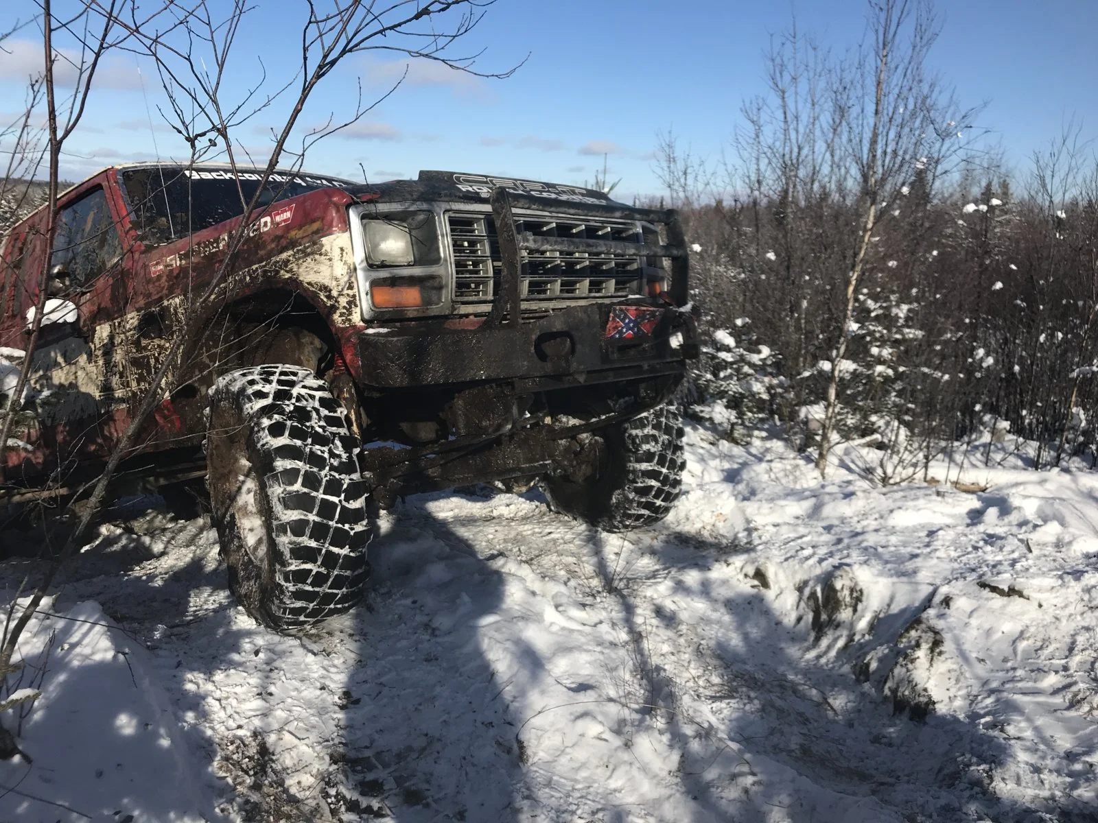

And part of today's fun included me almost going on my side, the Zuk breaking a t-case mount and having his alternator stop working, the big Ford ripped his fuel lines off, busted a tail light and added a few more dents. So it was a good day!! :)
This is considered a buggy trail, though it does have bypasses for the harder stuff. Everyone had a winch, and every winch was well used today. Lots of ice covered steep rock faces.
I was going to ask if that truck was too big! It seemed like that thing might not be able to make it some of the places a smaller TJ would.

It is a big ass truck, but he's taken it through places that it shouldn't have fit. Well technically it didn't fit until the sides were caved in, lol.
