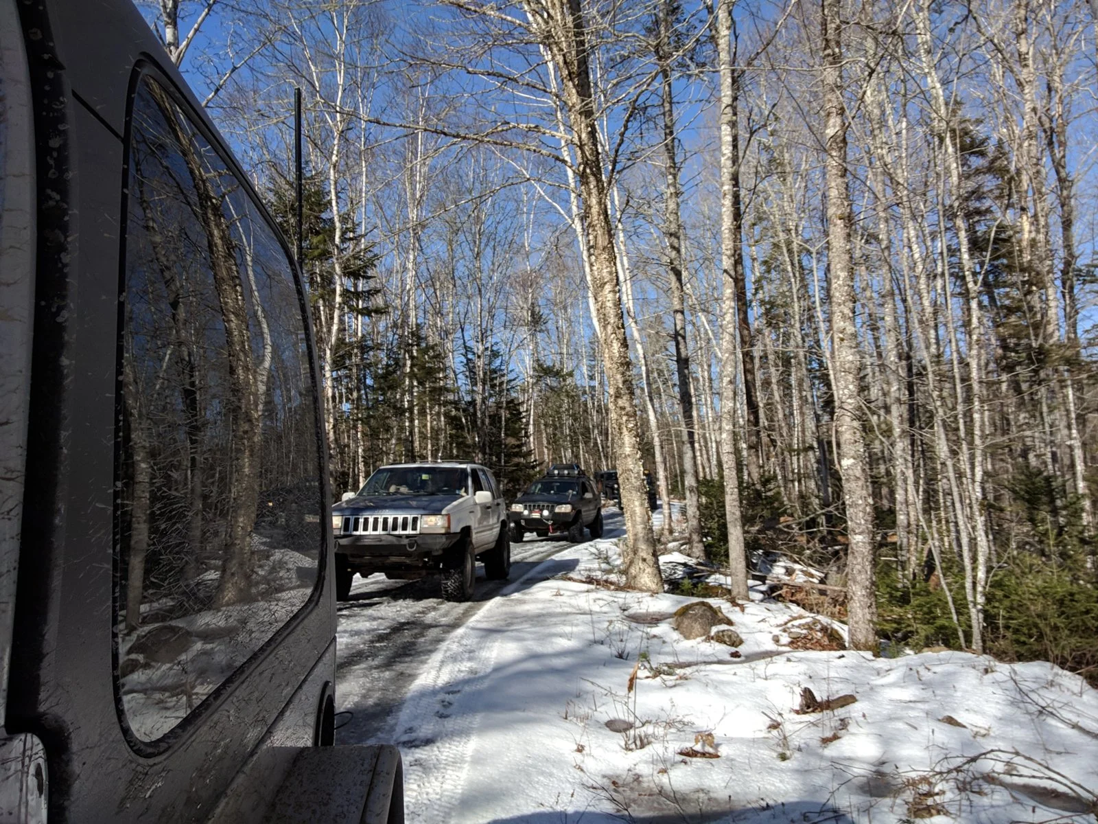

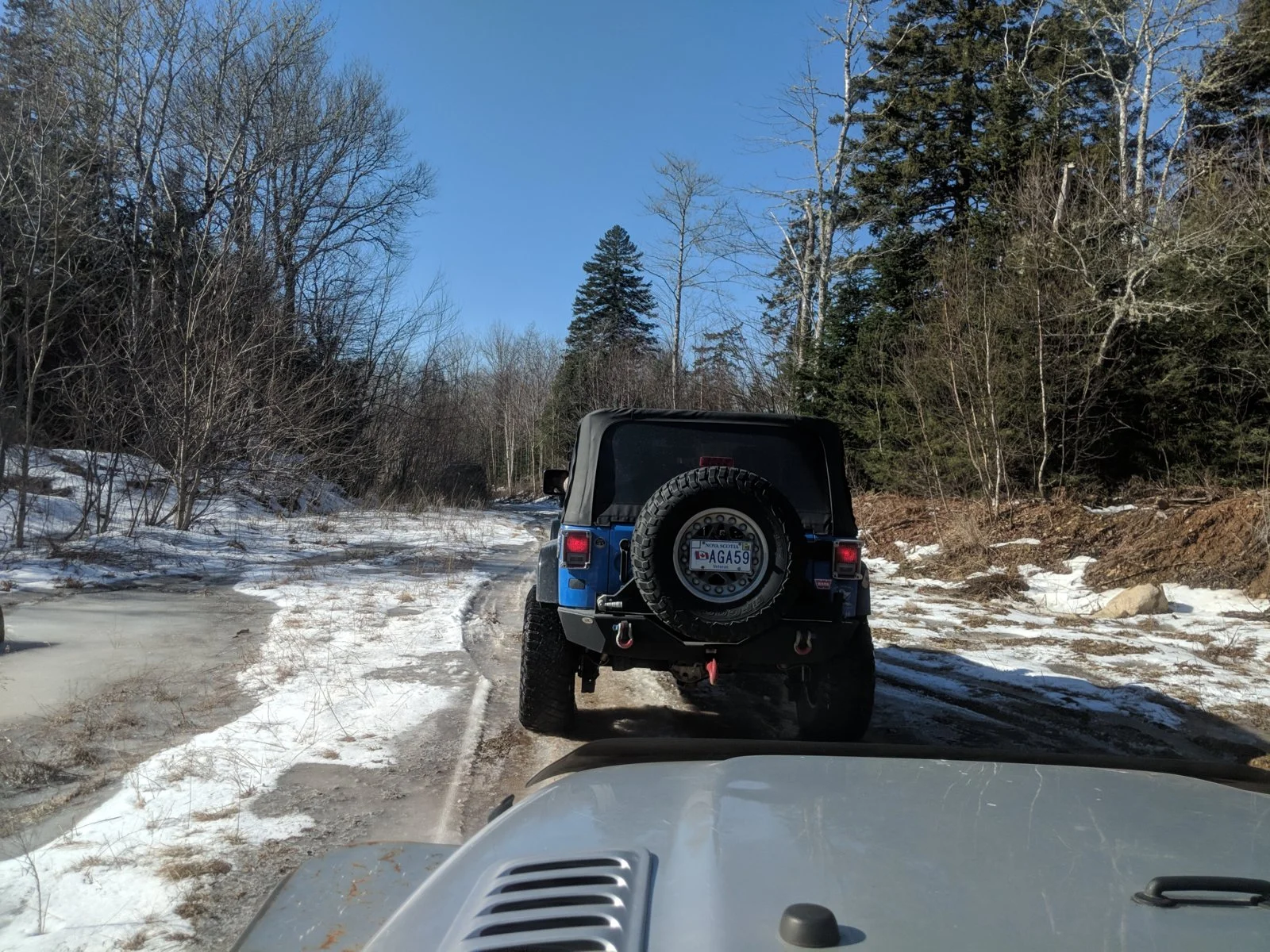

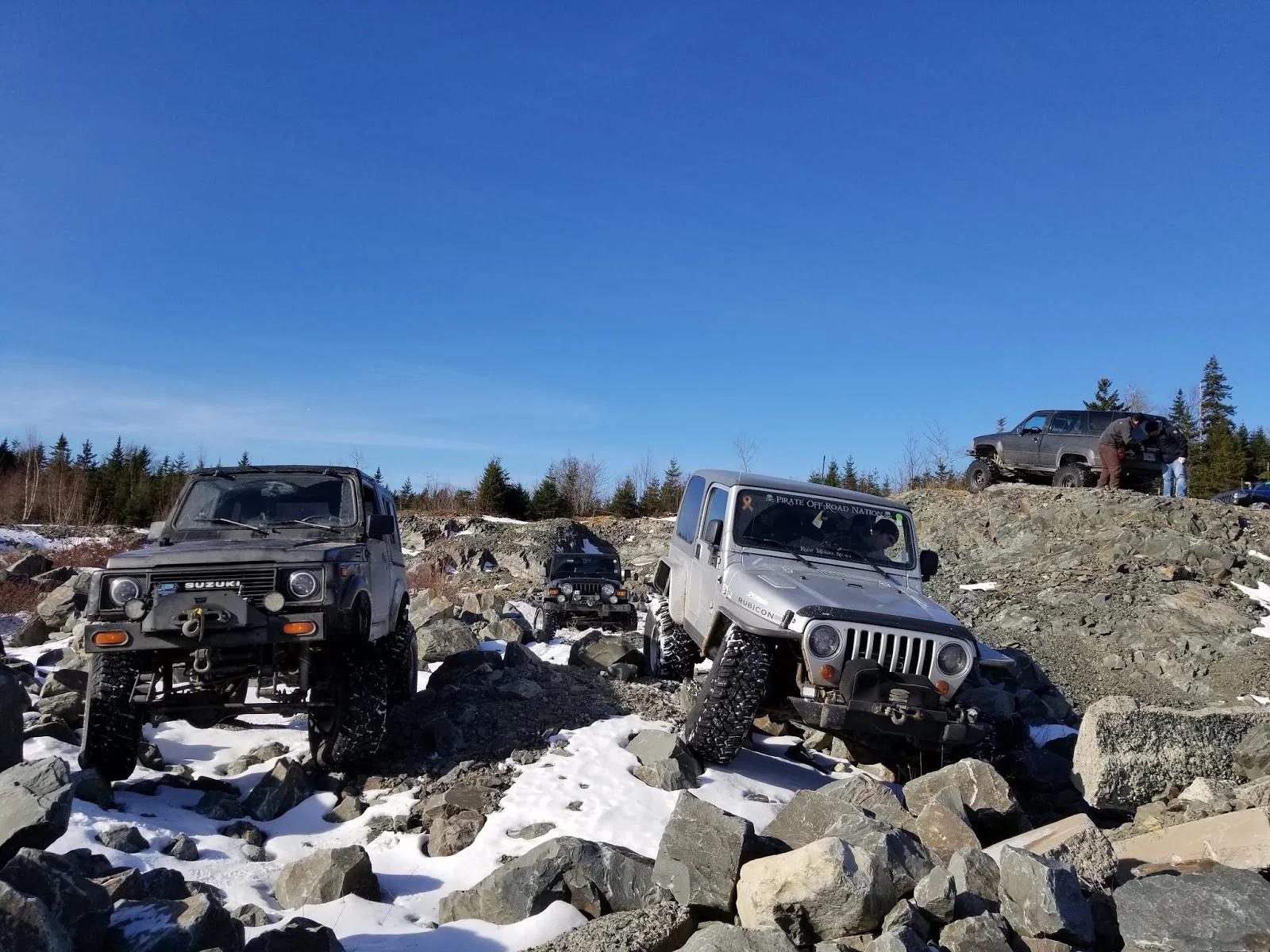

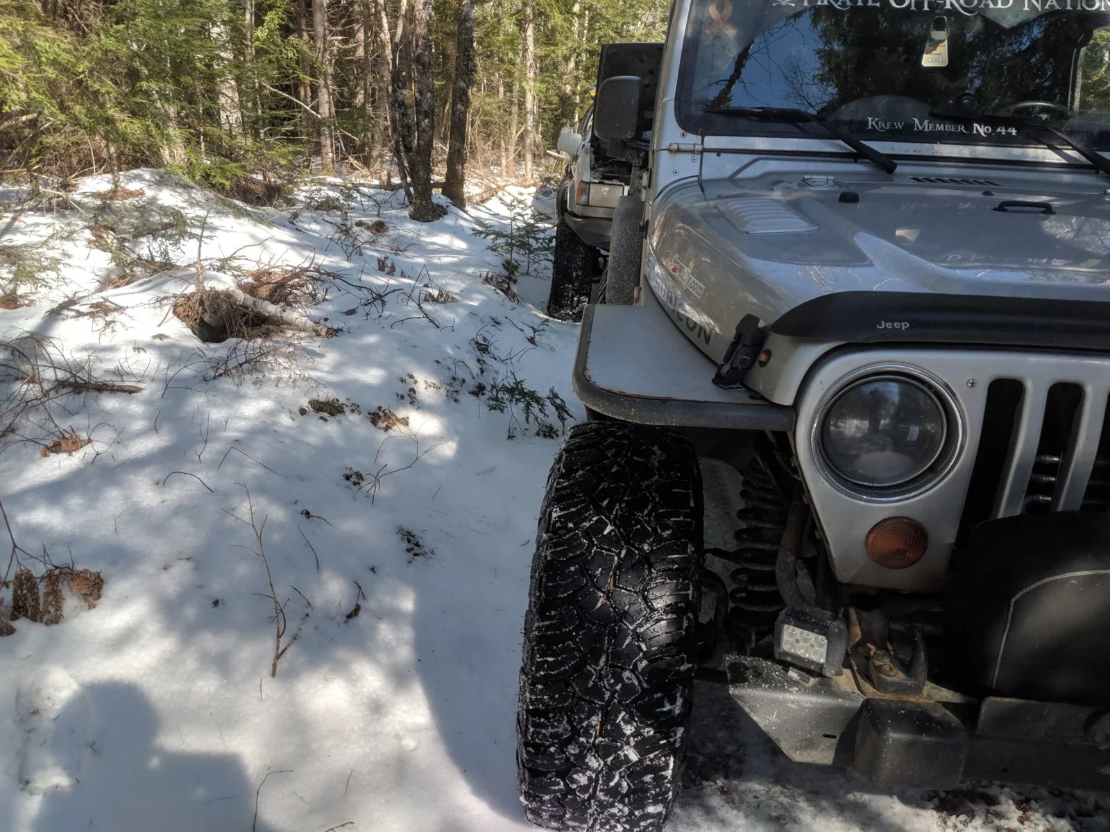

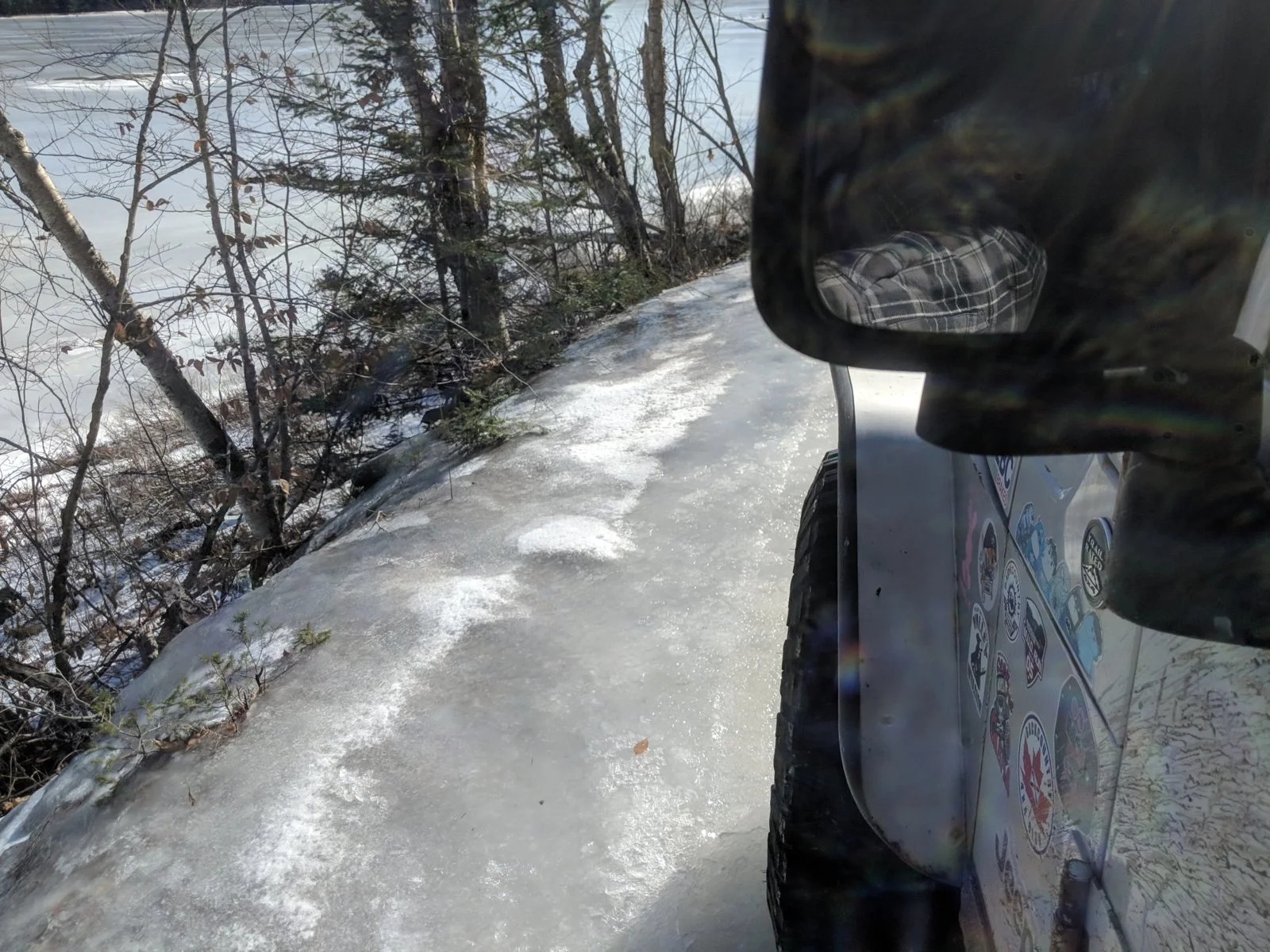

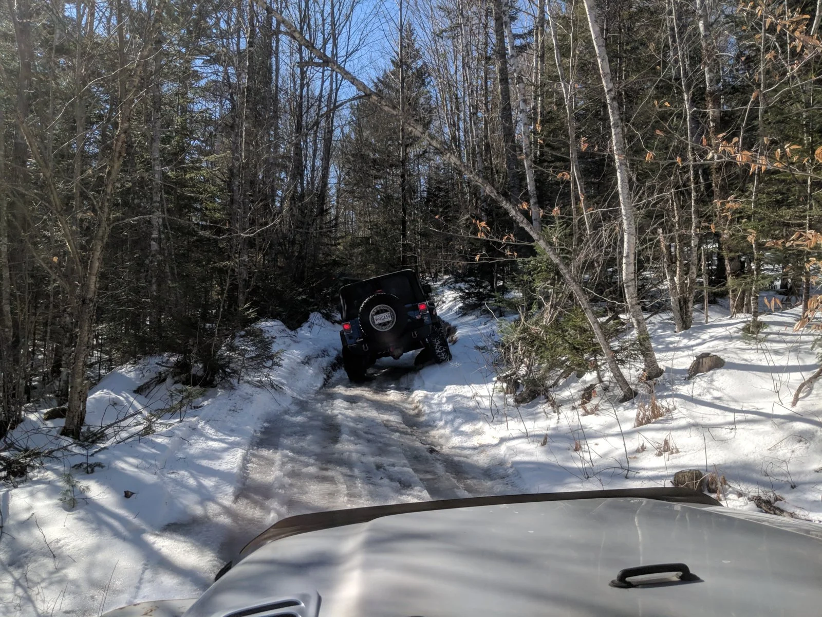

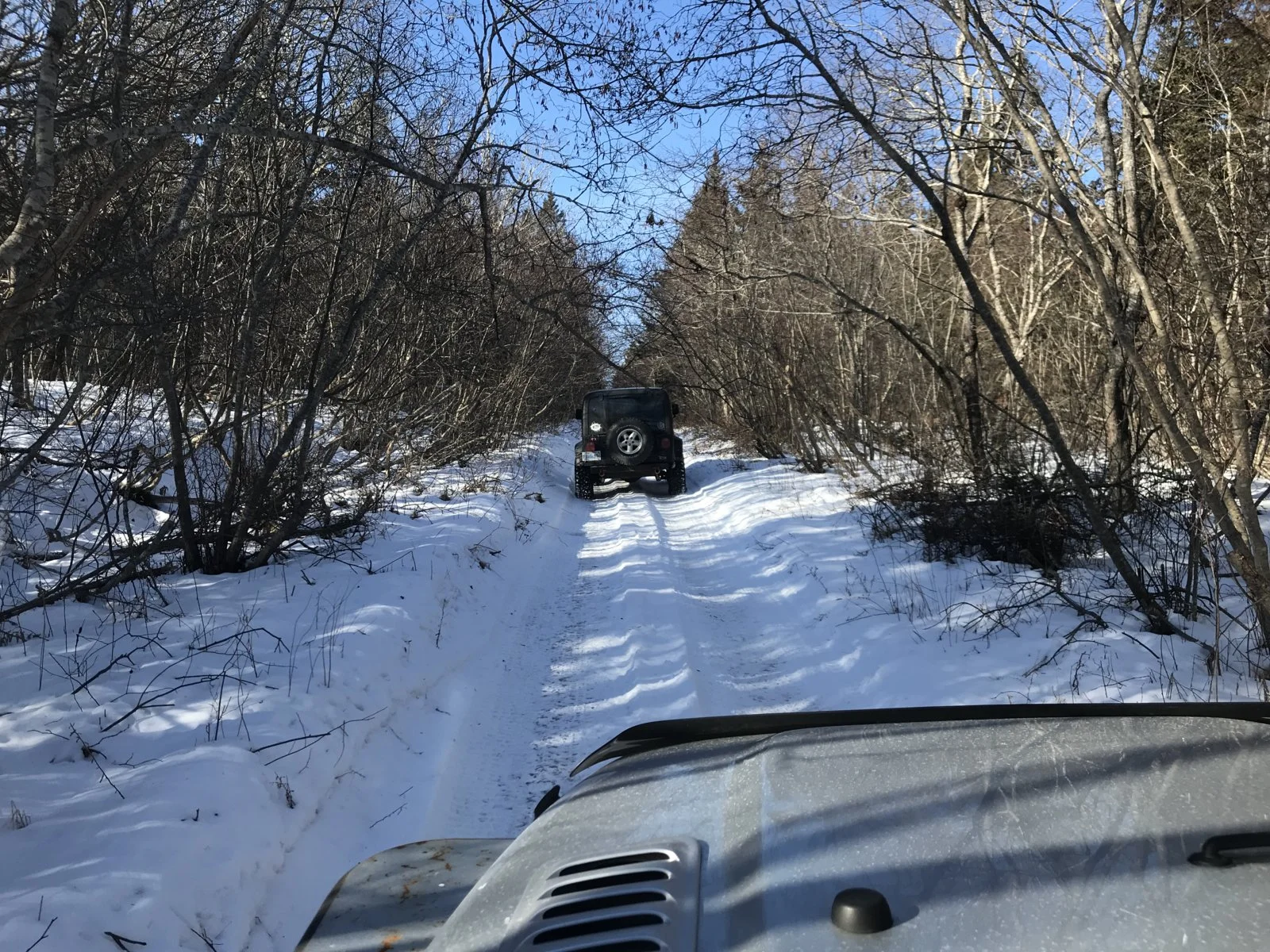

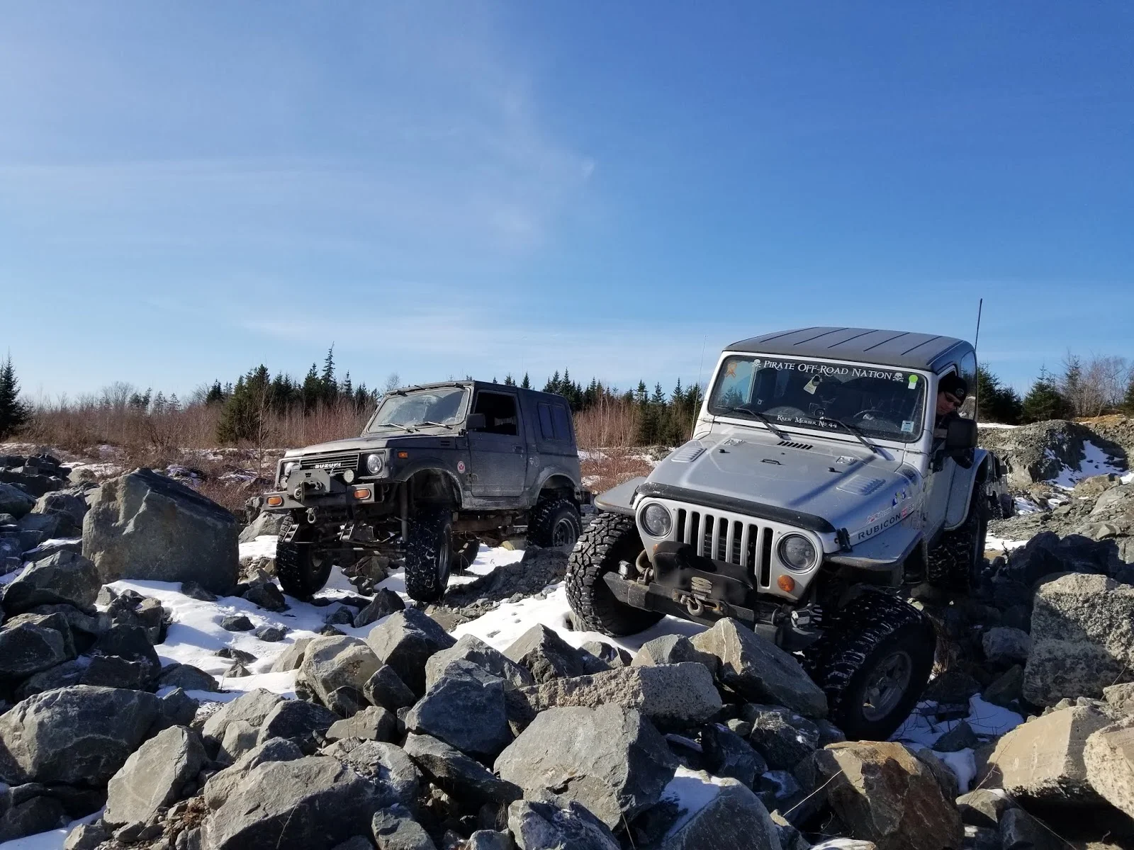

Now this was a cold day out wheeling @Chris lol. I'm the one brushing the snow off of the seat. I actually wasn't cold as I had my Helly Hansen Extreme Weather Gear on. My buddy that was driving was frozen by the end of the day.
I remember doing similar things when I lived out in Wyoming. Man was that a blast. I layered up some of my ski gear, a hoodie, and a nice big jacket. Wasn't bad at all until I got on the highway.

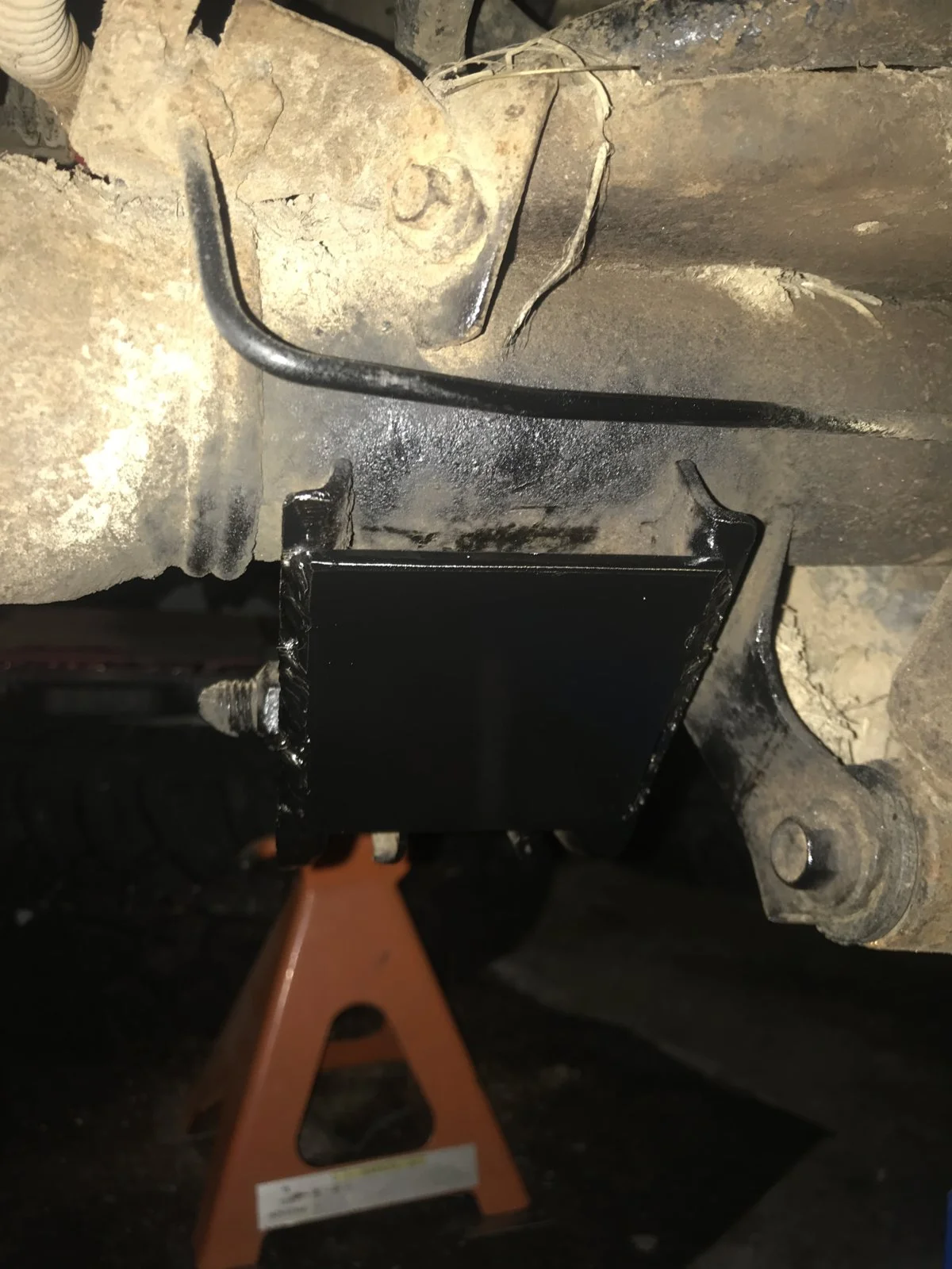

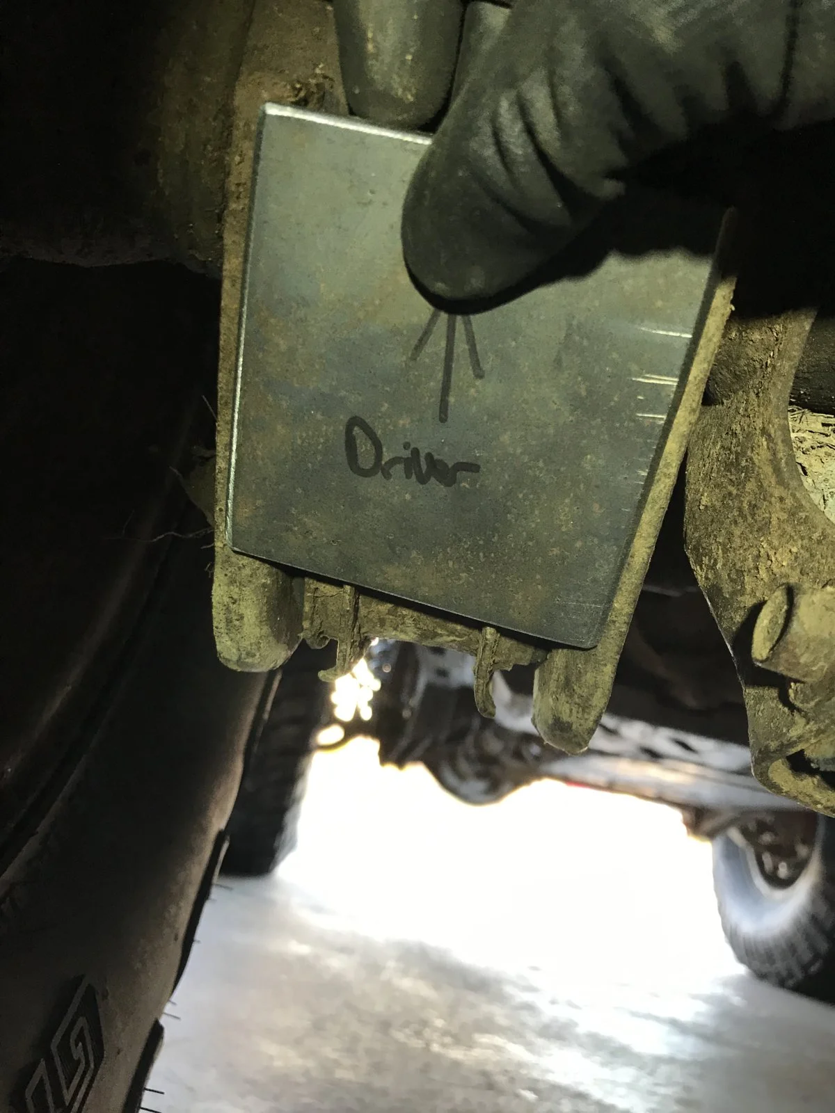

Today I cut out plates to weld onto the control arm mounts for the lower shock mounts. I still need to make the standoffs for the shock stud, but won't be able to do that until I get under there and measure angles. I think my SPI Tronic Pro 360 will get a good workout for this project.
Looks like I'm a bit behind here.

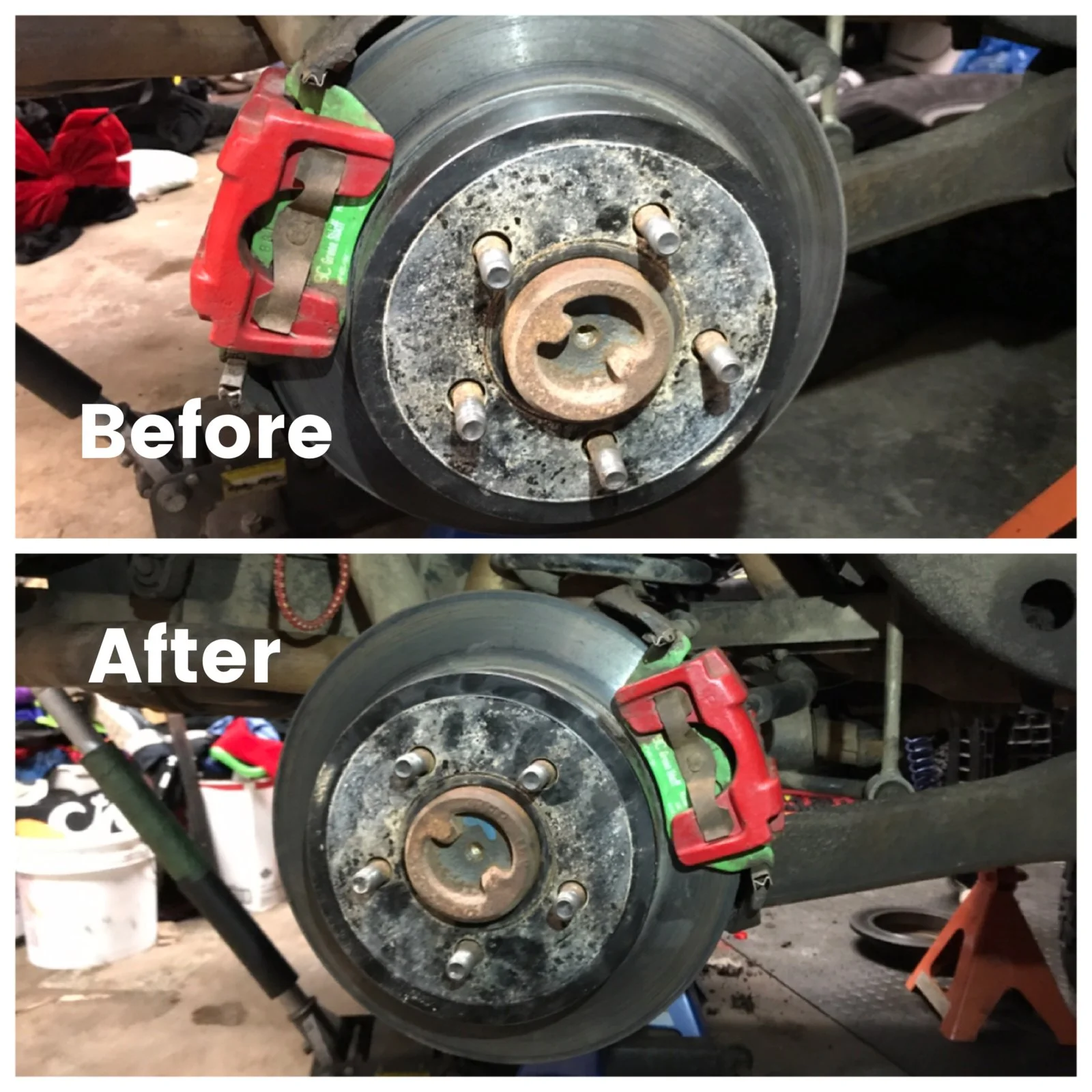

I did a rear caliper flip in preparation for outboarding the rear shocks.
Plated in the rear lower control arm mounts.

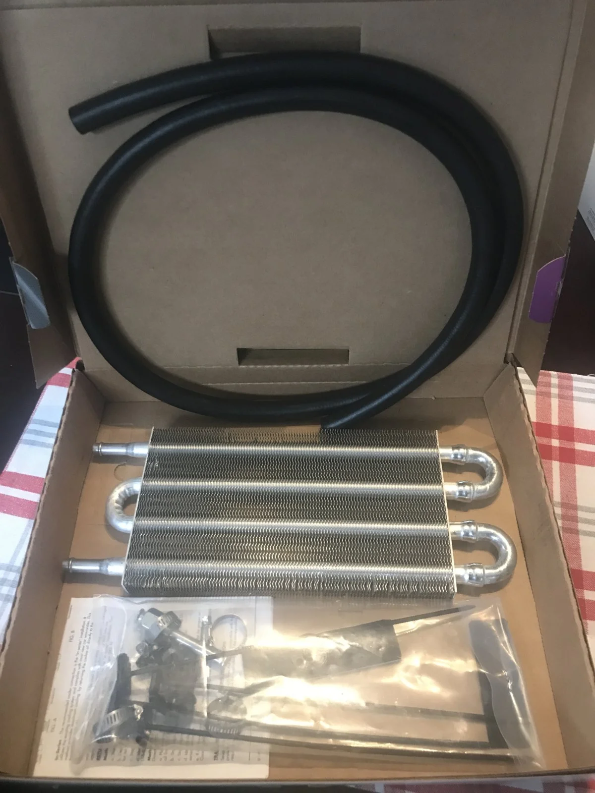

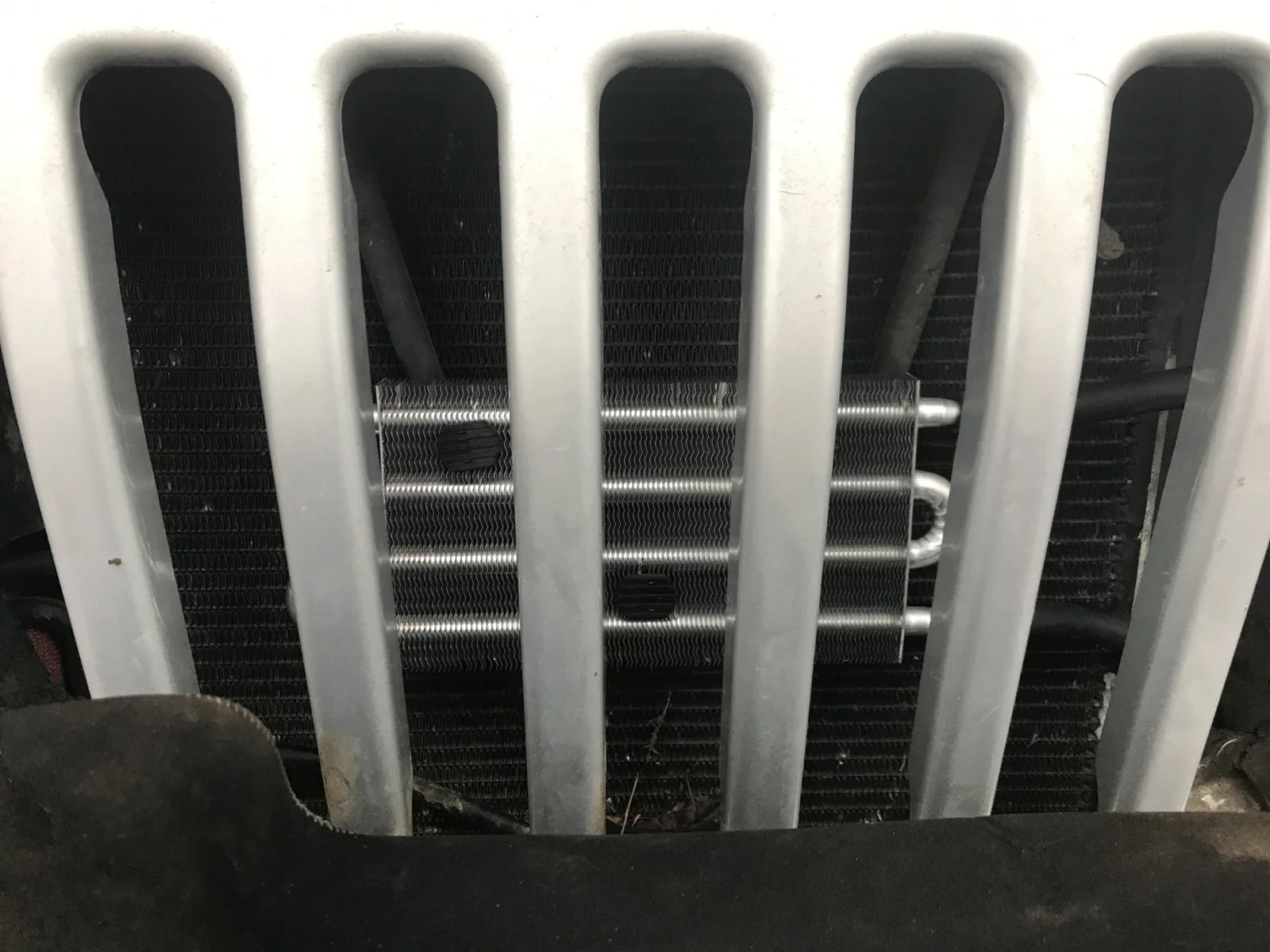

Installed a power steering cooler.

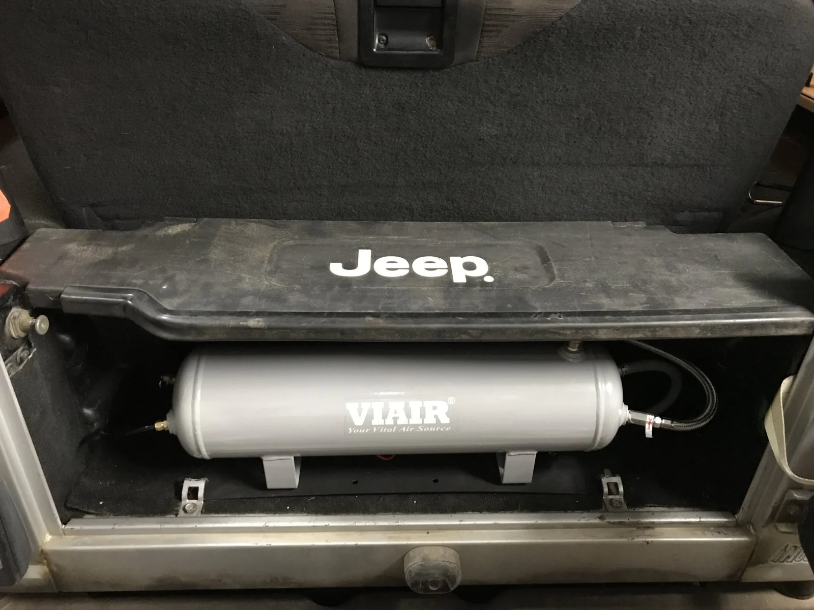

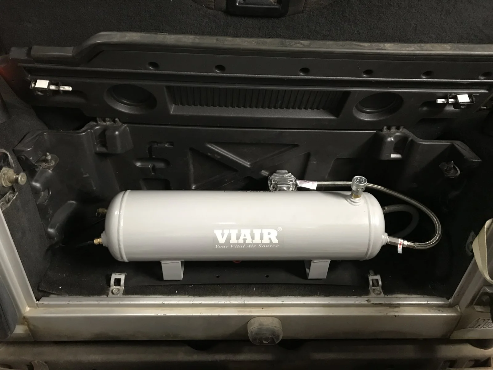

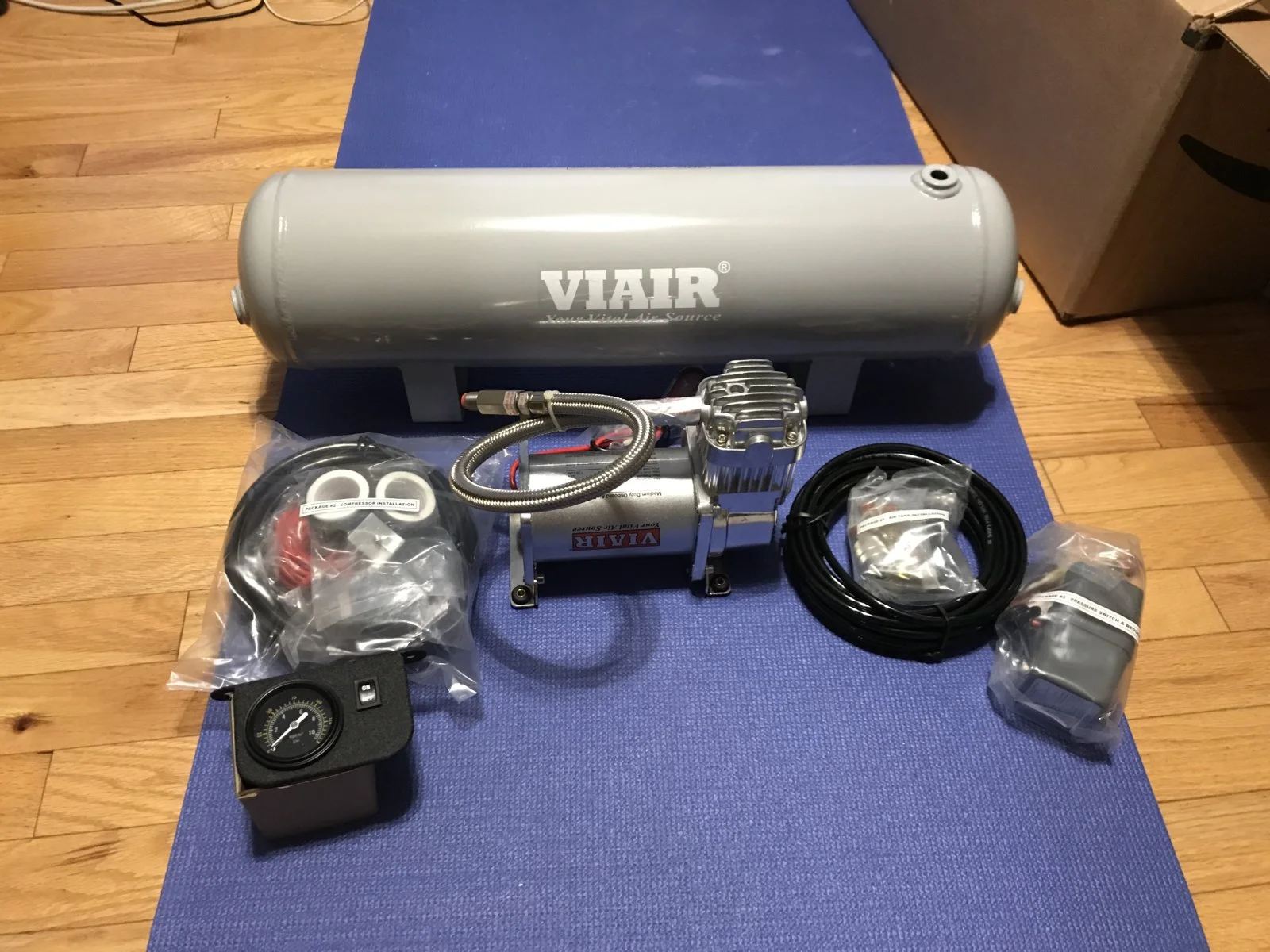

Installed a Viair OBA system.

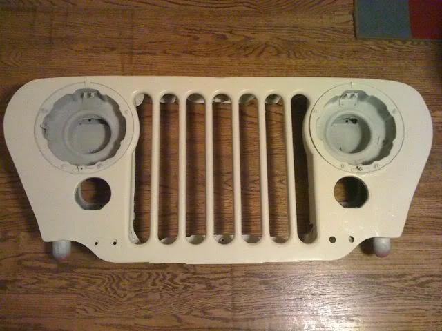

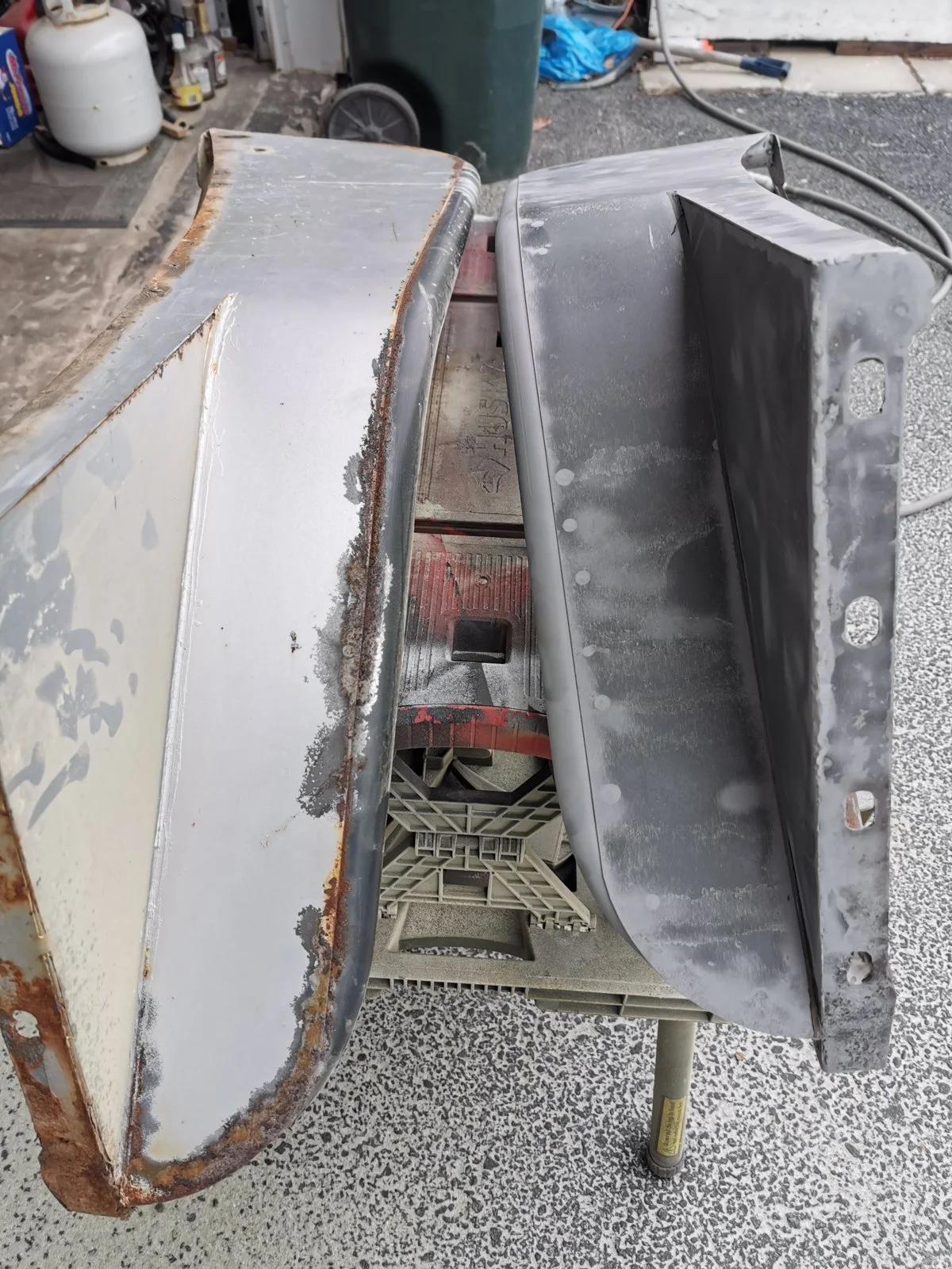

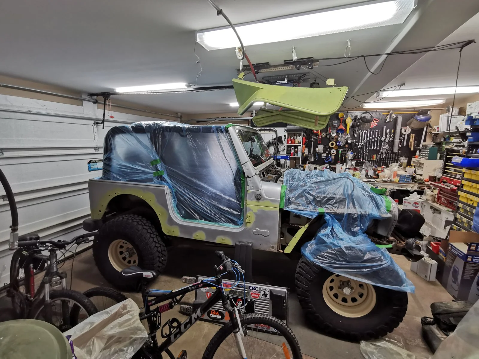

So I think it's time to start on this project. It's been something that I've been interested in doing for a couple of years now, so I think I'll start looking for some grilles. For those wondering what's going on, it's a CJ2A grille frenched into a TJ grille.
76329
I like the idea of a CJ front a lot. This grille with the flat fenders or the TJ fender lights welded over would look great imo.
Reactions: derekmac
I think it'll look good, and be something different that you don't see often (or ever). I also want to do the drop down CJ tailgate, but I need to figure out what to do with the spare as I don't want to do a bumper tire carrier.

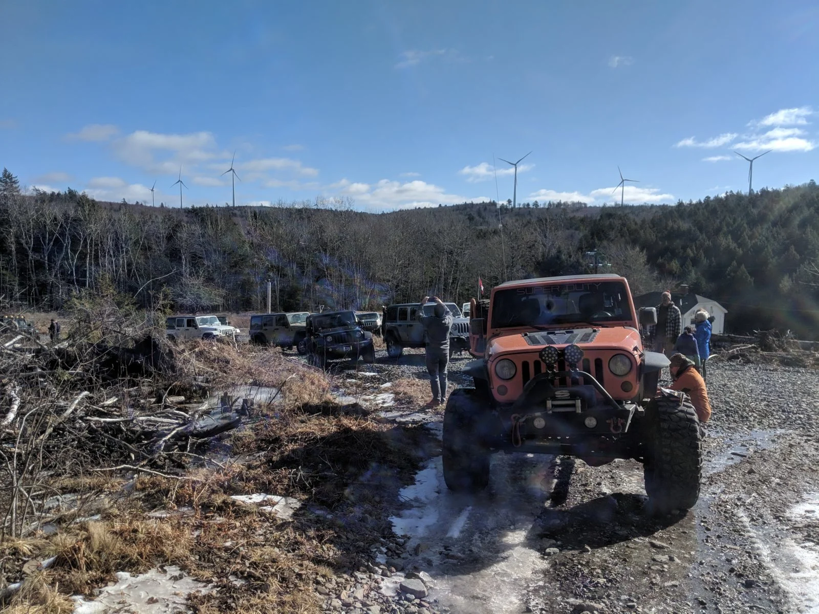

Went on the local Jeep Clubs annual topless run today. I really wanted to go topless, but I didn't get the chance to pull the hard top. Oh well, it was still a great day out!

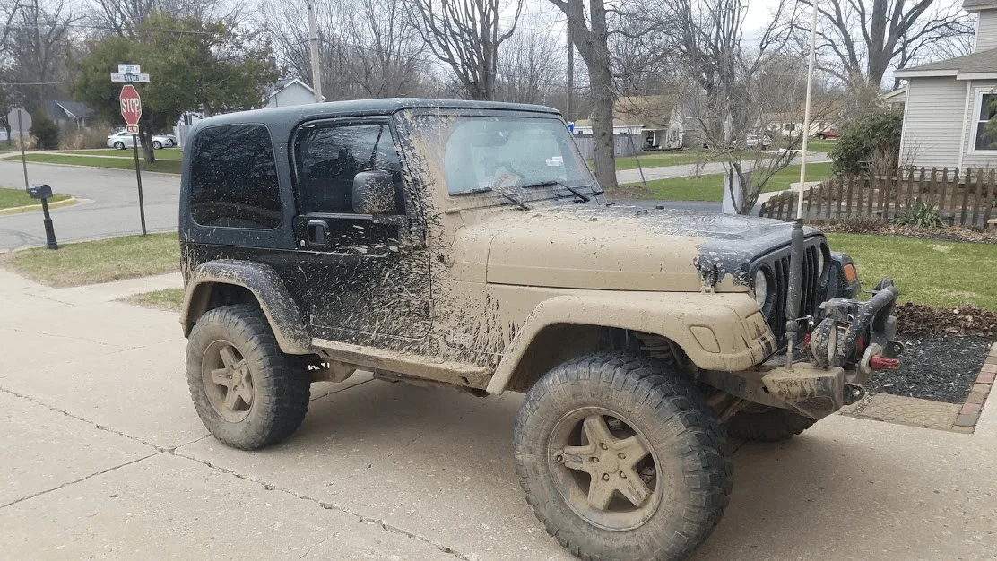

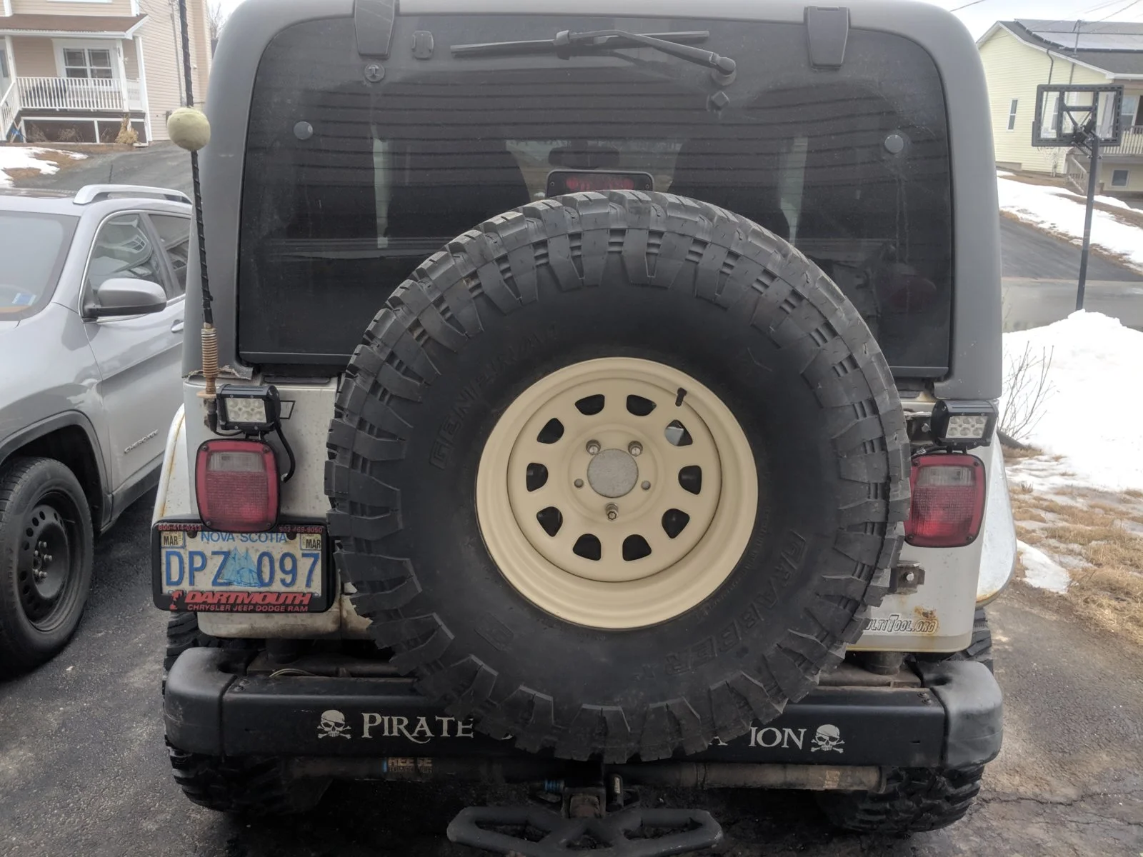

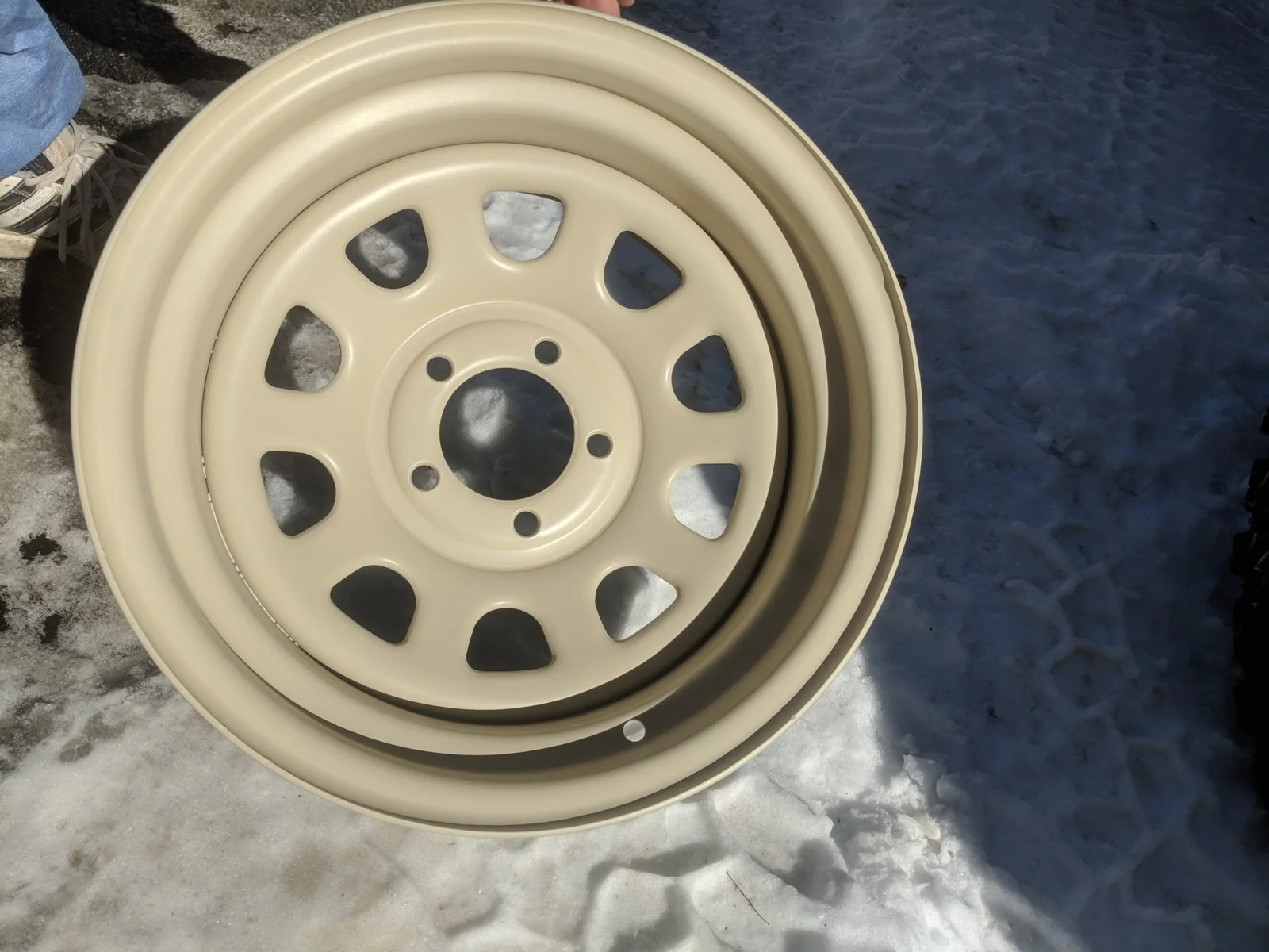

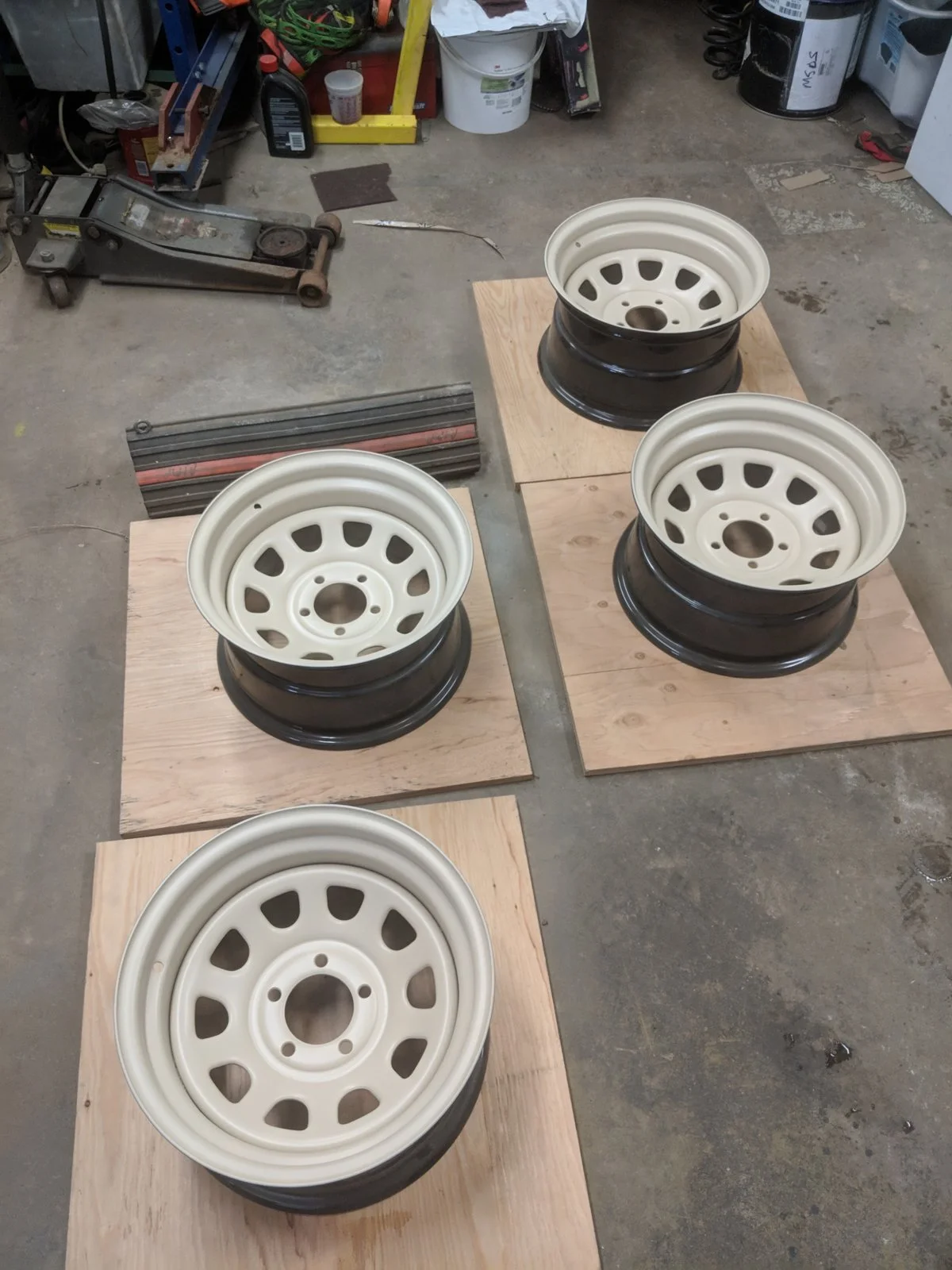

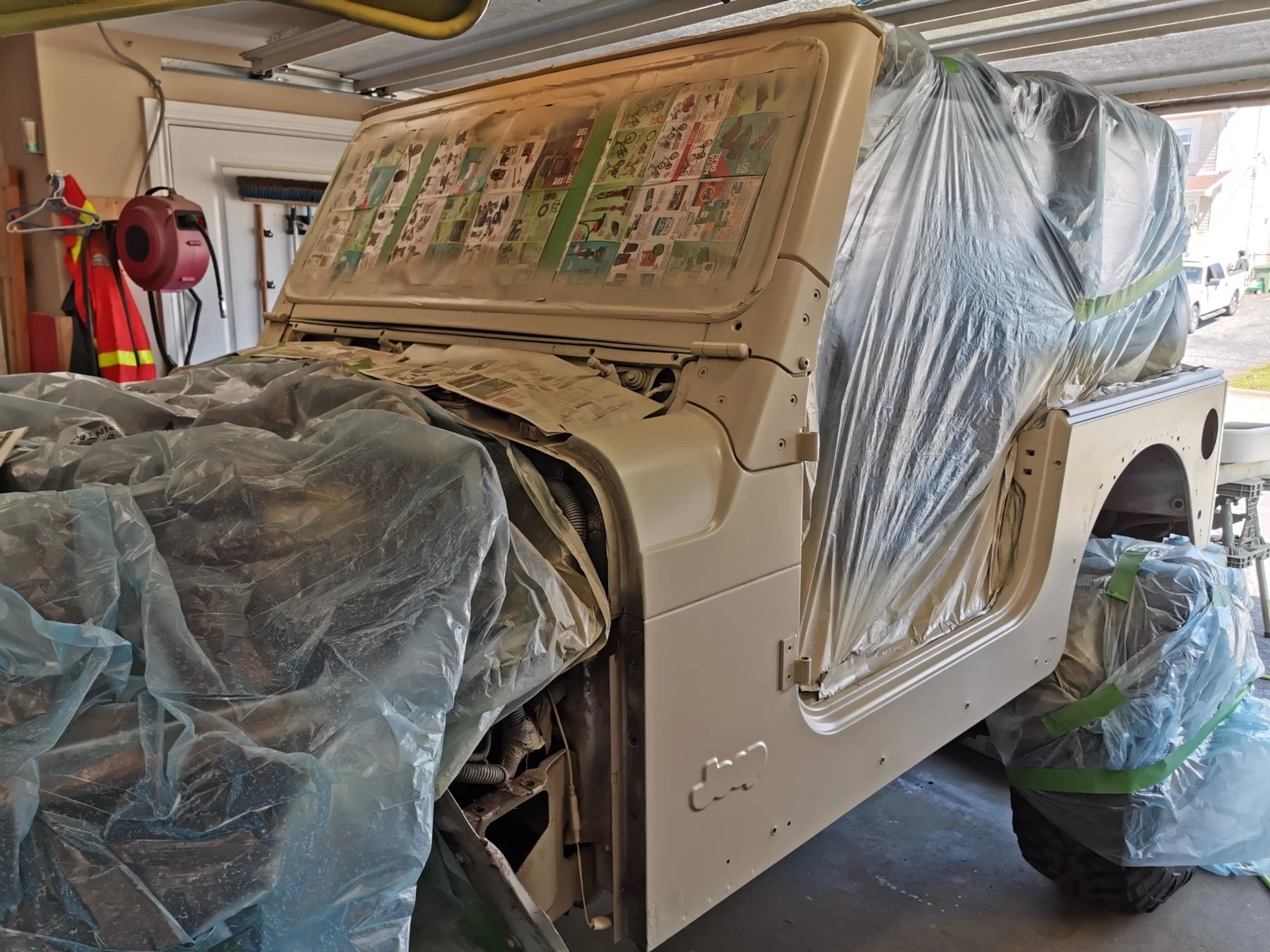

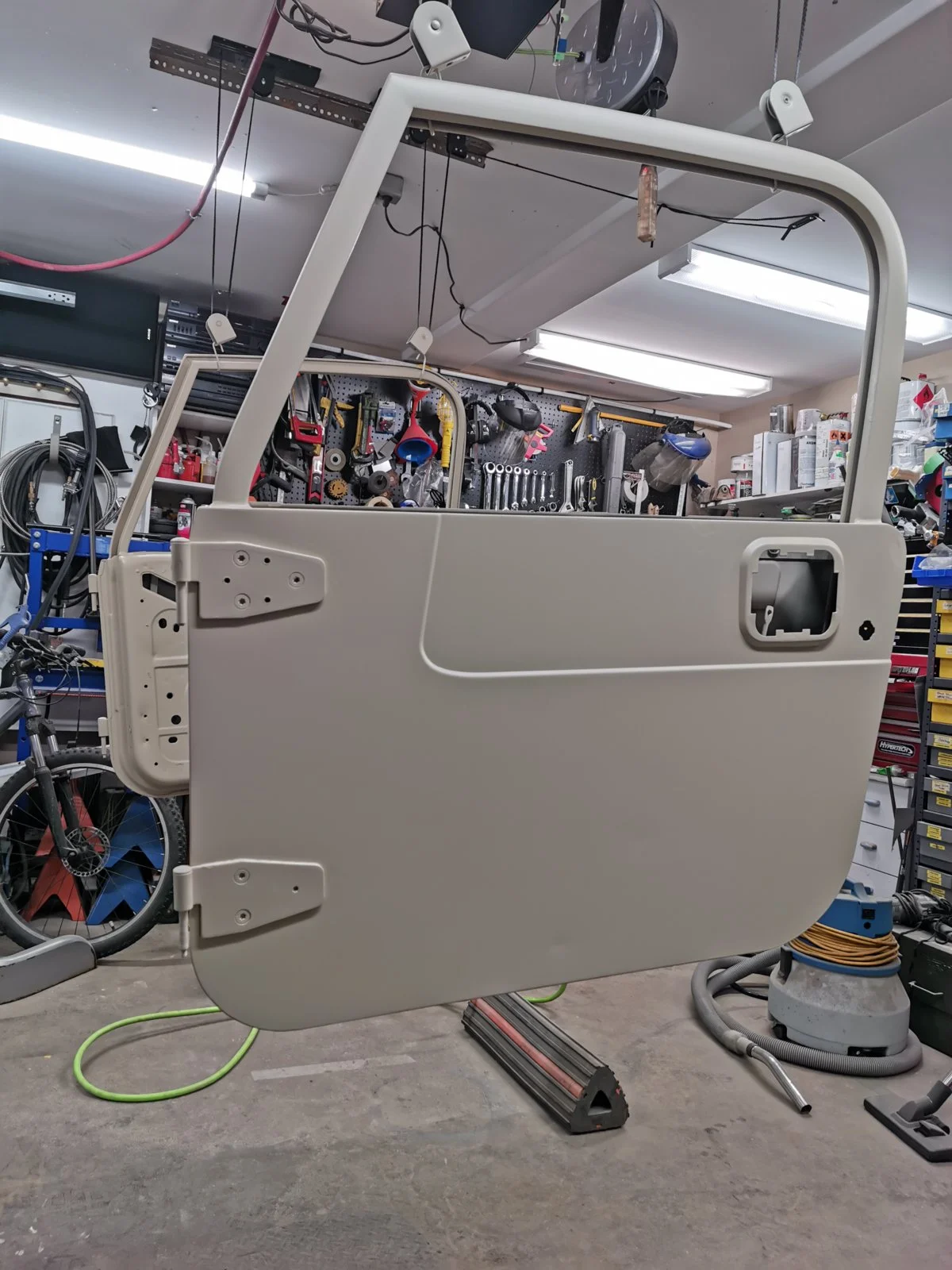

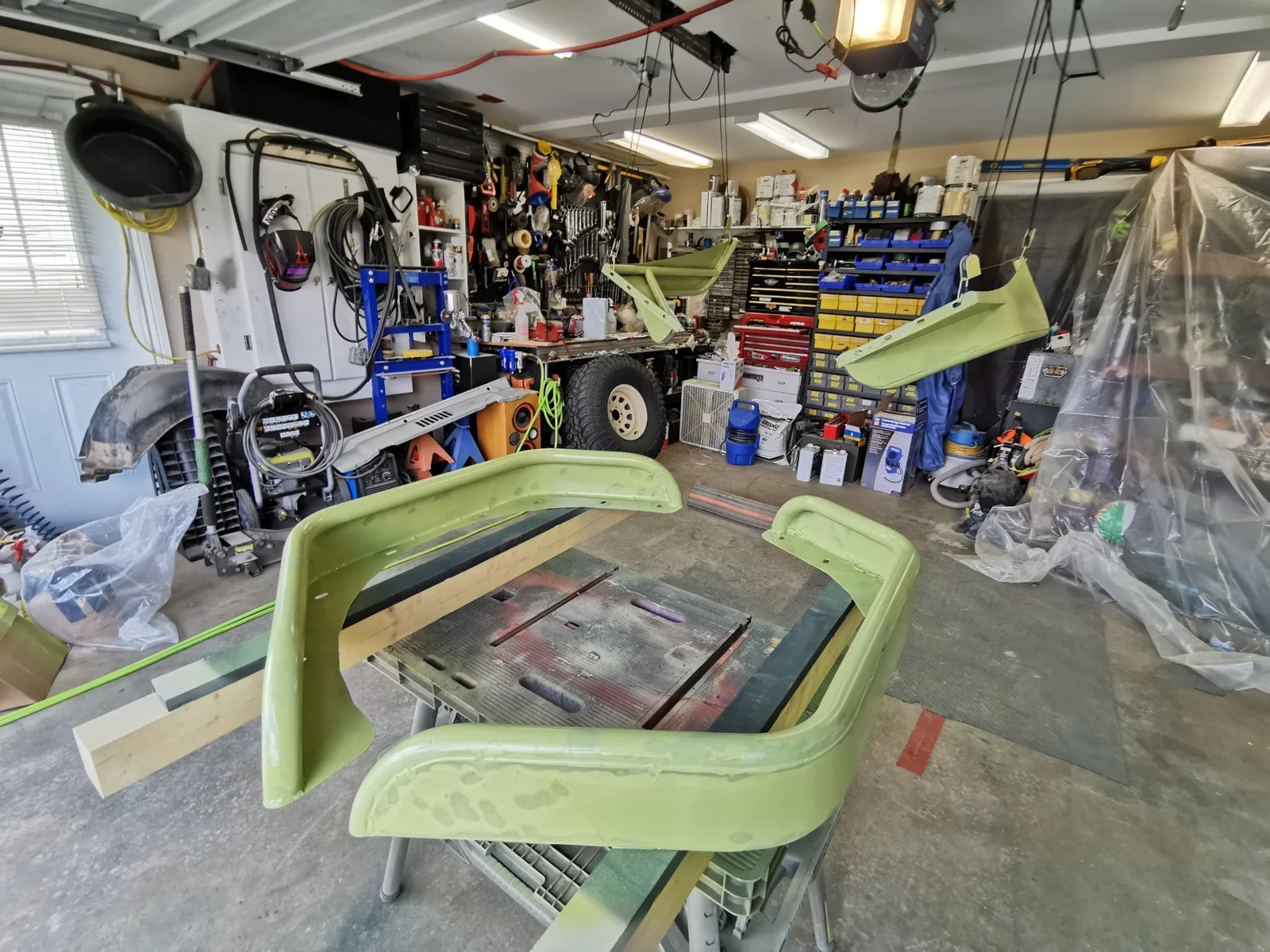

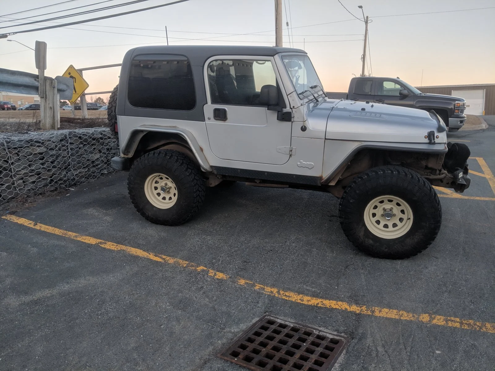

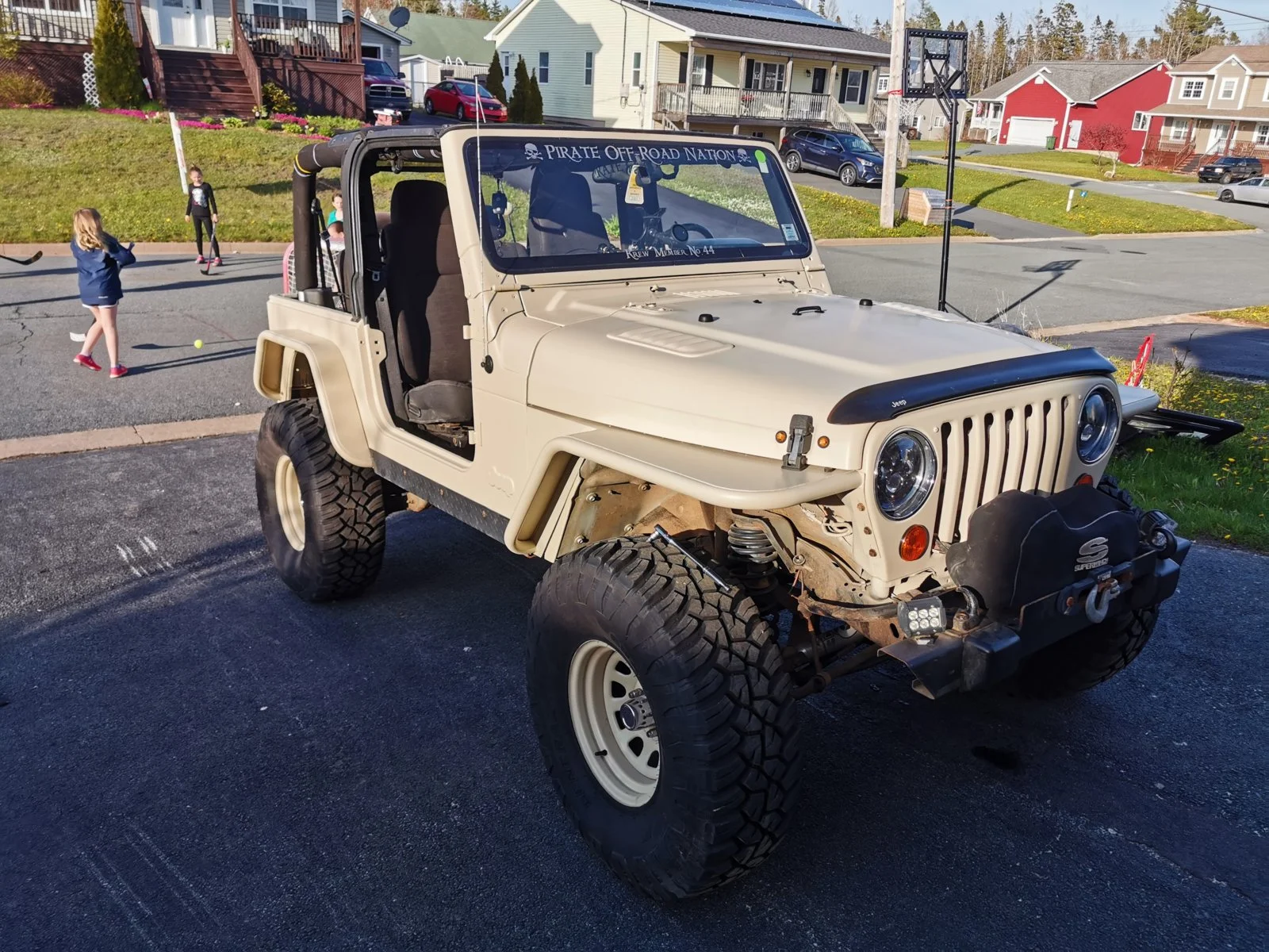

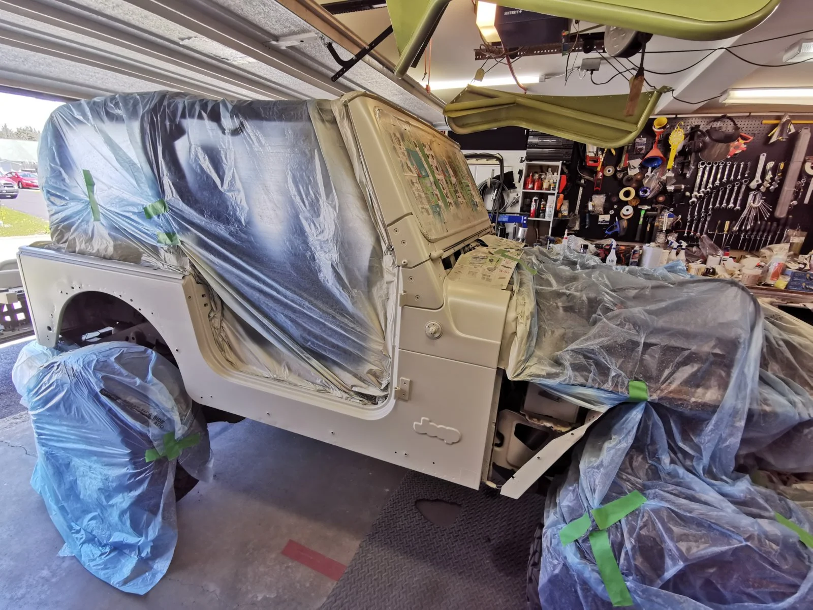

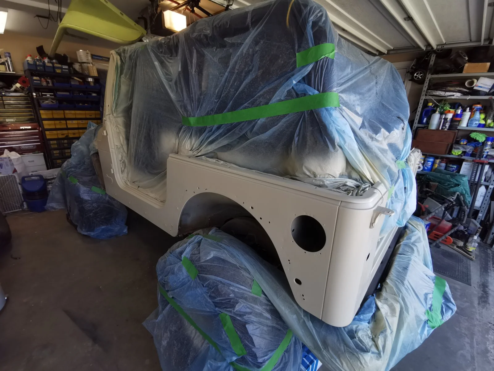

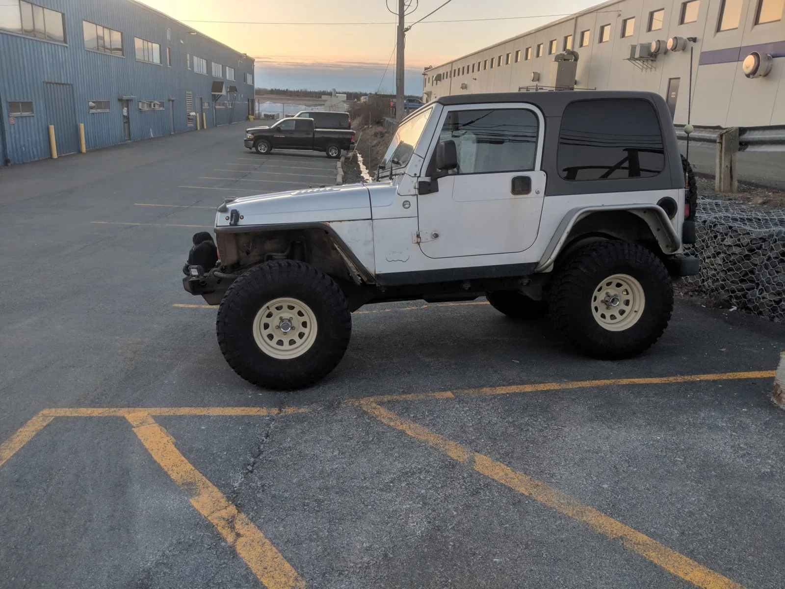

Posted this elsewhere, but should add it here too. I'm swapping rims so I have a little less backspacing (3.75" vs 4.5"), and I'll five matching rims too.
I painted them Desert Tan, and come spring/summer I also plan on painting the Jeep the same color.
82954
82958
82959
82957
82955
I just need to find the time to get the other four done.

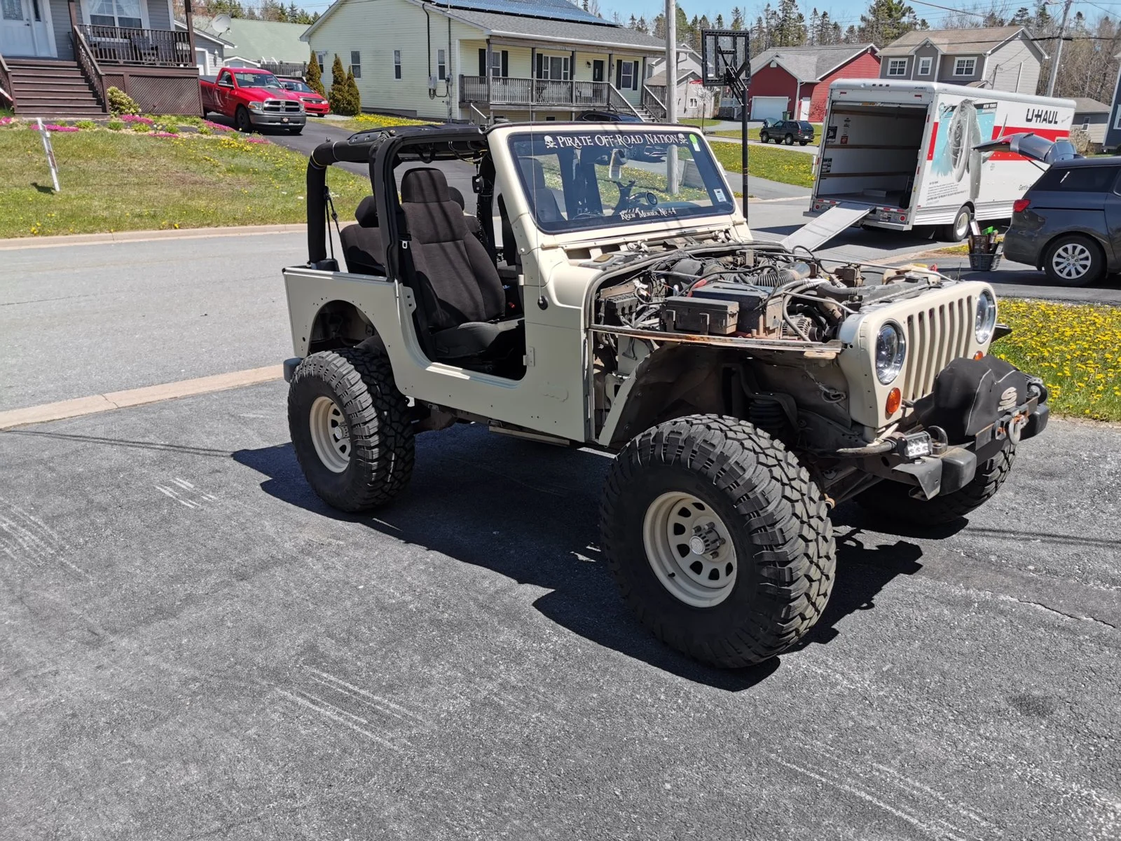

Got the new rims mounted last night, and I'm pleased to say no more rubbing when I turn. I'll have to see what I can remove from the steering stops now.
