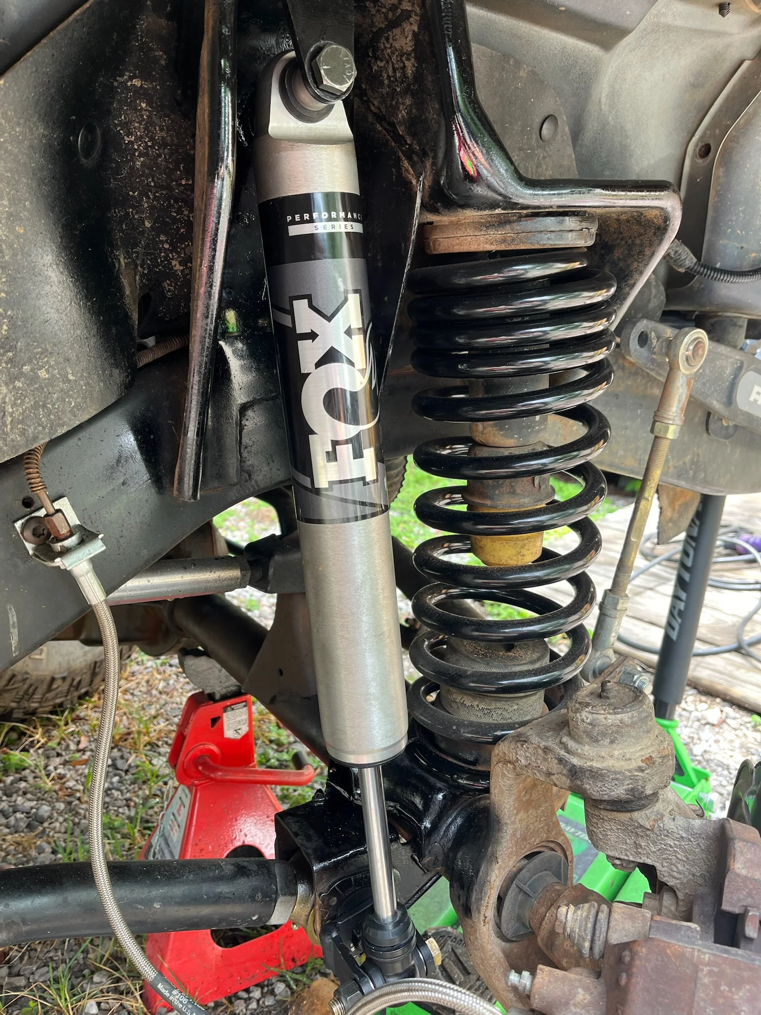

But then I found myself with an extra set of Fox IFP shocks that I didn't have any need for, and instead of selling them on CL or marketplace for pennies on the dollar, I decided to put them on my TJ. These are the shocks.

10.5" of travel (the Rancho 5000x these are replacing have 11")

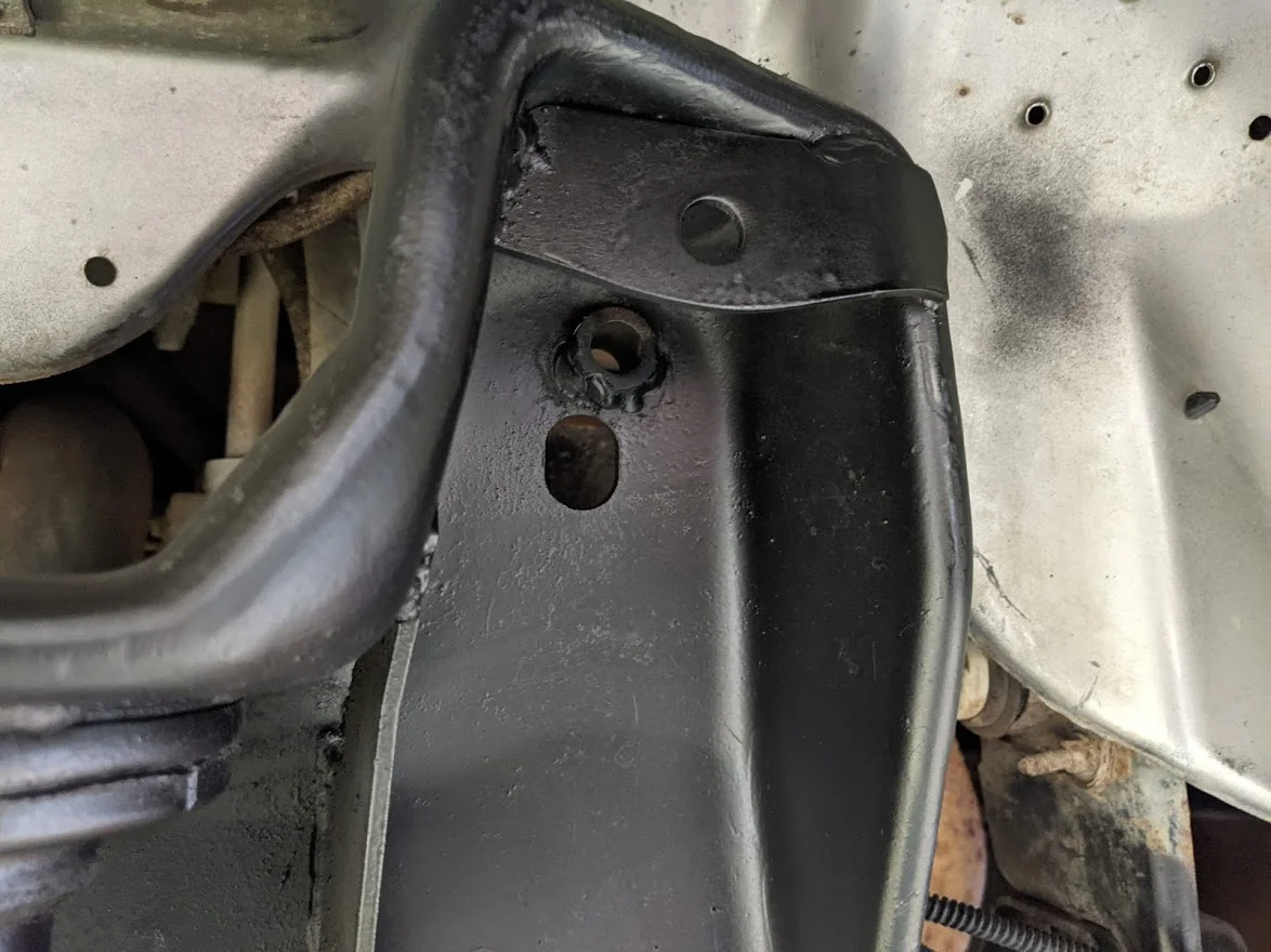

The upper were easy. I drilled a 1" hole through the rear of the perch and welded in a 1" long section of 1/2" ID and 7/8" OD DOM, a simple plate across the front locates the upper mount

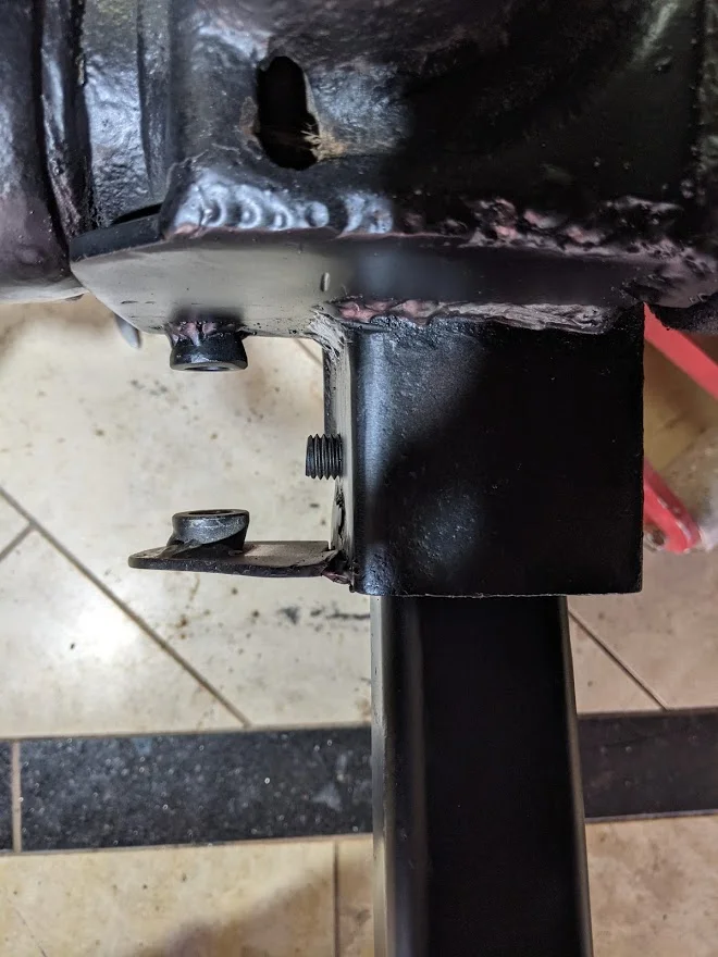

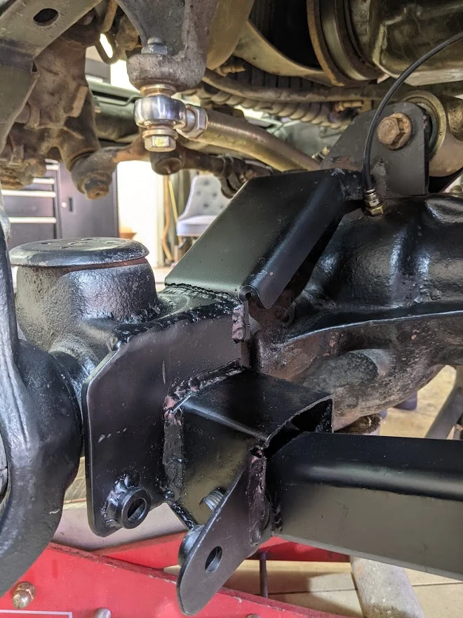

I cut the shock perch off the bottom, used 1/4" plate and created an L shape bracket that I welded to the spring perch and wraps around the control arm mount. It even ties into the edge of the truss. A simple tab locates the rear of the mount because I don't care for single shear shock mounts. The shock bolt actually sits lower than the control arm bolt.

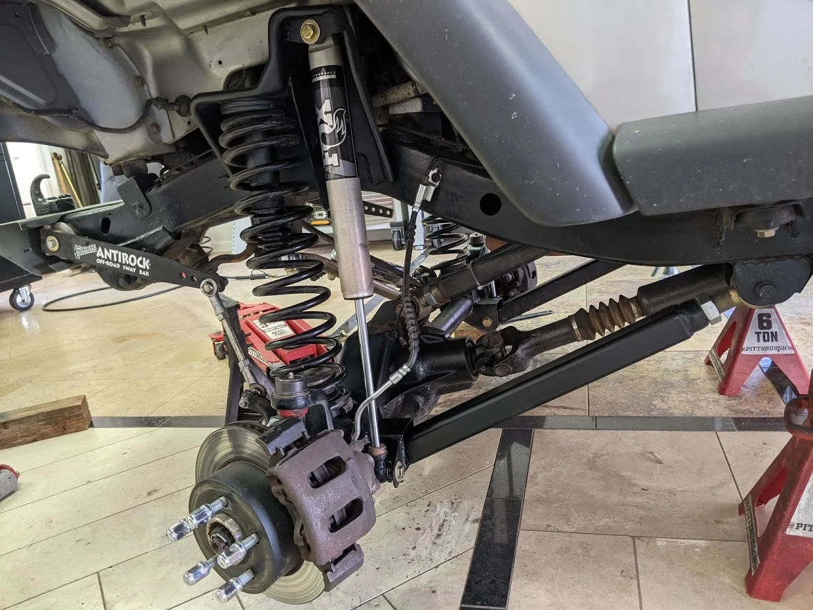

Finished project...
