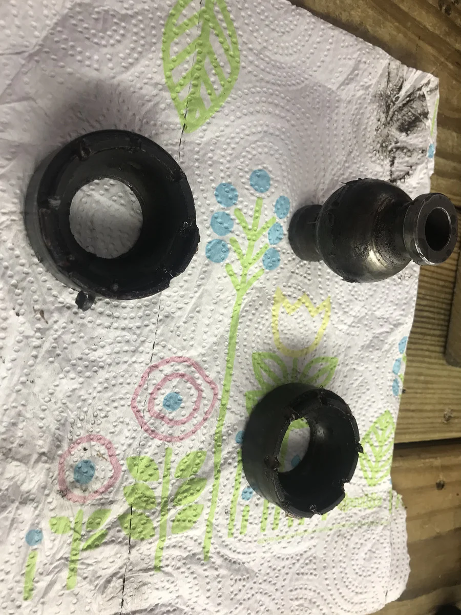

Earlier in this story, I discovered that some of my Johnny Joints had grease zerks on both the joint housing and the bolt. I found that if I removed one of the zerks, I could pump grease through the Johnny Joint. I pulled this joint apart first because I wanted to see if the grease gun actually lubed the joint satisfactorily. It did.

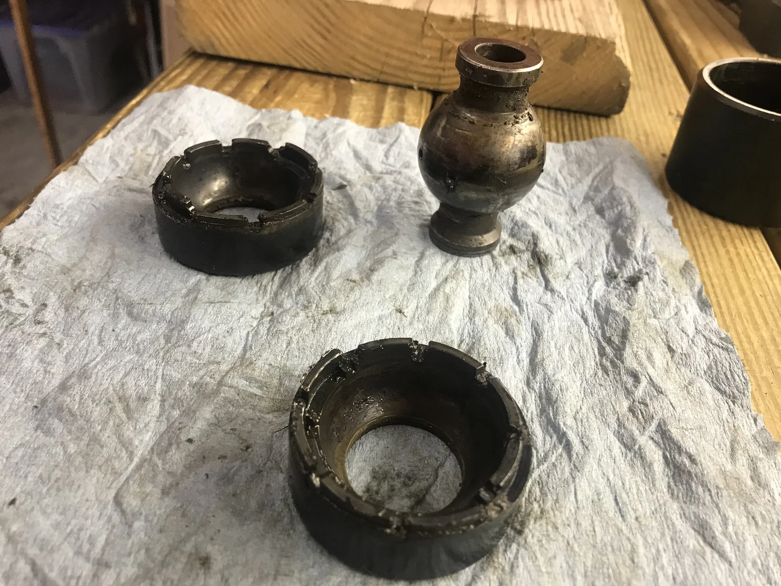

Then I pulled the JJ out of the other end. This is the first time the inside of this joint has been looked at. It was well greased too.

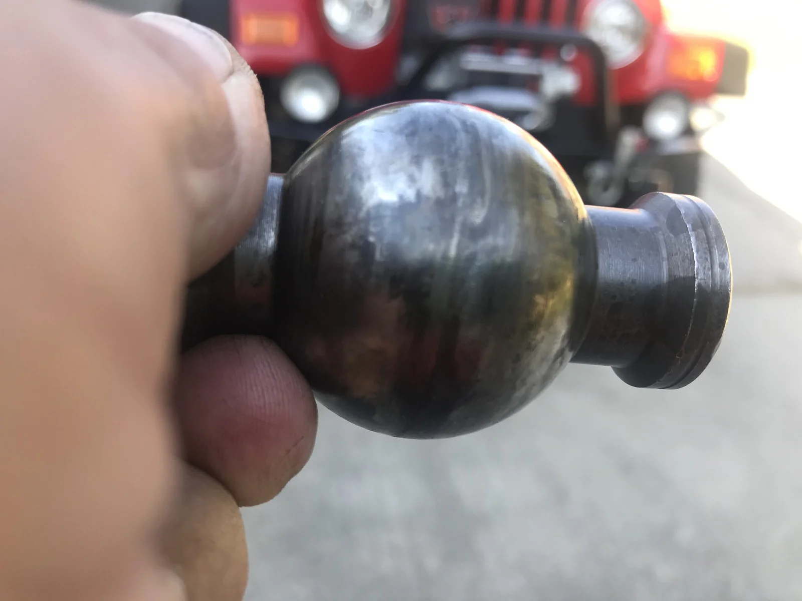

The only hting I noticed during my inspection was that the JJ ball surface is a little rougher than expected. Some of the roughness must be from the oil carrier of the grease. The black suff on the balls would not wipe off. I expect this roughness is thesource of the squeaking I hear.
My thought when I saw that was that maybe they let it keep a little texture to give grease some place to hang out and stick to. If it was perfectly polished smooth I think the squeaking would be even worse, and the greasing interval would be much shorter. The black stuff is probably poly from the races sticking in that texture, due to lack of lubrication. Mine were the same way, and I'm hoping filling in that texture hasn't doomed the balls to squeaking forever so I end up having to buy new guts for 13 JJ's to get a clean start.
Like many in here, it is pretty frustrating that a company as well reputed as Currie sells a premium product that needs rebuilt before you can even use it, because the grease they put in it isn't enough and isn't the right kind. If they're already going to the trouble of putting any grease in it at all, it can't take that much more to do it right. But there's no joint that compares as far as I know, so I'll finish greasing and roll with my 13 Johnny Joints and just hope my experience ends up falling in line with that of blaine and jjvw. And if it doesn't, I'll probably just accept the tradeoff of a good, long lasting joint in exchange for more frequent service. The RC joints on my LCA's took grease easily but they were worn out in 15k miles.
