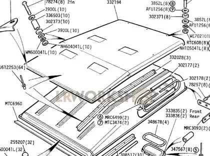

How about making a Tropical Roof for the LJ.
I need to keep the sun from beating on the roof in the summertime out here in AZ

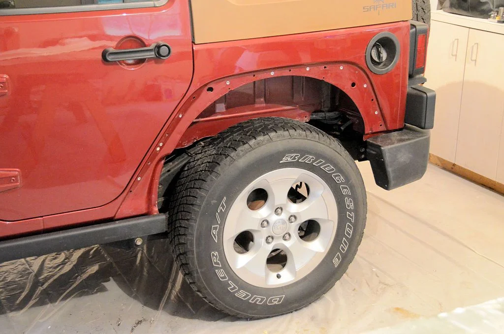

A few years ago I designed flat fenders for the JK and to make them fit properly I needed a mounting flange that exactly matched the irregular shape of the mounting area on the fenders, so I made a mold of the flange right on the body. These photos are from making a mold for one of the rear fender mounting flanges.

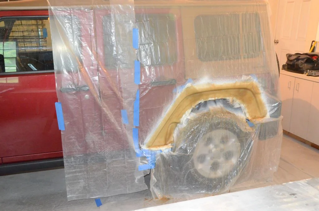

1. Mask off all of the areas not to be molded. Be over-cautious and use lots of plastic sheet to avoid overspray.
2. Liberally apply mold release wax and when that's dry, spray PVA mold release film on the area to be molded (no photo). Wax protects the body surface and PVA protects the wax with a water-soluable plastic film over the area.
3. Spray gelcoat (a special resin that forms the surface of the part) on the area and follow that up with fiberglass layup - fiberglass mat soaked in resin. Gelcoat:
