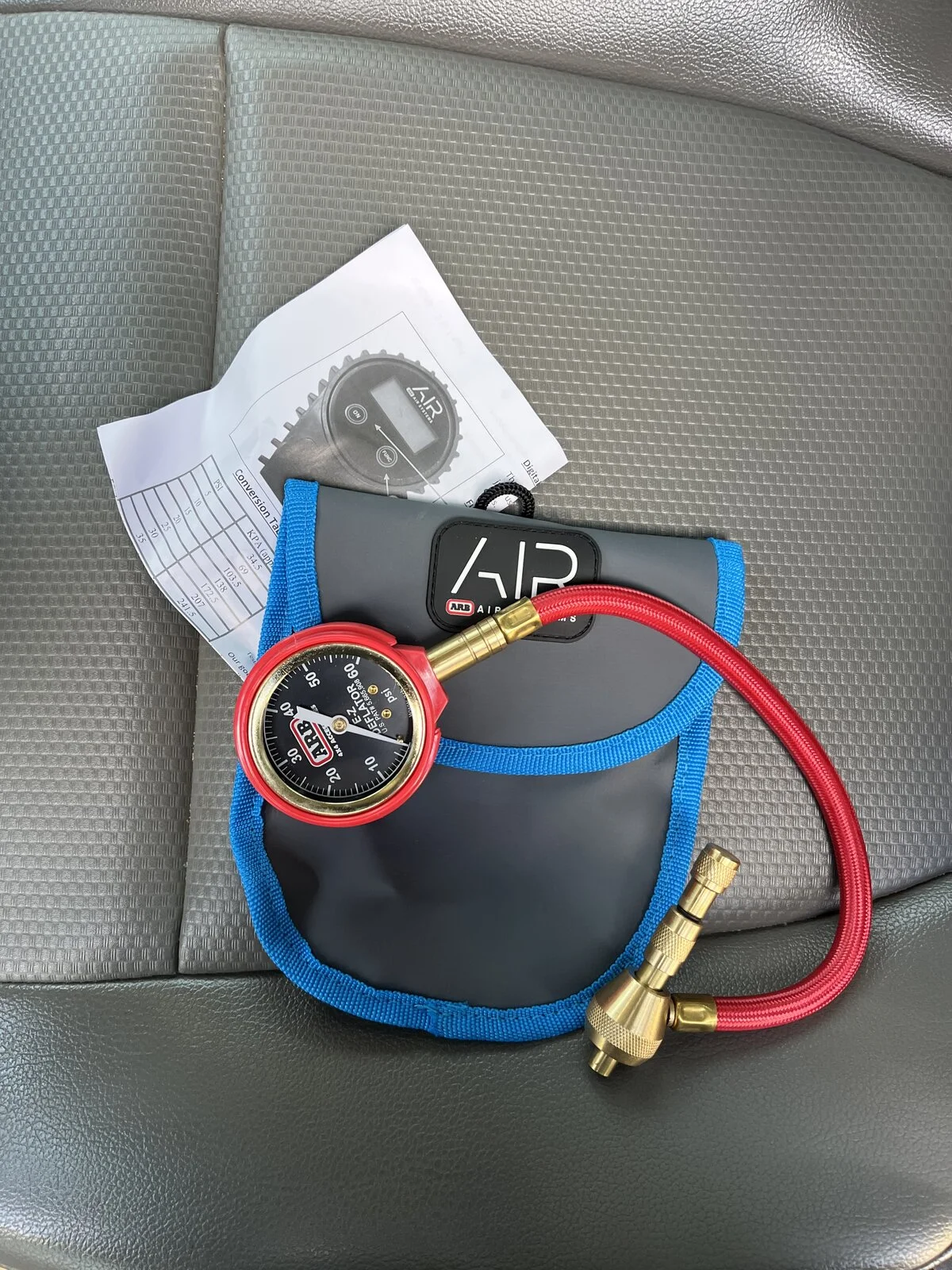

I just got this new toy in the mail 😀. Who has this? Seemed to be the way to go. How ya like it. I have to figure out how it works now.
Tell me about it if ya want. Or did I waste my money? Lol

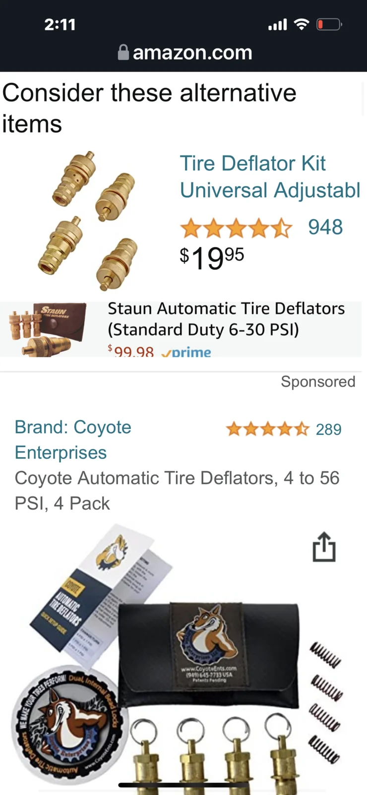

Coyotes are nice from a set it and forget it perspective - but I've found them to be somewhat inconsistent since we change so much altitude here. I keep meaning to try to calibrate them again to see if that'll fix it or not.

I've owned mine for years and it has worked well. I've never lost a valve stem--that's a real plus (even though you should have a few stashed in the jeep somewhere). I've stayed with it because I air down to different amounts for different conditions. Sand? High speed desert? Slickrock? Snow? I'm usually trying to air down the least amount that achieves the performance that I want. If I always knew that I wanted 10 PSI then the Staun's approach would be quicker and work better.

I don't have one of those, but I did consider it before I bought the Coyotes. They are really two different devices. The Coyotes are just pressure relief valves tuned to a set pressure. I have barely used mine, and so far, I'm not impressed with the accuracy/repeatability of them. I do need to use them a bit before I make a final judgment, though.
On the other hand, the ARB type deflator is simply a pressure gauge with the addition of a device that allows you to remove the valve stem, internally, to allow a faster deflation, and then reinstall it without loosing air. Not really that complicated.

That's a GREAT deflator, I have tossed all my other deflators including my set of Coyotes in the trash.
Screw the base all the way down all the way around the stem threads, then push and hold the center valve stem rod while rotating it a tad to get it locked onto the valve stem. Then while holding it against the valve stem, unscrew the valve stem completely, you'll hear the air starting to escape. Make sure it's unscrewed all the way. The deflator will hold the valve inside. Then pull the largest brass part, the lowest part, outward to open the big holes underneath it and the air will gush out. Push that part back in to stop the air flow to make air pressure checks then pull it back out again until it's at the right pressure. Then screw the valve stem all the way in and unscrew the main threads from the valve.
