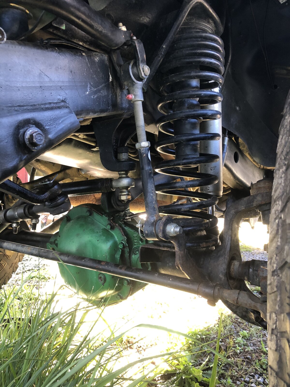

Hell yeah, this is what we call a LCoG build. What is that, maybe 2" of up-travel at most? You know, because the heavily biased down-travel is so much more effective when off-roading :LOL:
No bump stop either I see.
Reactions: D M
- Way to put the bumpstops above the cup.
- Can we hang our CA’s down any lower?
- Let’s not get the sway bar at least level
- Put our Fox shocks upside down
- Drop the TCase unnecessarily on a Rubicon because we’re so cheap we can’t buy or lengthen a Driveshaft
- Pumpkins are orange ya dumb ass
- More shocks upside down
They’re not upside down?
I’ve never seen those installed the other way around and they come with the bushings to be installed body up.

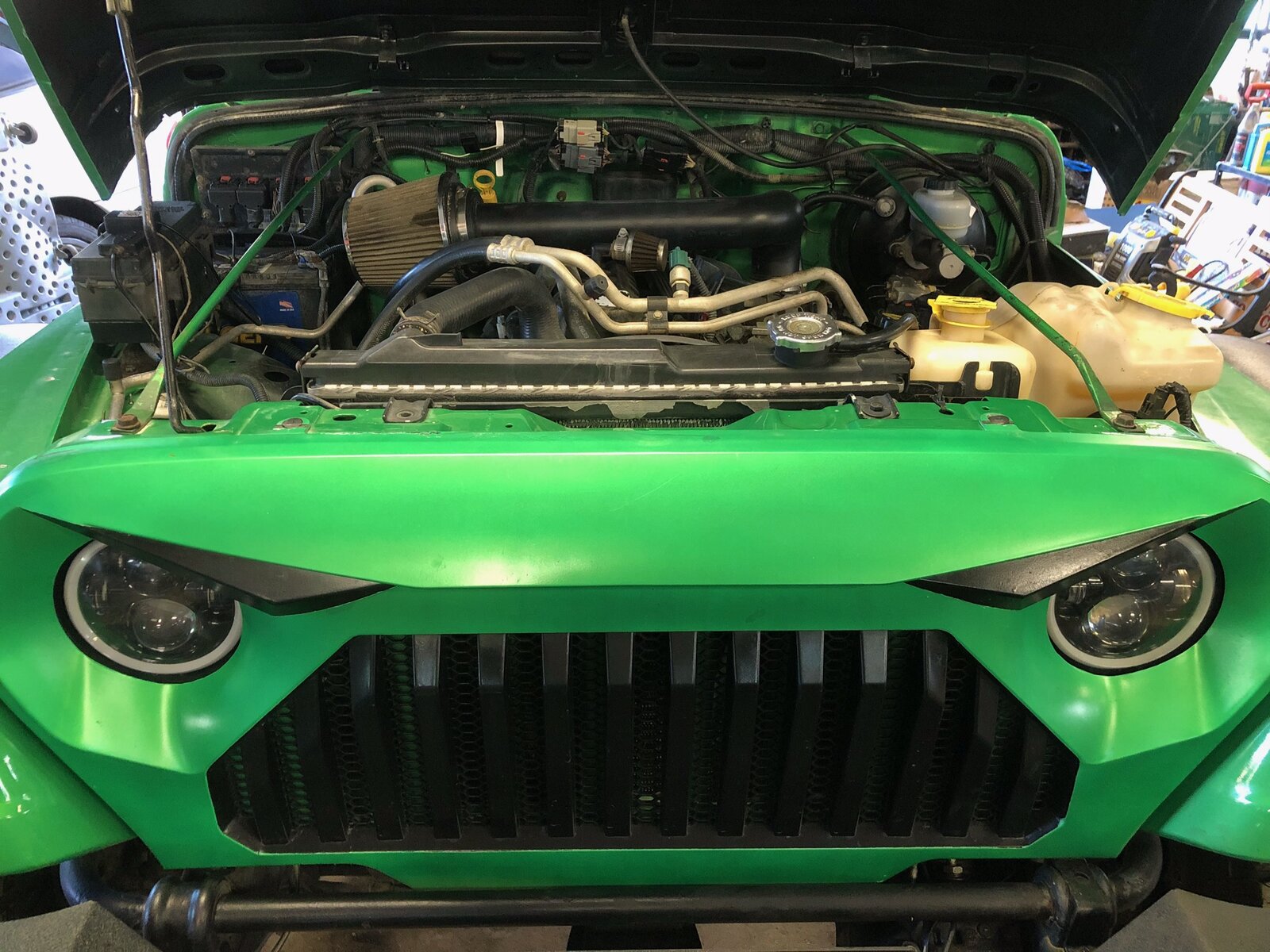

Just something I’m working on at the shop. It was recently bought and the owner is complaining it’s undriveable. I wonder why......
So far the list of shame is...

CAI
Led rock lights everywhere that don’t work
The battery has been flipped 180* so hot is almost touching the hood.
Can’t be LCoG on 6” springs, sorry
