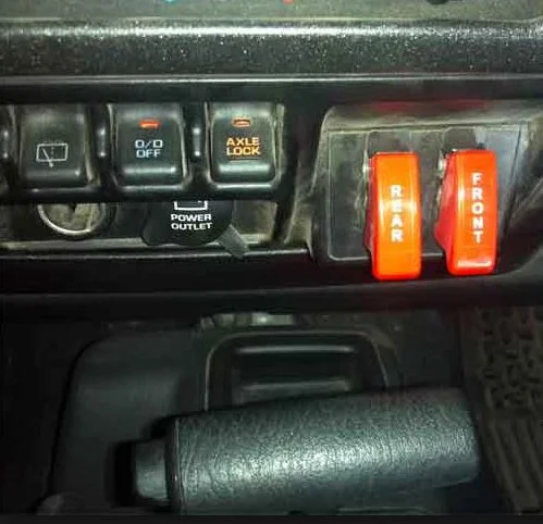

My (overly complex) Rubicon locker switching circuit stopped working so I replaced it with two heavy-duty on-off switches. It was simple to bypass the wiring, I just wired the locker compressors like I would 12 volt light bulbs with a 5 amp fuse for both compressors.
