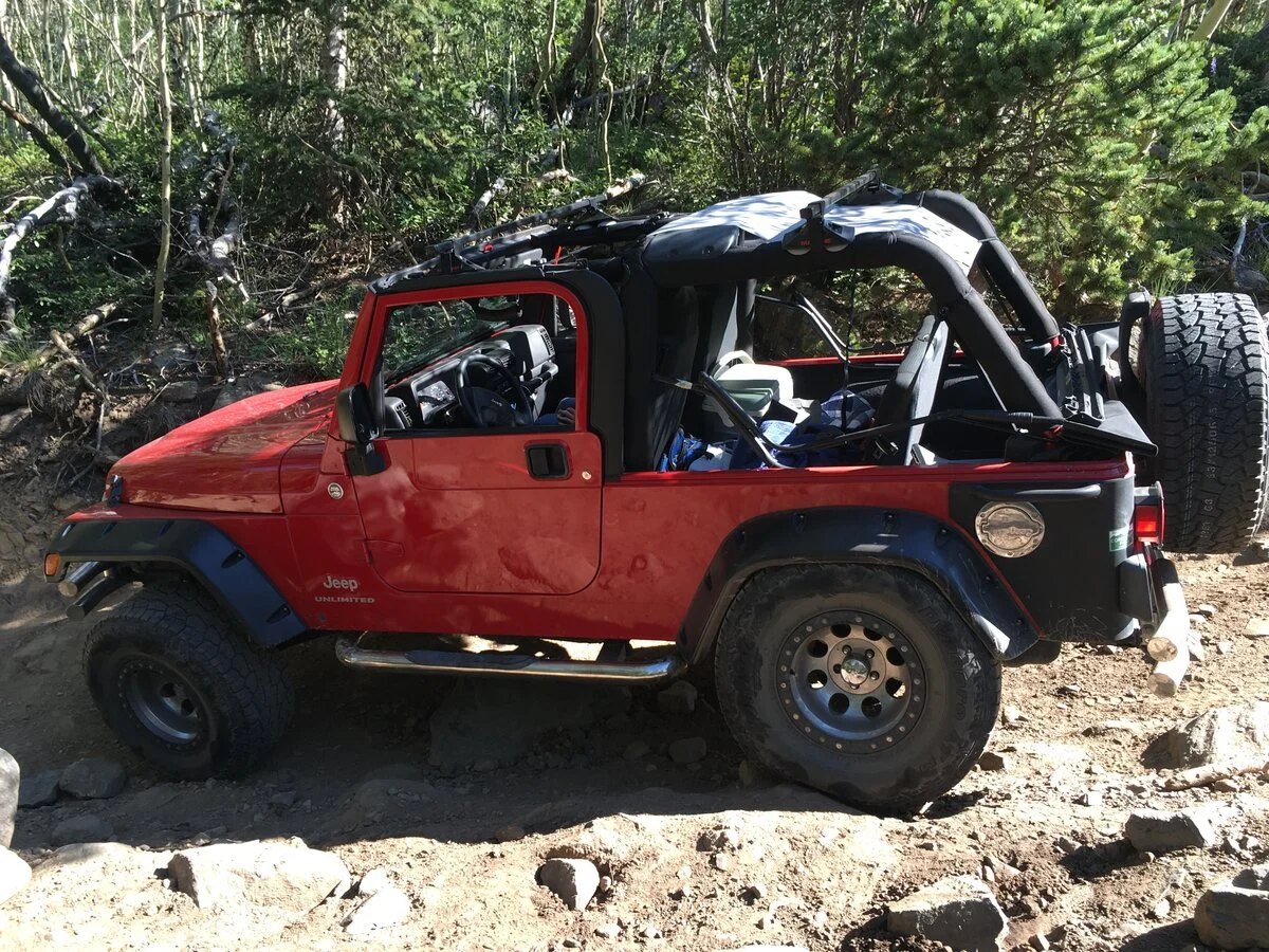

My son and I went back and checked out Red Cone. We did about 3/4 mile of the rough stuff before I decided I'd pushed my luck far enough. Stuffed the tire in the wheel well. My rig still needs some basics before it'll handle roads like that. Not to mention the driver needs some upgrades too. But it was fun and a good learning experience.
