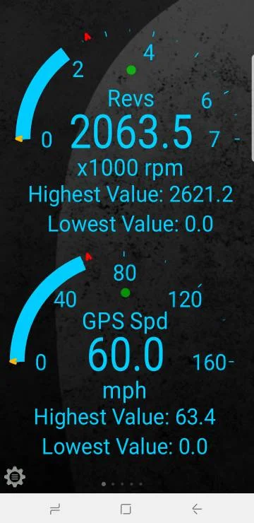

My 99 Sahara on 32 and 3.07 gears
4th gear and 5th
Sent from my SM-G950U using Tapatalk
