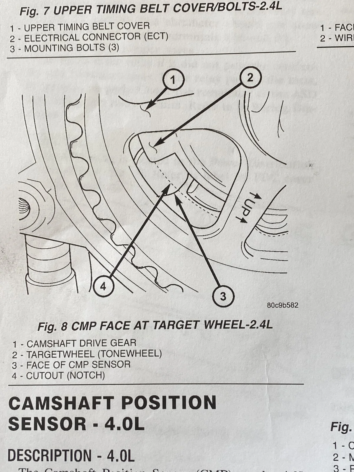

Sputter TJ Enthusiast Original poster Supporting Member Joined Aug 13, 2020 Messages 329 Location Jacksonville Apr 30, 2021 #21 Ok I think I figured out that it was the camshaft sensor. I went to install a new one per procedure and found that my 2004 does not have a tone ring like the service manual says it should. Am I looking at this right?

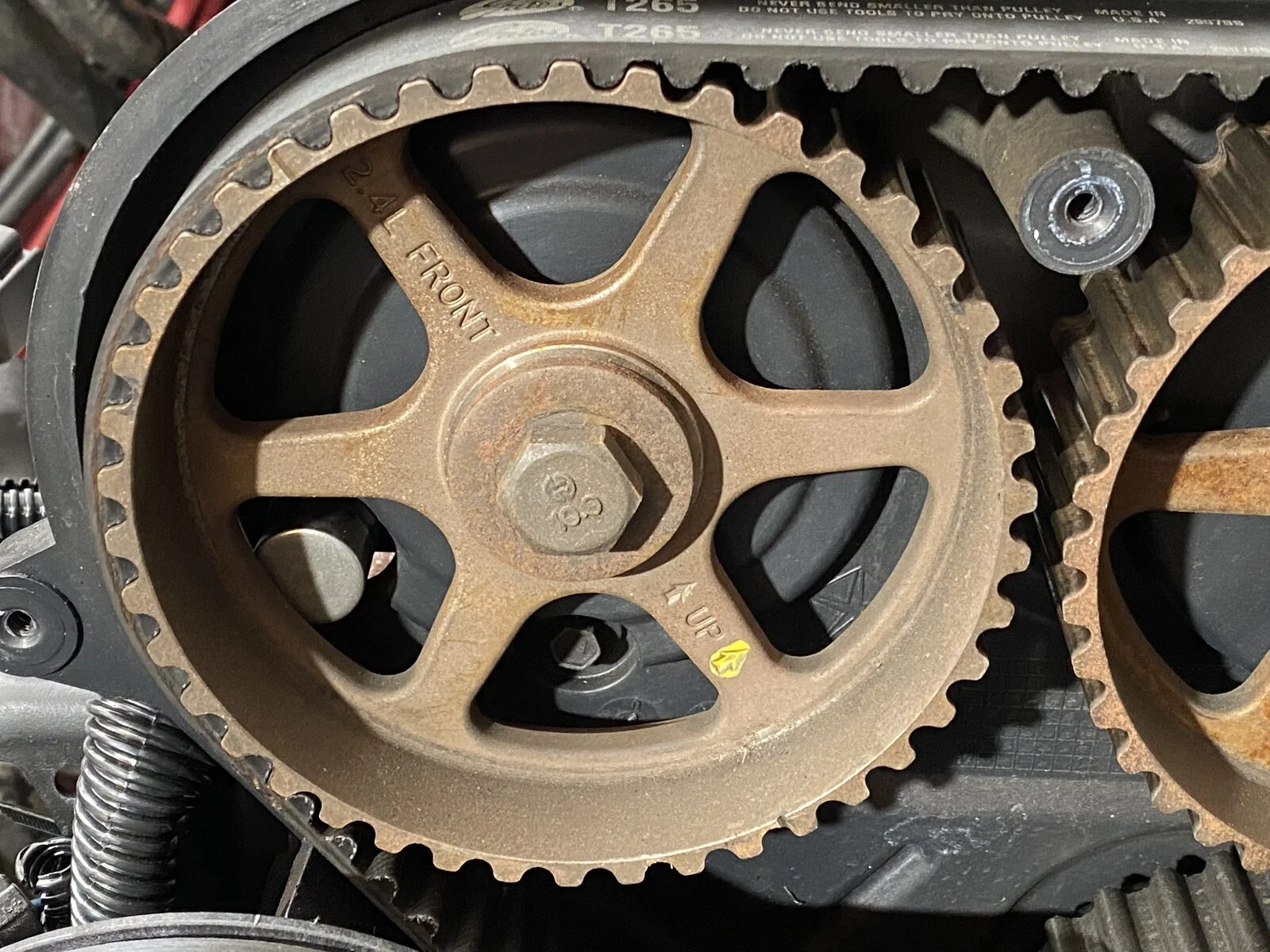

Sputter TJ Enthusiast Original poster Supporting Member Joined Aug 13, 2020 Messages 329 Location Jacksonville May 1, 2021 #22 This is what I am missing. Found a salvage yard out of NC that will sell me the individual part for $35. Crossing my fingers!
Sputter TJ Enthusiast Original poster Supporting Member Joined Aug 13, 2020 Messages 329 Location Jacksonville May 8, 2021 #23 Just to close this thread out. I did add the tone wheel and that fixed the issue.
