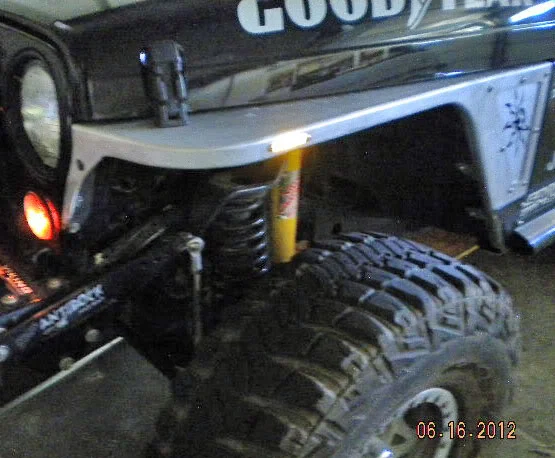

My LED front & rear sidemarkers work fine. The rears are part of the Savvy LED taillights, the front sidemarkers are just something I found online and integrated into the aluminum Poison Spyder front fenders I had just installed.
Are you running LED bulbs in the front fender side markers?
