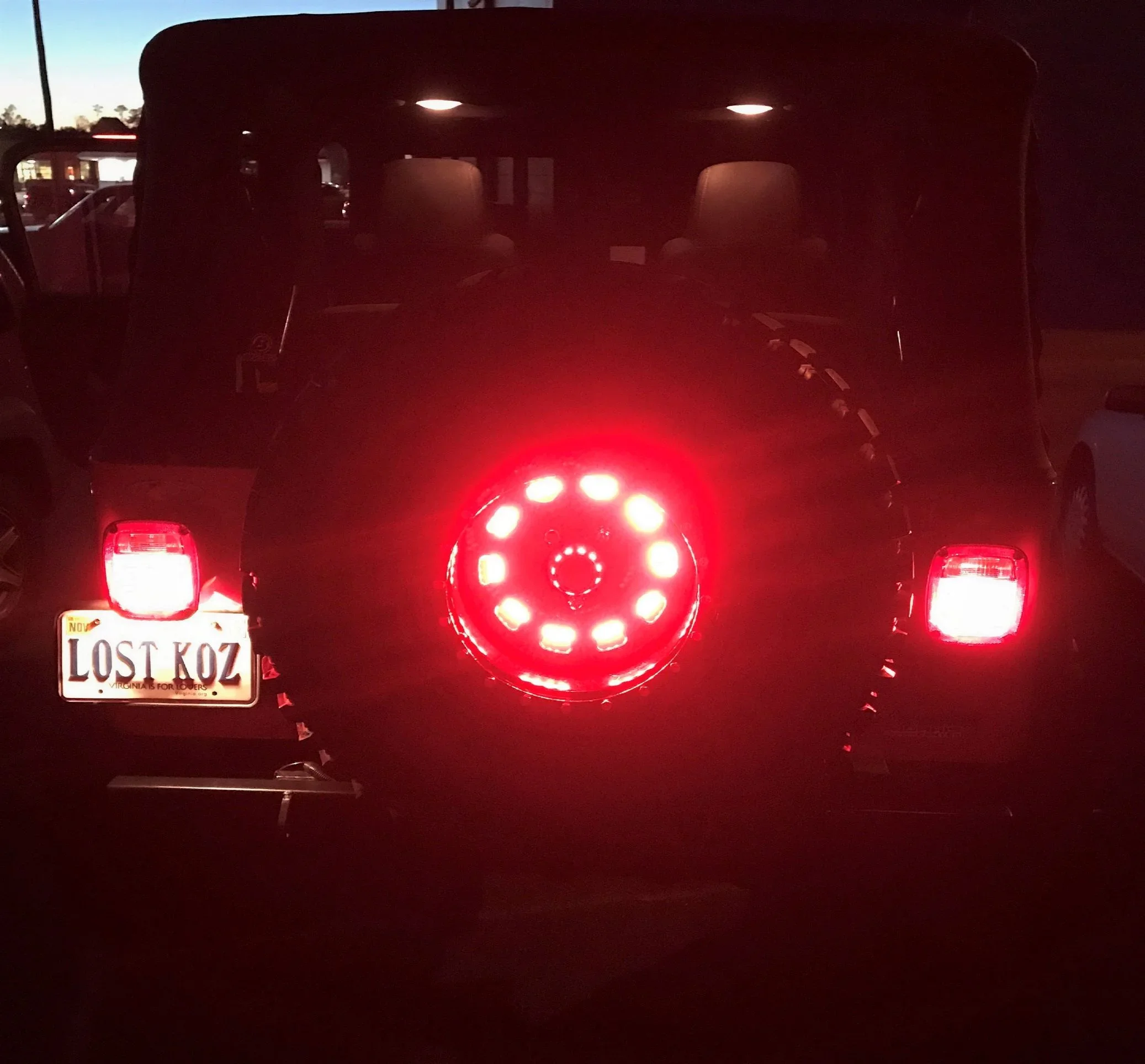

Then I failed the inspection because it had one of those LED rings behind the spare instead of the high mounted brake light.
I removed the ring and I made a bracket and installed an incandescent 3rd brake light.
Now my passenger side rear turn signal doesn't flash when the low or high beams are on. I tried an LED bulb in the lamp holder also.
Find a new mechanic.
Find a new inspection station. A working third brake light is all you need to pass.
That will be my plan for next year. I got my sticker today because for re-inspection he only checked the 3rd brake light and it was only $1.00. I did do spme reading and it seems the DOT only makes manufacturers stamp headlights and maybe something else with DOT. Brake lights do not have to be stamped even though they still need to be DOT compliant.

If a light is red it has to be in the rear and not flash to be DOT compliant. Your ring light is DOT compliant.

I couldn't speak specifically to VA or WV, but I think that depends a bit on the state (and maybe even specific inspection stations). Some are quite dickish about the vehicle being configured with original equipment as it was from the factory, so the ring light would be an automatic fail.
Swapped back to the ring and will go somewhere else next year.

No bulbs at this point, everything is back to the way it was when I bought it and known to be working. Everything is an aftermarket LED fixture. It has LED headlights with integrated turn signals, small LED markers on the high line fenders, the ring of fire type 3rd brake light and sealed LED tail lights.
Likely that the problem came before I swapped the third brake light to make the inspector happy. It was just when I noticed it.
Definitely depends on the state. In WV for example, if the vehicle was originally equipped with a 3rd brake light, it has to have one in functional condition with no cracks or obstructions. You can replace it with an aftermarket unit, but it has to steady burn (no flashing), be mounted in the center of the vehicle, and be visible from 100'.
