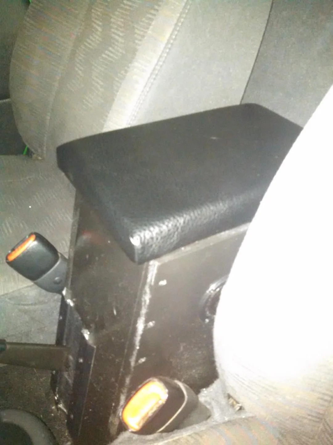

My 2005 SE didn't come with a center console or should I say armrest? It came with 2 cup holders that's it. I did some research and found a few I liked but they were very expensive around $400. I almost bought one but instead I decided to build one. Normally I am totally against using wood for anything on a vehicle but this way I could build it to the specs, height, I wanted. I absolutely had to have an armrest and I could easily mount my CB radio inside of it. I know this is not for everyone and it's not great looking but very practical for an armrest, CB radio, and pistol holder. I also put 2 small speaker grills on the side to hear the CB. Total cost around $50.
If someone wanted to make a homemade console look a little nicer, the screw holes could be filled in with wood dough and sanded smooth. The exposed wood grain could also be slicked in and sanded smooth. A heavier, high gloss paint to make it look more like plastic would also improve it cosmetically.

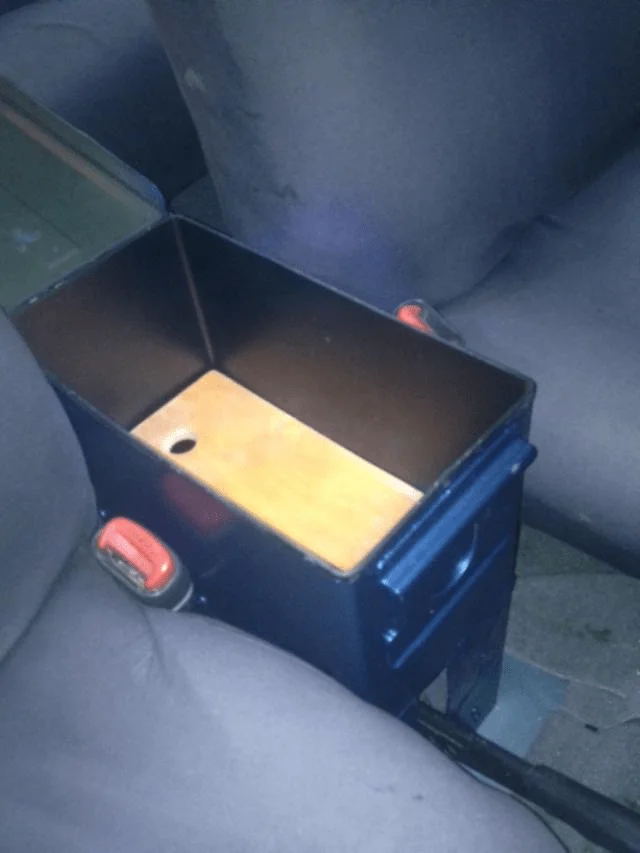

Heres mine in our 04 Willys, I used a 40mm can for the bottom with a 50 cal can on top, the height is just an inch or so over the factory, perfect for me as an arm rest being 6'2. I used a park brake handle out of a scrap fork truck from work for the park brake the only odd thing is that with the way its mounted down is setting the brake but it works like a champ and is adjustable to boot. I also mounted my winch contactor inside the 40mm can so my controler plug and everything is inside protected.
