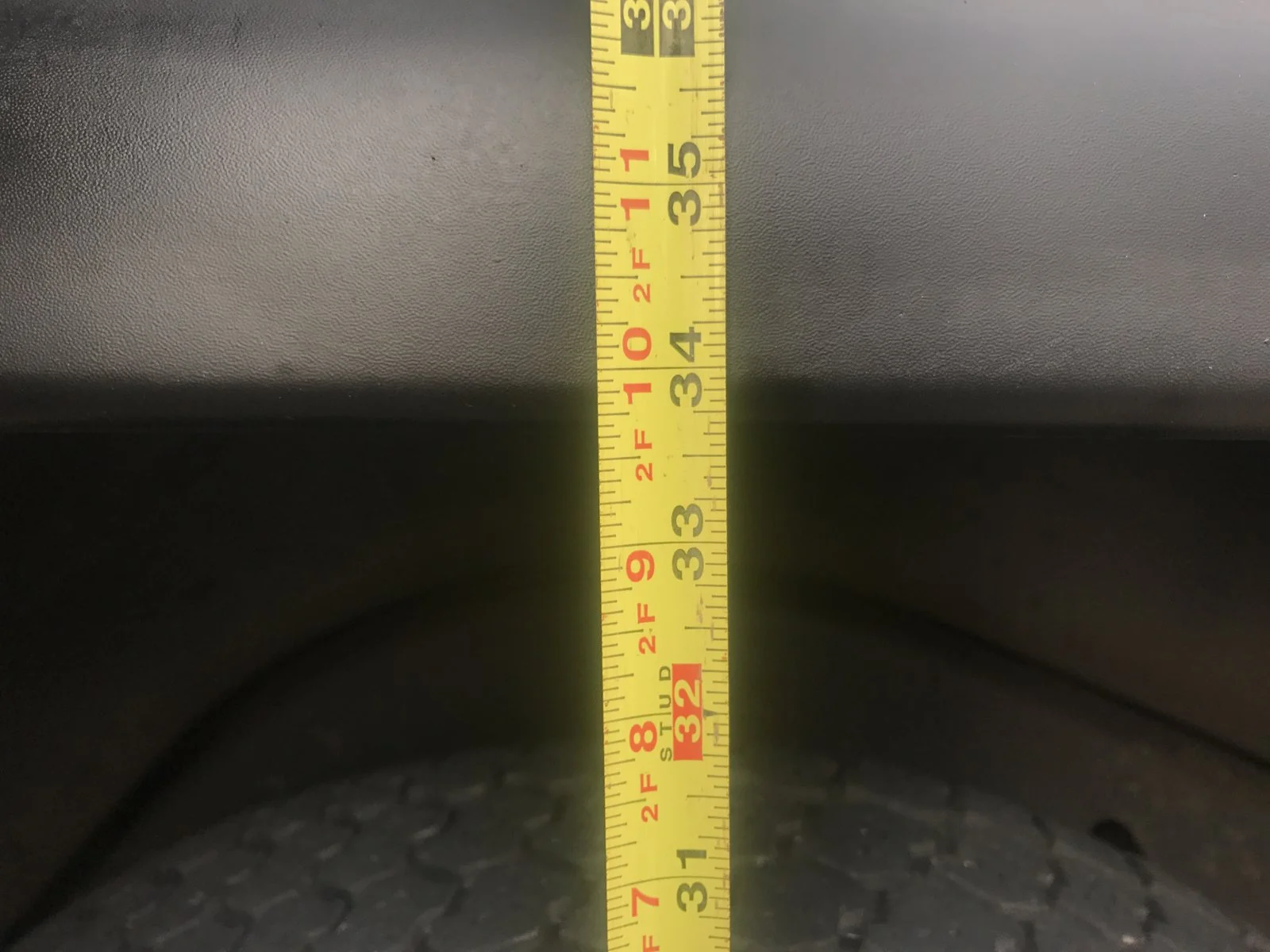

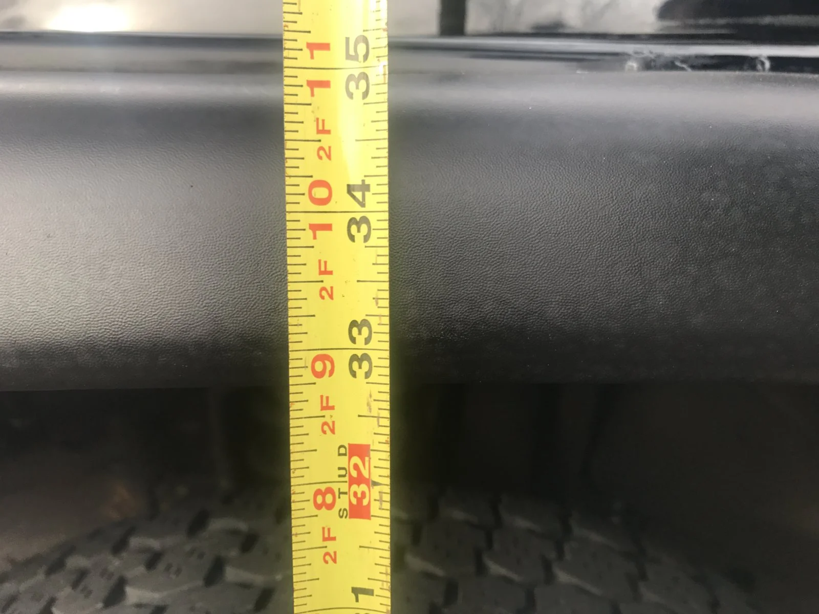

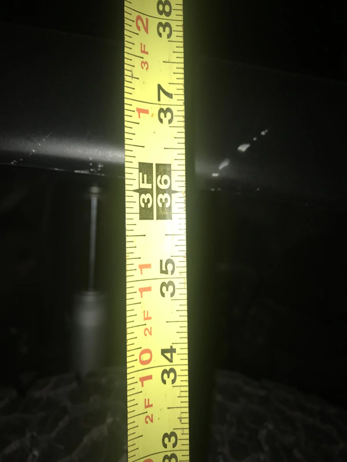

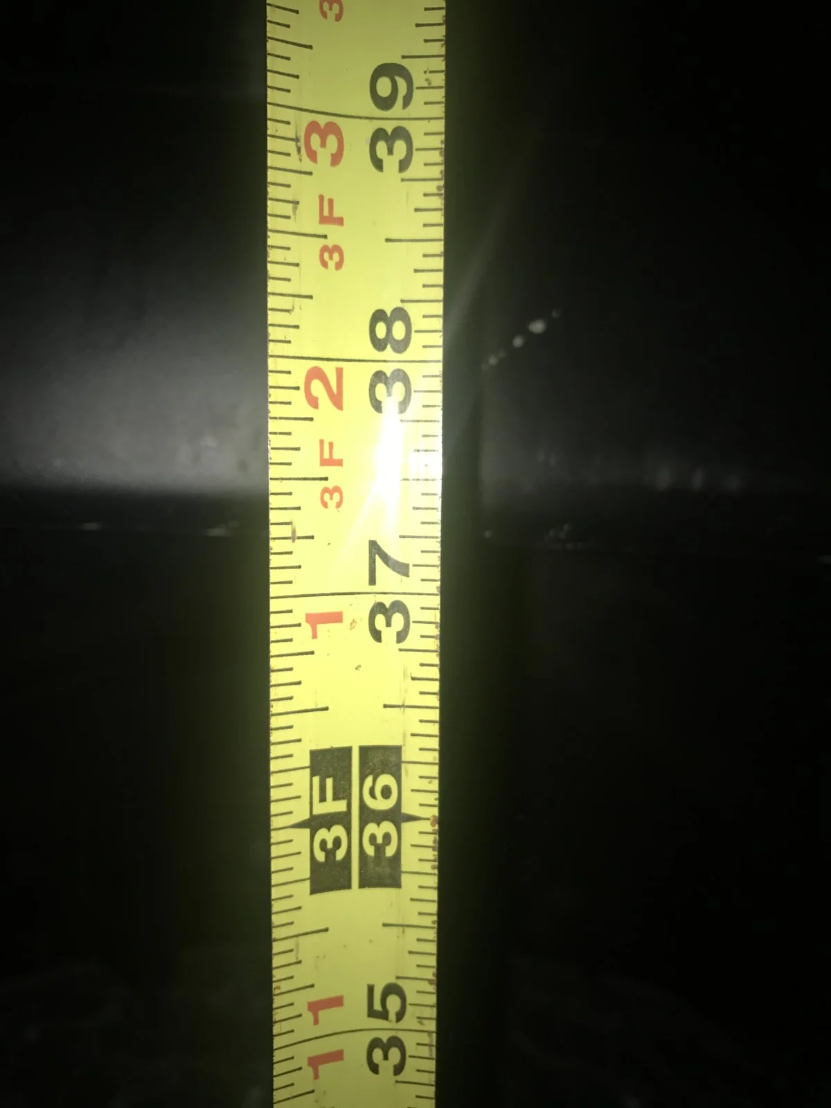

Here are my measurements before and After with BDS 2" lift kit and 31" BFG Tires over 30" stock tires
Before Front:
After Front:
Before Rear:
After Rear:
I measured from the floor to the frame just behind the lower control arm bracket on the crossmember side. tire air pressure 28 all of the way around. I measured before and just after. I haven't even driven it yet but here are the numbers.
before
Right front 14
Right rear 14.5
Left front 14.5
Left rear 15
After
Right front 17
Right rear 18
Left front 17
Left rear 18
