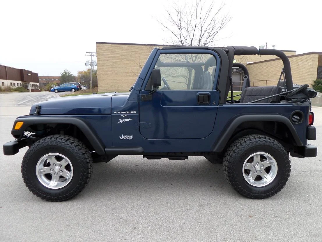

It wouldn't look too bad. There's a place called highland motors near Chicago. A lot of the jeeps they sell have 2" of lift and 31's which look really good. I'll post a picture for you later in the day when I get home so you can get a visual.
Reactions: Brag508 and Chris
1311_2.jpe
Here's a 1" lift and 31s
Ahhh, that's probably where I should have stayed. 2" lift and 31" tires... Here I am $10,000 plus later.
If I ever lift mine, 2" is all that I will do. I personally like the stock look of my 02' sport with rubicon wheels and 245/75/16 tires. But 2" of lift just gives it that extra aggressive look without making it a pain in the ass to get into. I'm 5'7" and my wife is 5'1". That last thing I want to do is make it a pain for her or our 3 girls to use.
No kidding. Makes me appreciate the 2-2.5" OME & 32" tires I decided on! I have to say that I had a dark blue '97 TJ Sport with OME lift and 31" tires some years ago; the photo above could be the Jeep I had. Loved the look and the way it drove/handled.
