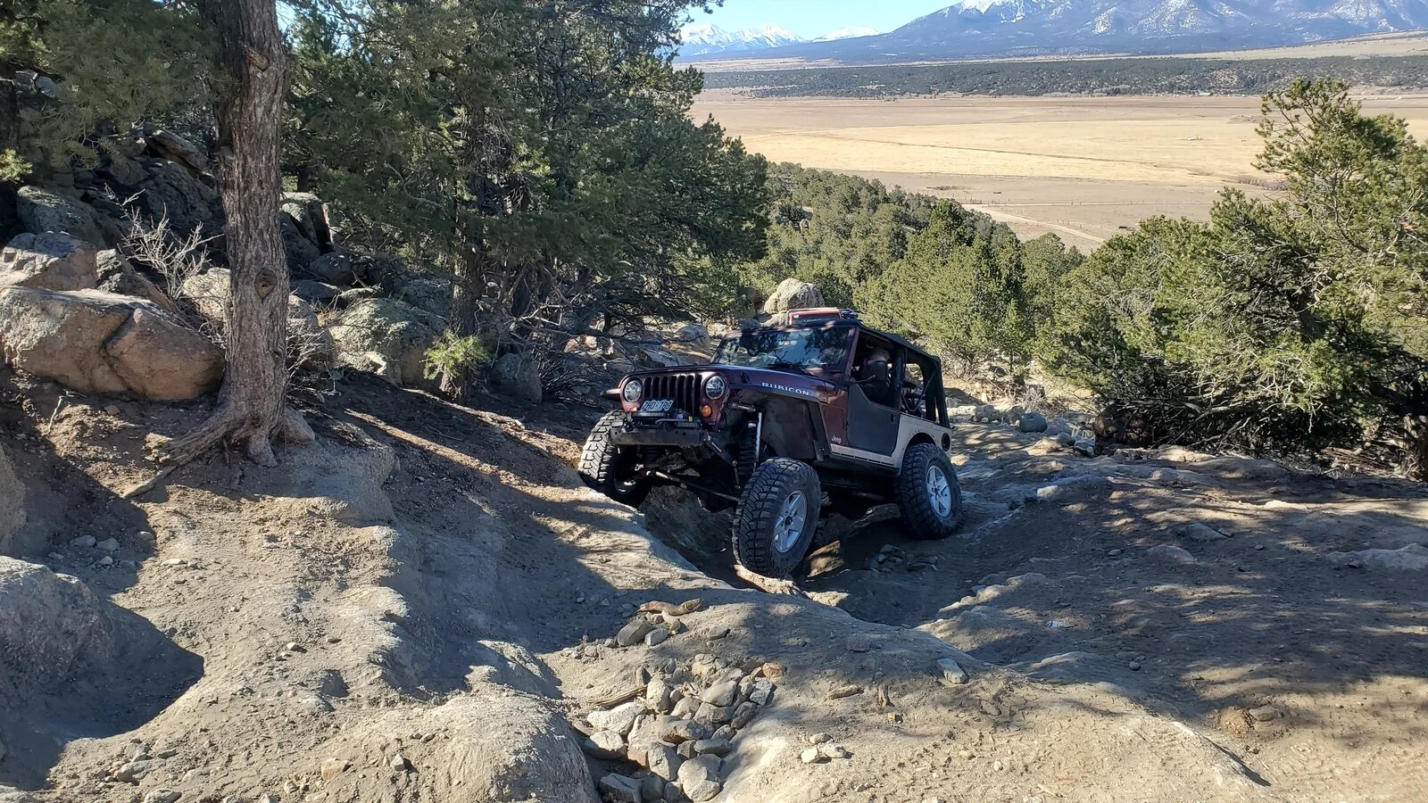

Your factory front sway bar restricts articulation. The Antirock does not restrict articulation. It is ultimately the shocks that allow as defined the limits of the articulation.
This is mine with 12" shock travel on both ends and its articulation is not being restricted by the sway bars either.
