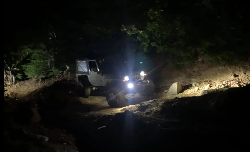

I have my led headlights, some underbody led rock lights, but then I added a couple of small 'flood' lights on the corners of the bumper pointed down and out to the sides at nearly 45 degrees. For me they help a ton when cresting something or going around tight curves/drop off etc. Below is a pick taken last weekend by a friend, the underbody is just enough for spotter to see rocks under me without being blinded, the one corner flood happens to be pointed at the cameraman here :) so it's bright but you can see the main spot it hits on the ground to the passenger front side.
There are more extensive setups, but this works for me most of the time and was relatively inexpensive + easy to set up.
