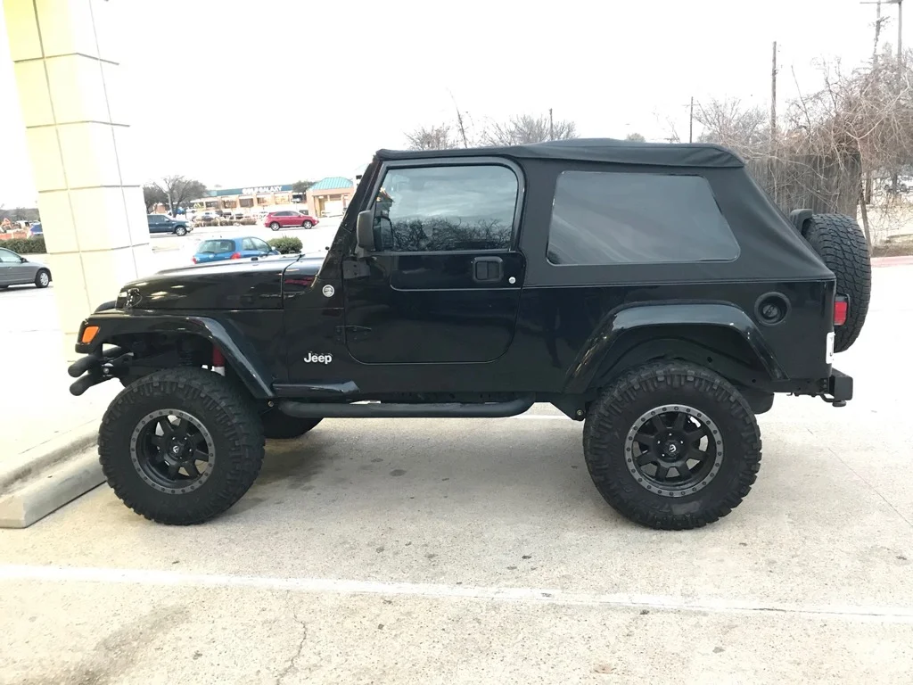

3 weeks ago I installed the currie 4 inch lift by hand and only installed springs, extended bumpstops, adjustable upper/lower control arms and adjustable trackbars. No SYE/CV deiveshaft needed. Ive had no vibrations or anything. I decided to go with the RS5000x shocks
Heres a pic with the lift installed with my 33in tires
I was originally going to do the 2.5 OME ultra lift since it betted 3.75 inches but after talking to Jerry I went with the full 4 inch. He pointed out the LJ needs a little more lift than a normal TJ because the breakover angle is worse (due to the longer wheel base). Also just installing 4 inch springs and control arms are easier than installing springs + MML + BL. You’ll do more work for no reason if you do the combo (if you install yourself)
