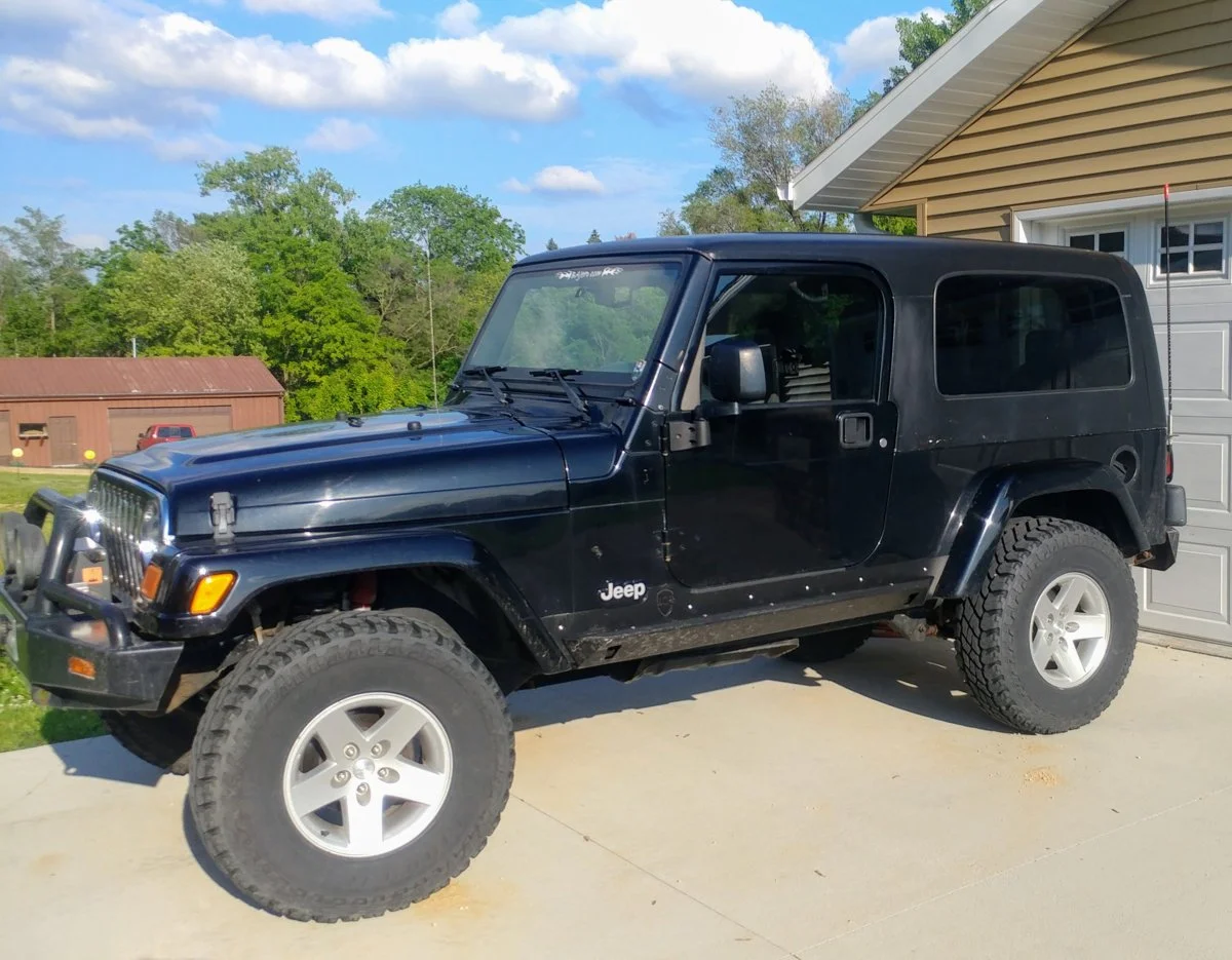

Thanks everyone for your help. And here's a pic of the LJ in question, just because.

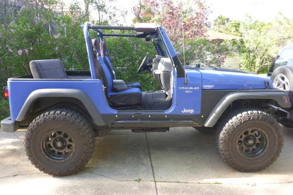

Here is a photo to give an idea of where the roll bar is cut and capped for the half-hardtop. I would agree with Sundowner in terms of utility, the half-cab might not provide what you are after compared to a pickup. Unless you typically have smaller payloads that will fit the back area and you want segregated from the passenger side.
On the other hand the half hardtop is unique and interesting. I removed mine because my kids were wanting to have more passengers. It was hell removing the divider because a PO had used bed liner. (I resorted to a fish fillet knife - took hours.) So if you go this route, consider installing the divider - in a way that will later allow easy removal.
