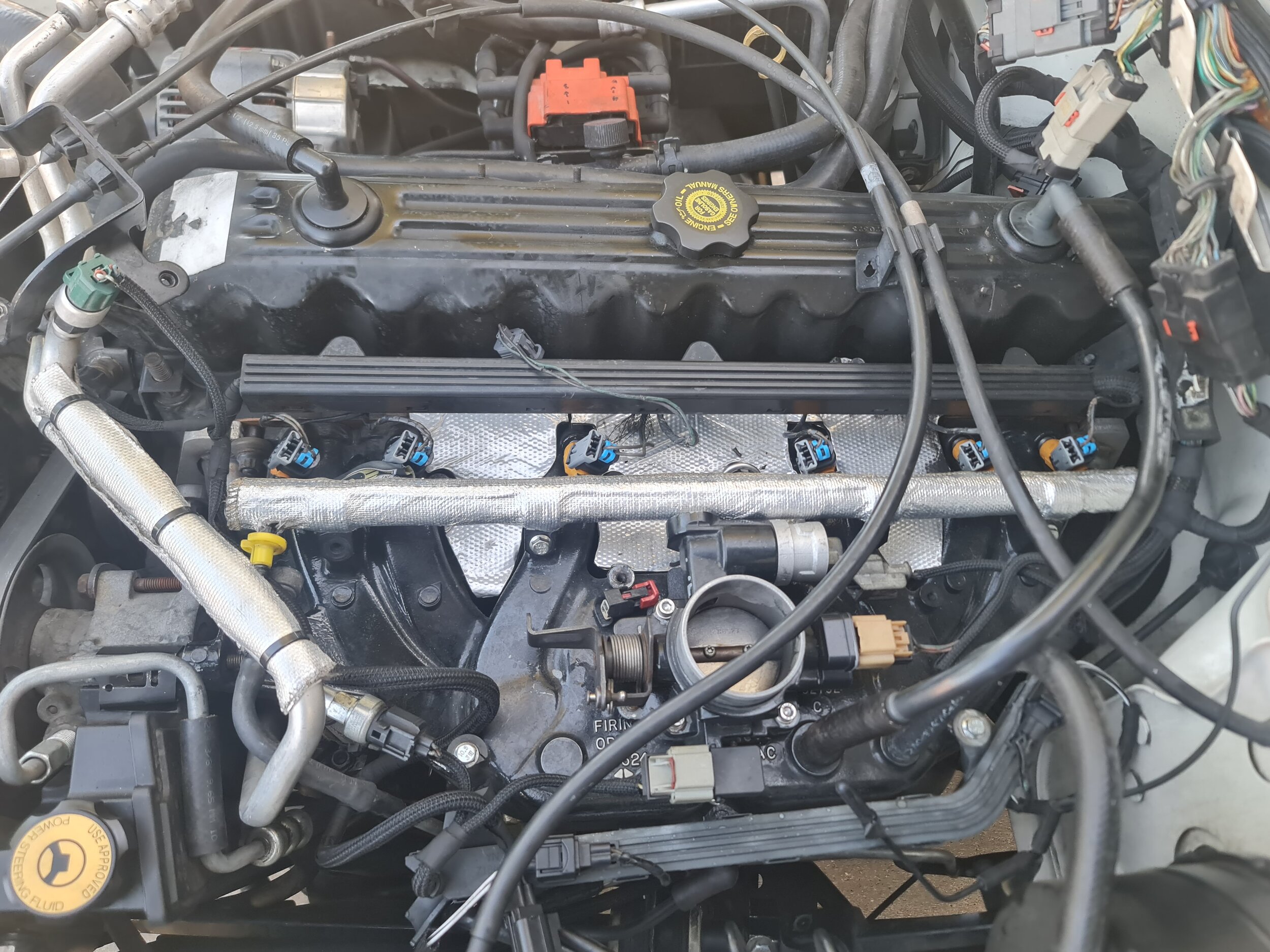

Yes that's an old connector sitting there,didn't realize it till I looked at the picturešŸ˜†*
As I mentioned a few days ago,did new injector connectors Sunday,Did new injectors today,About 2 hours worth of work the longest bit of work was cutting the old connectors off and pinning In new ones 😁
Long crank issue GONEāœŠšŸ¼. for me atleast
