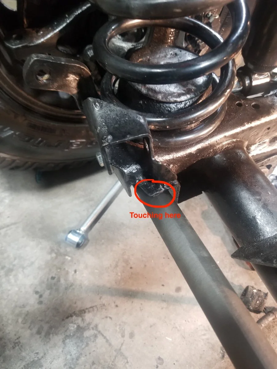

Yea, I didnt want to drill that hole. does the bar touchs at the top of the mount as shown in the attached picture?
That is the one of the reason am going to adjustable bar. my original bar is hitting that top so bad.
That Rough Country track bar is actually very good from what I hear. It bolts into the stock locations, but doesn't cause any interference like a lot of aftermarket track bars do. I typically don't like Rough Country, but I've heard enough good things about that track bar to feel comfortable recommending it.
