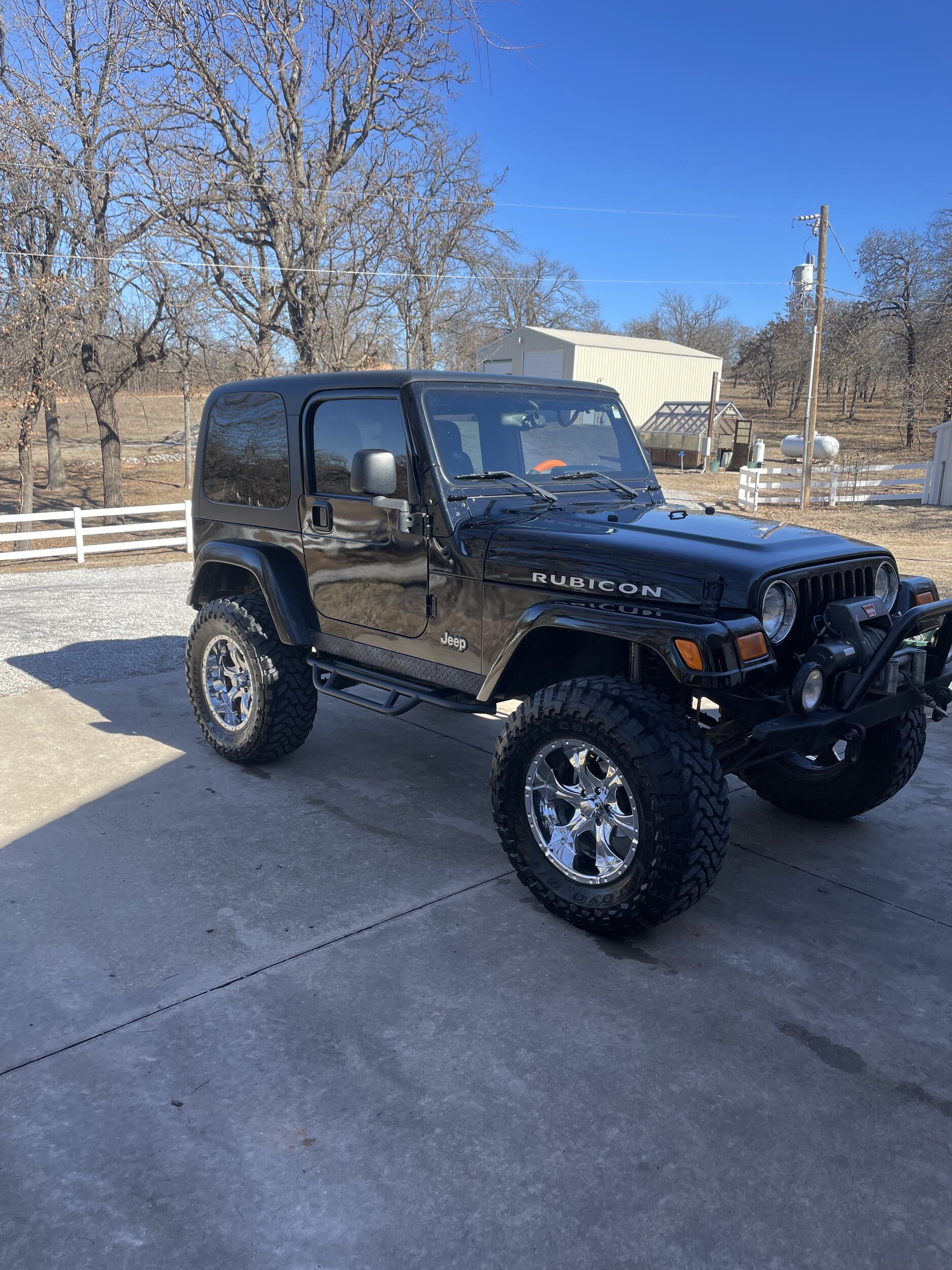

Fixin to pill he trigger on 35’s for an 04 Rubicon with 513’s and 4 inch lift in an All Terrain. Only off roading is hunting / pasture so want good road manners. Looking for recommendations. Is load range E too stiff? Thanks in advance. This is the Jeep . Currently has 18 inch rims and going tom17s. Yes I need to update my profile.

I wouldn't care about the load range all that much. But good call to drop those 18s, that looks like a high schoolers rig.

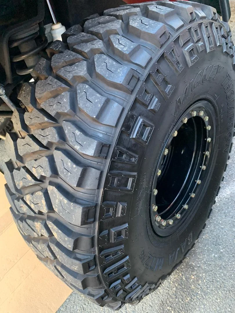

I have a few thousand miles on a set of 33” Baja boss ATs on my JK. They have a fairly aggressive tread for an AT and have very good road manners. For more casual wheeling they work great off road as well. . My last pair of mickeys on my TJ did get louder with time (even with frequent rotations) but overall wore like iron vs some of the other brands I’ve had.
