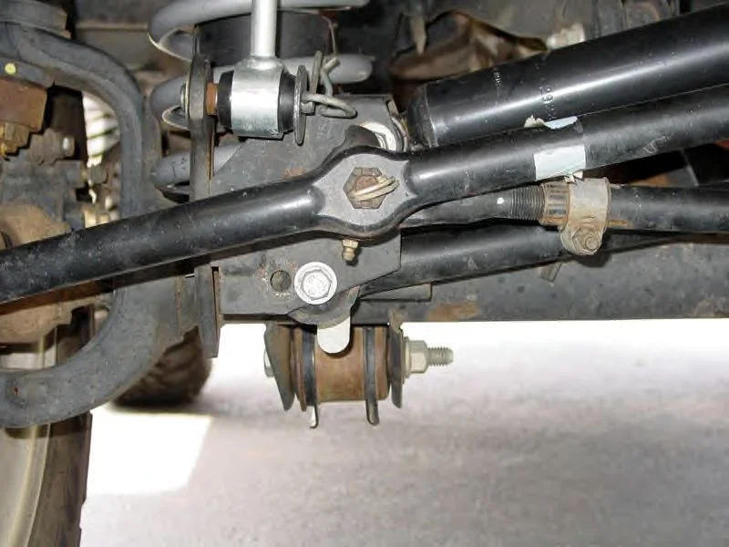

How can i tell if my axle is shifted? Been driving like tht for 3 years?
To put it simply with a 4 inch lift and stock track bar you should be able to eyeball it, the track bar should be closer to being parallel with the other components, not going diagonally really bad. Even just going from stock to a 1.25 inch lift I could see how my track bar had tilted upwards and away from the diff (stock track bar).
