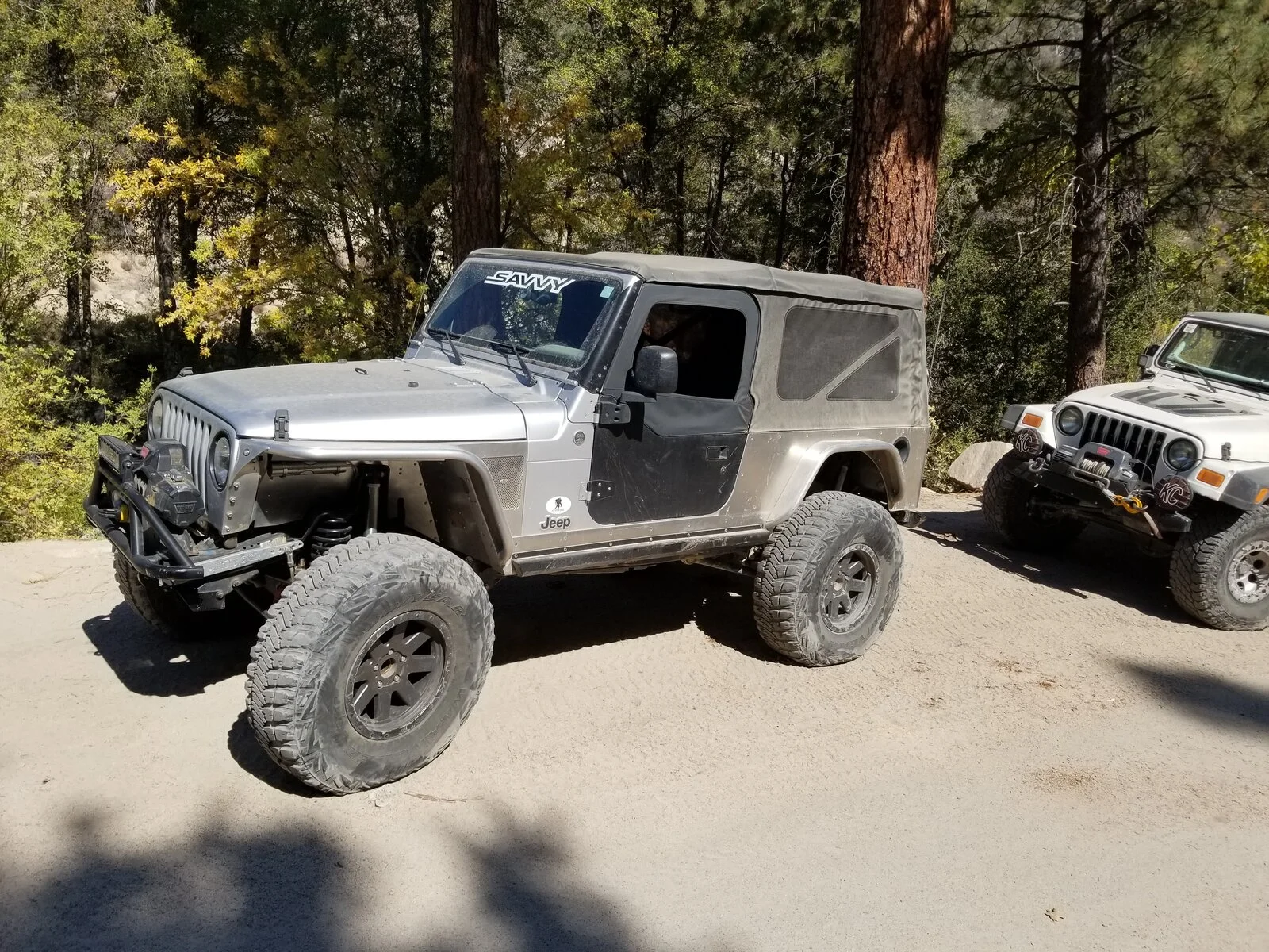

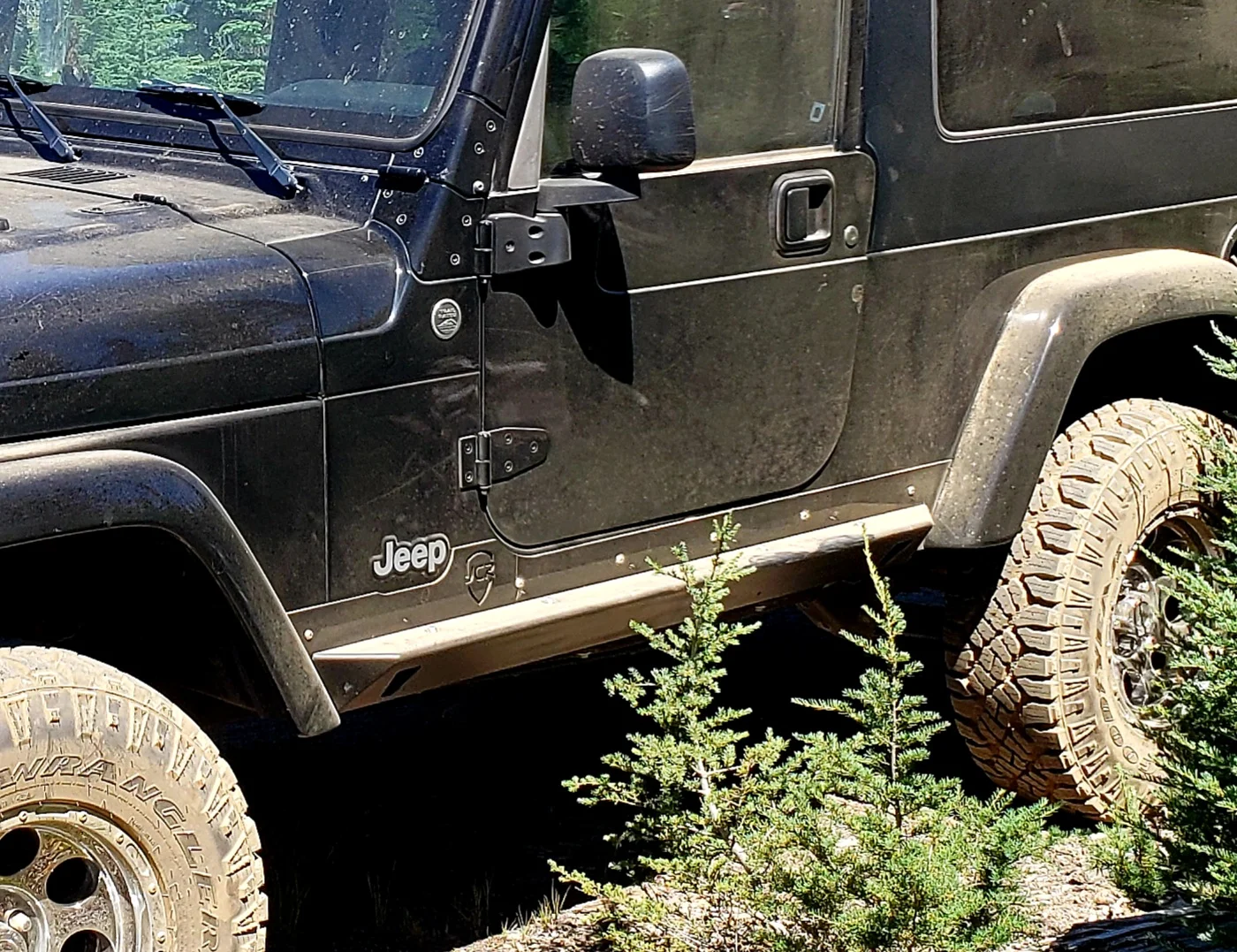

Looking to upgrade from my 3" tube step bars to some rocker panel or rock sliders. Prefer not to drill into the body but I will if those are all I can find. Anybody have pictures of their LJ rock sliders?

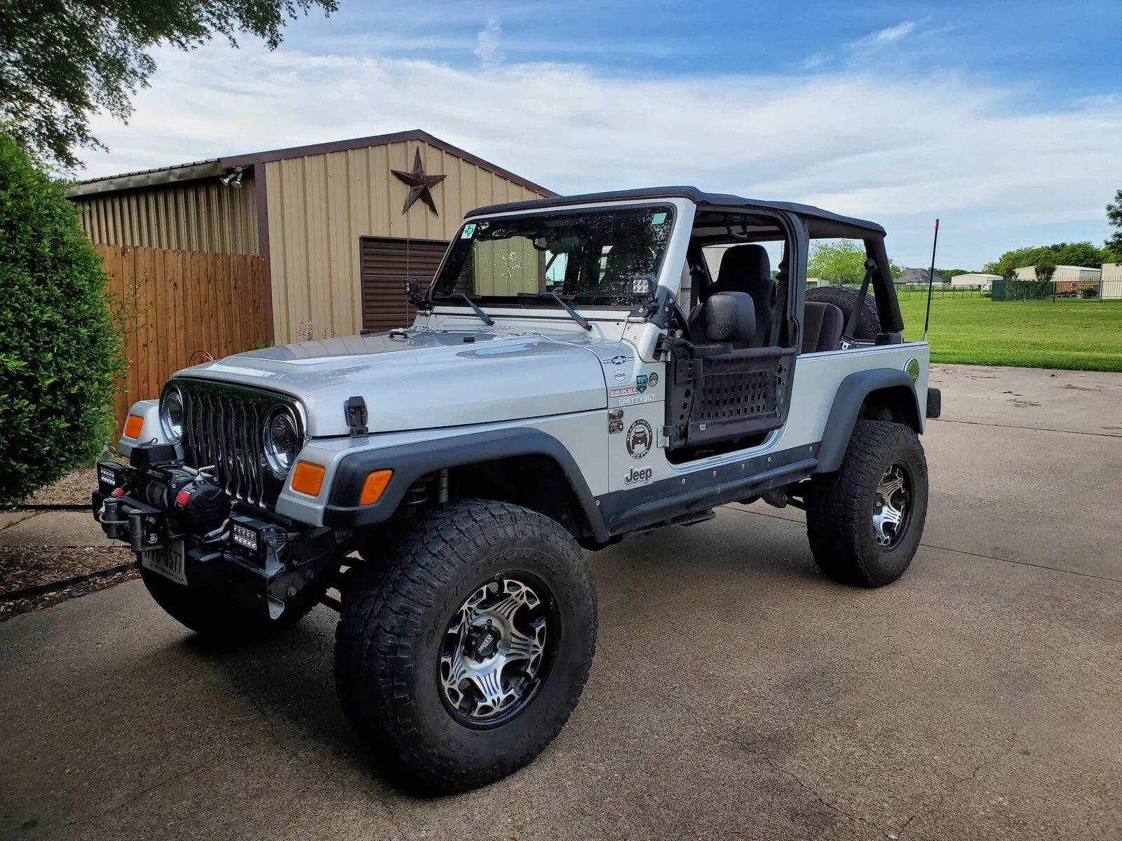

Those look like my A to Z fabrication sliders.Dont know what brand these are they were onView attachment 212063 it when I bought it
