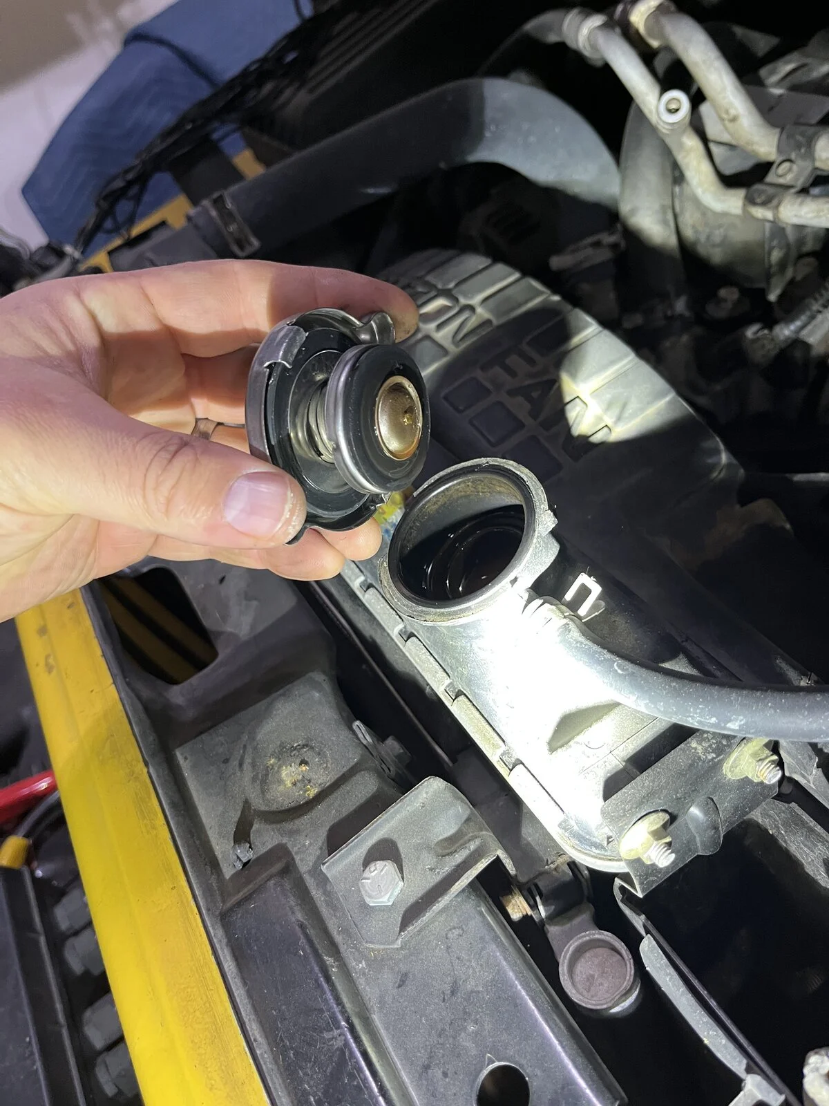

I'm losing coolant pretty quickly. I've done some searching around and my symptoms don't seem to be the same as any of the other issues I've seen.

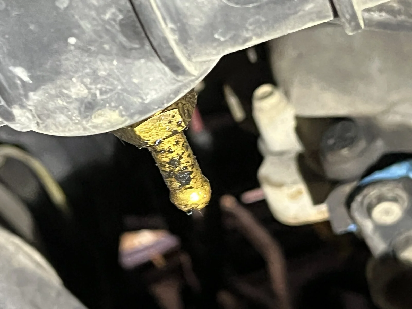

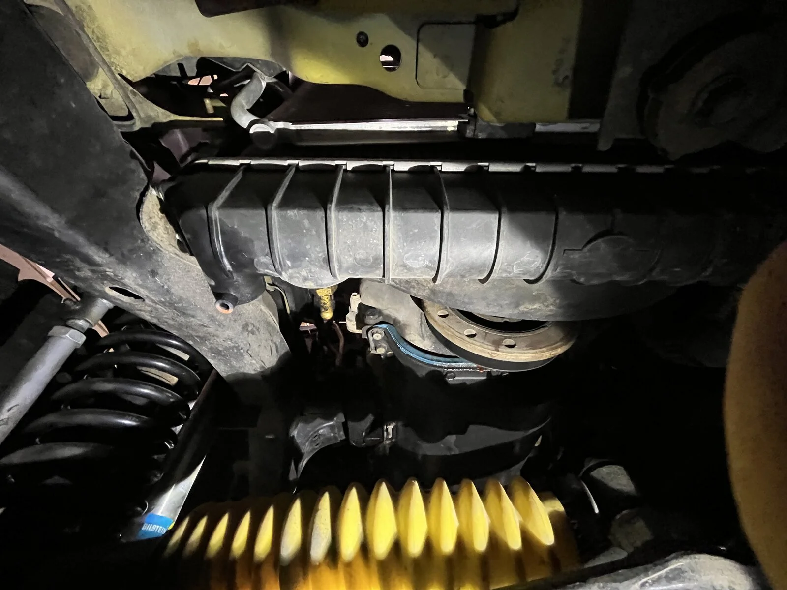

I have a 2000 Sport with the 4.0. Little backstory, I had a big overheating event last year. When I finally got home I was spraying cooling out the main hose. I replaced that, the thermostat, and 18psi rad cap and since then I've been able to consistently stay between 200-210. Looking under the oil cap I just have clean oil, none of the discolored build up the would suggest something wrong in the engine. I not noticing any big leaks, at least not to be the main source of losing it. The spout at the bottom of the rad on the passenger side is wet, driver side is dry. Should I just go ahead and replace all hoses to start with? Do a full flush of coolant? Water pump or rad replacement? Appreciate any help.

I'm losing coolant pretty quickly. The spout at the bottom of the rad on the passenger side is wet,

I appreciate all the feedback. Making me nervous! I'm going to check on the spark plugs and then do that test that was recommended.

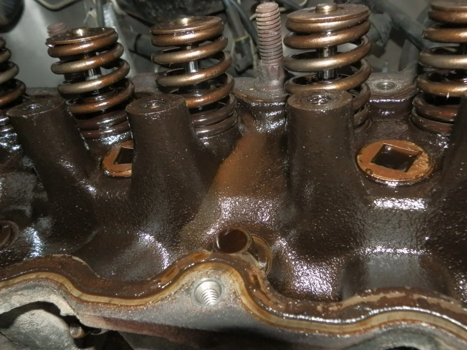

When they crack it's usually between cylinders 3 and 4, if I remember correctly. A tell tail sign is low coolant with no visible signs of leaks.
You can remove the valve cover and inspect. Here's a picture of what to look for.
