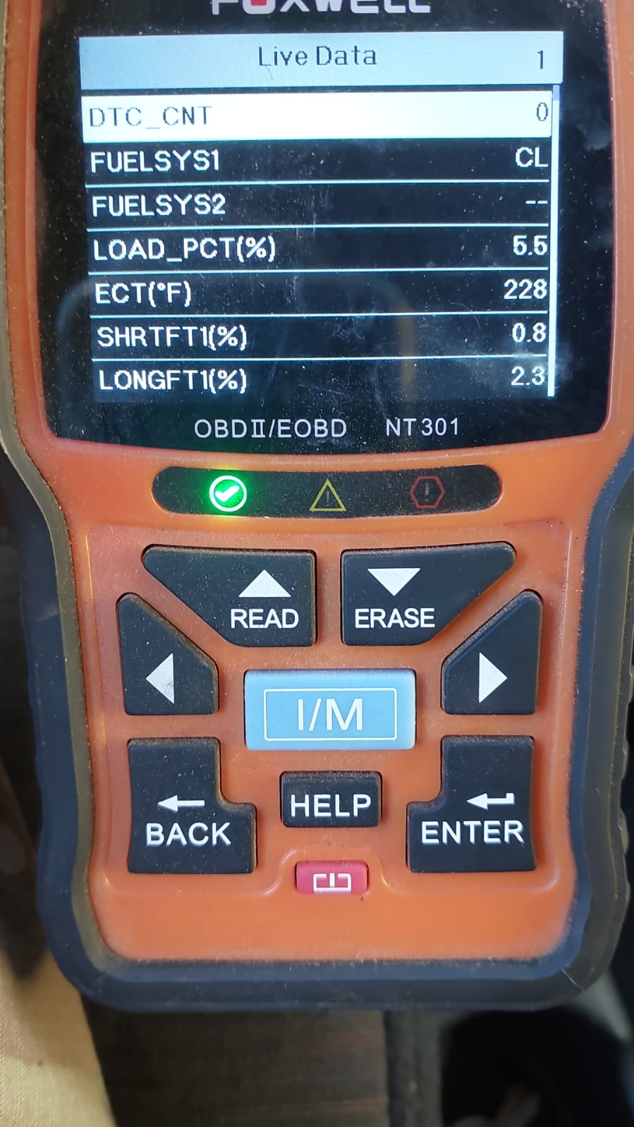

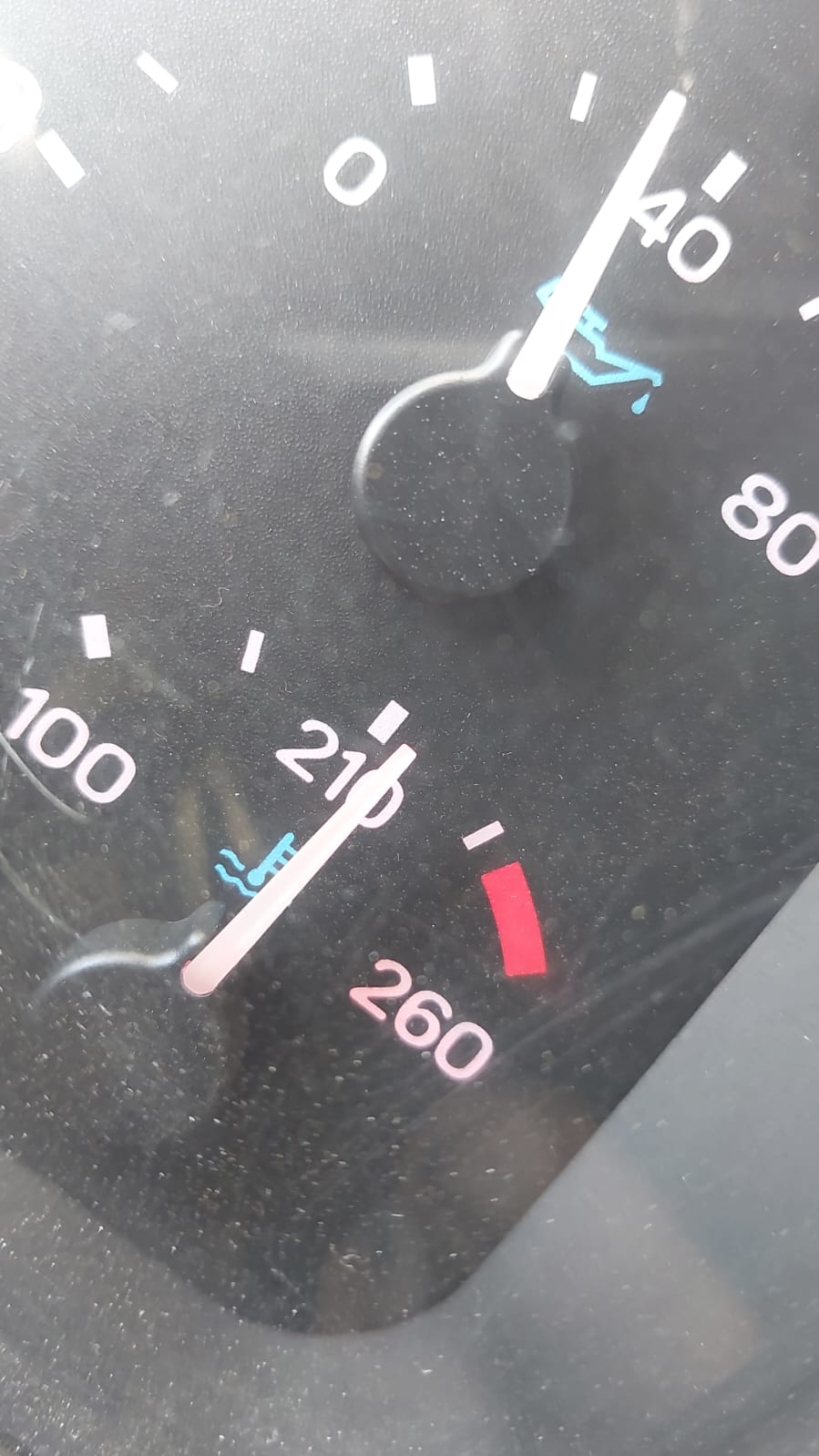

Well, maybe not.
I don't know why its reading two different temperatures, but this was after driving around for half an hour and then going up a steep grade holding 2700rpm, no AC on. Went from 210 on the dash to what the photo shows. So I hooked up the scanner and it says 228, but it was at 231 before the photo.
Well, maybe not.View attachment 567636View attachment 567637
Bummer. Does this only happen at highway speeds when more load is put on the engine? If so, that was my issue.
Based on my experience, I'd pull the radiator cap and check inside the top of the radiator for contamination. My OEM system would heat up at highway speeds if chips/debris gathered in that area. Another thing I noticed was that I couldn't trust my thermostat once my ECTs had gotten too hot (240-255* range).
