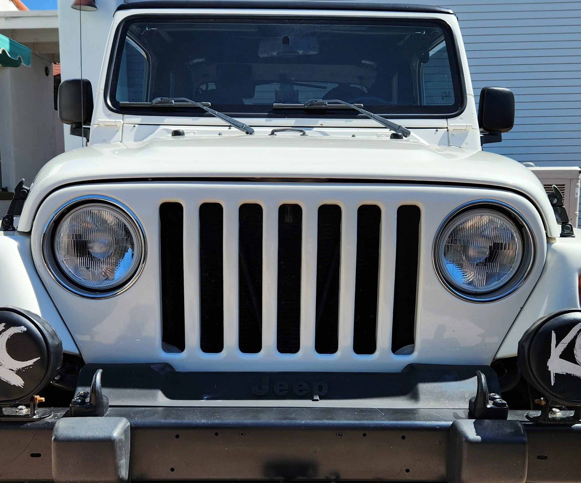

Napa thermostat, and I did remove the grills so today going to work I’ll see if it helps
