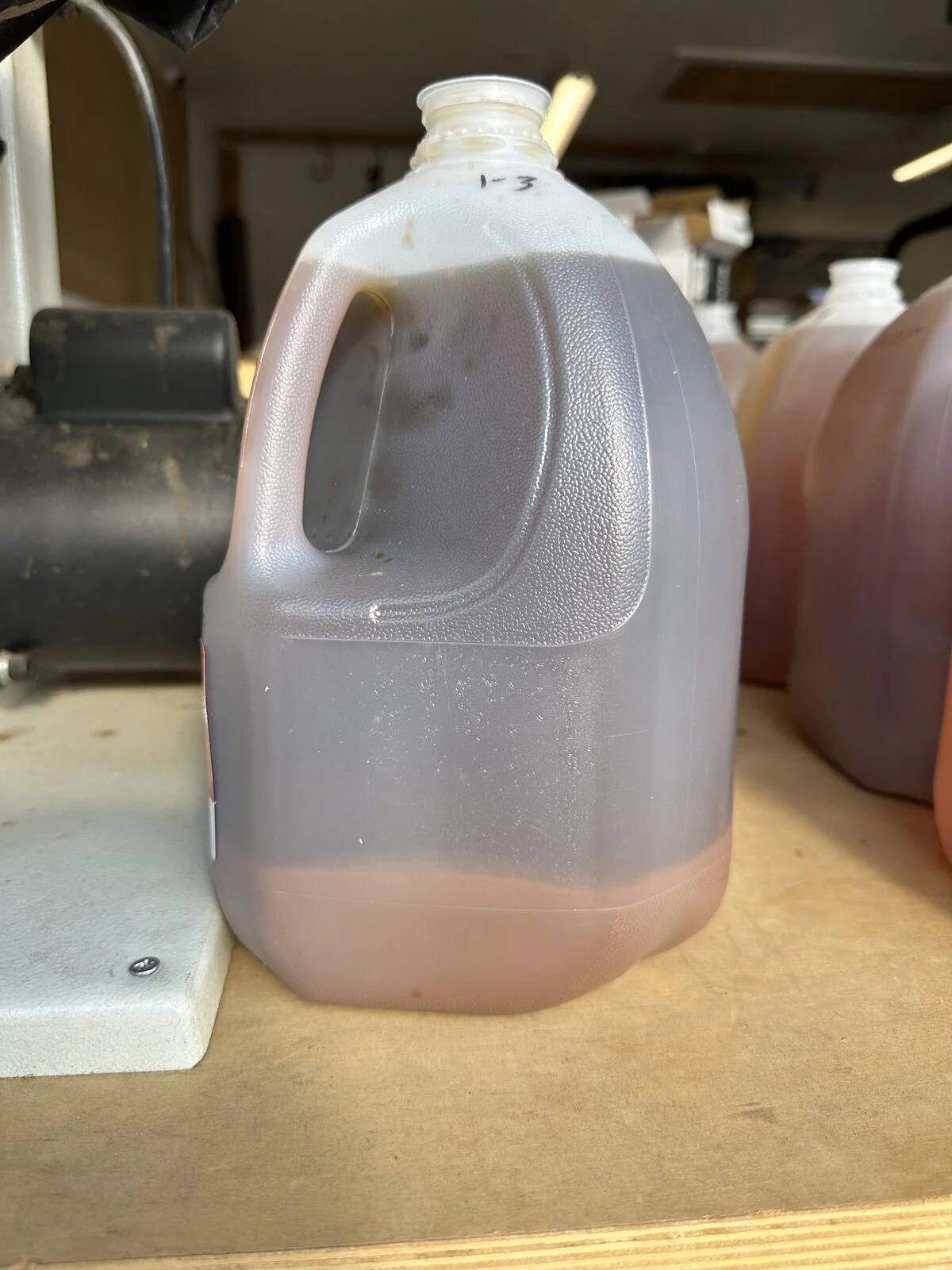

If you believe it's a circulation issue, have you flushed the system with Thermocure, and continued to flush it, until it's clear and clean, and free of residue particles? A clogged cooling system could be the issue if someone was mixing different coolants and messed up your cooling system. You should only use the recommended coolant specification easily verified by color and don't mix different coolant types. It has been known to cause casting sand and Jell-like substances in your cooling system which can clog it. See the pictures of another TJ cooling system with this sort of problem. Clearly, if you have stuff like this in your cooling system, it can clog it up. See the bottom of the collected flush in picture #2? You need to continue to flush your system until you see no residue particles. If it is caked, it may not all come out the first time, second or eighth time. It depends on how long it was left in that state. When it cools down, it cakes. Then, if the flow isn't great, it may not break up, and just continue to caked more and more. This issue has ruined some JK vehicles when the manufacturer changed coolant specifications, and just added the new coolant to the old coolant specification. Different coolant chemical compositions may be incompatible with each other and they may cause reactions, producing Jell-like substances and precipitations.
