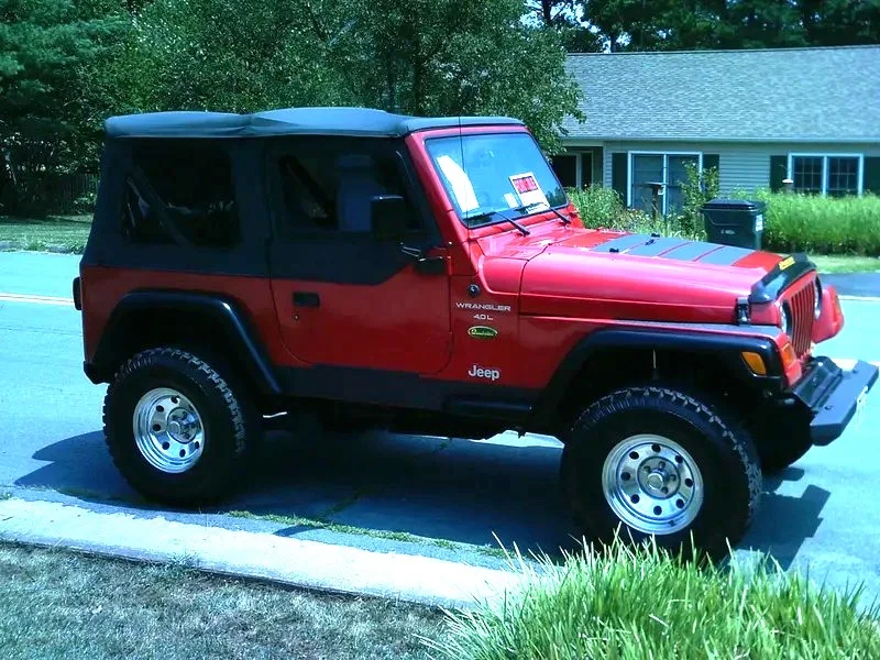

My old 98' with a 3" lift and 32s.

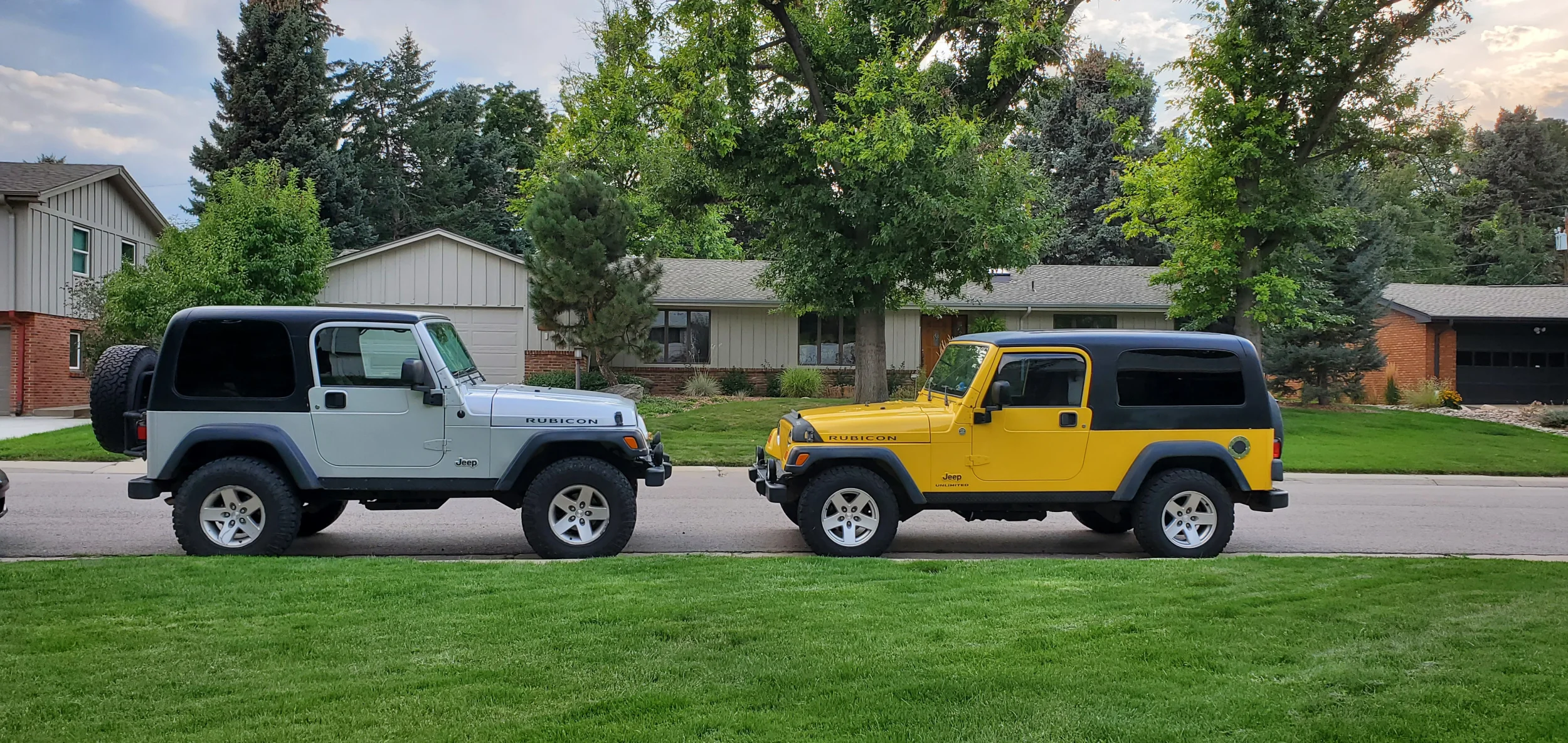

My silver Rubicon is on 2.5" springs and 33"s for comparison.
