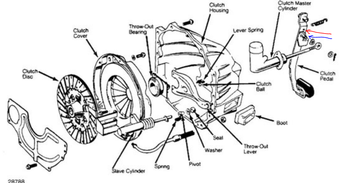

I'm super late to this party, but aren't there two holes in the clutch pedal? Is it possible someone attached the master cylinder to the top one (red arrow in pic) instead of the bottom one (blue arrow in pic) by accident? Maybe a previous owner had shorter legs and was being "clever"?
Having zero experience with this part of the pedal, it seems like the spring connects to the hole with the red arrow. Are both holes the same diameter, i.e. interchangeable?
It has been too long since I stuck my head down there while replacing my master/slave clutch cylinders. Sadly I cannot remember :(
Edit: I just realized the OP has an LJR, not a TJ. I am not familiar with the clutch pedal assembly of LJs.
In my experience the nsg370 grabs at the very top and is awkward to drive coming from other vehicles. The 5 speeds I have driven also have grabbed high but not as awkward as the 6 speed. I always felt the 6 speed was a significantly lighter clutch feel.
The red arrow is a hole, for the return spring that you can see in the diagram. The blue arrow is a pin that the master cylinder rod slips over. That pin is pressed into the pedal. I don't think it's possible to swap the spring and the rod.
