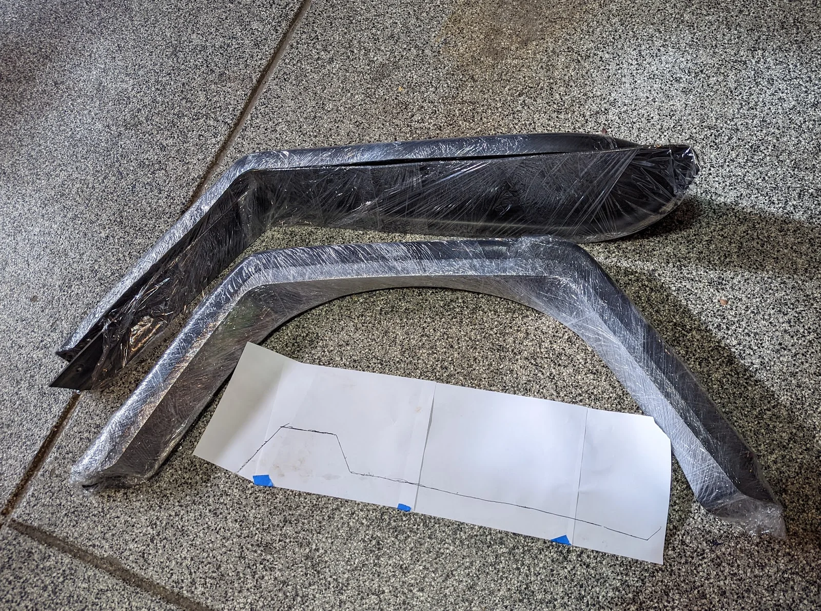

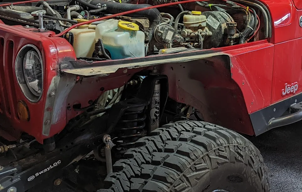

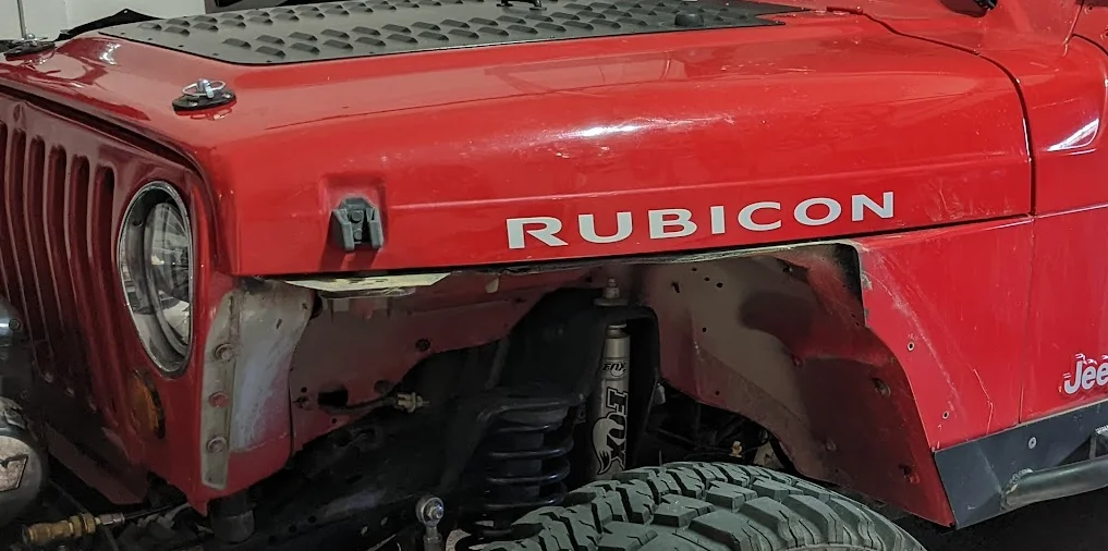

I don't know if this will help, but this is what I sent to the guy that bought my fronts. The jut out is where the factory hood latches would be (if you look inside your fender well you'll see the support around it).
You could pretty much just use your hood to draw a line with a sharpie and follow that until the latch.

If MCE still refuses to send the template to you, you could always download and print it from their website and them tape the pieces of paper together to make the template. I do think the template is still available as a PDF on their website unless they have removed it.
On the rear wall of the wheel opening, continue the body line up. After that, just leave about an inch around where the flare bolts go.
