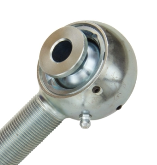

Let's look at some more details. Here is the Johnny Joint:
And here is the Krawler Joint:
It has a similar design and uses jam nuts instead of snap rings to hold it together. They both are rebuildable with replacement guts.

Of the two designs, I’d favor the RK joint. MCs will likely eventually have the ball separate from the rubber. That makes rebuilds easier since you just replace the whole joint inners.
With the JJ style you will need to service them with grease (and note if the RK are anything like JJs the zerk won’t work). However they won’t tear themselves up, they’ll just creak.

I've seen multiple failures where the ball tears from the rubber from people who wheel their Jeeps and make use of their articulation. It's a dumb design. One of the reasons to change to a high misalignment control arm is to get away from the reliance on the elasticity of a bushing.
