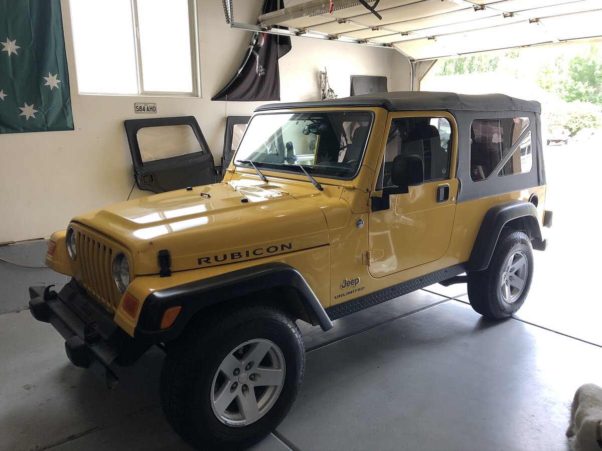

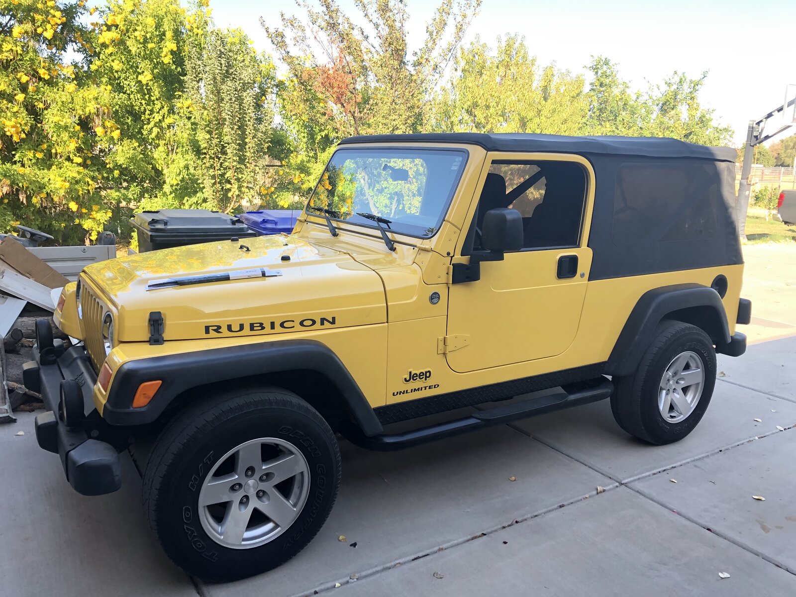

last year I picked up my LJR, a long awaited first Jeep (dream Jeep to add). It came up on local classifieds the jeep was in a light roll over. 98k miles for $9,000. Yellow wasn’t my first choice in color...but for the price I couldn’t let that turn me away. Nickname of “Sunny Side Up” quickly became part of the Jeep
A few little repairs, a trip to the body shop to make sure the frame was straight and the Jeep was road worthy.
A new top was the first purchase because the original hardtop didn’t survive the roll over.

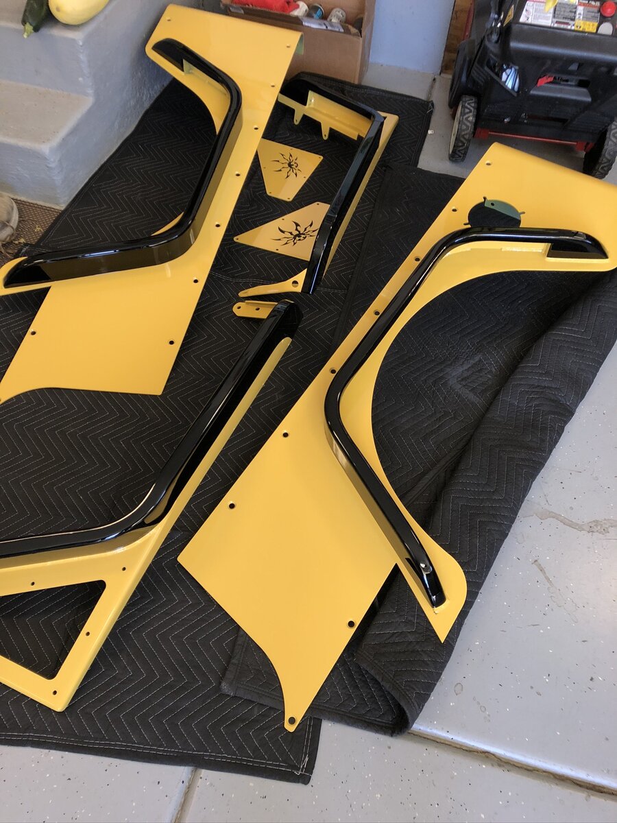

I decided to do the PSC defenders with 3” tapered flares. I opted out the stretched rear crushed corners and high line fenders because I’m wanting to do a more mild build. I prepped them for paint then headed to a buddies paint booth to shoot a color matched yellow and black flares.
Drilling into a clean tub was hard...but worth it! I’m happy with the results
The 33” MTR’s and 17” spyderlock wheels might have been premature. With the extra clearance from the PSC fenders I decided to go for it!

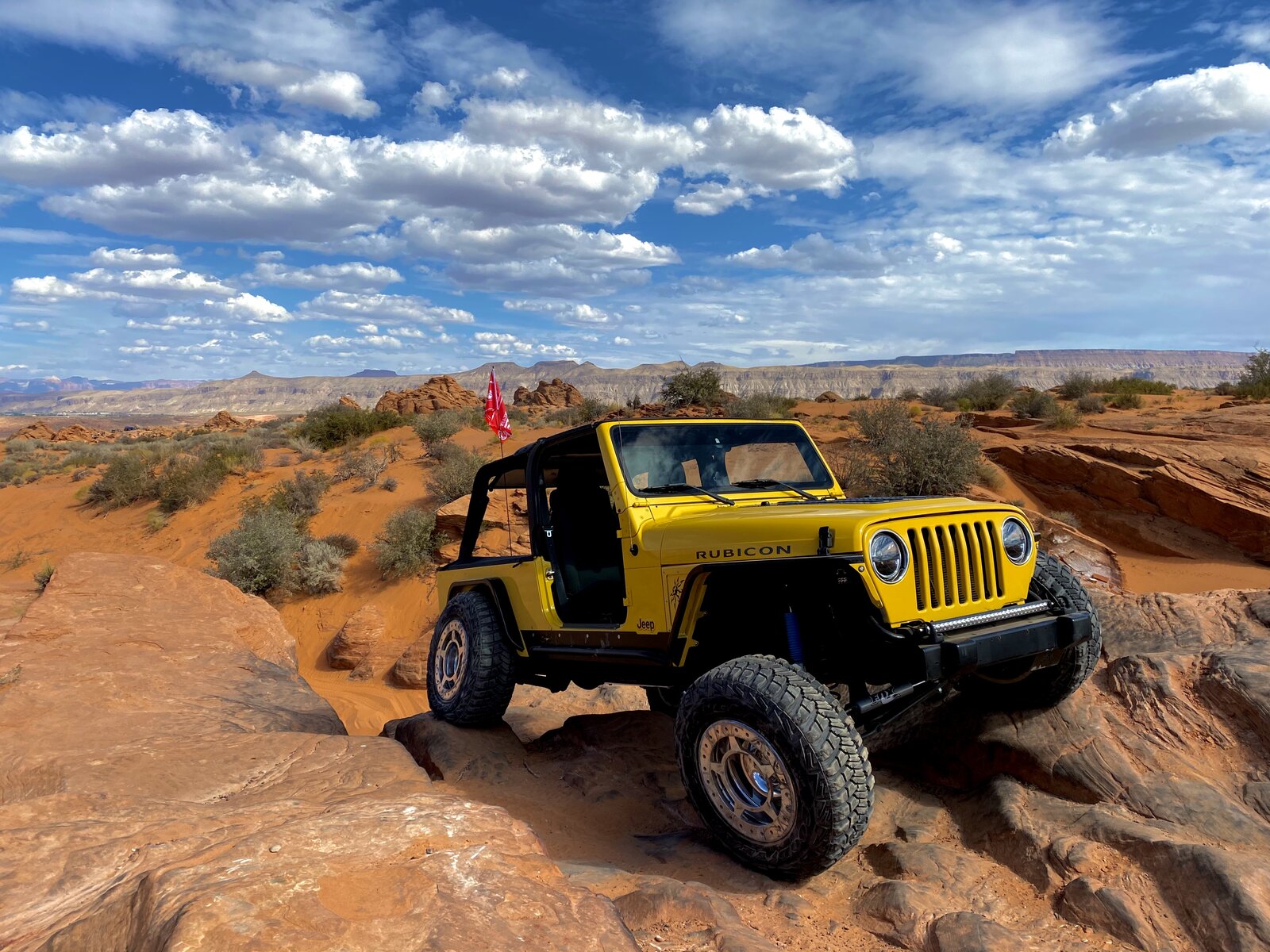

After the install of the Savvy TT, I was happy temporarily. I knew there would need to be a lift before too long. In the mean time more wheeling trips were planned. I attended Trail Hero in Sand Hollow UT. Awesome trails! The LJ did shocking well. I put it to the test and found some of the limitations with my current build.

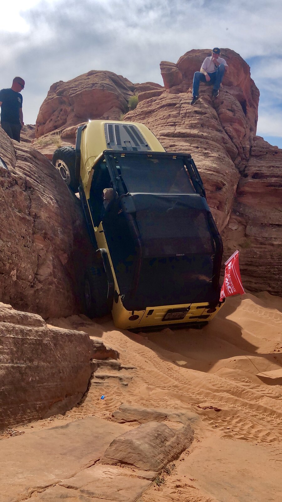

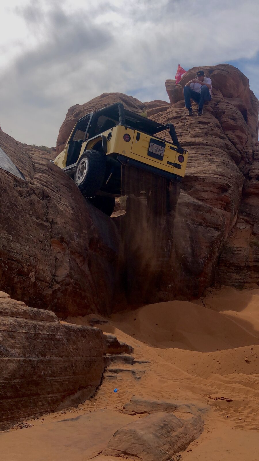

What at Sand Hollow, We were able to run Milts Mile, Double Sammy, and Sliplock Gulch. here are some photos of the trip.

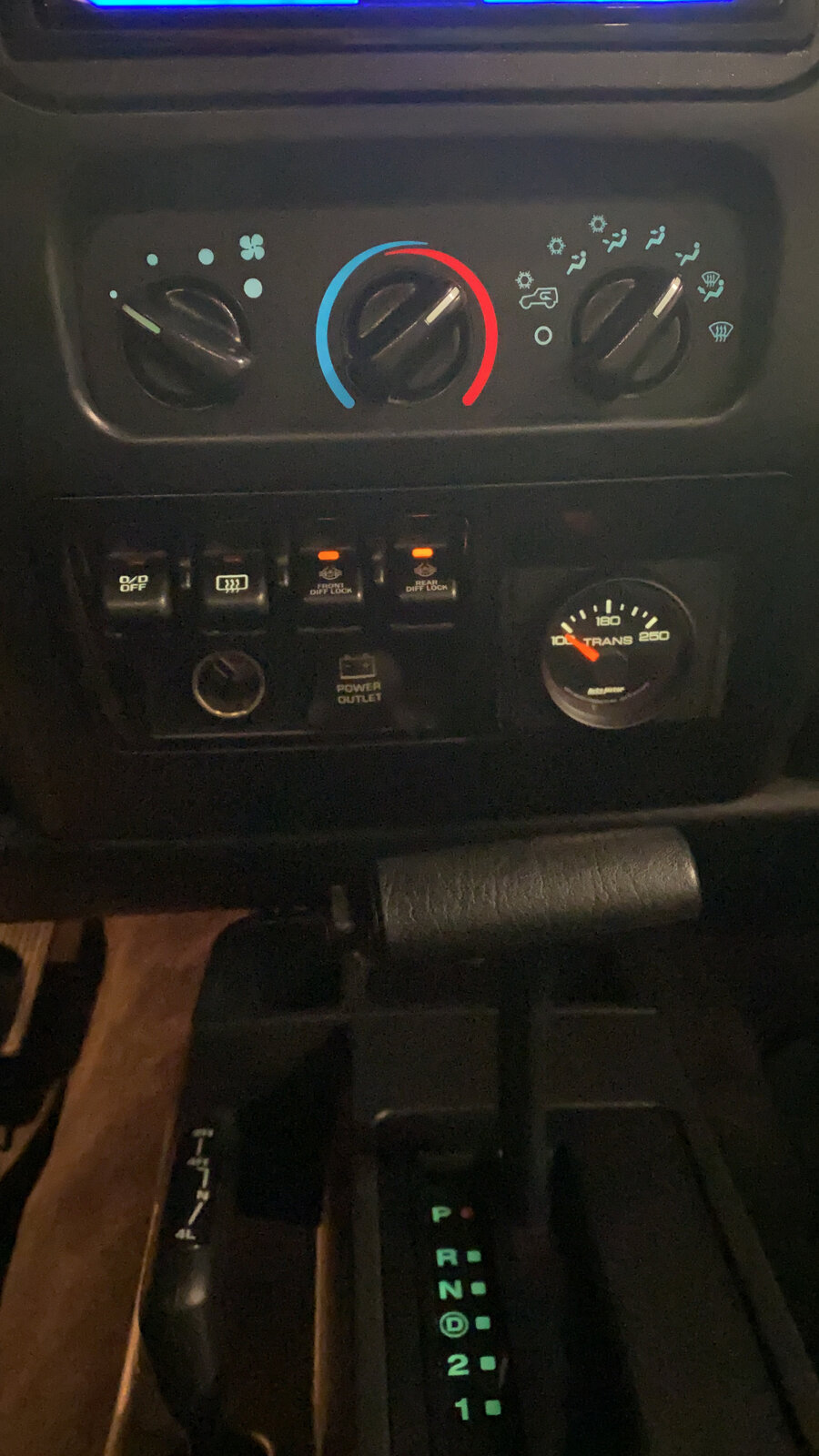

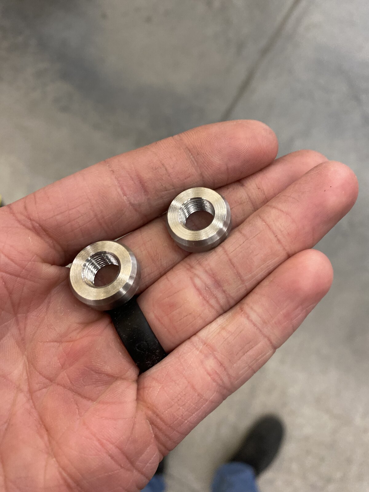

I always liked the thought of a transmission temp gauge to keep on eye on things. after reading some posts about where to mount the sensor I decided to make a bung and weld it into the pan. A quick easy project on the lathe and I had some stainless steel bungs.

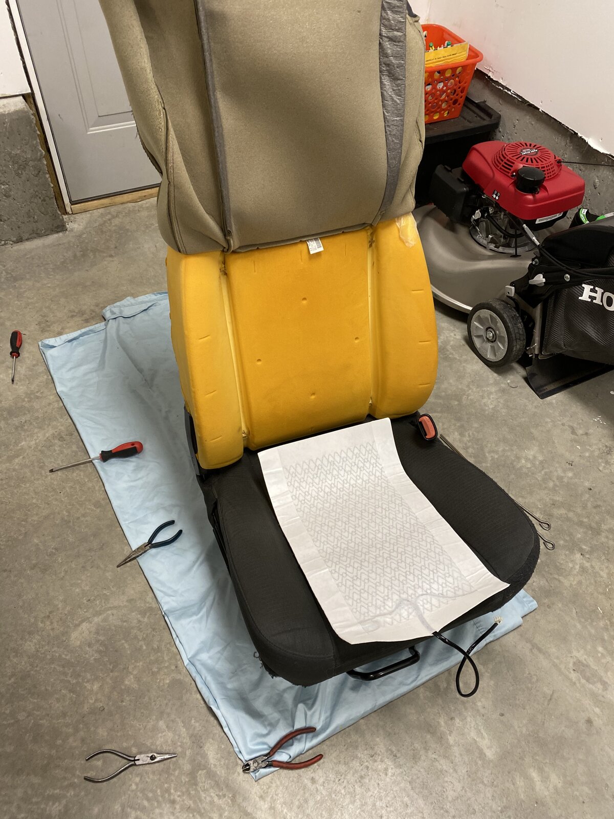

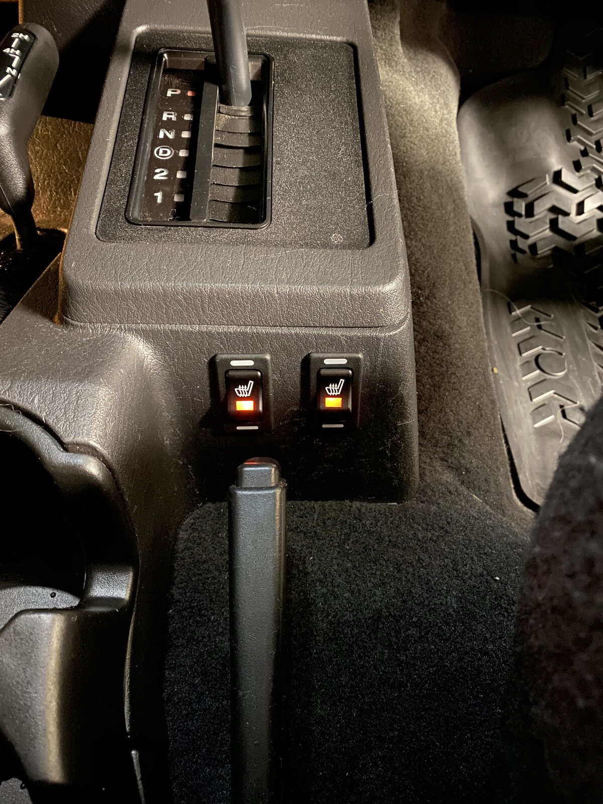

Knowing it is usually chilly in Moab at the end of November, heated seats were on the list. (More so for the wife) She claims the Jeep is now her favorite vehicle we own because of the seats and the heater that will just about melt yourself. Here are a few photos of the installs!

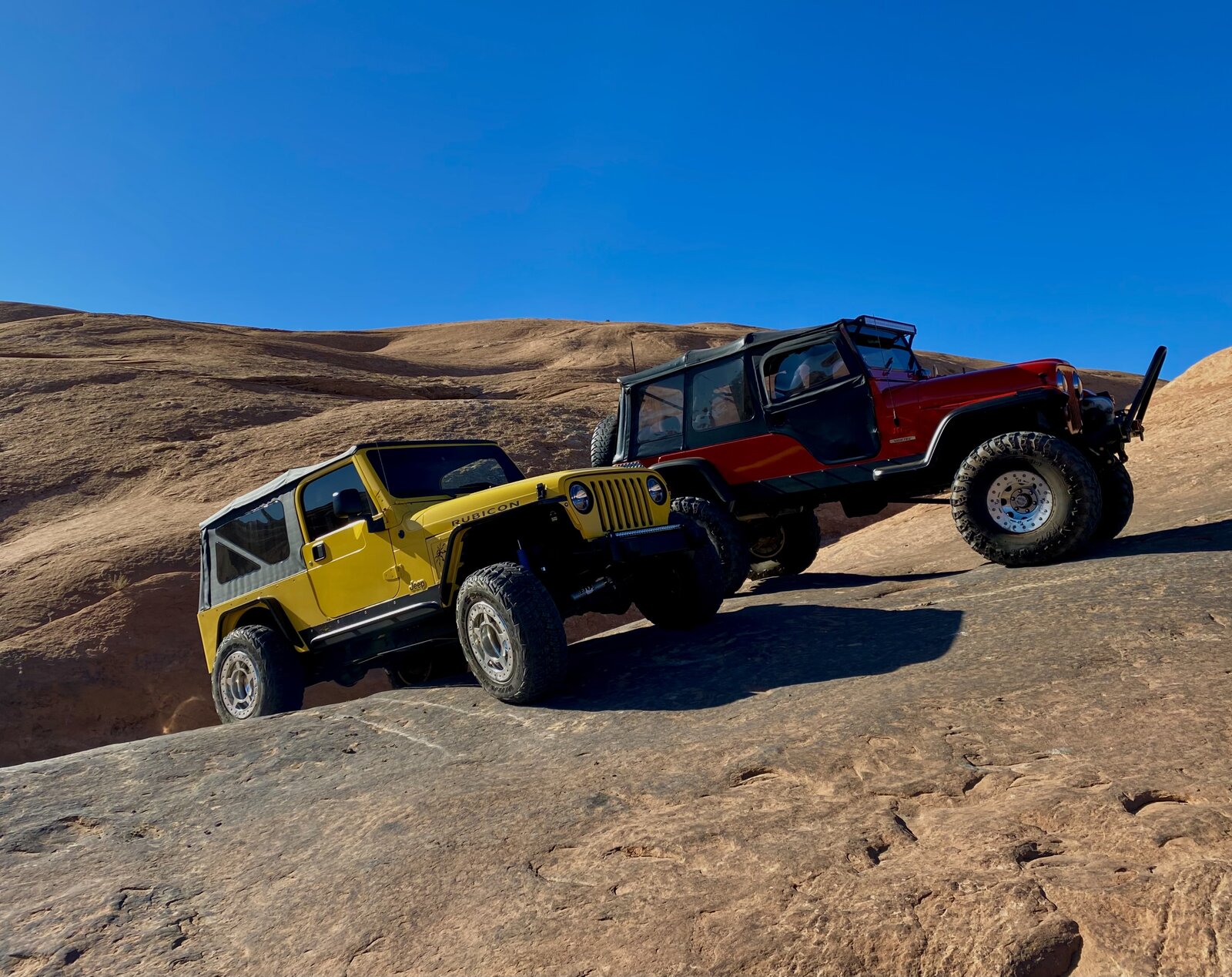

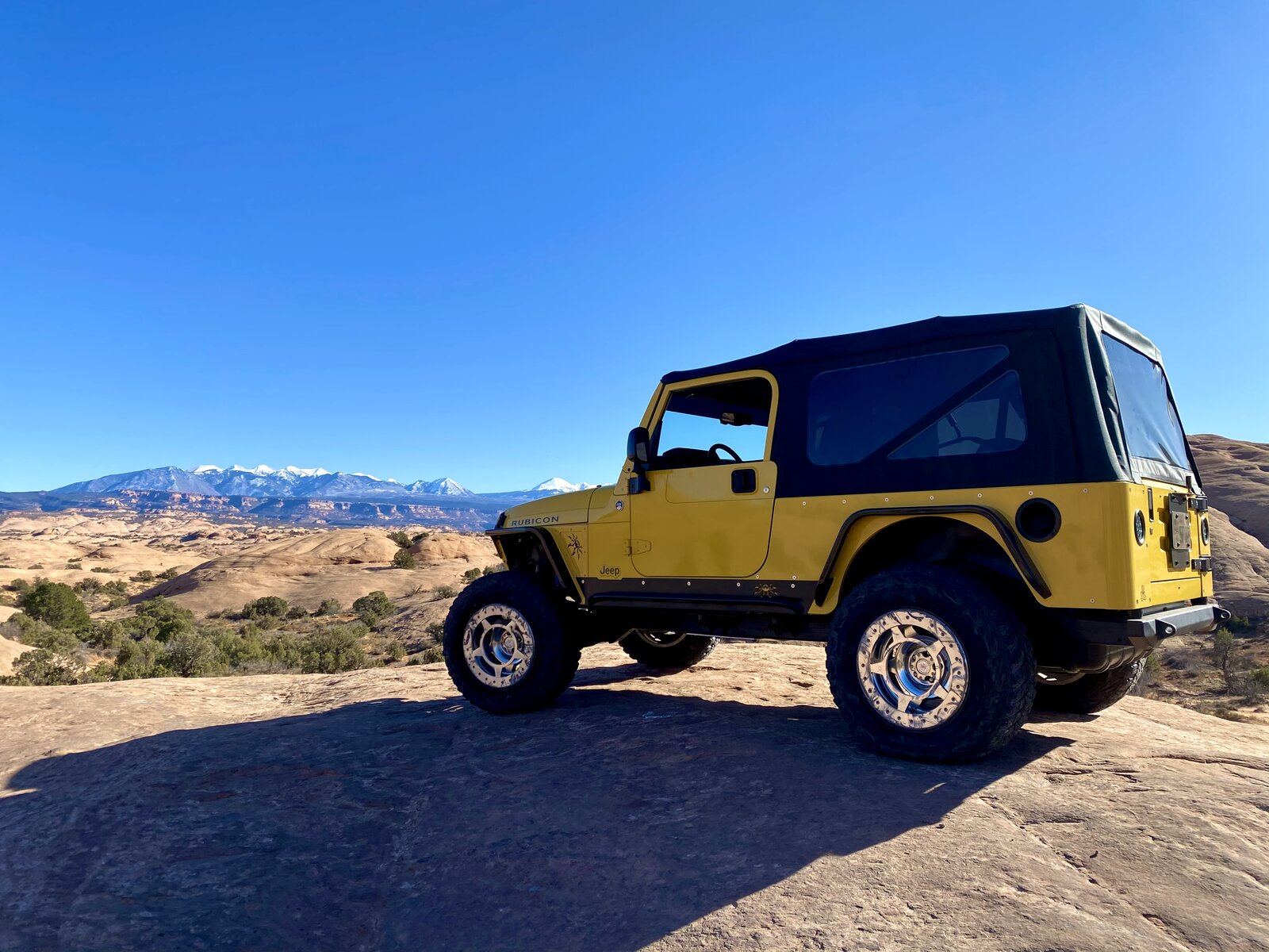

A few photos from Moab..
My Lj and my Dads '71 CJ6 at the top of "The Escalator" on Hells Revenge. Long Jeeps are better ;)

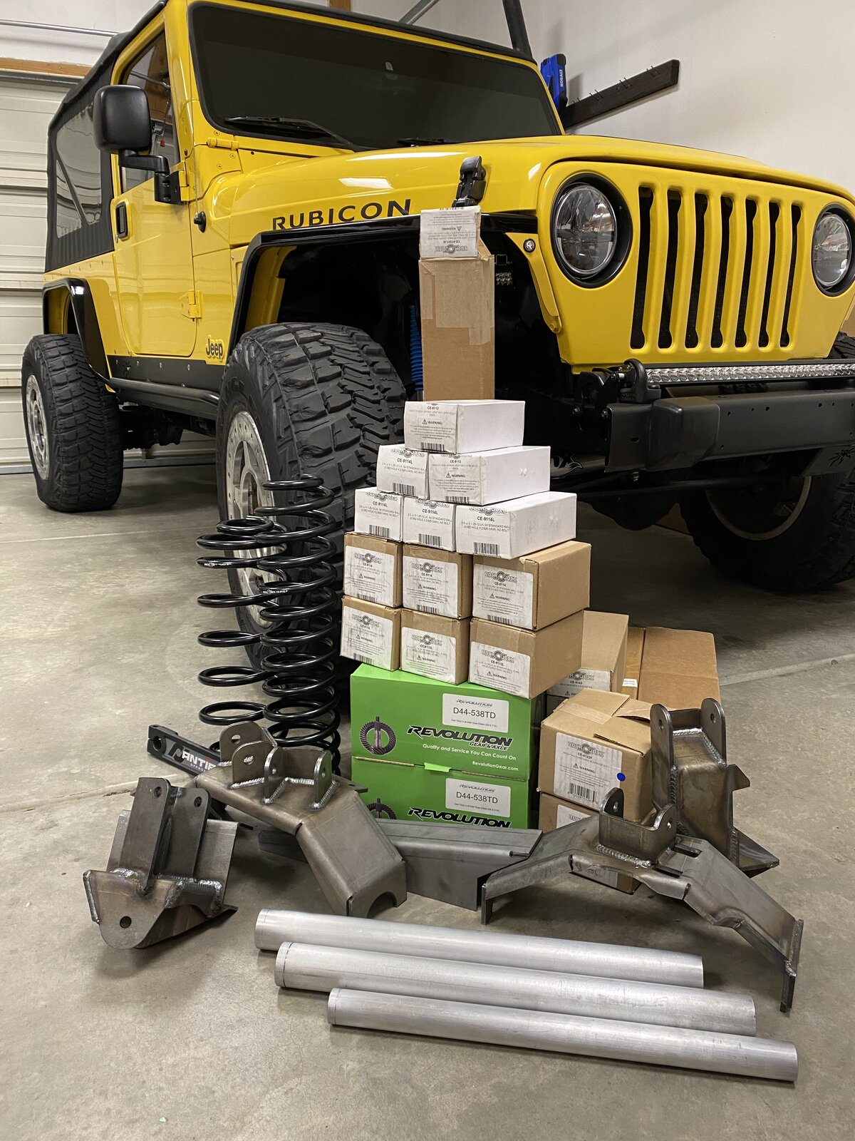

Once I got home, my Savvy Mid Arm lift was waiting for me. All the pieces of the puzzle are coming together. Next week I am planning to begin the project. (I do all my own work) Just need to make room for it in my dads shop and get to it!
Thats an exciting pile of parts!!

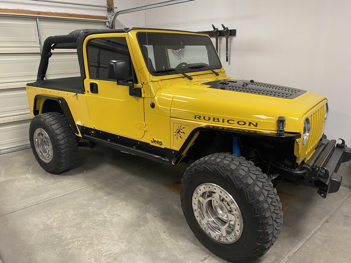

Thanks! Making the masking tape line for the flare was the most nerve wracking part...turned out as good as I could have hope. Very happy with the outcome!

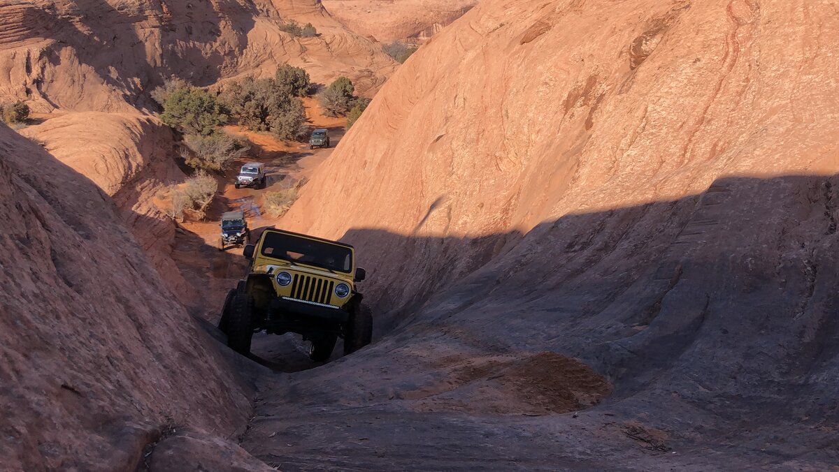

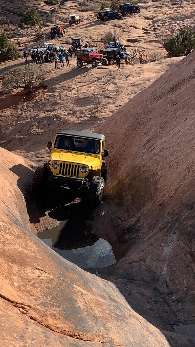

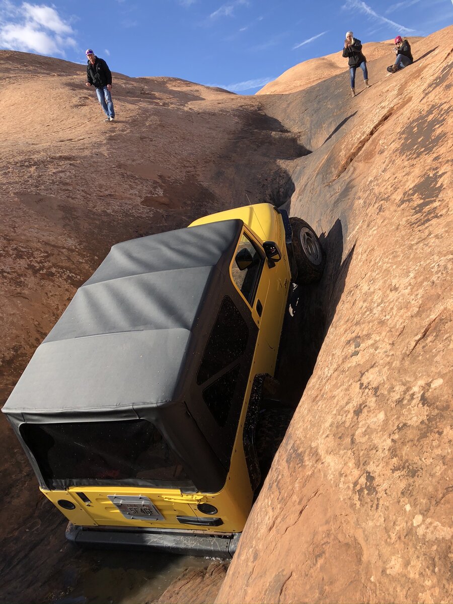

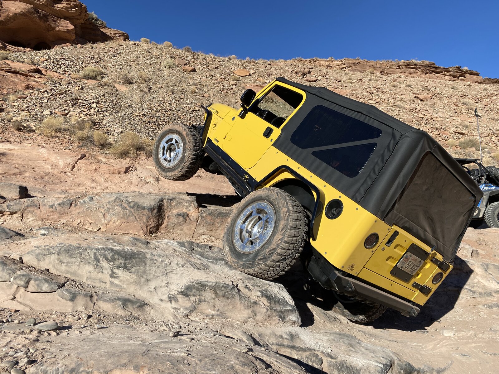

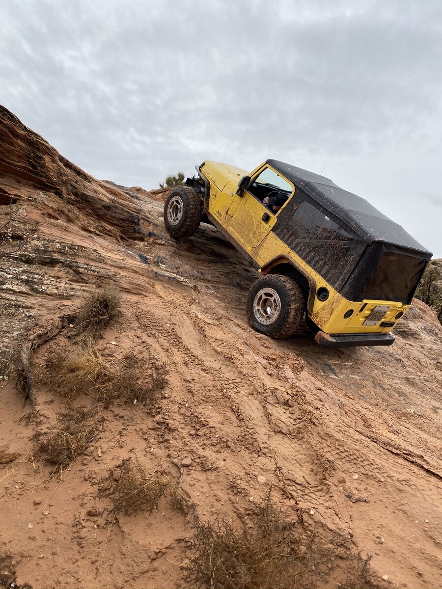

That wall you climbed at sand hallow was ridiculous!! what was your lift height when you did that? stock motor and rubi gears? awesome build.
Hahah I too was amazed to make it! The whole trip I was waiting to give that obstacle a go. The Jeep was on stock suspension and stock drivetrain at that points. Just shows how impressive these Jeep can be nearly stock

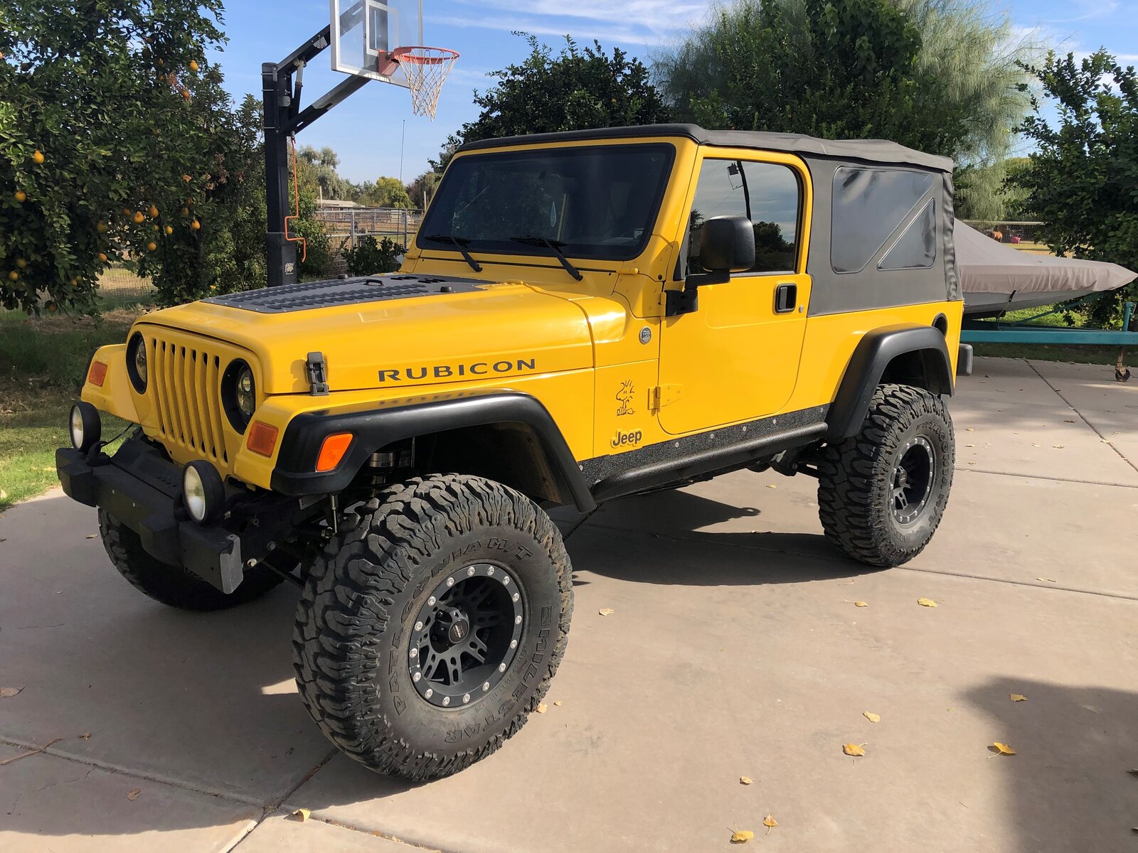

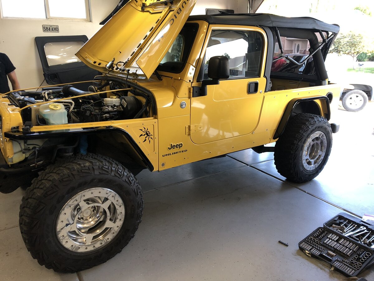

Something about the stock fenders and flares look awesome! Very clean LJ. What lift size and tire size are you running?
I have stock fenders on my JK too... Just like that look. So, I'm at 4.5" of lift plus the 1.25" body lift. With the tummy tuck, she's got some really nice belly clearance. Running 35's on 15's...

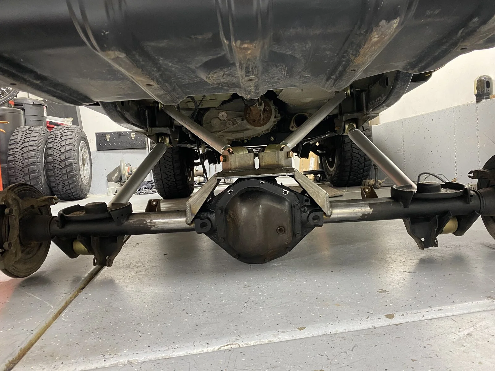

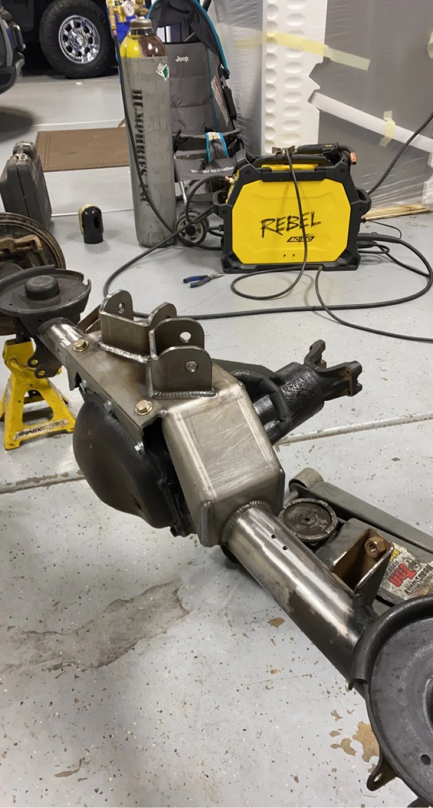

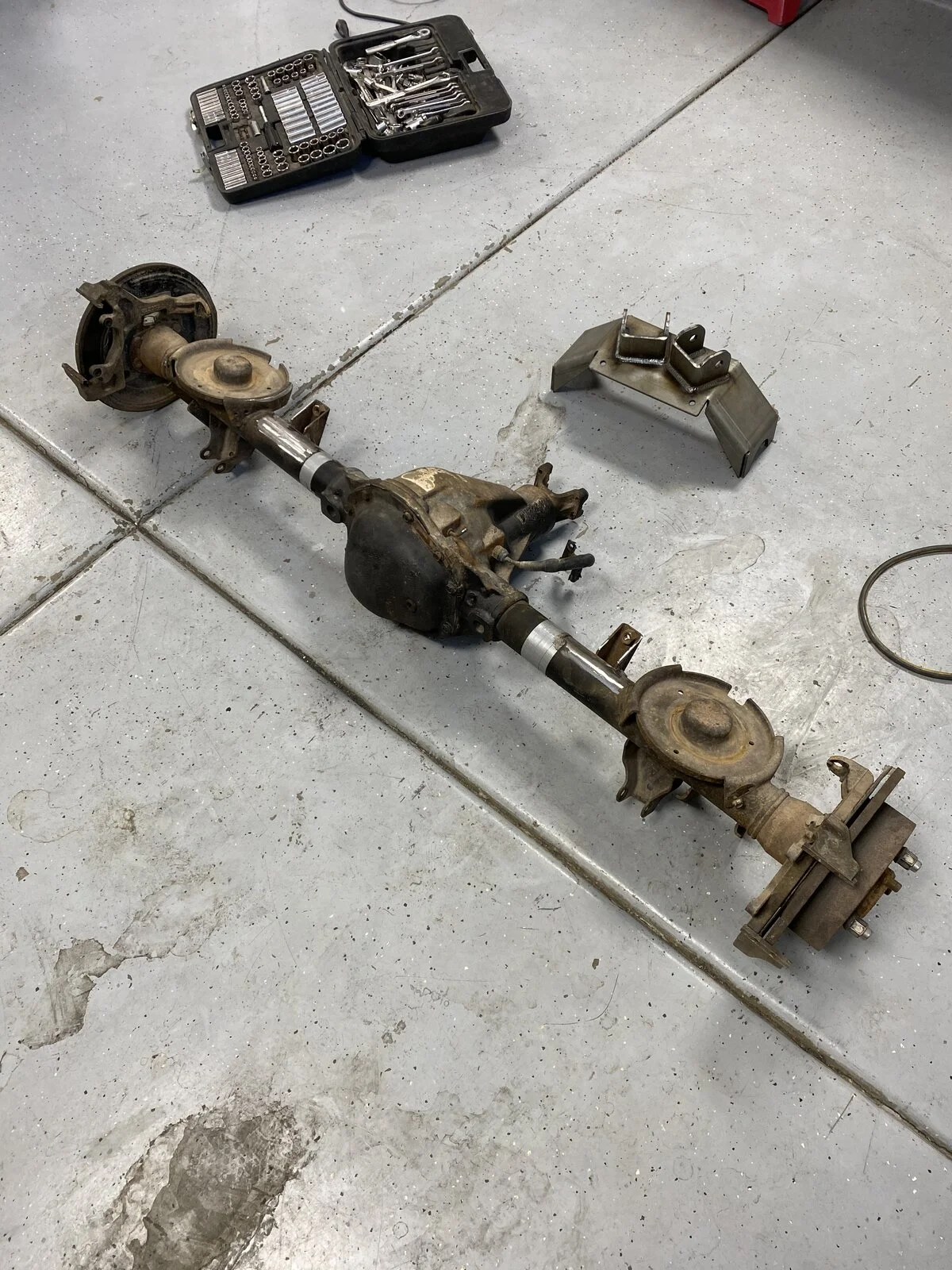

Good day working on the Jeep! Started by getting the rear end on jack stands and pulled the rear axle out. Plan on doing the rear first then moving to front. Lots of cutting and grinding but was able to remove the unneeded factory brackets off the frame and axle.
Next I plan to cut the upper coil buckets off to relocate them. Then begins the tacking and welding!

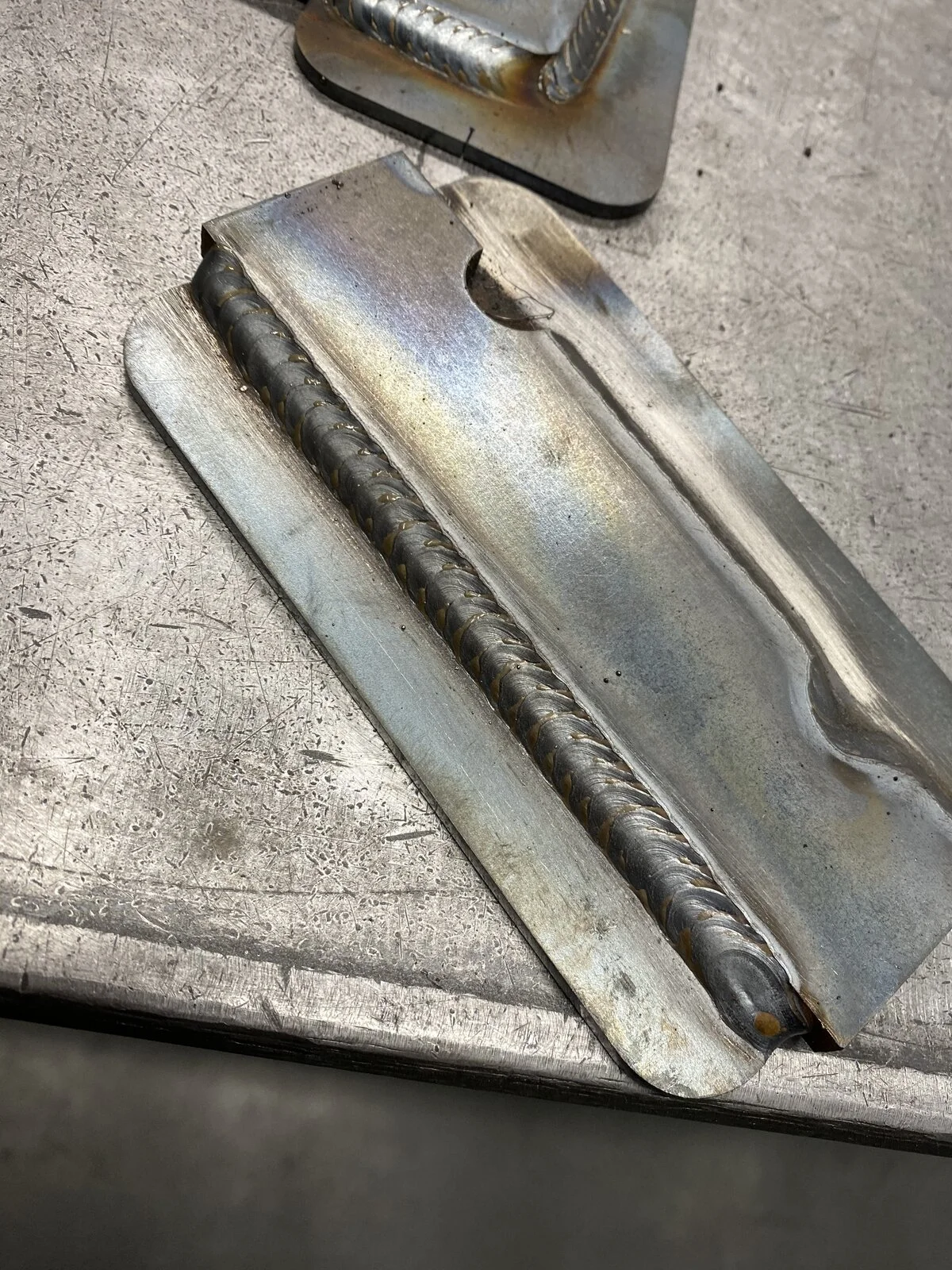

Here’s a little bit of practice welding coupons... 1/4” to 1/8” trying to mock welding the Savvy brackets to the frame. I’d say I’ve got the setting just about dialed!
I assume you're going to relocate the upper spring perch while you're at it?

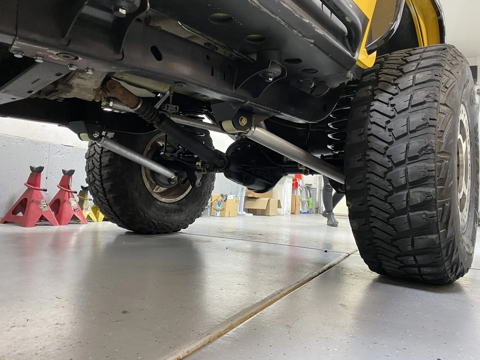

Progress is slow as I only get a few hours after work to spend on the Jeep. I got the rear upper coil pads cut off, and welded the rear truss, the control arm frame mounts, and welded the coil pads in their corrected position. I am very pleased with the way things are coming together so far! Enjoy the pics!
First week of the build is coming to an end. I feel I made a good amount of progress. The rear end is near complete. Everything is repainted, ring and pinion is installed, locker lines and wires are rerouted. I am waiting on the rear brake line. Tracking says it should arrive on Tuesday. The Jeep is sitting back in its own weight!
Shout out to @hosejockey61 for the input and tips on the ring and pinion install. I got the pattern and backlash just right!
The process of cycling the suspension has been done a number of times already. A few more adjustments to get the pinion angle perfect, and a night with the cutoff wheel for the 37’s to fit is needed! (I know...most of you squirm with the thought of 37’s. I know the risks 😎)
