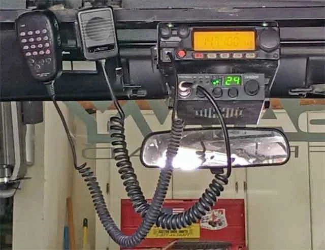

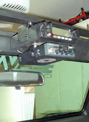

Mine fits nicely in the cup holder of my center console, but I can't argue with your logic. A hard mounted unit with an external antenna is convenient and more powerful if you have the accommodations to mount multiple units and multiple antennas. I prefer less clutter myself. If memory serves me, you have a HAM radio also? Where did you mount your stuff? Overhead rack?
I mounted mine overhead using the mount from Arizona Rocky Road, it requires no drilling to install. Its design is especially nice that it hides the wires inside. That's a Yaesu FT-2900R 2 meter ham radio on top and a Uniden Pro-520xl CB on the bottom.
Reactions: bobthetj03
Where do you stow the mics?
I use spring-loaded automatic mic retractors for both which works great. No need to have to put the mic back into its holder.
They're easily found on sites like Amazon. Like this though I didn't use the extra cord or connectors, I cut the snap-on connector off the string and just tied the string to the button on the back of the mic. I siliconed the retractor housing to the top of the mounting bracket where it has been working well for a dozen years now. This is a retractor like I used... https://www.amazon.com/dp/B00361UOTM/?tag=wranglerorg-20
My mic cords don't hang down like it shows below any more, I gave both cords one wrap around the mount which gives them enough slack to be pulled out for use but not to hang down.
Reactions: D M and bobthetj03
