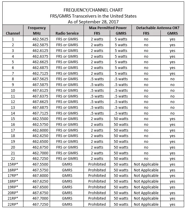

Also confused on how DCS codes work, if there are only 8 channels w/o repeaters how do you keep from hearing everyone else using say channel 4 when out with a large jeep event ?
CTCSS & DCS codes/tones are like sticking your fingers in your ears except for anyone also on that specific code/tone. Everybody else without the tones will hear you, but you won't hear them. It's the opposite of privacy. Reference a big Jeep event, there are 22 channels, not 8, but if you wanted to be on the same channel and not hear everyone else, CTCSS/DCS codes are designed exactly for that. Not sure how well that would work on a super busy frequency in a small area though, sorry. I'd just use a different channel.

How did you come up 22 channels ? just asking
Midlands show these numbers
8 Repeater Channels
15 Hi Power Channels (GMRS Channels: 1-7 & 15-22)
so 15 and if you add the 8 Repeater Channels you get 23,
Roger. I hadn't really paid attention to my Midland in those super low power channels so didn't notice they were missing. That's where I got my numbers from though.
