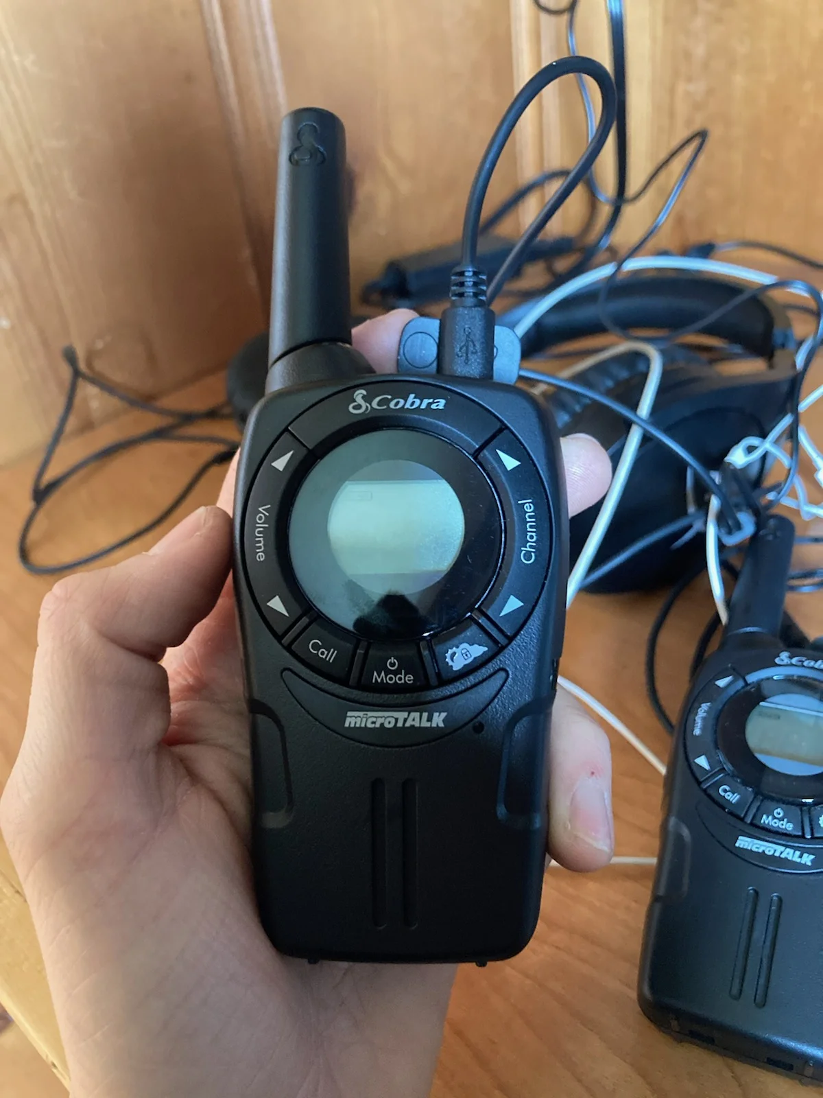

I have my Baofeng and a pair of these, they work well for trail use

Those look kinda cool! Never saw any like those before.
I got the idea from @bobthetj03 after we went to upper lake, amazon actually sent me a different pair than what was listed in the Ad, but these use 1-22 GMRS and FRS so I like the fact it can use both. I tested the range with a buddy when we were also testing the baofeng's range. Its okay, about a mile at best and there was some obstruction(neighborhood houses), but fine for trail use when we are within eyesight too.

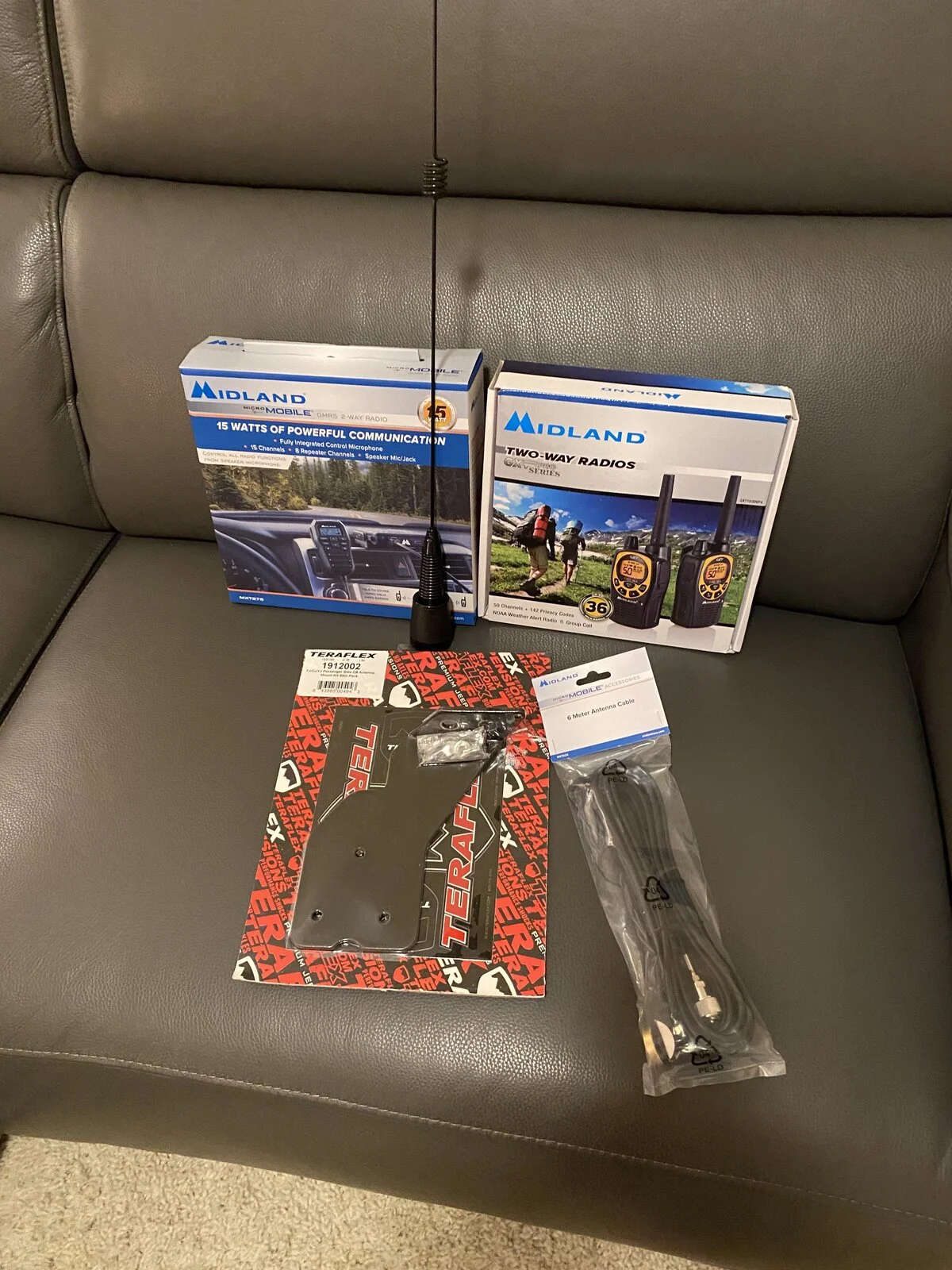

Just received my new equipment hopefully next time I am with my jeep I can start the install. I went with the Midland MXT275 because of its small size and since I am keeping my CB for now I didn't want one more thing mounted taking up space. Also went with the Teraflex passenger side taillight mount, and the Midland 6dB gain antenna for better reception. Also this way it will match the CB antenna mounted on the drivers side taillight mount, I guess this is my OCD coming out. Then to round it out added the Midland Handheld GXT1030 VP4 units for tail and camp use. Now I hope everything works like I planned :)
