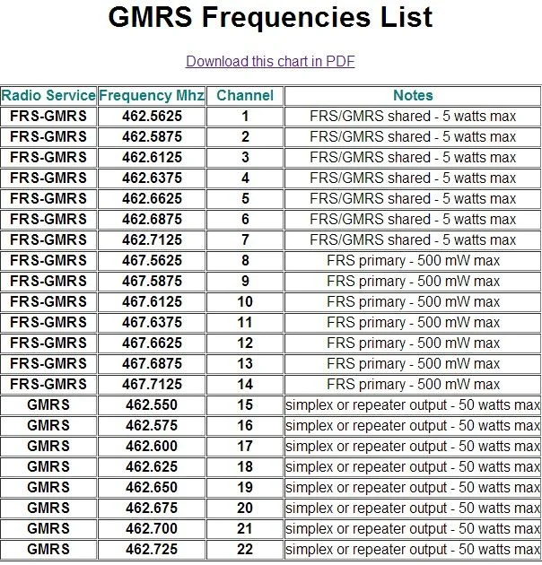

Correction —- The Midland Micromobile radios WILL NOT work on FRS channels 8-14 due to power restrictions, but will work on channels FRS 1-7.
This may help.
Channels 1-14 are FRS/GMRS shared channels. Channels 15-22 are GMRS only.
The Midland Micromobile radios cannot use FRS channels 8-14 but can use FRS channels 1-7 and GMRS channels 15-22.
